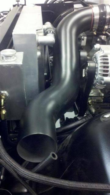

      Now that the HRPT '12 is getting very close, and our Olds is receiving it's final few finishing details, I thought I would upload a few more photos..
      Here is the cold air intake that I built using a piece of diesel truck exhaust..
