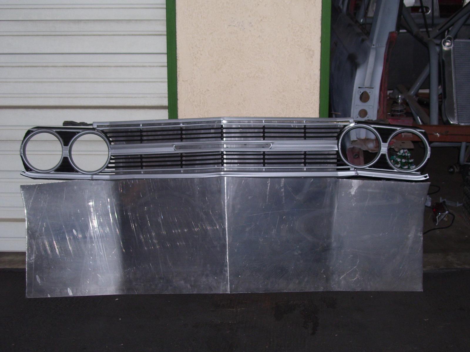

      Your spoiler has given me so many ideas for mine, I would love a better picture of the flange on the bumper. Mine is a grill blockoff also so it will be a little different design but alot of it will still apply but your design is very thought out. Here is a picture of the begining of mine it is mounted to the grill support connected to the core support and will have a frame behind it to stiffen the whole thing up. My radiator is rear mounted so there isnt a need for airflow.

      I'm working on the car today so I'll take some more pictures of the flange for you. The nice thing about this design is once it's all bolted together, it creates a box and doesn't need any other supports.
      It's kinda hard to see in the pictures I posted, but there are two block off plates for the rectangular openings in the bumper. I'll use racer's tape to cover up the grille, the engine runs cool regardless.
