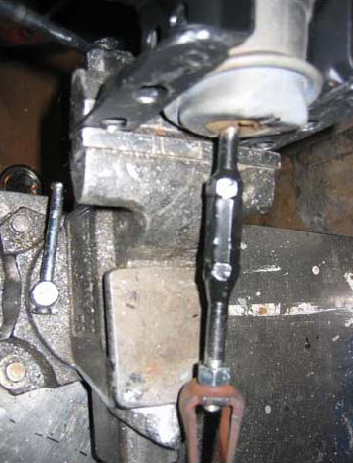

      What did you change on it to make it work with your car? I've done a few and broke the first one I modded.

      I welded metal to the bracket so i would not have to mess with the firewall. Also put a sleave on the rod...see picture (sorry its the only one i have).
