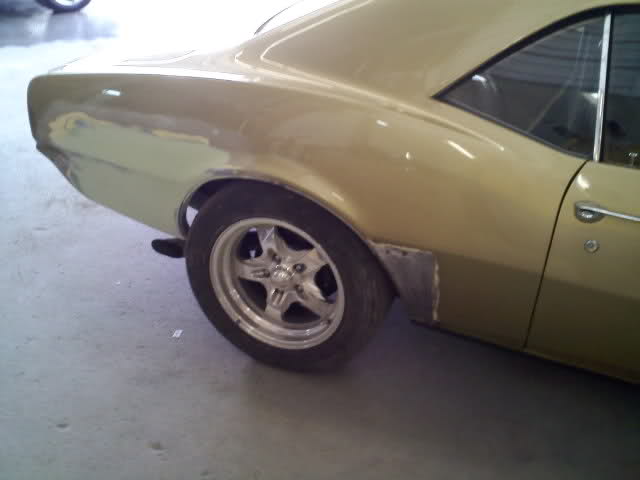

    11. #31
      Jan 2007
      CT
      782

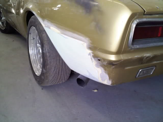

      Body Work Under Way!
      So.... Last yeat I did the mini tubs / Cage / replace some rusty parts of the quarters. At last I have funds to have the car painted. This is being done by a freind who works for a body shop.

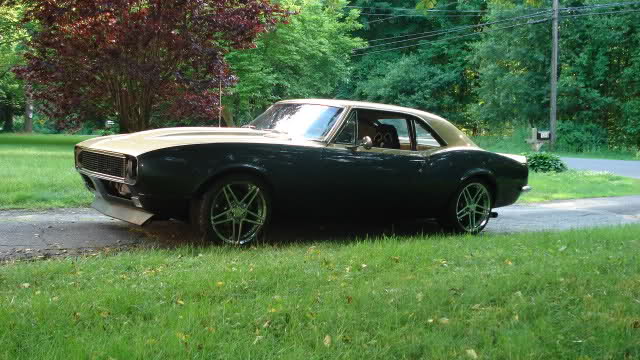

    13. #33
      Jan 2007
      CT
      782
      whoo hoo new paint!
      Well its been 7 weeks and the car just got back from my buddies shop..Couldn't be happier.....

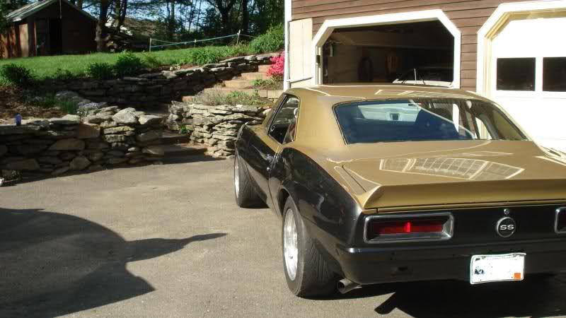

    15. #35
      Jan 2007
      CT
      782
      heres a better pic of the paint
      ________________
      Nick S.
      Gold/Gray 1967 Camaro

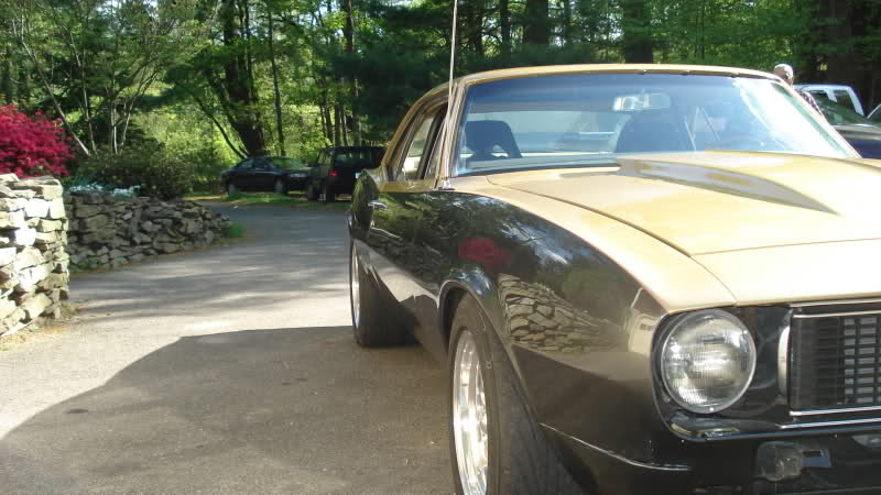

    18. #38
      Jan 2007
      CT
      782
      here's one in the shade to see how much darker it gets

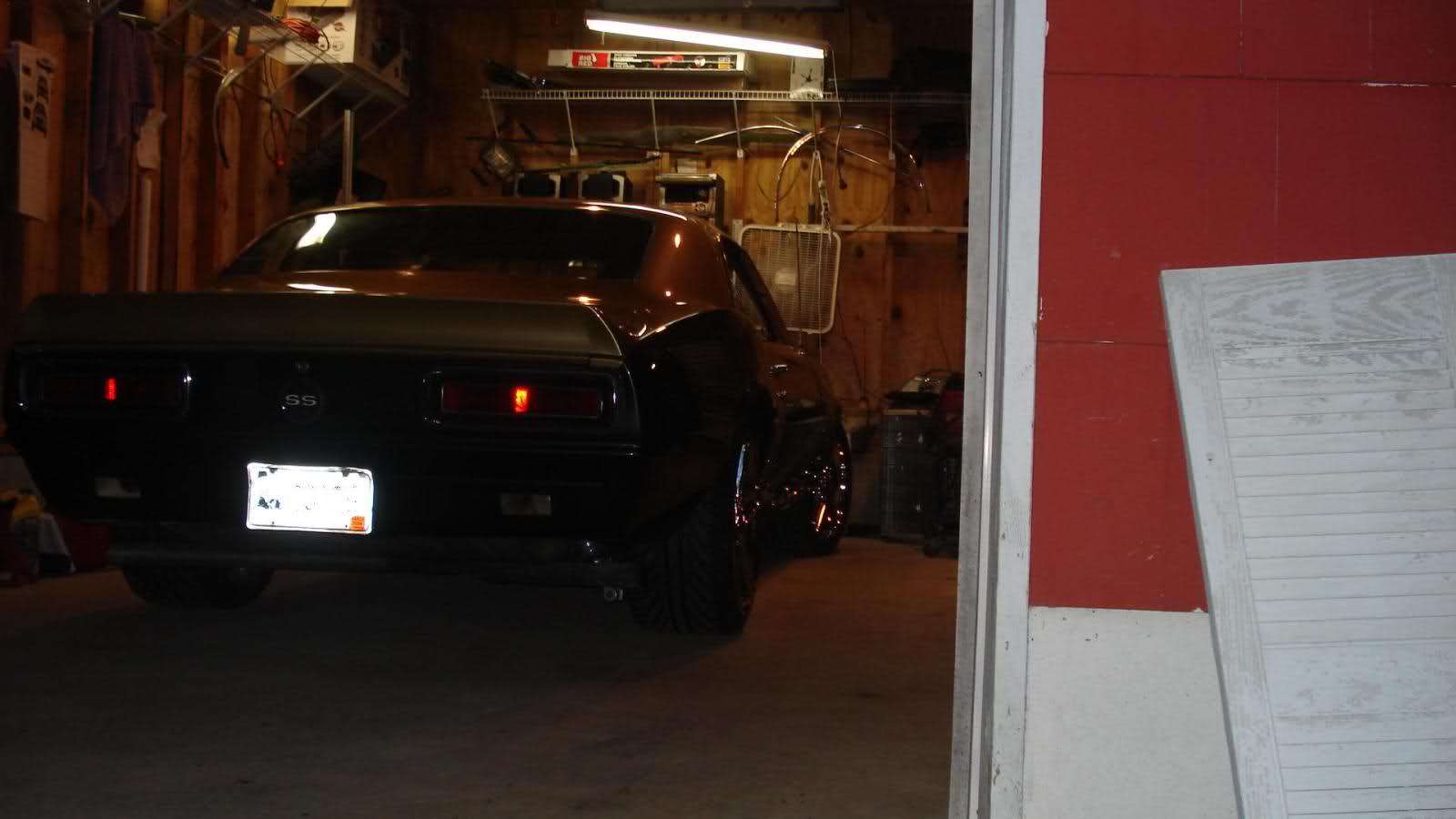

    19. #39
      Jan 2007
      CT
      782
      Back on the road
      For the love of god it is back on the road.
      After the t56 and 4.10 went in I had developed a horrible vibration. After messing with the pinion angle, 2 driveshafts, and rechecking the tranmission it turned out to be the trans mount.
      Itstarted like this
      Installed the transmission and I had a bad 2nd gear syncro so the trans came out for a rebuild
      Then I had the original driveshaft shortened and the shop cut it to short and left a ton of play in the Universal. I thought this was the source of my vibration so ordered a denny's driveshaft and it was still there. After beating my head against the wall for a while I started to eliminate things. It was the F^(%!#& trans mount. For some reason it was not working with the solid body mount and the rest of the car.
      Between waiting betweek paychecks, parts, repairs, diagnosis, and install time It took over 3 months to get it back on the road.
      Just in time for a nice Connecticut winter........
      Oh and the 30 pound flywheel needs to go now....

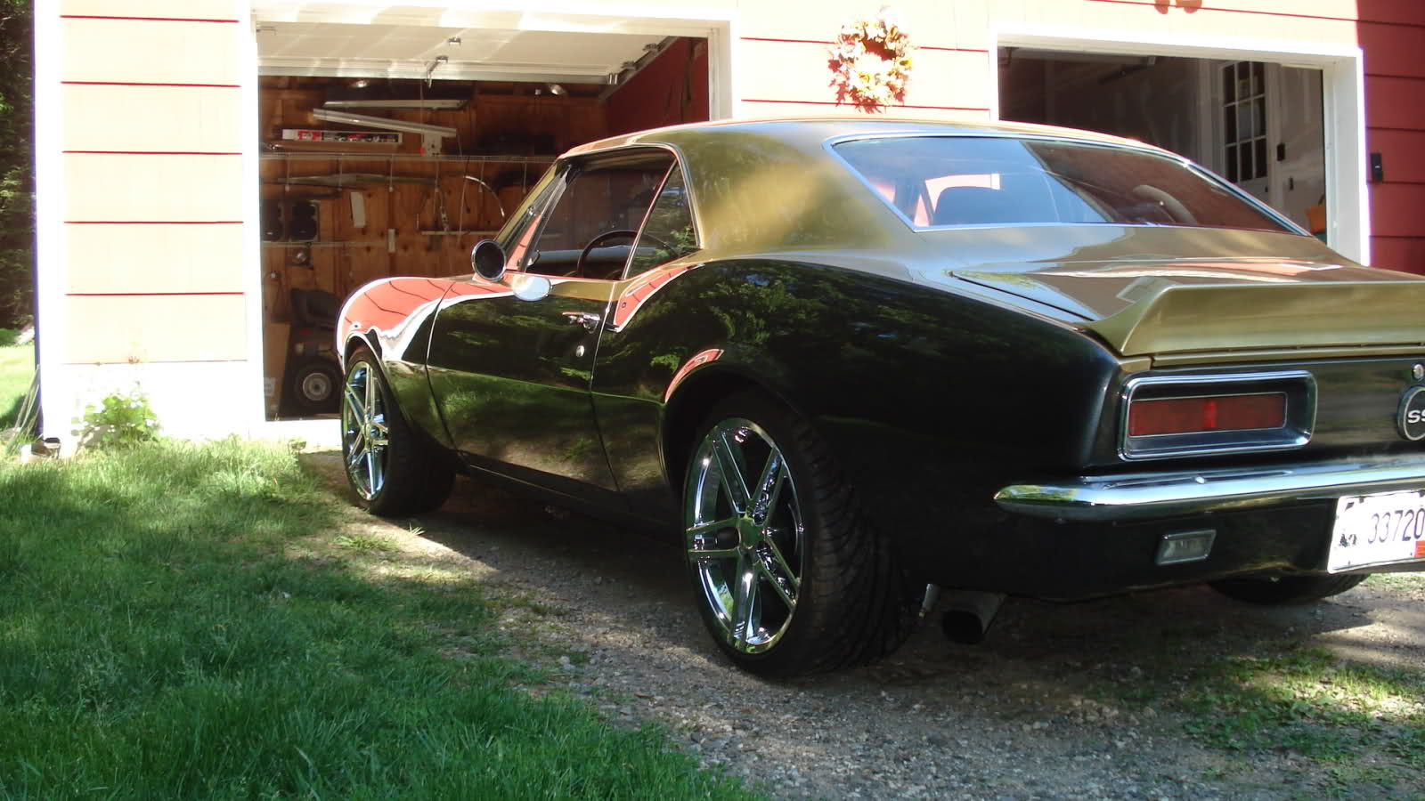

    20. #40
      Jan 2007
      CT
      782
      Painted my wheels
      Well i was never a fan of the chrome rims so i decided to paint them jet black. I am happy with them overall. I was testing a new spay gun and it was total junk.
      Also I added my home made splitter and is overall really happy with it.
