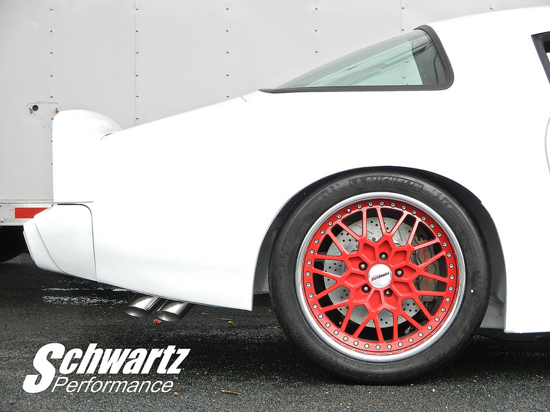

      Here's some more pics.
      Test fitting the Forgeline TA3P wheels. Minitubbed, marker lights and door locks shaved, etc. I'll start assembling the twin turbo 6.9L LS? in a week or 2.

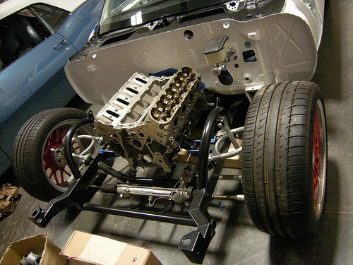

      Jeff, I noticed in picture #2 you have added webbing in between the motor mount brackets. Is this something that I should do on my chassis? Have you had a twisting issue or just doing this to avoid that possibility?
      Mike
      Chicagoland
      957
      Quote Originally Posted by Mike Holleman
      Mike
      One of the guys added that because this thing is getting a 1000+ hp twin turbo engine and I'm gonna beat the tar out of it.
      Haven't had any problems though. I hadn't even noticed it at the shop until you mentioned it here.
