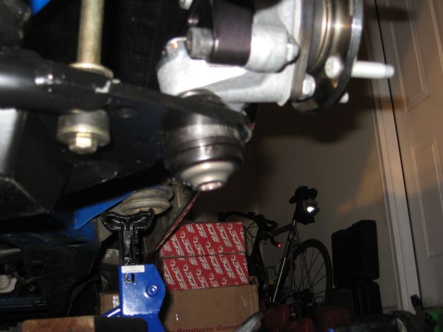

      I had my new Howe lower ball joints (LBJ) installed in my new SPC lower control arms (LCA). When the guy pressed them in for me, he mentioned that he was nervous about them slipping back out of the LCA due to the lack of friction surface between the LCA and the LBJ. I didn't think much of it since I've had several sets of stock-type LBJ's installed and never any problem.
      So, I finally get all my parts here and get some time to get out there and start installing my new front suspension. SPC upper control arms, ATS spindles, hotchkis springs, SPC lower control arms, etc... I get everything installed nice and purty. I'm painting up my calipers getting them ready for install. I read the instructions about trying to get your alignment at least clse to what it was stock. So I take some measurements and start to adjust my new uppers.

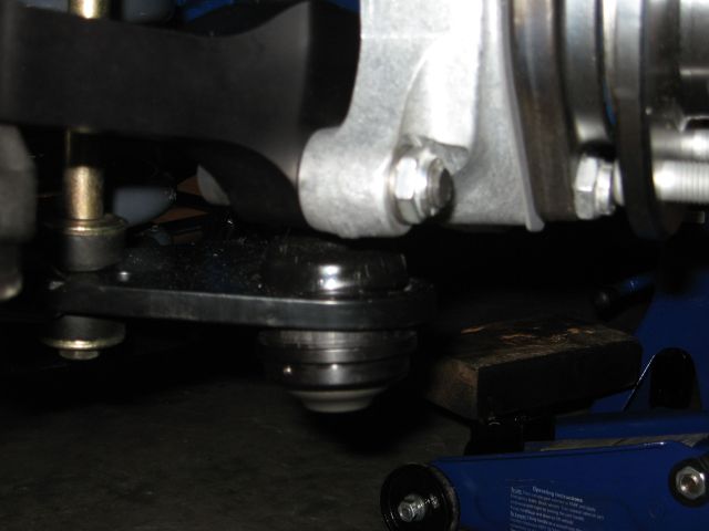

      I'm on bolt 4 of 6 and I'm DONE. Then THIS happens...
      Yes, that's the LBJ that has slipped out of the LCA.
      Has this ever happened to you?
      What did you do to fix it???
      My personal opinion is that there just wasn't enough friction surface. Or maybe the hole was cut a few thousandths too big. Or??? I just don't know.

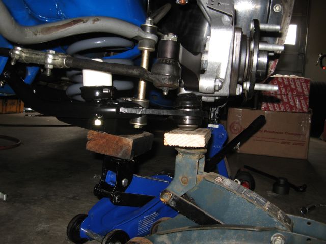

      I haven't checked with Marcus yet, but I have already decided to tack mine in place. I was able to get it to reseat by removing the swaybar and tierod and placing a block of wood on the LCA. A few blows with a 3lb sledge and it reseated. I did need to jack up the LCA at the same time, though - I used my biggest socket to protect the BJ.
      I just wish I knew why it pushed out, I was thinking that the spring would pull it into place, not force it out.
