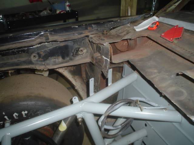

      got bigger fish to fry than the roof flaps right now.....the race car firewall is set 4 to 6" further back (along with the motor) than the stock Chevelle....had to lose my stock wiper mount but a local street rod guy who came by says its not a huge deal to put a hot rod wiper motor in......my delema right now is if I should try and save the stock Chevelle fender mount (way easier) or cut the whole area out and make a brace to hold the fender from the race car tubing in the same area.....you can see in the 2nd pic where the stock fire wall was.....been letting it digest for a week and am heading towards saving the stock mounts

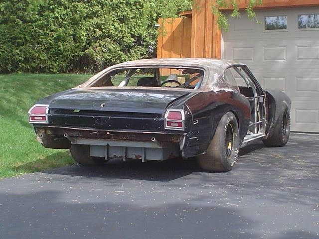

      finally some updates.....been working hard to get the body down on the frame in the last while before our trip to California and my busy season at work kicks in....I may have to trim some fenders some more and play around but this is basically where its going to sit.....
      with the jack screws front and rear I can raise or lower the ride hieght as I see fit and I dont have a rulebook giving me a min ride hieght
      with wheels avail in one inch different offsets I can move the wheels in and out also....these ones have a 3" offset (measured from the back side of the wheel) I had some 4'' ones on there but it lacked attitude compared to the 3's....I think I'll stick with the 3's

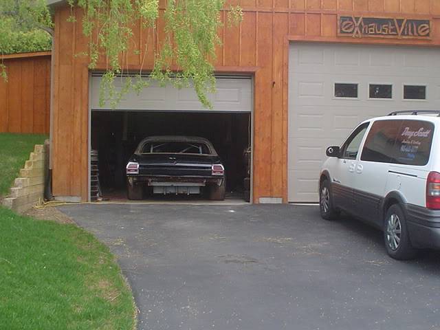

      I thought Id post a pic of it with the van in it also to give an idea how low it is compared to other vehicles.....

      last two.....see how well the top of the cage tucked up into the roof with no mods whatsoever.....I swear a pre COT Cup car is a 68 - 72 chevelle....
      next order of bidness will be to take the body back off (its just sitting there) loosely install the motor and trans and take it to Peter Gibbon's race ahop 20 mi away and have him put a roadrace set up in the (front) of the car....right now the left side (drivers side) wheelbase is 1.5" shorter than the right side so the LF fender wouldnt fit.....
      In all probability they will leave the right front alone and match the left side to it.....I have a bunch of A arms and spacers and slugs that came with the car hopefully they will be able to use them.
