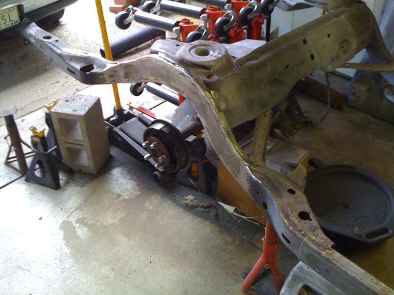

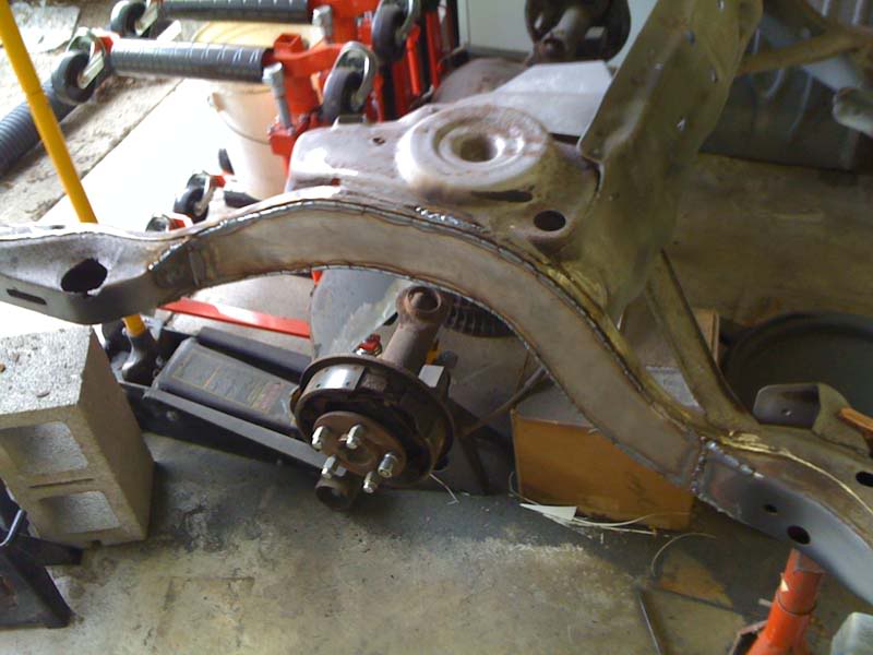

      well, I haven't had much time to work on it lately since I've been slammed at work, but I sneak in a few hours here and there. I had one good weekend where I was able to get one side of the frame notch completed.
      I went downtown and picked up a 4x4' sheet of 1/8" and a big sheet of 16 ga. use the 1/8" to make the notch panel and it took me probably an entire day of trimming and fitting to get it nice. then I pie-cut the frame where the outside of the rail tied in, to make it look more natural.
      here's the pics:
      tacked in:
      and fully welded:

      Looking good Dave! I really like how you went about your frame notch. Makes it look less like a notch and more like it came that way from the factory.
      One thing you might consider is that I was told that you should try to box in the part of the frame where you ended your C channel boxing at.
      I was told it would keep that from being a weakpoint in the chassis. I figured a little more metal wouldn't hurt.
