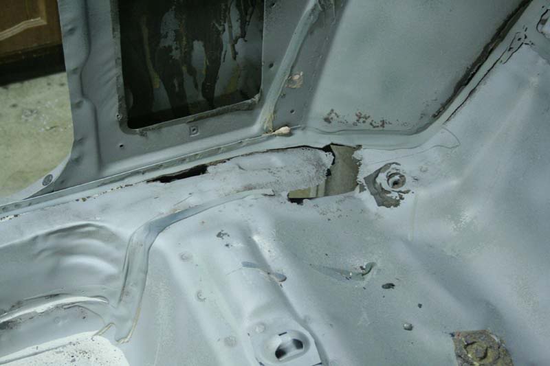

      and here's the one that made me decide to go for the media blasting. this is supposed to be a body mount, right behind the driver rear wheel
      that one will be fun to fix. I think i will probably cut out that whole section and build a box out of 16 ga that will be the body mount.

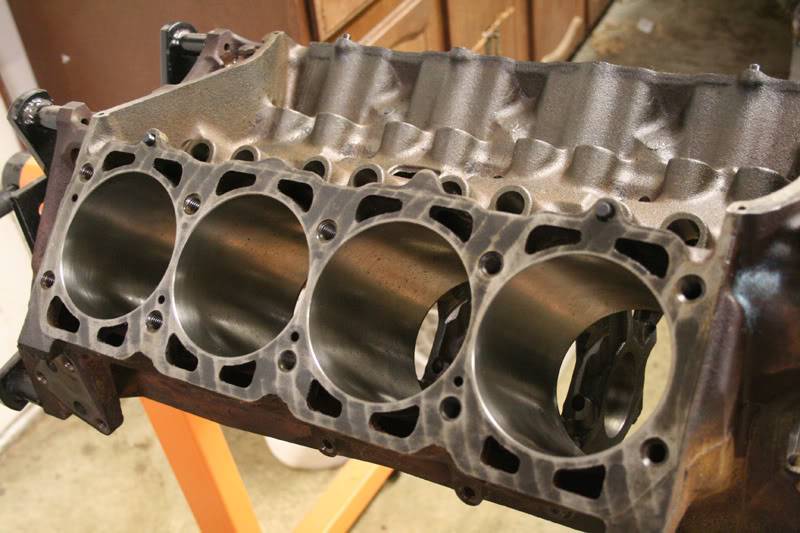

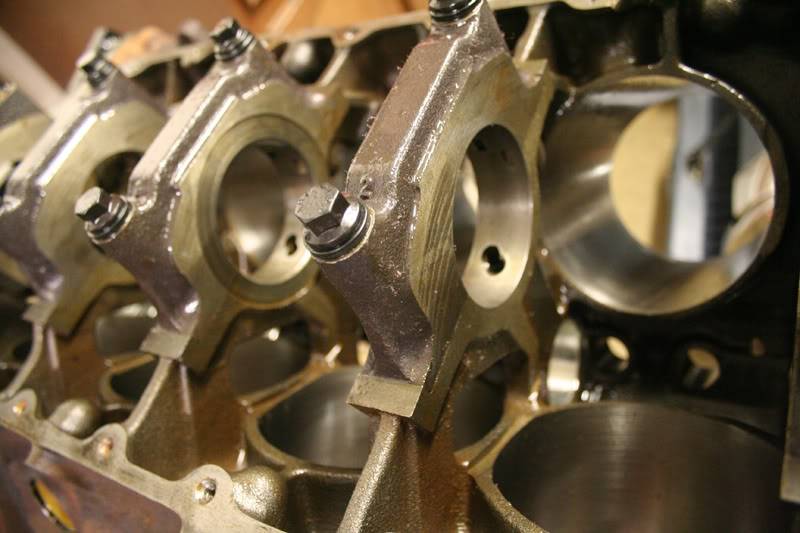

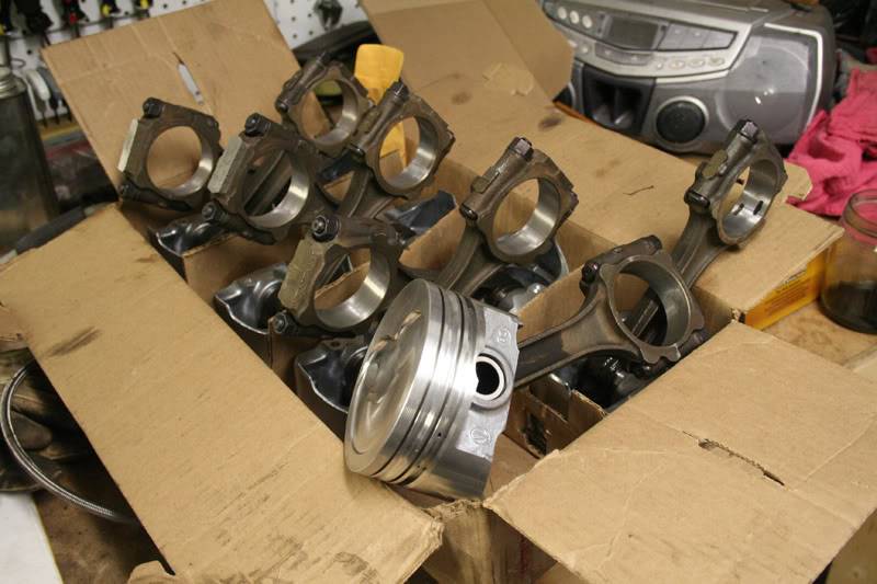

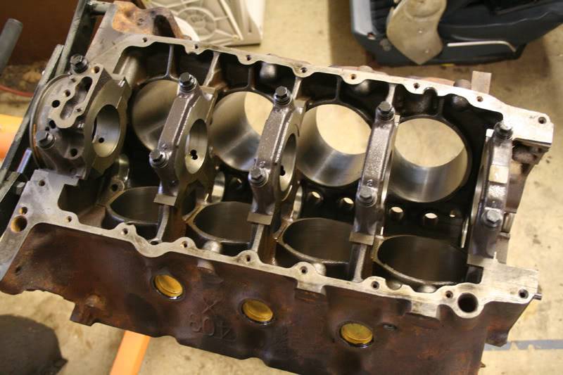

      just got my engine stuff back from the machine shop last week.
      Keith-Black pistons, special made to boost compression ratio in a 403. final comp will depend on other stuff, but normal for these pistons is 9.4:1 instead of the lousy 7.9:1 you'd get w/ stock replacement pistons. stock rods, ARP rod bolts.
      block bored out to 4.375". biggest bore GM ever made.
      ARP main bolts. crank cut 0.010", polished, chamfered oil holes.
      beauty shot:
      next up is heads, but I will wait until the body/frame is blasted and primed to do those.

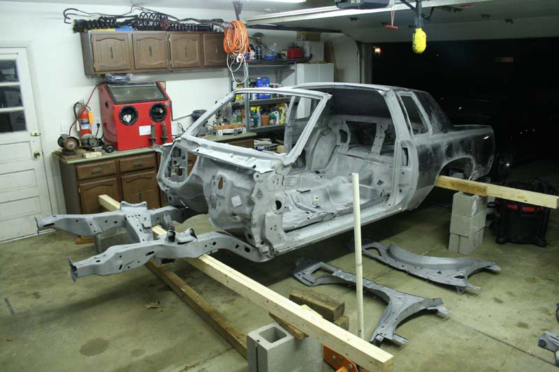

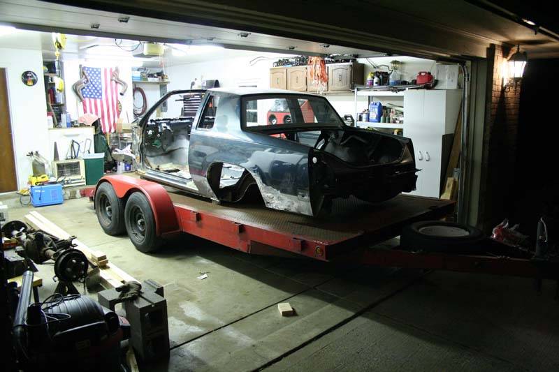

      here's a pic of the media blaster loading it. the straps are going through the rear taillight holes and the firewall.

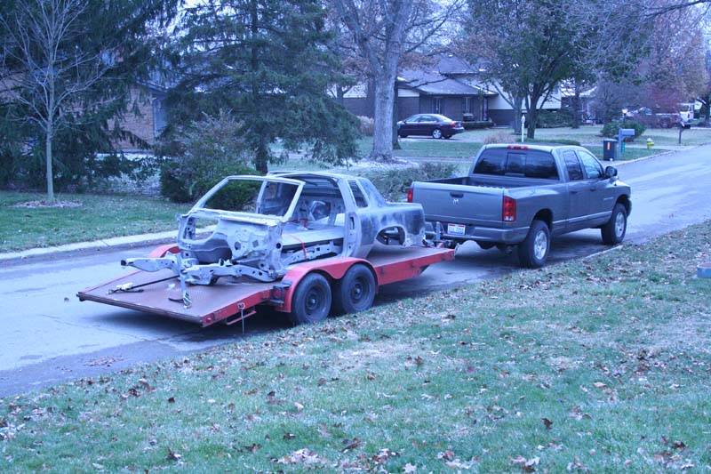

      wow. it's been awhile since an update. I spent most of the summer working side jobs to try and save up some money to put toward the project. every time I'd put some together, some other expense would pop up.
      anyway - i'm pretty excited to have some progress to report. sunday I loaded up my friend's trailer with anything rusty I could find, and monday morning (35*F and raining) drove it across town to the blaster
      Dayton Metal Prep
      they will be staying away from the flat surfaces like the quarters and roof, but going to town on everything else. after the picture was taken I loaded up the rear window w/ duct tape to protect it. he said they would probably get to it next week.
      i'm looking forward to having a rust-free project!

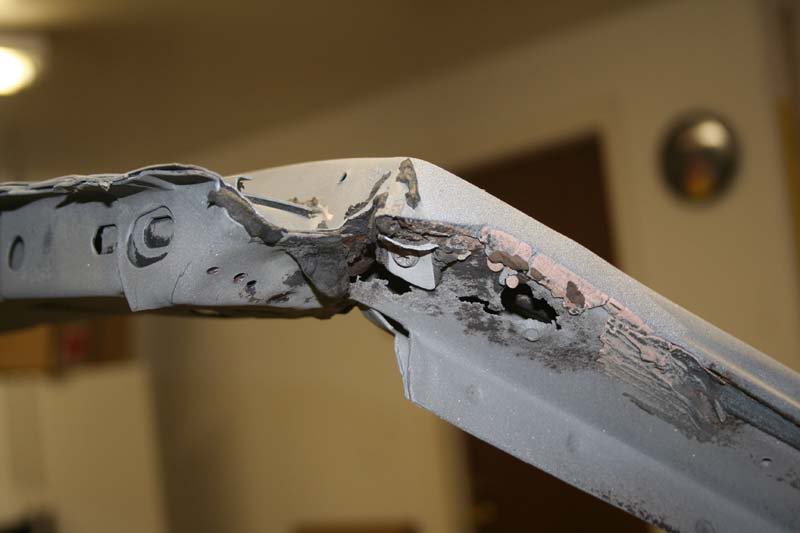

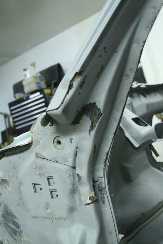

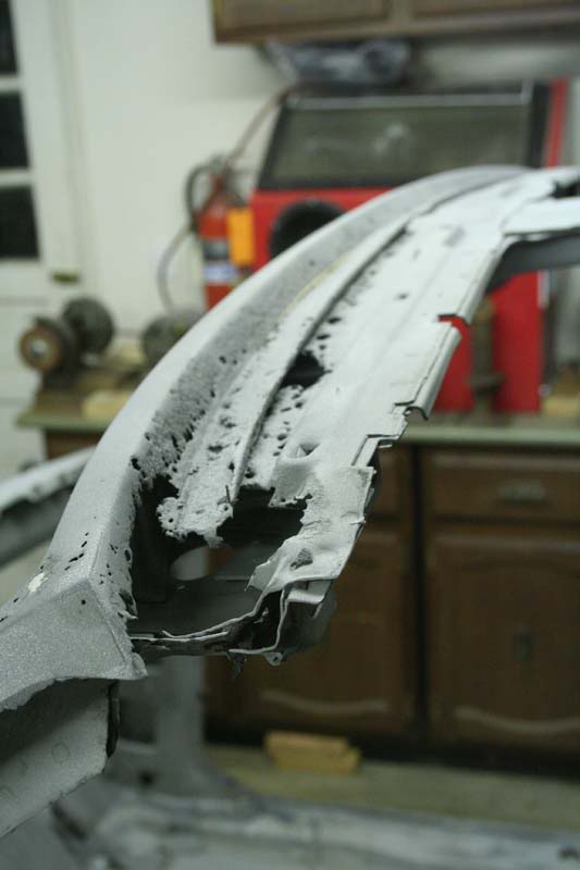

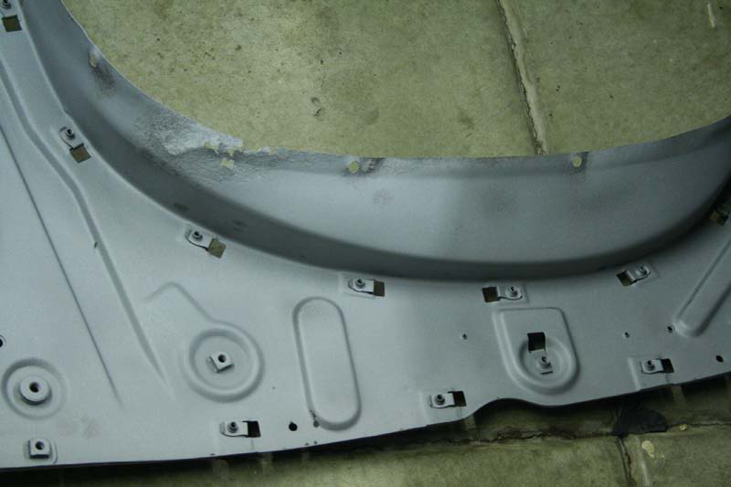

      whoops. forgot to post an update. I got all my stuff back from the blaster after Thanksgiving. outside temp was about 30*

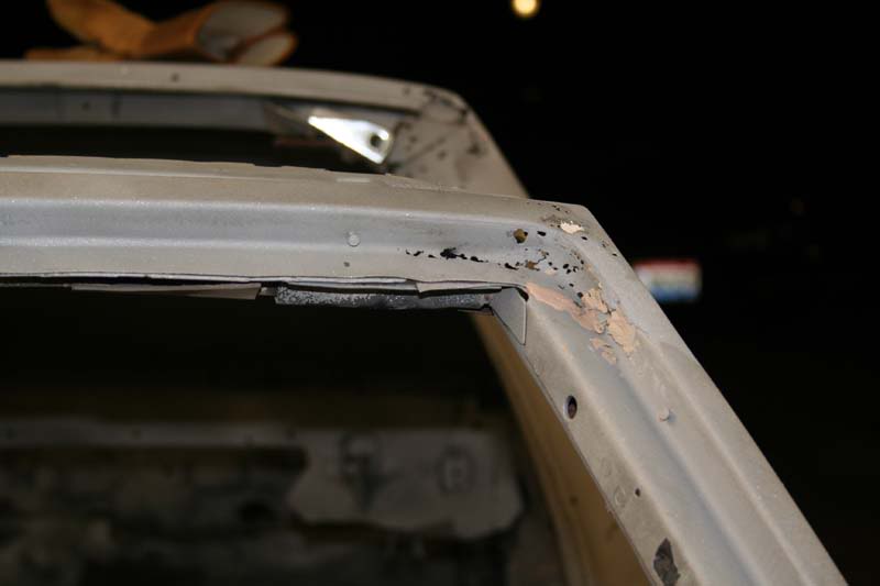

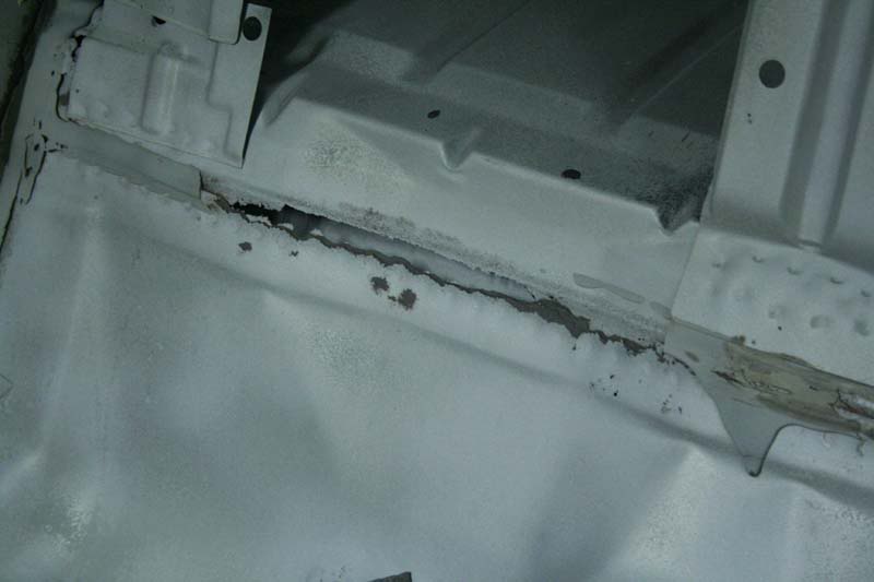

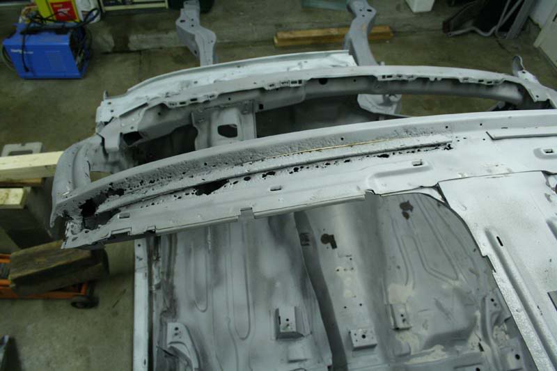

      I knew not to expect any good news from the blaster, but I've got a lot more work ahead of me than I thought. here's the gory details:
      inner fenders:
      t-tops & roof

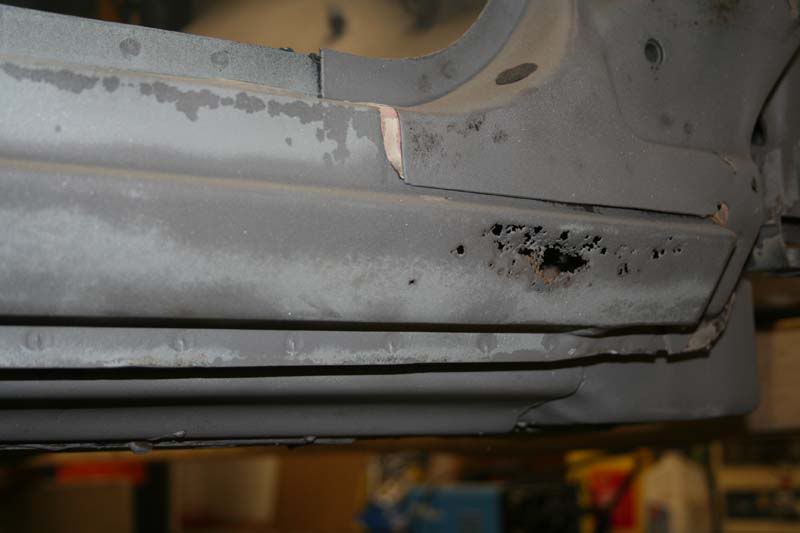

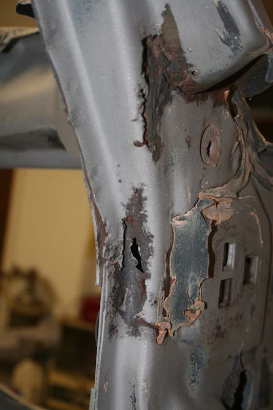

      floors:
      rockers:
      I picked up a 60gal Devilbiss compressor off of craiglist, so I'm good to go for lots of grinding and sanding.

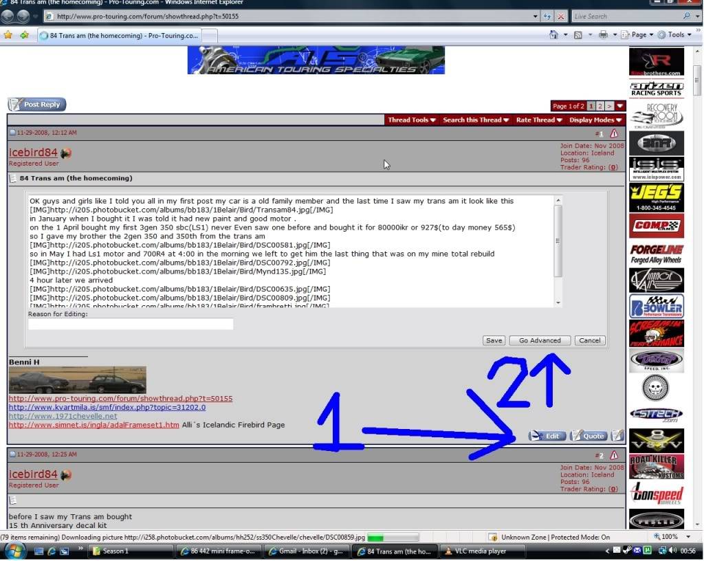

      Quote Originally Posted by jackfrost View Post
      hah. it started as a motor swap, clean-it-up sort of deal. then I discovered half the body mounts weren't holding the body on anymore.
      is there a way to change the thread title?
      go to the first post in this thread , edit it there in go advanced
