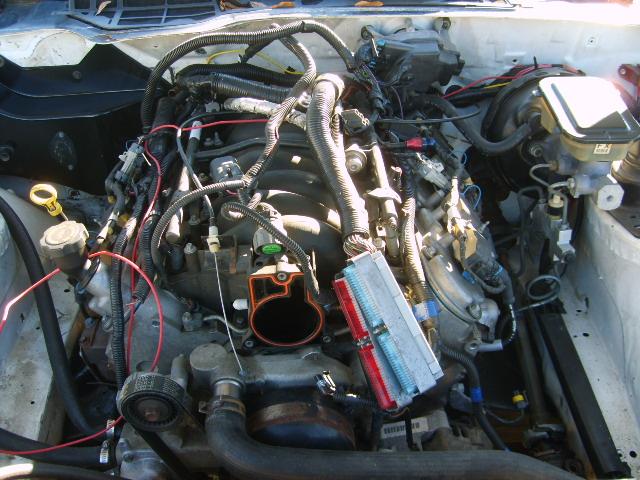

      I ended up buying this one on another forum:
      this is a ls1 conversion harness done by speartech
      they installed a fuse box,inside diag port,and check engine light,also instaled the fuel pump relay
      i am taking it out now but here are some pics of it as it comes out 450.00 shiped it is for a auto car also have 2 pcms for sale.
      I bought it even though I have an M6 setup, he said it can be used as a stand alone. I bought both pcms and the harness shipped for the price stated. It sounded to good to pass up since it was redone by speartech. I have seen just the harnesses for 250+ and would need mods so it seemed worthwhile. Can anyone give me input as to using this on my LS1/T56 setup?
