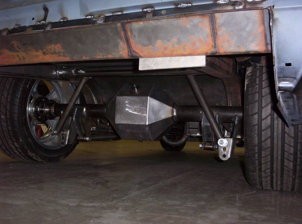

      The frame is based on AME 4 link rear w/c5 front.
