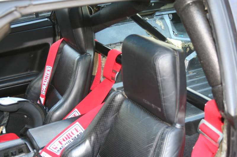

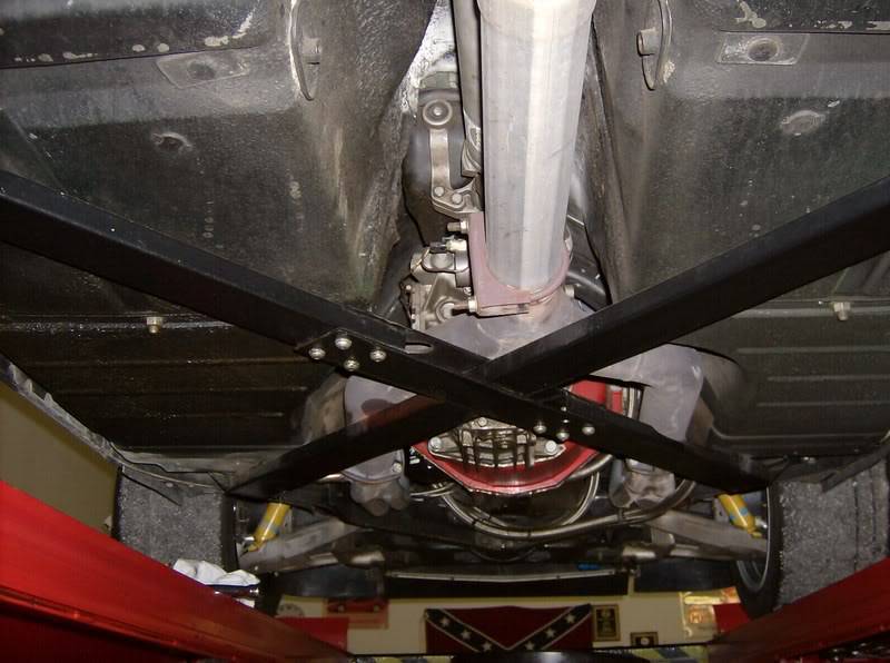

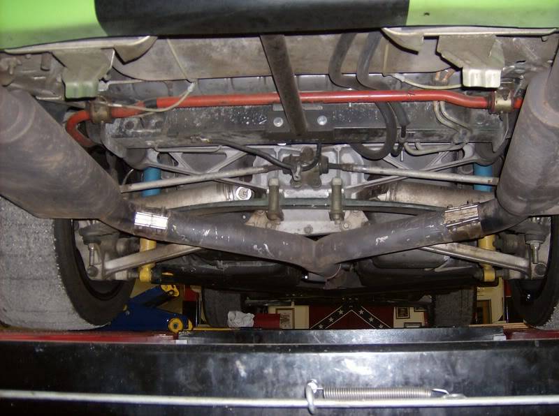

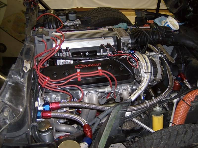

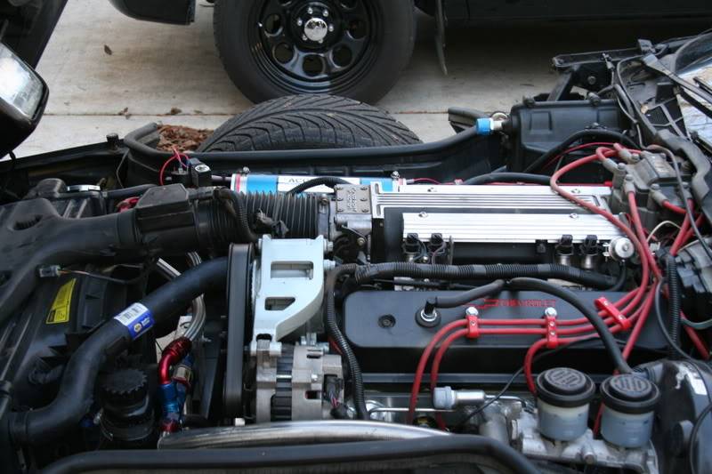

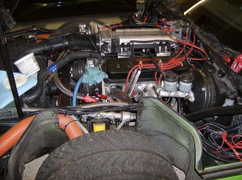

      i figured that this is kind of pro-touring (well, in the extreme at least). started out as a stock 88 vette that we picked up from a guy in raleigh for 5000. fixed what was broke at first, and started tracking it with the stock brakes, stock motor, and that horrible 4+3 tranny. we rebuilt the suspeinsion with bilstein shocks and poly bushings, added C5 front brakes, and headers/exhaust/miniram intake. raced for another season until we spun a bearing. then built a STOUT 383, swapped in a ZF six speed, added a four point bar, and ran it some more. wound up cavitating the oil pump due to cornering loads and eating another couple of bearings. so the motor came out again. as well as the interior. and everything not needed for NASA time trials and DE.
      the current version, after two motors, two dry sump setups, etc, is:
      dry sump 383 stroker, TPI based mini-ram induction, full exhaust. made around 430 WHP at 100% duty cycle on the injectors. currently adding bigger injectors.

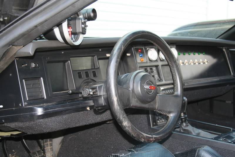

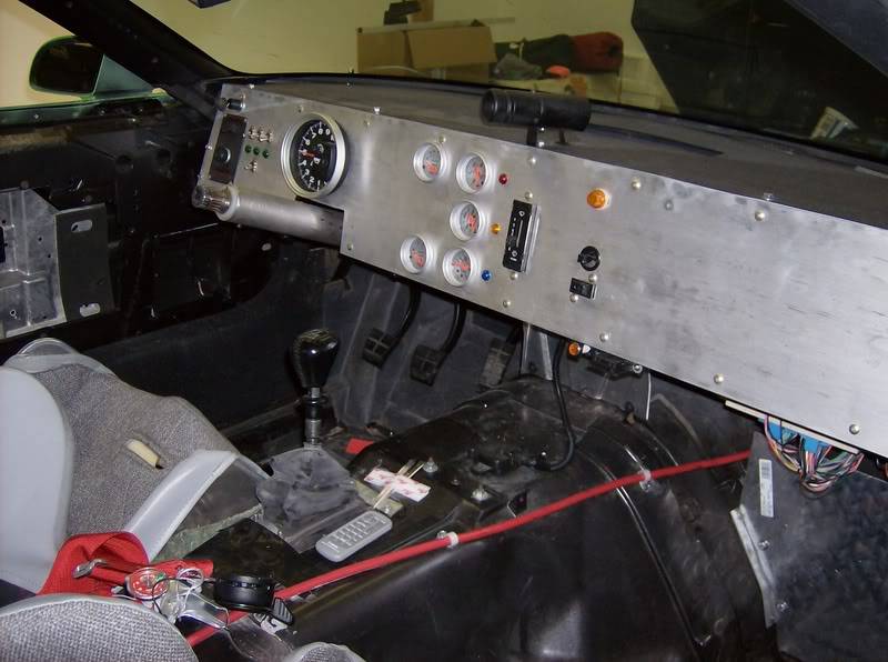

      full aluminum interior, all ultralight gauges with standalone warning lights, kirkey seats, coolsuit, and data acquisition system.
      Z51 springs, VB&P offset bushings, custom uppre control arm spacers, Z51 sway bars, revalved bilstein shocks, Kumho slicks

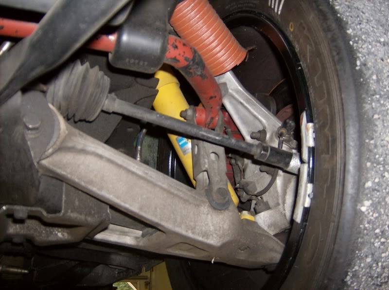

      C5 front brakes with cooling ducts, wilwood H pads, stainless lines

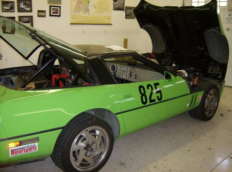

      Kawasaki green paint, ZR1 wheels. Chassis bracing, motor plate, custom wiring harness (retaining power mirrors and ABS!).
      dont know how pro touring this is, but i thought id share what i'd built. and the cool thing is, my father is the one that drives it. hes turning 64 this year. and now he wants to buld a northstar powered Locost...

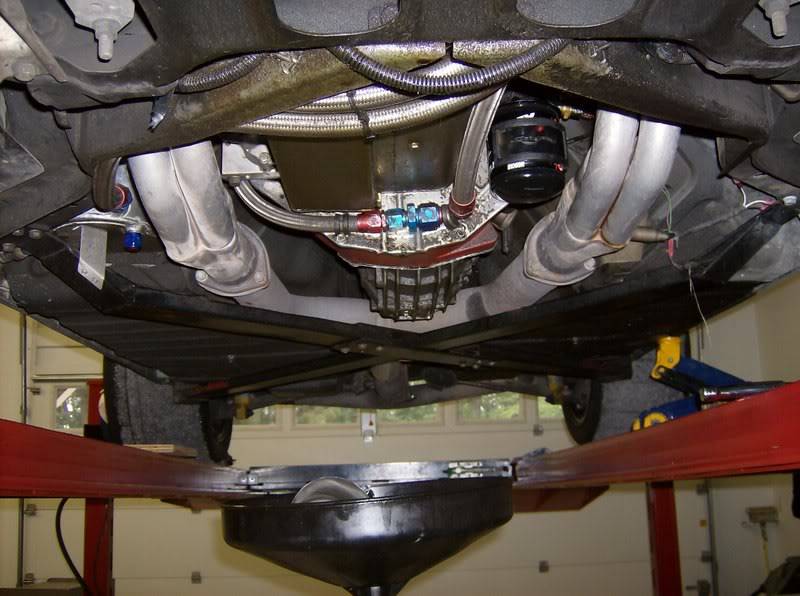

      That sounds like a pretty mean Corvette... I often wonder if I should convert to a dry sump oil system considering how hard I take the turns... I haven't killed any of my other cars yet but knock on wood I suppose... I wouldn't know where to begin though... any pointers???

      Wow. I've spent many hours in class thinking of building a road race c4. Very cool.
      Oh, and what happened to the number one cylinder? Looks like it went ridiclously lean or some oil cought fire on the outside of the tube.

      i would not recomend you go dry sump unless its absolutely necessary. tearing down the block to do the required modifications/machining is the cheapest/easiest part o the conversion. you dont even want to know how much we have in it.
      as far as the #1 cyl, it didnt burn. we actually had to cut and rewelt that section of the header to clear the dry sump pump. we never recoated it, hence the reason its ugly.

      Why are the tires mounted in the wrong direction,never seen that before.

      I love the front brake venting...
      So the questions I have,
      1) What is the remote for?

      1) remote is for the camcorder. we tape events to evaluate driver performance

      I bet it's simply because those are the street tires for moving the car around. Don't want to risk damaging the race slicks away from the track.

      exactly. sorry, i forgot to answer that question. theyre just rollers, never driven on (unless its to break something in an the roads around the shop.
