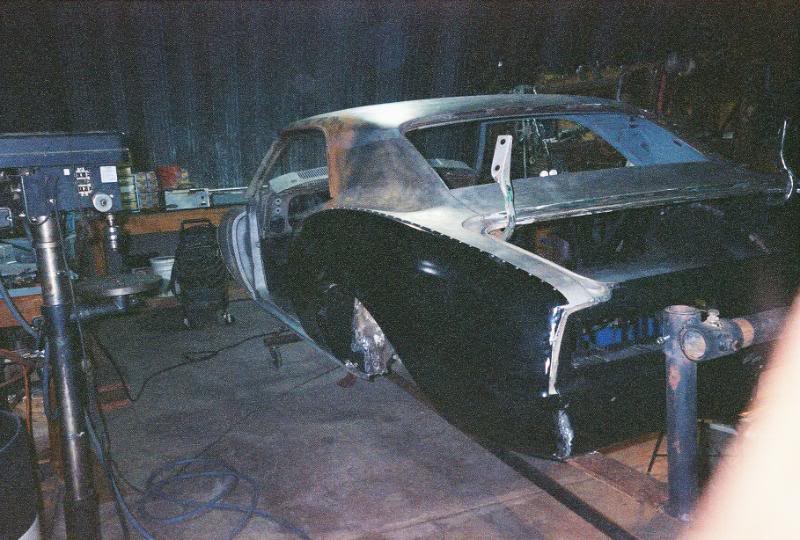

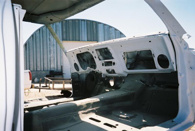

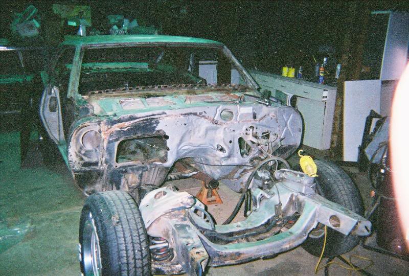

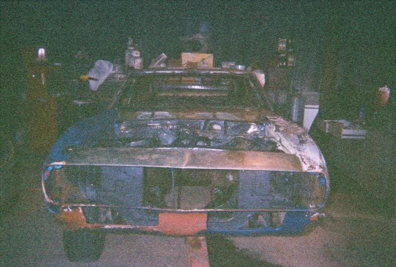

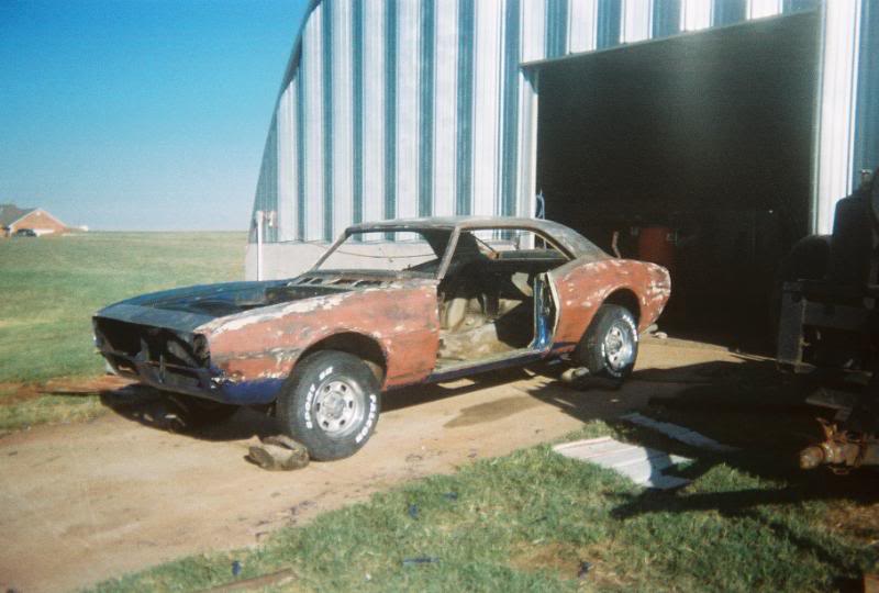

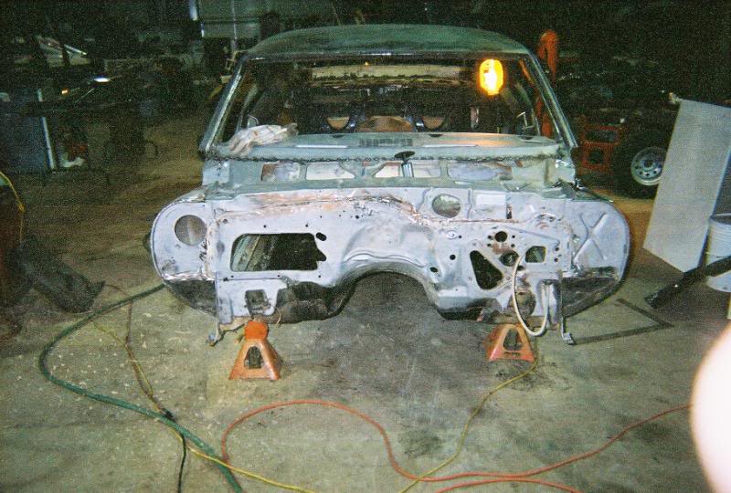

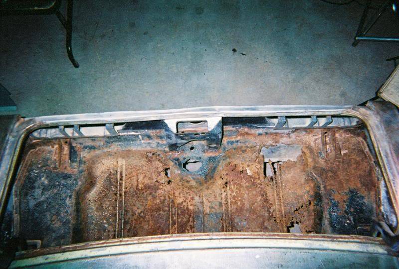

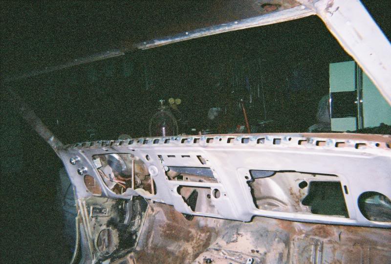

      The teardown:

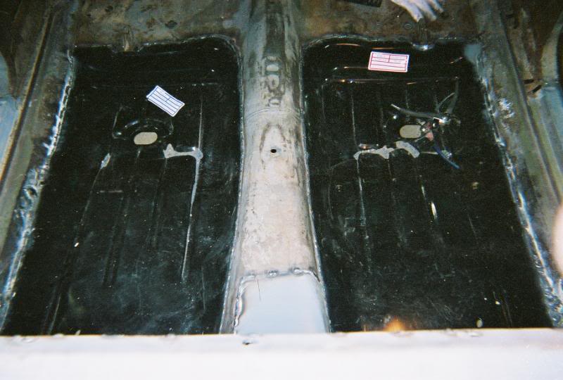

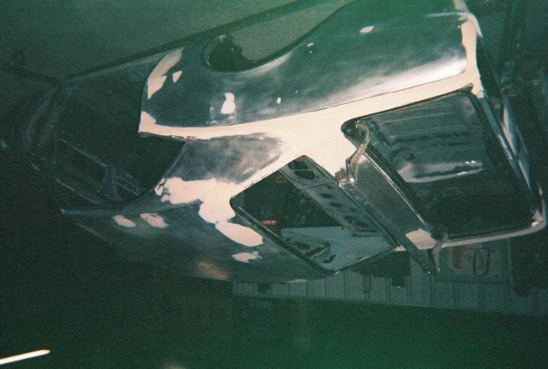

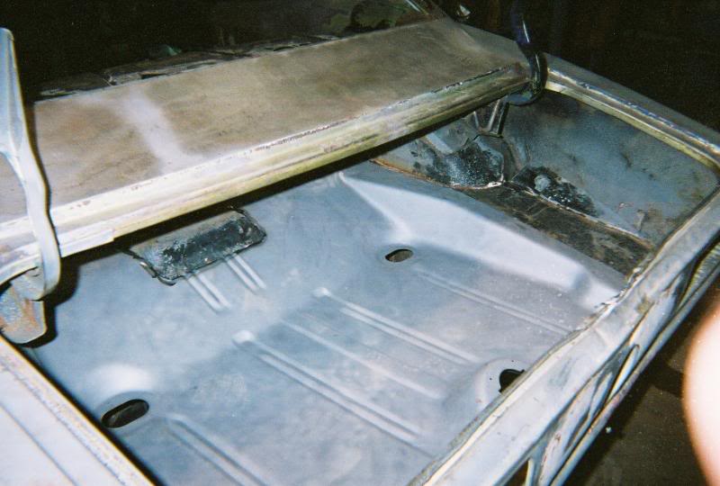

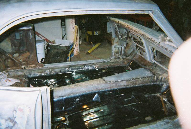

      The sheetmetal Work: My father helped me and I learned how to mig!

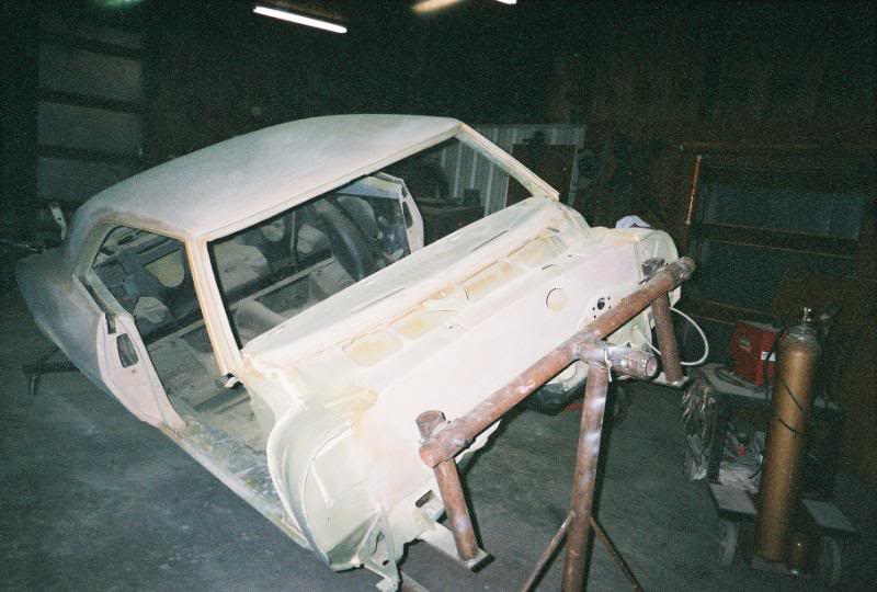

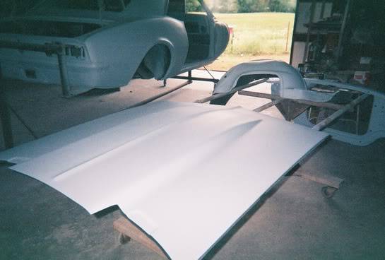

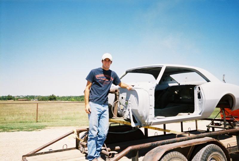

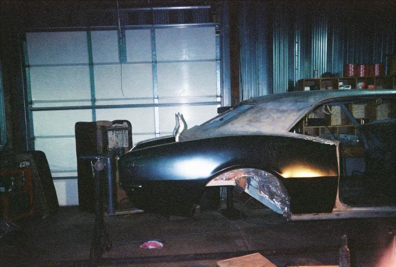

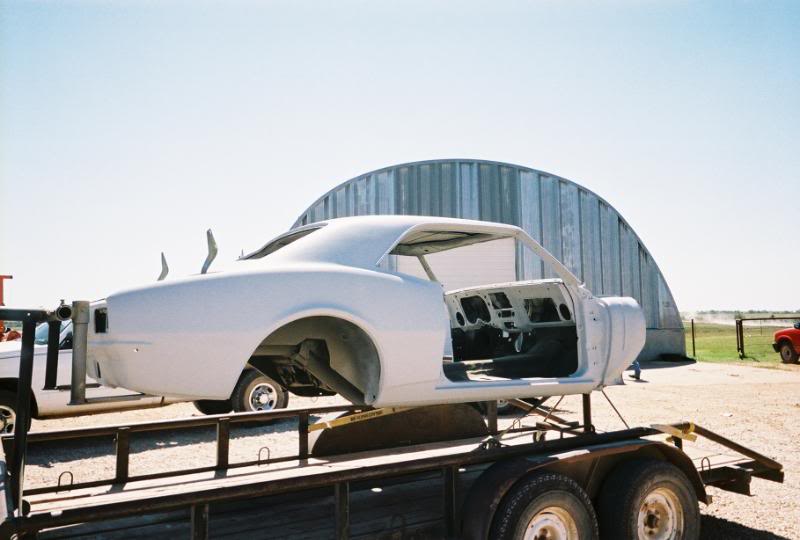

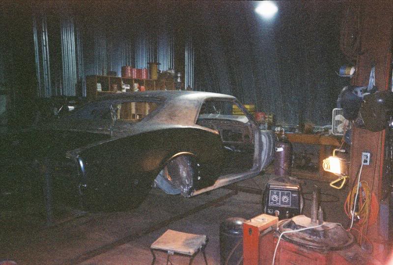

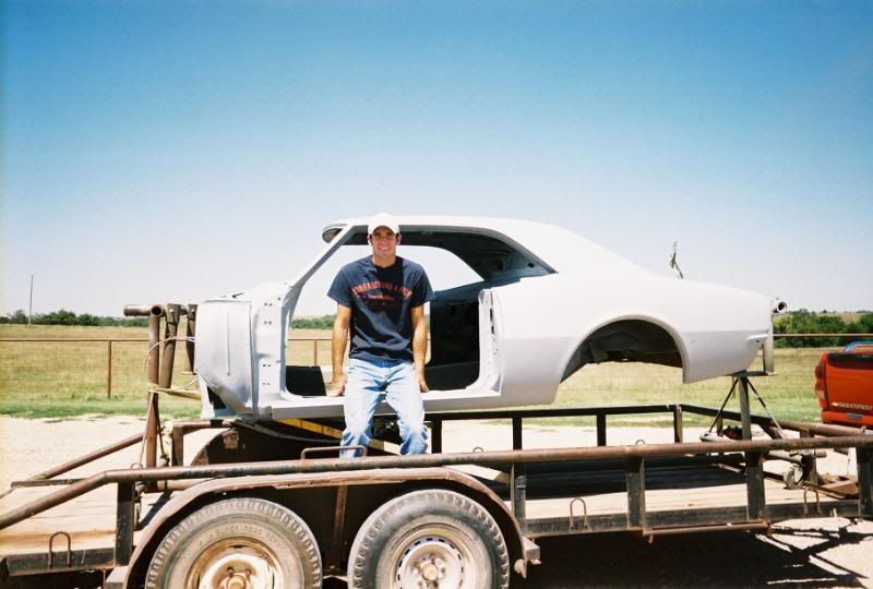

      BODYWORK Begins!
      The Day she came home from my friends shop who helped me with the bodywork. I drove 3.5 hours in from school to come per up and check it out.

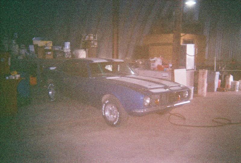

      Pictures of my old wheels and before the 3" drop front and rear springs: These are sold and once Vintage wheel works starts the production of 18" V40's, my car will have a a new set of shoes!

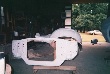

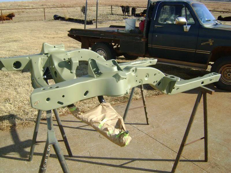

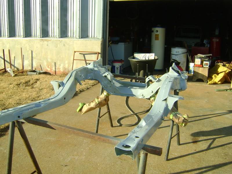

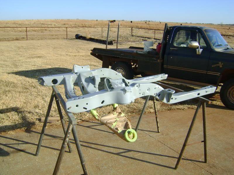

      Well today I got some work done on the frame. I had already assembled and painted the frame once before and it looked good, but I didn't like the gloss black and I found a hairline crack in the frame.
      I blasted it back down, rewelded all the seams and then smoothed it out. I shot a coat of etch primer today and then sprayed some gray primer this evening.
      I should have done some close up shots, but this is where I am at. I decided to tape off tubular arms and leave them installed so I didn't beat up the frame re-installing them.
      More updates soon...it has been awhile since I have added anything!

      Hey Andrew, the subframe looks good! You'll be done in no time....Well at least probably before me anyway. On the frame where the body mounts sit, the holes on mine were rusted out quite a bit and I had to buy the patch panels and weld them in. I do have mine back together finally and got the motor and trans sitting in it, but that's about as far as I've got. At least it's all finished, now on to the rest of the story. looking good keep us posted!

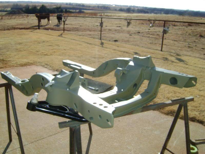

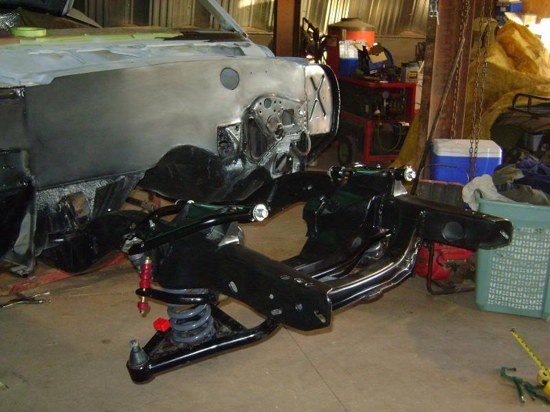

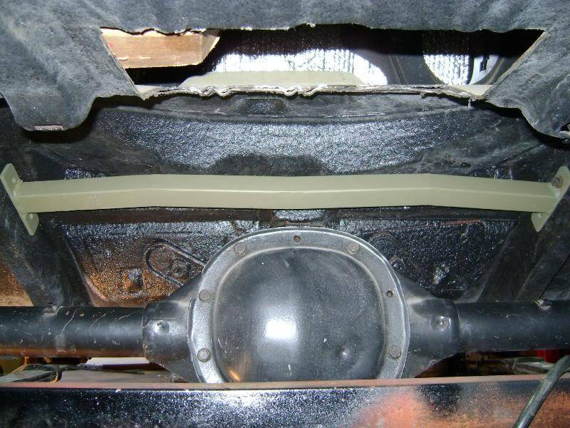

      Update on subframe and rear frame rail brace
      Yesterday painted the frame. Today I assembled some of the parts. I shot a coat of etching primer on the hubs, spindles, and tie rods today. I will try and get those painted next week. Next, I will finish assembling the C5 brakes on the front.
      I also built a rear frame rail brace.
      I shot a coat of primer, but it will be painted black and reinstalled. (The hole in the trunk pan if for my caprice tank fuel pump access)
      I will be building some homemade subframe connectors next (bolt in style).

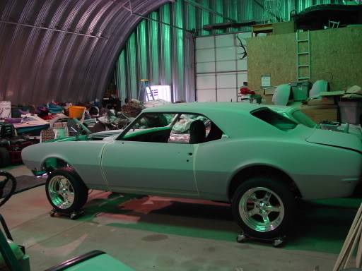

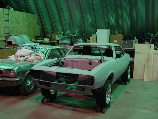

      well here are some pics I took last week. I have everything except the doors and hood on now. What do ya think of the 4x4 ride height. can't wait to get the 2" drop leaf and coils on. I am excited to see her finally coming together.
      -Andrew
      '"4x4 ride height"...Lower that thing before you take credit for building the first "Pro-Donk". Not that there'd be anything wrong with that! LOL. Anyhow... your car is looking great! Go Go Go all the way to the finish line!
      OK
      767
      Quote Originally Posted by venturabeachpup View Post
      A lot has changed since that picture! The stock springs/suspension and 17" wheels are gone. I have hotchkis coils with coils removed are in place. A lot of work left but it is getting there little by little.

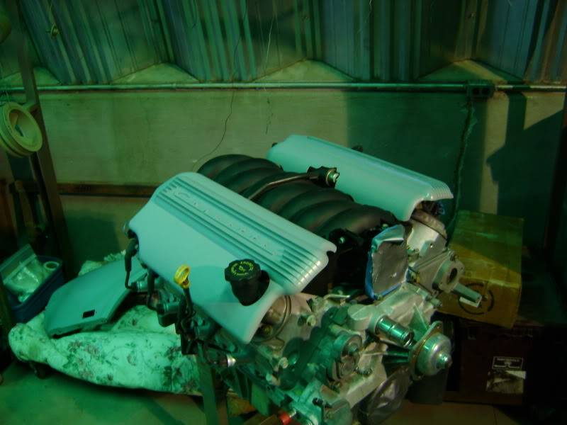

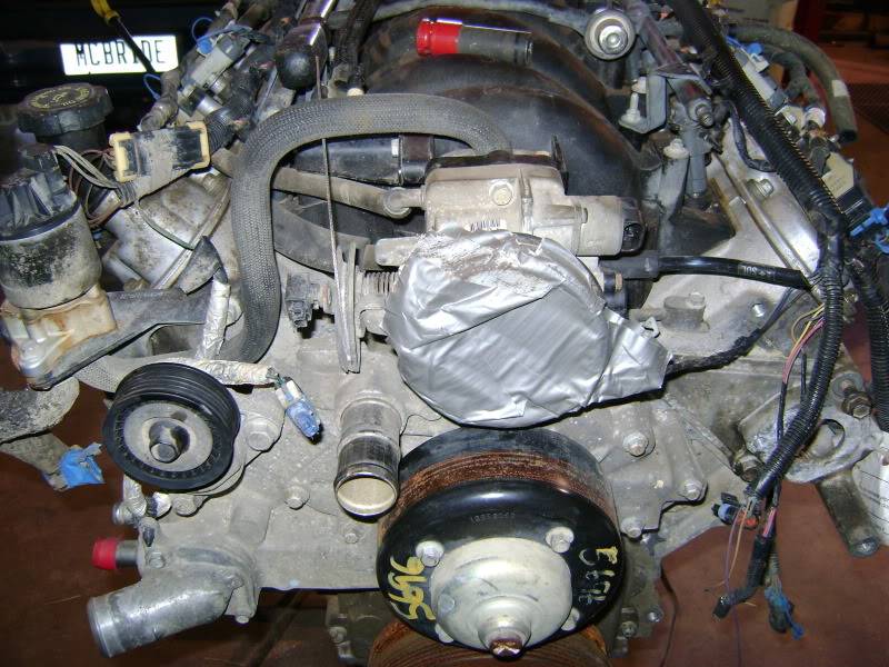

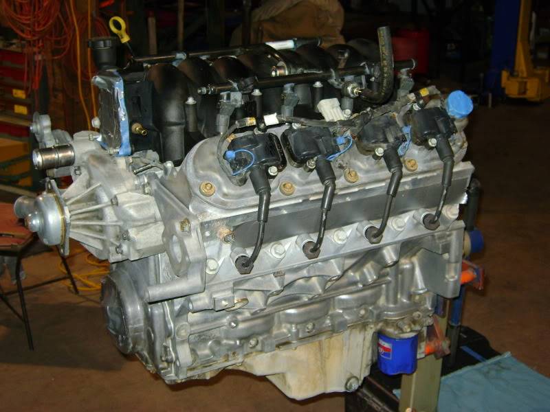

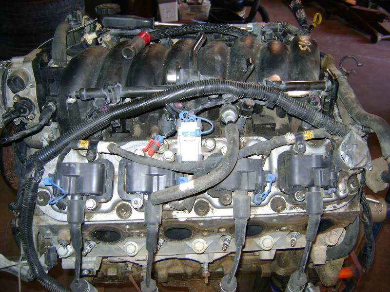

      A few small updates. Bought an LS1 from a 98 Z28 w/ 68K. I always wanted an LS1 and now I got one! The wife helped me tear the motor down and we got it back and reassembled in a weekend. Looks to be a solid motor.
      Plans for the motor:
      new cam
      LS6 intake
      ported LS1 throttle body
      paint the block, heads chevy orange.
      paint the stock f-body accessories black
      paint the LS6 intake a cast color
      I am also going to run the corvette fuelie style fuel rail covers and they will be orange w/ silver script on them. (kinda an old school theme)
      Long tube headers (undecided)
      homemade motor mount plates
      f-body oil pan modification-got a friend at a machine shop going to do this.
      cold air intake
      Here is a before an after photo. We still gotta a little more work to do to get it to pass my OCD scale.
      Before:
      After:

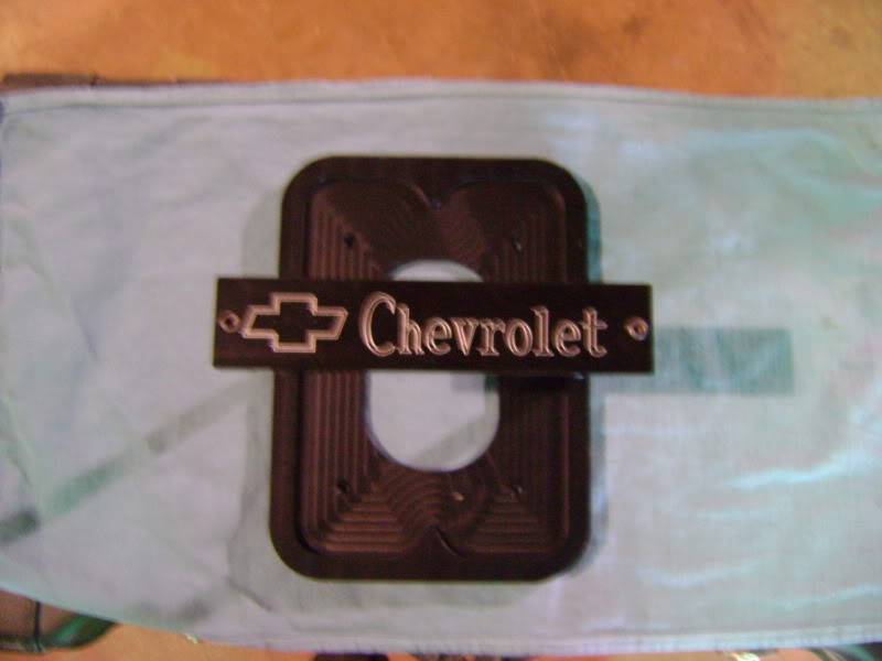

      I also picked up this battery tray from a guy off of ebay that is custom making these: pretty cool I thought and not bad for $45

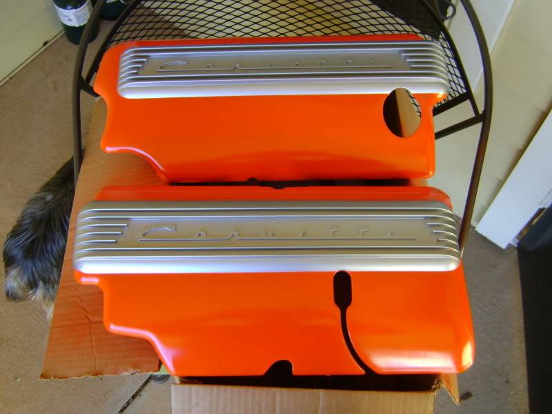

      Here is another small update. I painted the LS1 block chevy orange, painted all the bracketry & accessories a low gloss black, and painted the fuel rail covers.
      I am thinking about painting the "corvette script" orange also, but I like it silver too. What do you guys think?
