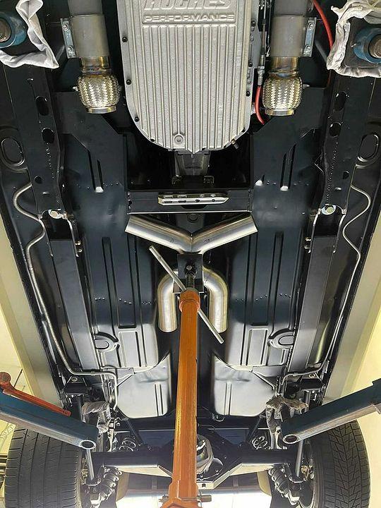

      I just got some pictures of the work on my exhaust, he made an X pipe to fit around the 4l85. This trans is a lot longer than a turbo 350 Here's a few pictures.
      Here are a few pictures of it where the X pipe is going on the car.
      This has me concerned. I'm planning to have the exhaust coated, I don't think they can do anything for the the flex coupler. I'm going to make a heat shield if there's room, I'll also put heat shield over the trans cable.
      Some of his TIG work.
    11. #651
      Nov 2018
      1,004
      I like that, built in driveshaft loop. If the U-joint pops it'll bang around but you won't high-jump through the air.
      Also, those flex pipes don't have to go there, they just have to be somewhere between the engine and the first solid exhaust mounting point on the body/frame. You could move them a foot or so further back and put a thinner coated pipe where those are now. You'll get more clearance for the heat shield for the trans lines that way as well.

      The X pipe necks down to a little over 3" so I talked to him and he's going to make one that is bigger at the X to increase flow.
    15. #655
      Sep 2009
      3,012
      Good move. I was thinking that when I saw the post, but figured that guy must know what he's doing. It's a shame because those welds look amazing.

      Here's some shots of the exhaust completed. Better a little late than never.
