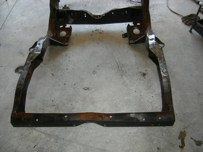

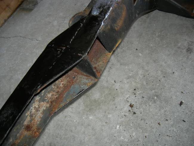

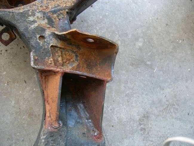

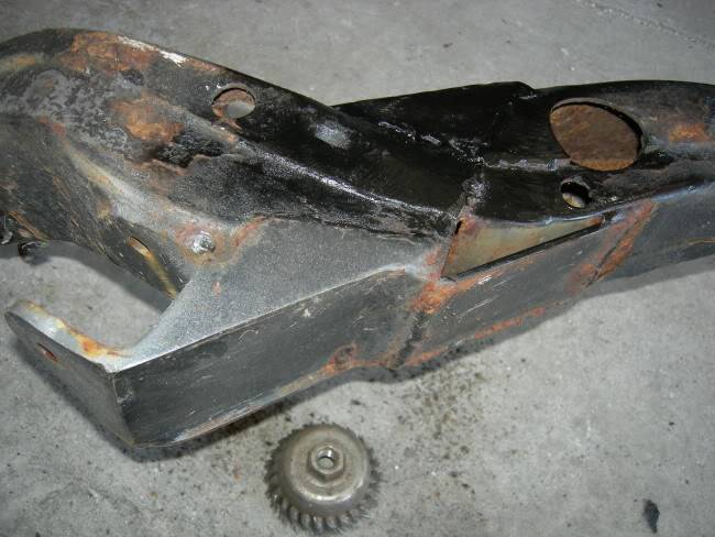

      I Don't have a project name for it but I do have info and pics on it. This is my 1965 chevelle I got from my father he bought it brand new in 1964 so it sat at the coast for 30 years for reasons but that just means I have a lot of work to do. so here is the frame I welded some gussets for the front LCA for streng in the rear I did some boxing and moved the frame Rails in 2.25 inched for my mini tub.
      the frame is upside down as I do some last grinding on it.

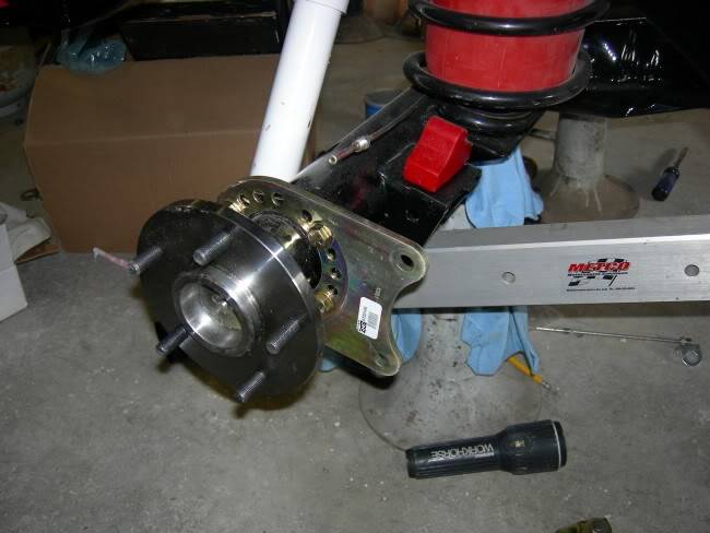

      This is a pic the The Rear end in place with the summit rear end griddle. And my Metco Upper and lower Trailing arms

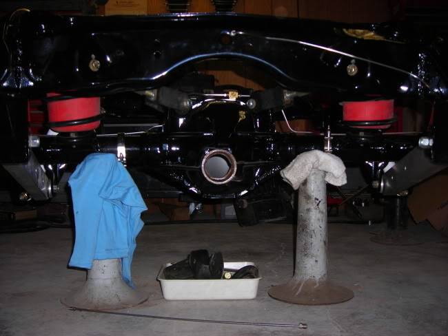

      SO a few days Later I decided to install my SS brake lines and my SS fuel line with my Rear air bags and eibach springs and shocks

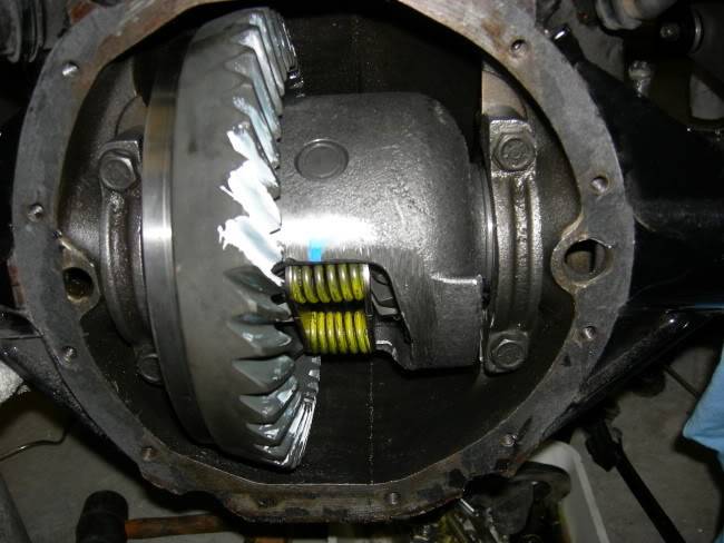

      Then figured it was time to get that rear end together now from my mini tubb I also had to cut the rear end down and did it successfuly. My rear end contains richmond 4.10 gears,eaton 3 seiries posi,moser 30 spline alloy axles,ratech install kit, toped with a moser 1350 yoke

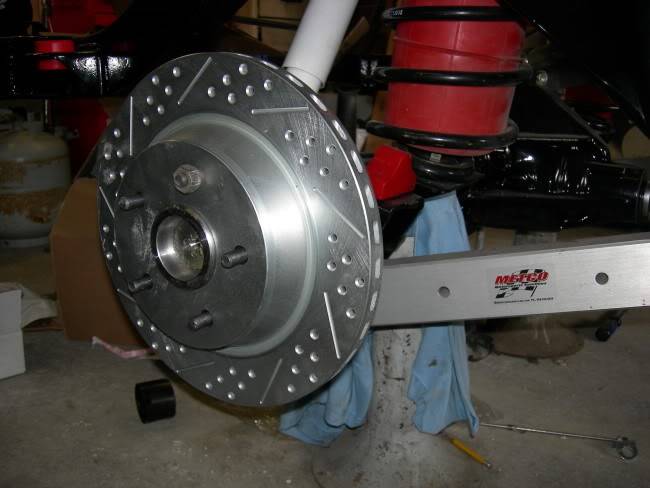

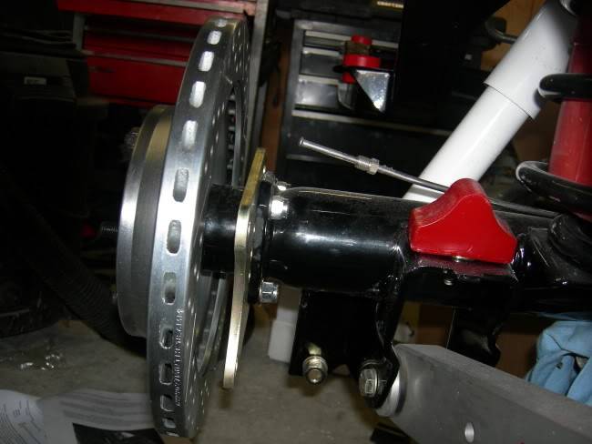

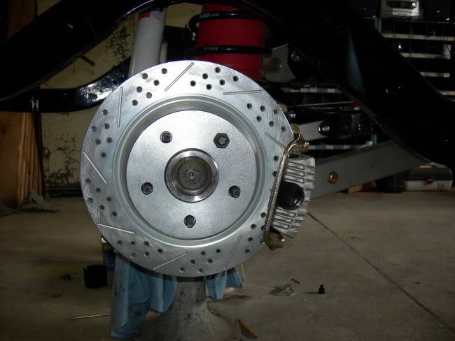

      now for the last part of my progress The rear brake are on but I have no money right now to put front brakes on and wheels and tires all around. I got the body in the garage and started taking out the bad parts and going to also finish up my mini tubb.
      sorry frame is a little dusty

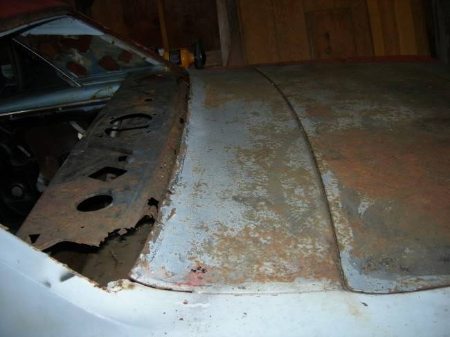

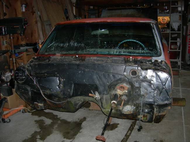

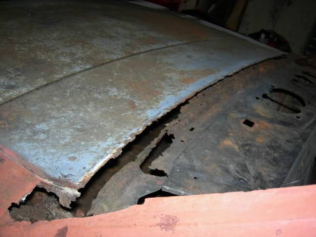

      And here is the body I currently have a rust primer on that will stop any rust so thats why it is red.
      their is some of the damage
      Ouch!!!

      very sweet build, looks like you are doing it right.
      what brakes are those? looks like touring classics?
      May 2007
      Eugene Oregon
      293
      Quote Originally Posted by HotRod68Camaro
      Yeah they are baer 12" touring. I am doing my best to do it right
