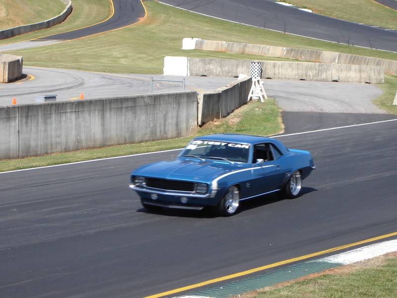

      A few pix I shot Sat. at Road ATL.It was great meeting everyone and seeing the cars up close.

      Nice pictures. Anyone have any track pics?
      ~Ryan
      ATLANTA, GA
      337
      I'll have a few as soon as my bro emails them to me. You'd be surprised how hard it is to take pictures and drive Road Atlanta all at the same time.
      103
      Thanks for the pics

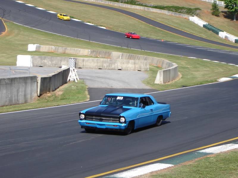

      I was sure digging the track time. I only got to run one session: I was black-flagged due to so-called exhaust noise. They have a noise ordinance on Sunday mornings. I think I took the fall for the silver 2nd gen Camaro that ran behind me in our group.
      But ... while we were on the track, we passed three other groups and were the fastest of the B groups. The best laps were when I got to follow the pace car. I think he was skeptical that a Chevy II could keep up with him. No problem.
      I was a little weak in the S-curves because I wasn't sure of the line, but otherwise the car didn't use the whole track, and I felt like I was about 80% of the car's capability. That's with it on the street suspension settings. I've yet to try out the race settings.
      I need to improve the brake pedal linkage, orient the brake bias more to the front, increase the rear stiffness, and add a power steering cooler.
      There's an event at Sebring here in Florida I'm hoping to run in August.
