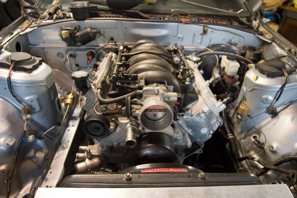

      Many of you know that I had an 88 RX7 with an LS1. Many of you also know that back in NOvember of last year I wrecked that car. So a few months ago I picked up the replacement. I stripped the old car of everything that was salvagable and I am slowly transfering it to this car.
      This car is an 86 GXL. The stock hood has been replaced with an aluminum hood. The rear suspension and differential have been extensively tweeked. The stock diff is gone and in its place is a diff from a 2004 Cobra Mustang with custom halfshafts. The interior is going to be stripped from the seat back. The engine will be the same as before but with a slightly bigger cam and long tube headers. I am hoping for around 400RWHP. It made about 375RWHP before.
      With any luck I should have it up and running by the end of the month.

      Busy morning and early afternoon so far.
      Install the flywheel and torque to 107 lb/ft in a star pattern:
      Clutch cover, flipped upside down:
      Pressure plate added making sure everything is ultra clean:
      Then the disk:
      This is what a real clutch alignment tool looks like:
      Alignment tool inserted. Disk lined up. Clutch cover tightened to 24 lb/ft with a dab or red locktite:
      All done. The whole assembly with the flywheel and clutch is about 22 pounds:
      After installing the clutch I double checked my setup height to make sure that the throw out bearing was in the proper position. Everything looked great. Transmission was attached to the engine and the engine is in the car. I will take more pics later.

      Engine and trans are in.

      I just bled the clutch and the pedal feel is awesome. With the small 5/8" MC I can push the clutch pedal with my hand. I also did the release test and it perfect. I bearing is about .170" from the spring. I am very pleased so far.
