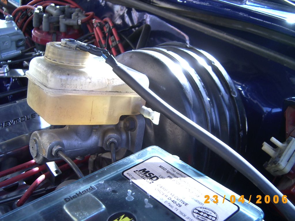

      take a look on my mastercylinder in my Camino.
      the master comes out from a BMW 750il with 25mm bore and the right stuff for rear disc breaks
      the double membrane brake booster comes from a BMW E34 series.
      i close my mouth for breaking
      greets
      Klaus
