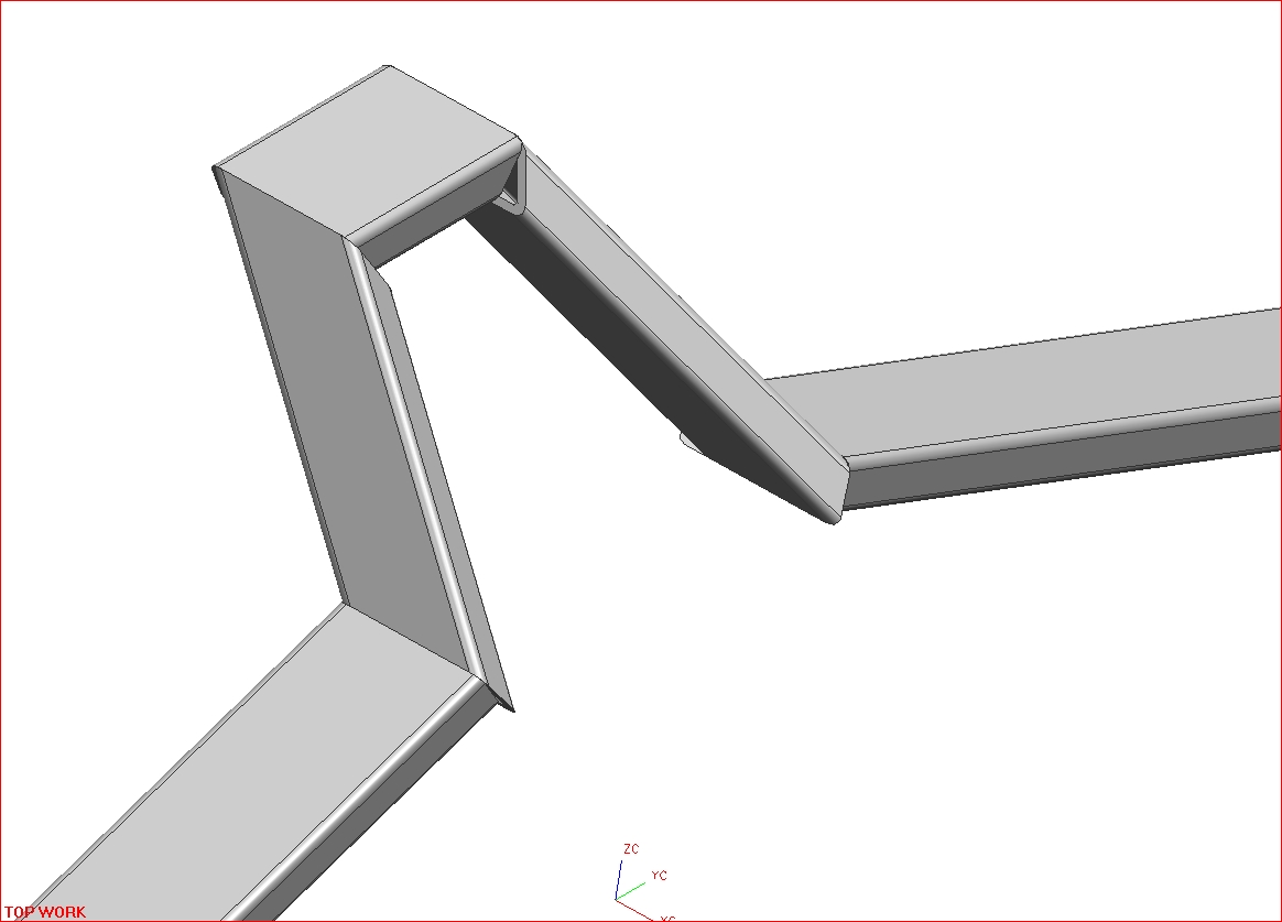

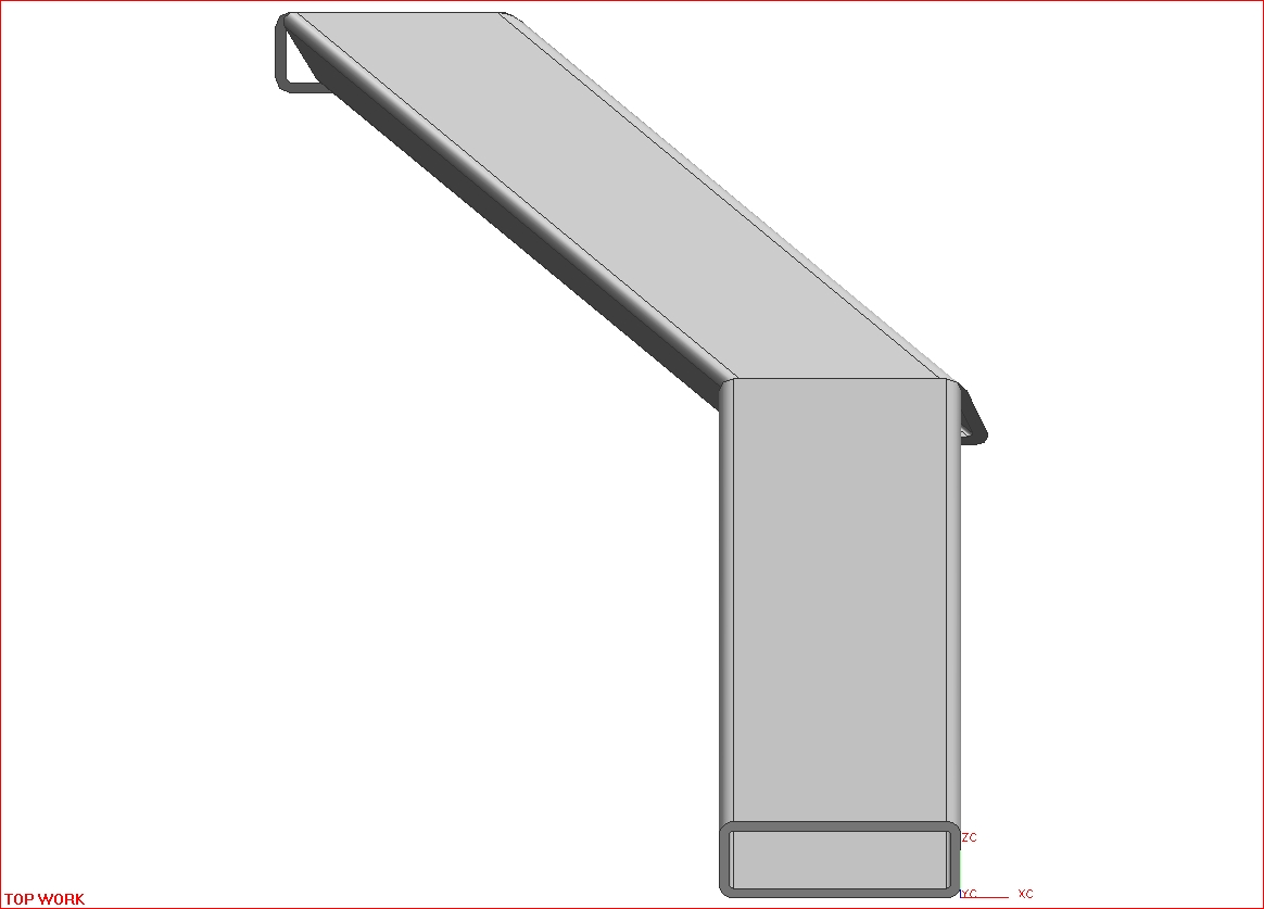

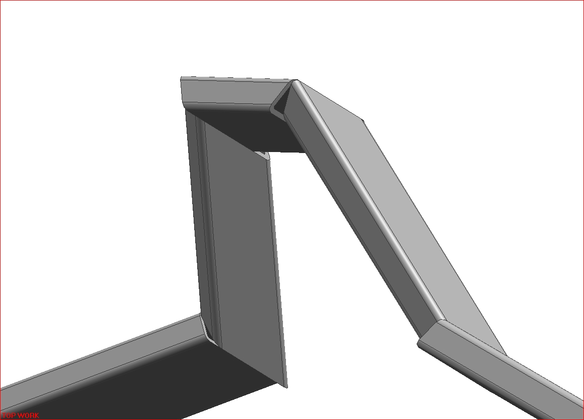

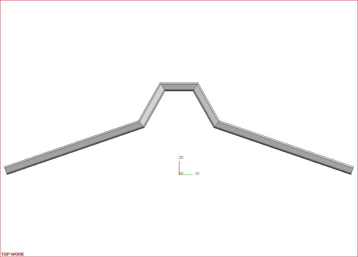

      Okay Matt, I did a quick design study this morning using the dims you gave me in the PM...
      TOP VIEW
      REAR VIEW
      SIDE VIEW
      CLOSE UP OF OVERHANGS
      CLOSE UP OF UNDERCUTS
      You can see a lot of over hanging and undercut corners with this design. Of course it could be done by hand fitting small pieces into the undercuts and trimming the overhangs and fitting small pieces there. That is a lot of hand fitting but you could make it work.
