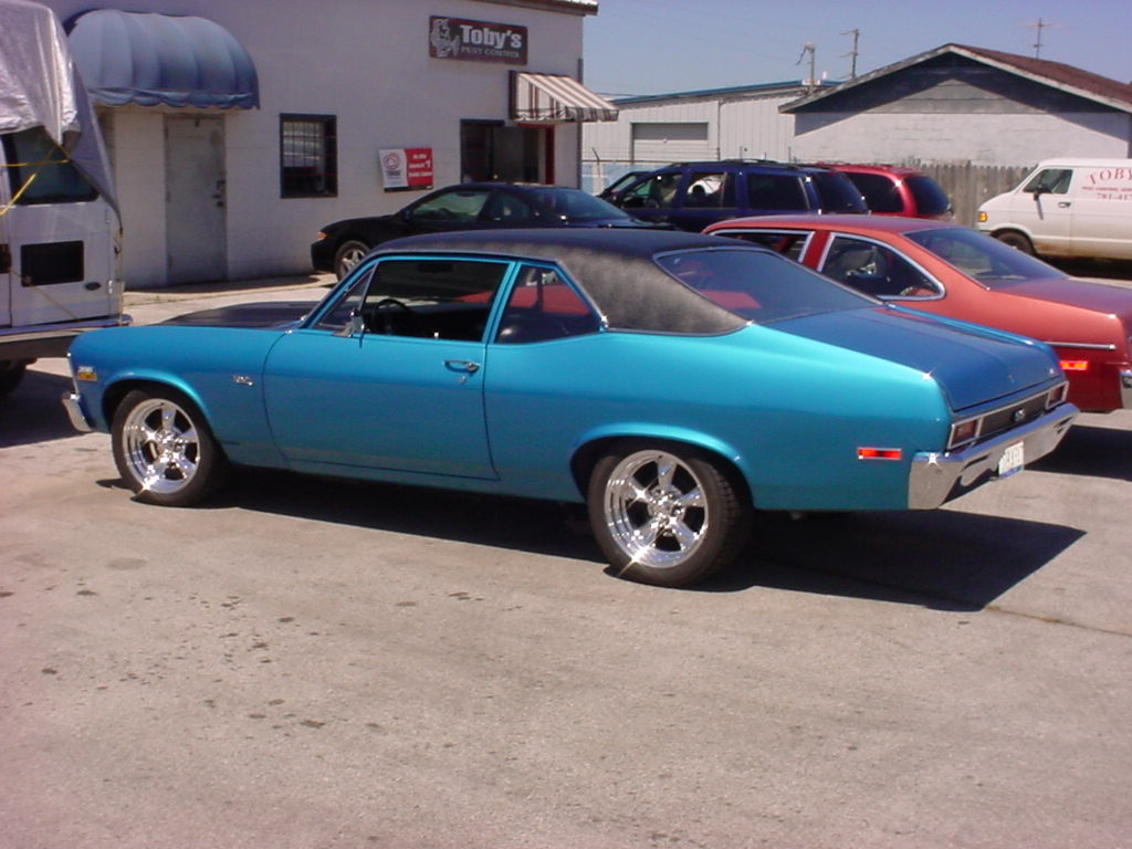

      Here's a couple side shots of my '70. The rear leafs are stock replacements from ESPO (http://www.espo.com). The front coils are factory (i.e. 34 year-old) with a all-steel BB. Measurements from the ground to the bottom of each fender lip is 24" rear and 23.75" front.
      I have Hotchkis coils and leafs (when they come off of backorder) ready to replace the stock units. Hopefully they won't drop it too much more, as I like the current ride height
