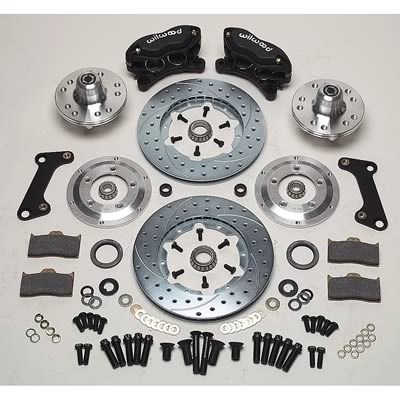

      I ended up deciding on the Wilwood kit # 140-2285BD and ordered today:
      Anyone else using this kit?
      Phil

      Installed "most" of the kit on the front today.
      However, I ran into a "snag" on step #1. The bottom bolt they show for the caliper bracket is 3" long for a 1" span???? I don't get it. If it wasn't for that 1 bolt it would be totally installed.
      Anyone run into this? What am I missing?

      Hmmm. Do you have the disk brake spindles (I do)? Is the lower mounting hole smaller than the upper (mine is)?
      There is a shorter bolt included in the caliper bracket hardware package, but is the same diameter as the upper bolt (too big).
      There is a disclaimer that mentions having to enlarge the bottom hole on earlier model spindles. It makes me wonder about the spindles that I have. According to the PHS docs, my car did not come with disk brakes, so I know there was a conversion done.

      Okay, this was my 2nd stupid question of the week.
      Got it figured out. The bottom hole isn't even threaded and I didn't have the 2nd piece of the spindle attached to the back.
      The 3" bolt passes through the front and back prortions of the spindle and gets a nut on the back.
      In my defense, this was not clear in the Wilwood assembly diagram.
