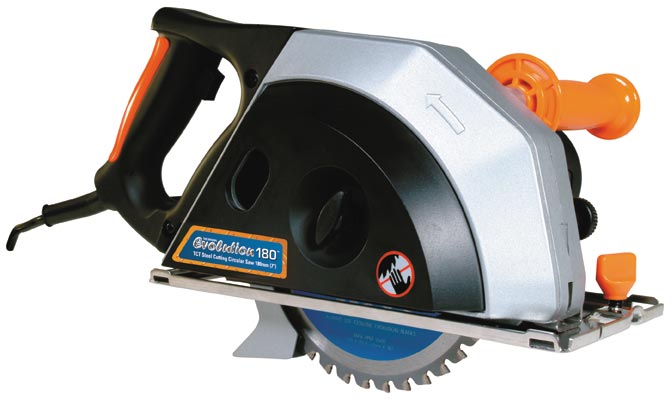

      i got a badass toy for cutting sheetmetal, Its called the EVO 180 but around the shop its called the "ultimate saw", this thing eats, sleeps, and breaths sheet metal cutting!!!!
      Damn Jason, do you go down by the winos and wave bottles of Southern Comfort around too?
      You should know better than to show a pic of a cool tool around here: I nearly bought it just now. But I remembered the 12 steps of beating tool addiction, and was able to call a friend before getting my credit card out. That was close!
      Seriously, that looks like something I'll likely buy someday. Nice stuff.
