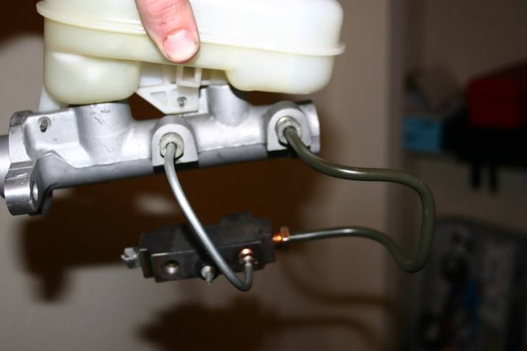

      UPDATE
      does this look right??
      or should I run the rear one straight to the back of the car instead of through the distribution block?

      Is the front port on th MC for the rear brakes and the rear port for the front brakes? If that is the case then your rear line from the mc to the block is correct. I believe that the line from the rear mc port needs to be moved to the left on the block. The port that it is connected to on the block is the out for the rear brakes. Let me know once you get the booster mocked up to the firewall. I am curious how you did it and if you have any thoughts on hooking up the pushrod.
