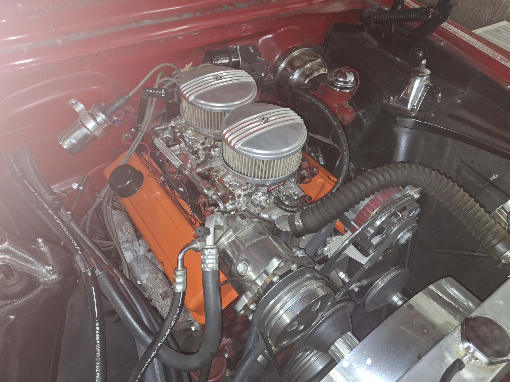

      This Thread will be the beginning of my 63 Nova Convertible Pro Touring Project. I'm re-posting my first Post in the New Members Thread with an over view of the Project.
      "Hi,
      I'm Rick. I'm from N. Central TN and I'm a Caroholic... This is my first foray into building a Pro Tourer. I have several Hot Rods, Classic Cars/Trucks and Motorcycles but I try to keep them "Old School" Classic. They're great for local events <200 miles but I want to get a little Hog Wild and do some long distance touring so I found a nice 63 Nova Convertible that the previous owner tried to build a "Restomod" for lack of a better term. Lots of it was done half-assed (but it made him happy so I'm not going to knock him) and was the perfect candidate IMO to let some of my Freak fly...
      I'm putting together a mix of Old School and Modern in this thing. The Project will begin in April when my Schwartz Performance Chassis arrives. I have almost all the Bells & Whistles on the Chassis and it cost me more than I paid for the Car it's self. I have the Currie Spec 9" Rear w/ 3.70 Gears, Detroit TT, Moser Full Floaters, 13" Baer Brakes and the Ride Tech Single Adj. Coil Overs. The Car will be Mini Tubed and I'm going to try to get 11" Tire under the Rear with 18 or 19" Wheels (looking for 28" Dia. minimum), not sure about the Front yet. I have a GearStar Lvl.3 4L80E with a Yank Converter and a US Shift Quick 4 with the Remote controller.
      The Engine is a 1964 Chevy 409 Big Block (I grew up with 409's in my Dad's Cars). The Engine has a 4" Stroke (474Ci), H-Beam Con Rods, Ross Forged Pistons, 11:1 CR. This motor is a Torque Build so I had Mike Jones custom make a Cam with a 4/7 Swap. The Engine is about 540hp and 575 Tq. I'm using a Progression Ignition Distributor like I have on my other 3 V-8's. I have an Accusump Kit as a Pre-Oiler, Steffs is making me a Custom Dry Sump Pan for the 409, I don't have my Tank and Pumps yet as I want to do a dry fit of the Motor before ordering them. To top it off I'm going really Old School with an Offy 6x2 Pacesetter Intake and 6 Stromberg 97's. I have 2 Big 97's (250cfm ea.) and 4 Vintage 97's (165cfm ea.) as Secondaries. PITA I know but I love 'em. I'm running the Carbs as a progressive set up with the Big 97's as Primaries.
      I plan on customizing the Interior with maybe Procar Rally XL's or Elite Lumbar DLX's,(I need to find some to actually sit in before I make my decision). I'm planning Roll Hoops and a Rear Seat delete as well."
      This is my Starting Point...

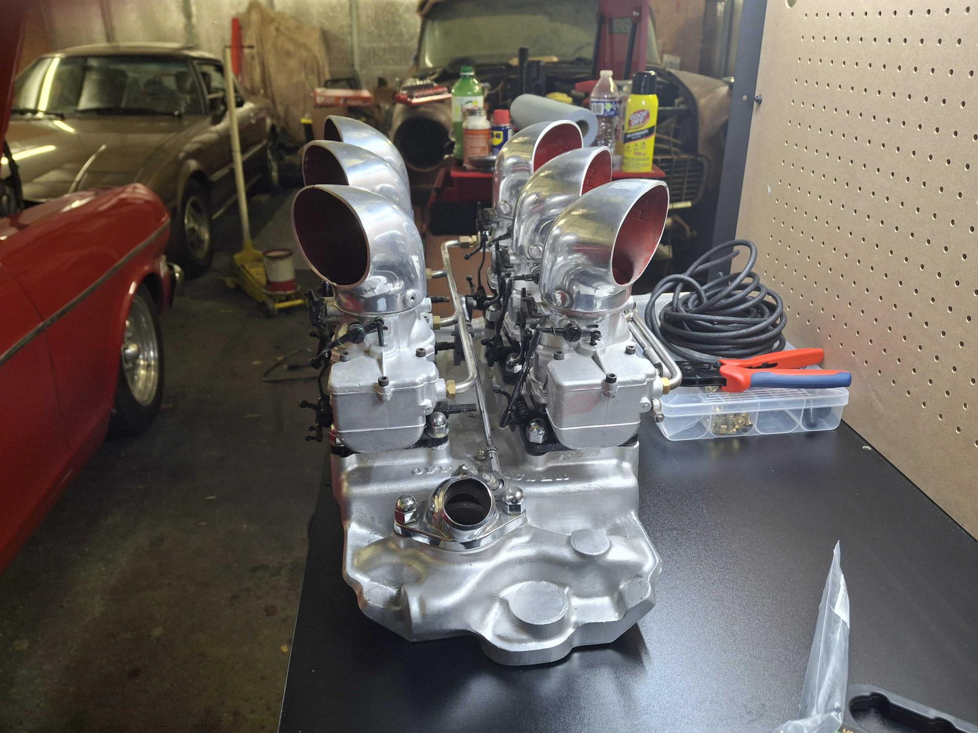

      Got my Offy 6 Deuce Intake back from Rob Walden yesterday. He added on some "Ears" to the Intake Ports to modify it so it will fit the Chevy High Performance "690" Heads. These Intakes were only made for the Low Performance 348 and 409 Heads with the smaller Intakes and Valves.

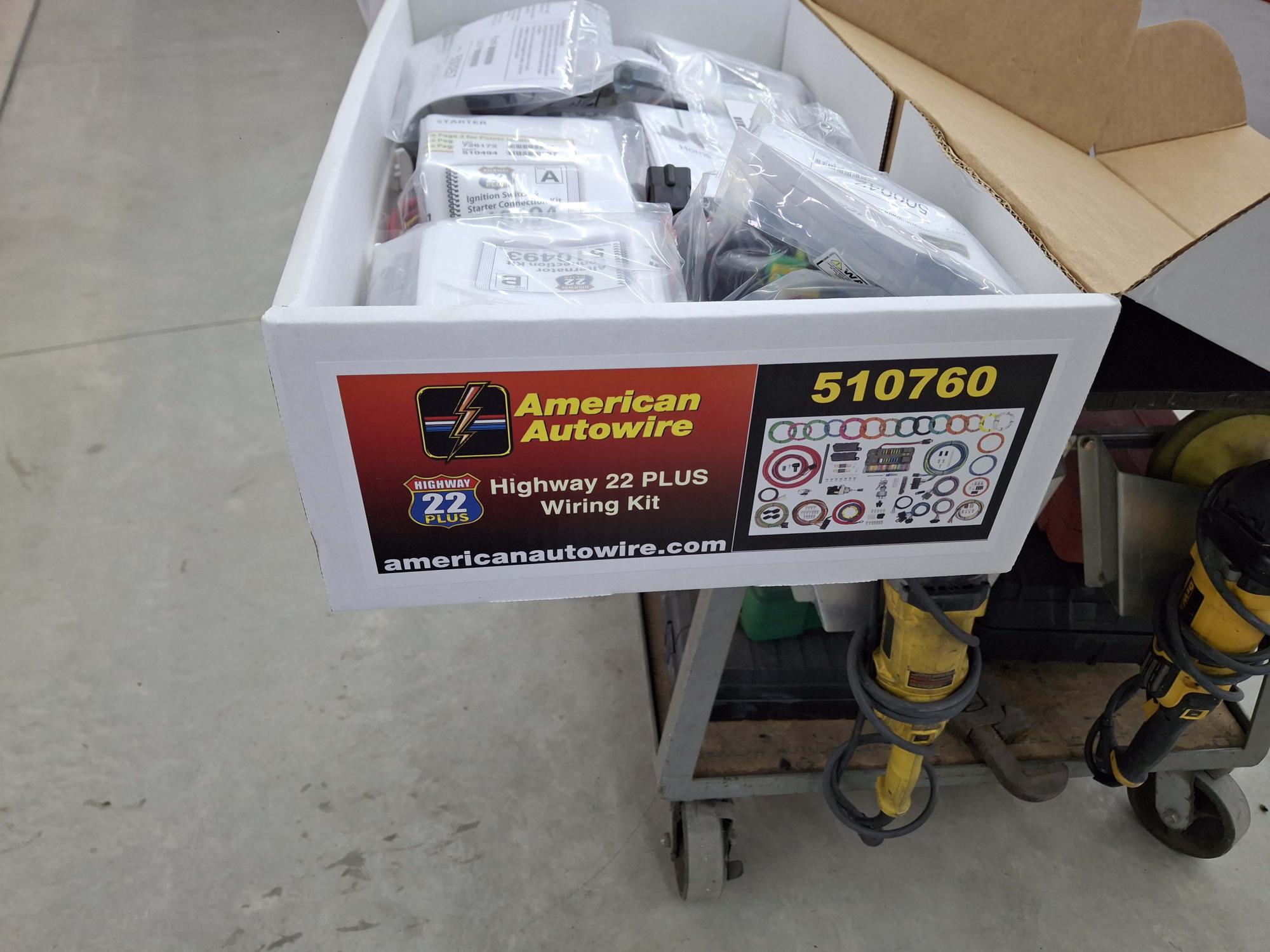

      Ok, It's begun... I started tearing the Nova down about 3 weeks ago. I breathed a real sigh of relief when I got the Carpets and Padding out and got the entire Floor Pan exposed and found no Rust except a little surface stuff. I was pleased to see the original Red Oxide Primer and the Tar Paper sound proofing. The only Rust hole I found was just below the Windshield between the Door and Front Fender, got it Welded up.
      Stripped the 327 and the 700R4 out as well as all the wiring, I got a new AAW Highway 22 Wiring Harness to replace it. I wire wheeled the entire interior floor pans to remove any loose primer and surface rust then gave the entire interior a good coat of POR-15.
      Schwartz Performance sent me a couple of Photos of my Chassis on the Build Table, should be finished in a week or so and be ready for delivery. They have developed a "New & Improved" 1st Gen Nova Chassis and mine is #2 of the new design.
      Got the new Alu. Core support in and marked up to widen it for the new Radiator. I got my new Radiator from US Radiator in today...Man that thing is nice. I ordered a Brass/Copper Radiator for a 68 Impala 396/427 with 4 Cores, the optima Core option and the Triple Pass. If you want a good solid Radiator I highly recommend them, all hand made in Gadsden, AL. and the quality is the best I've seen in a long time. The Guys are great to deal with. Not cheap but well made.

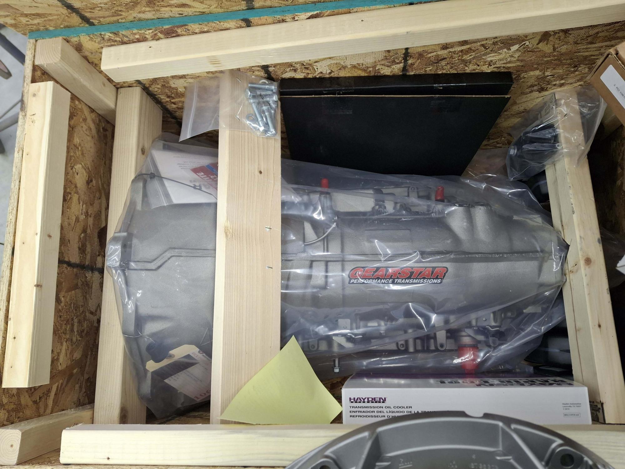

      Got my 409 Test Block in today as well as the 4L80E, going to throw some Heads on tomorrow so I can look at Header clearance, the Oil Pan as well. Also got the Front Clip removed.

      One small thing I found is that the Trans Mount needed to have one more hole rearward for it to be exactly right. The Rubber mount has a small angle in it and is slammed against the rear of the slot. The 409 has the same mounts as a Small Block but is about 1 1/4" longer. I called Schwartz and told them if anyone ever orders a Chassis for a 409/4L80E combo the bracket need to be longer(which I doubt because I'm the only Idiot that would something like that). Justine asked Immediately if they needed to make me a different one but I told her I could make it work.
