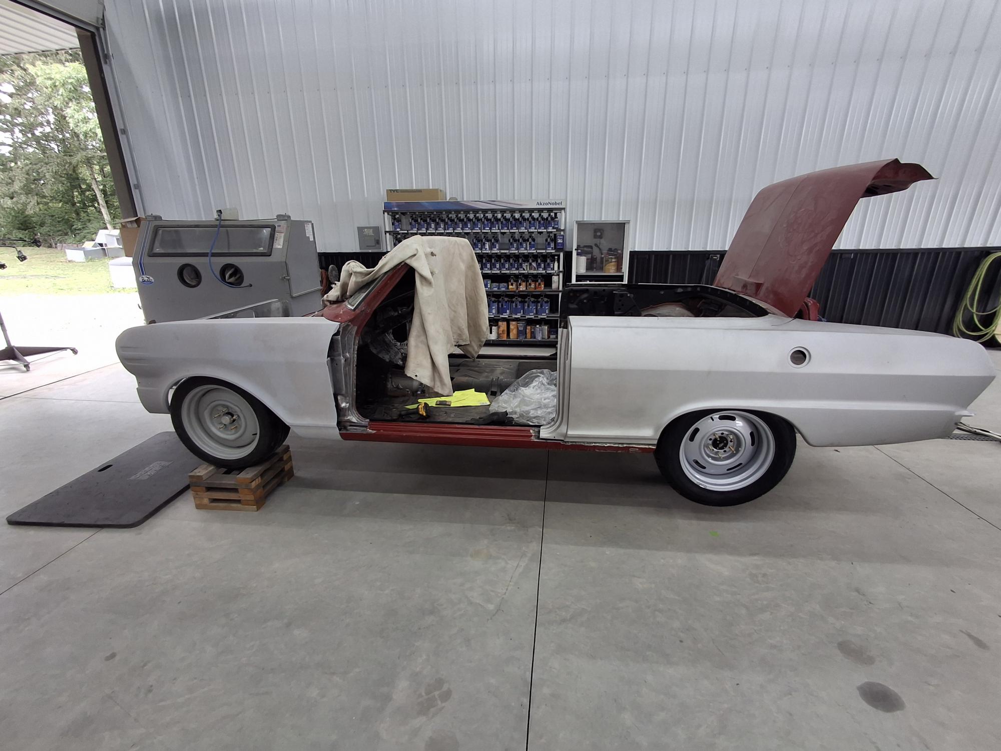

      This Thread will be the beginning of my 63 Nova Convertible Pro Touring Project. I'm re-posting my first Post in the New Members Thread with an over view of the Project.
      "Hi,
      I'm Rick. I'm from N. Central TN and I'm a Caroholic... This is my first foray into building a Pro Tourer. I have several Hot Rods, Classic Cars/Trucks and Motorcycles but I try to keep them "Old School" Classic. They're great for local events <200 miles but I want to get a little Hog Wild and do some long distance touring so I found a nice 63 Nova Convertible that the previous owner tried to build a "Restomod" for lack of a better term. Lots of it was done half-assed (but it made him happy so I'm not going to knock him) and was the perfect candidate IMO to let some of my Freak fly...
      I'm putting together a mix of Old School and Modern in this thing. The Project will begin in April when my Schwartz Performance Chassis arrives. I have almost all the Bells & Whistles on the Chassis and it cost me more than I paid for the Car it's self. I have the Currie Spec 9" Rear w/ 3.70 Gears, Detroit TT, Moser Full Floaters, 13" Baer Brakes and the Ride Tech Single Adj. Coil Overs. The Car will be Mini Tubed and I'm going to try to get 11" Tire under the Rear with 18 or 19" Wheels (looking for 28" Dia. minimum), not sure about the Front yet. I have a GearStar Lvl.3 4L80E with a Yank Converter and a US Shift Quick 4 with the Remote controller.
      The Engine is a 1964 Chevy 409 Big Block (I grew up with 409's in my Dad's Cars). The Engine has a 4" Stroke (474Ci), H-Beam Con Rods, Ross Forged Pistons, 11:1 CR. This motor is a Torque Build so I had Mike Jones custom make a Cam with a 4/7 Swap. The Engine is about 540hp and 575 Tq. I'm using a Progression Ignition Distributor like I have on my other 3 V-8's. I have an Accusump Kit as a Pre-Oiler, Steffs is making me a Custom Dry Sump Pan for the 409, I don't have my Tank and Pumps yet as I want to do a dry fit of the Motor before ordering them. To top it off I'm going really Old School with an Offy 6x2 Pacesetter Intake and 6 Stromberg 97's. I have 2 Big 97's (250cfm ea.) and 4 Vintage 97's (165cfm ea.) as Secondaries. PITA I know but I love 'em. I'm running the Carbs as a progressive set up with the Big 97's as Primaries.
      I plan on customizing the Interior with maybe Procar Rally XL's or Elite Lumbar DLX's,(I need to find some to actually sit in before I make my decision). I'm planning Roll Hoops and a Rear Seat delete as well."
      This is my Starting Point...

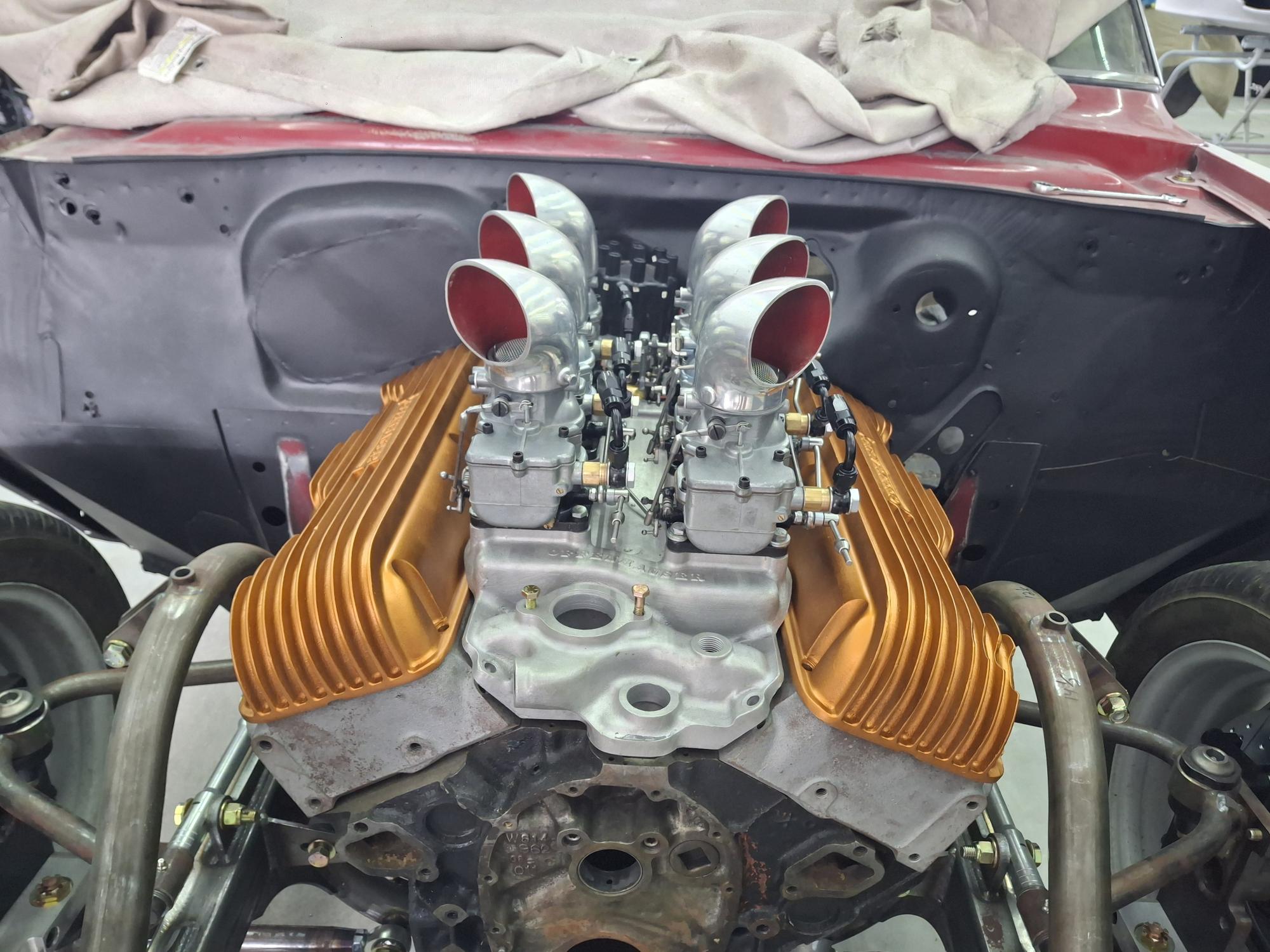

      Got my Offy 6 Deuce Intake back from Rob Walden yesterday. He added on some "Ears" to the Intake Ports to modify it so it will fit the Chevy High Performance "690" Heads. These Intakes were only made for the Low Performance 348 and 409 Heads with the smaller Intakes and Valves.

      Spent the day today doing a 12 Pack Jigsaw Puzzle getting the 6 Strombergs and all the 6x2 linkages assembled and test fit. I also got the Core Support modded to accept the much larger 4 Core 68 Impala BB custom Radiator from US Radiator in Alabama. Very nice Radiator, Brass, 4 Core, optima Core and Triple Pass options. It should keep the 409 (474) cool in all scenarios.

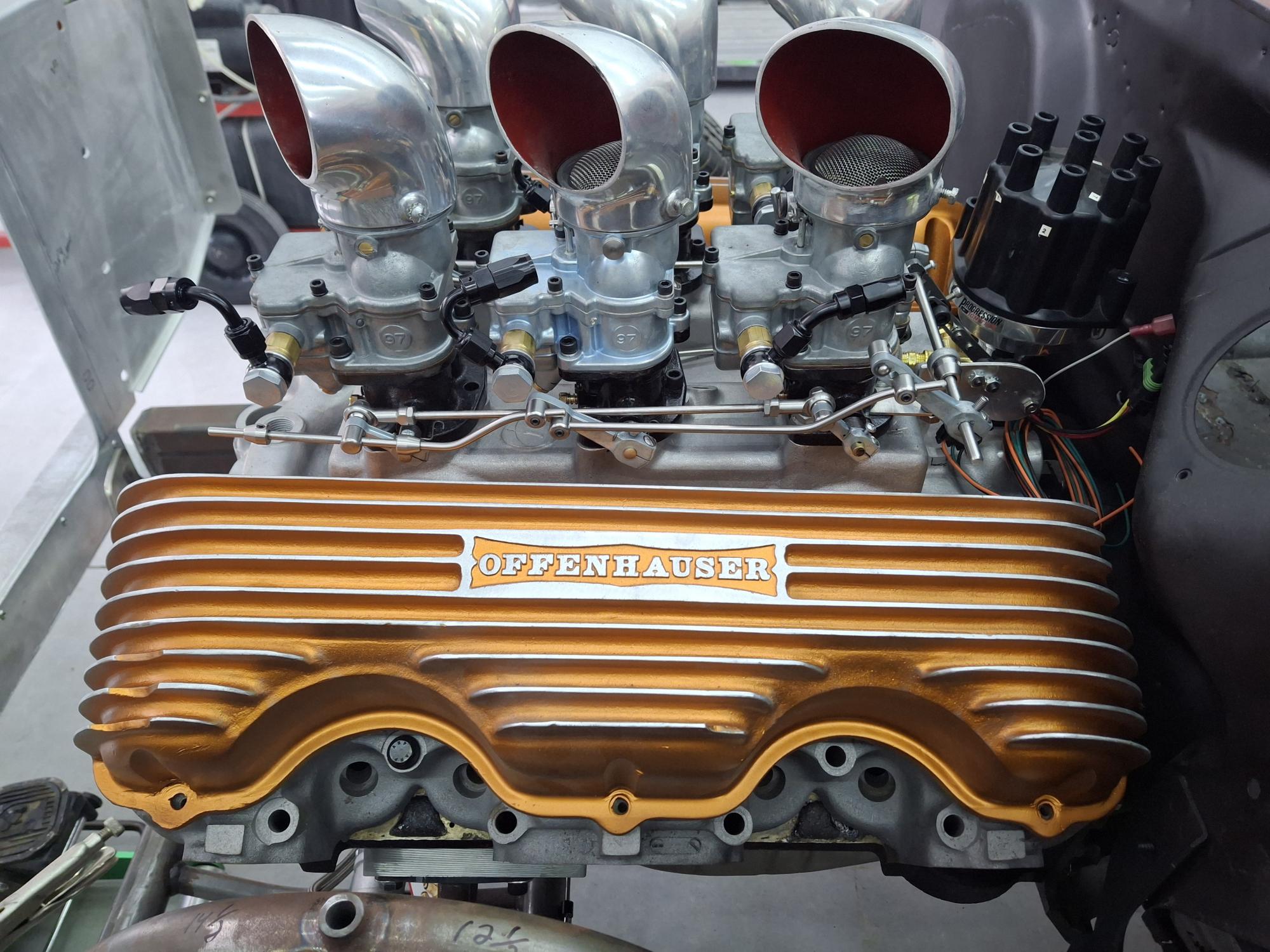

      I couldn't watch so I worked on the Carbs a little more... I cut the Choke Linkage off the Secondaries because they won't be needed but that also left the Idle Screw without an Anchor point since it fixes on the upper Choke Lever so I drilled and tapped a 6-32 screw between the Idle Screw Arm and the Shaft Bushing to fix them in place.

      Tomorrow I have to drill out the Fuel Inlet Float Valves on the Secondaries to accept the improved S-Jet (Grose Jet with 2 Ball Valves) so they match the Big 97's. I need to drill them out to 33/64 and then Tap them with a 9/16-18 thread and then put in a threaded insert for the 5/16 Valve. Ought to be fun...

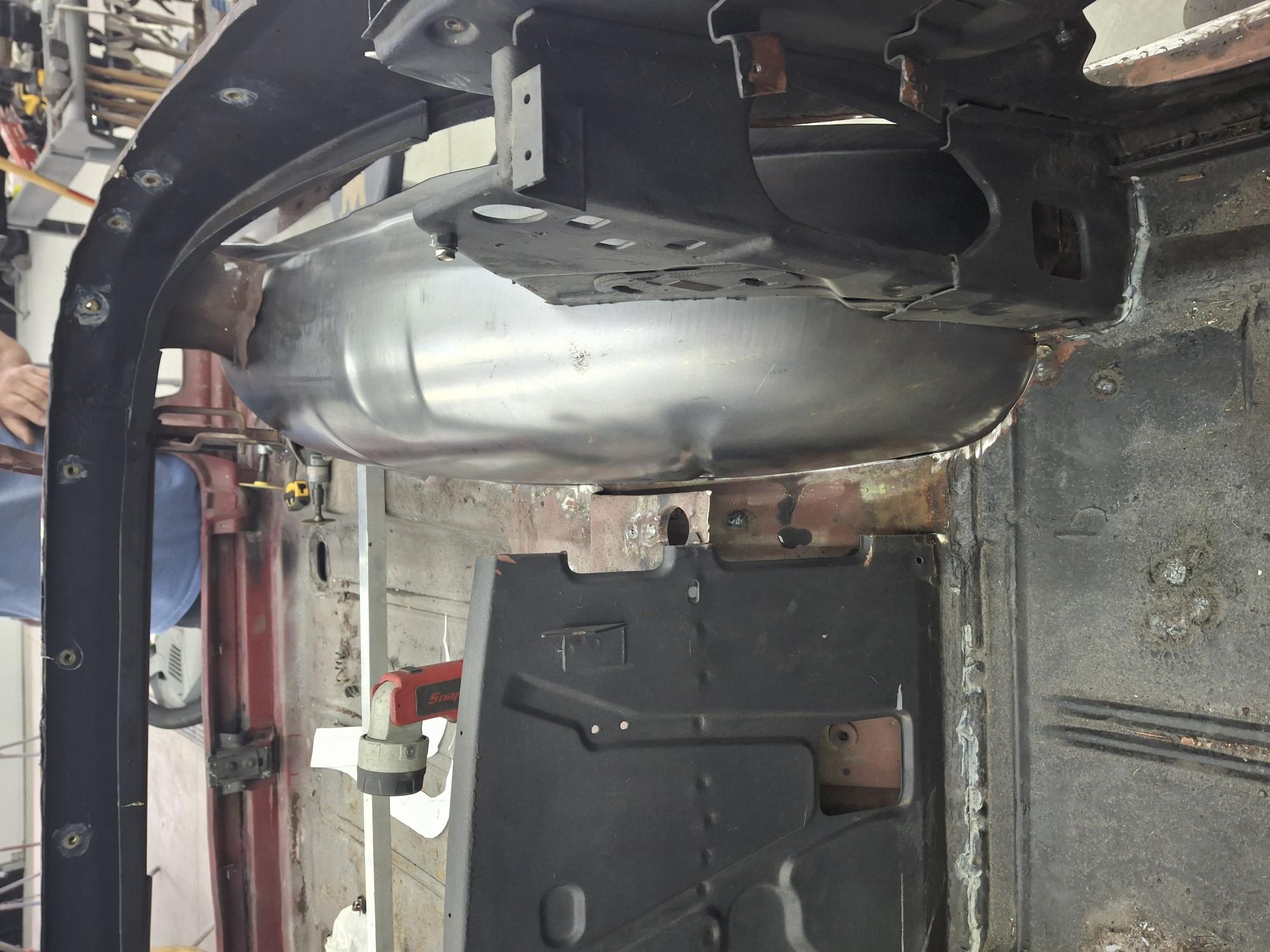

      Got the Trunk Pan cut out and raised, I'm having a custom 34 Gal. tank built and I wanted to raise it a few Inches into the Trunk so it won't hang but a couple of Inches below the Rear Bumper. I'm having an Access Door put in the forward portion of the pan to access the Sending Unit, Pick ups, Vents, etc...

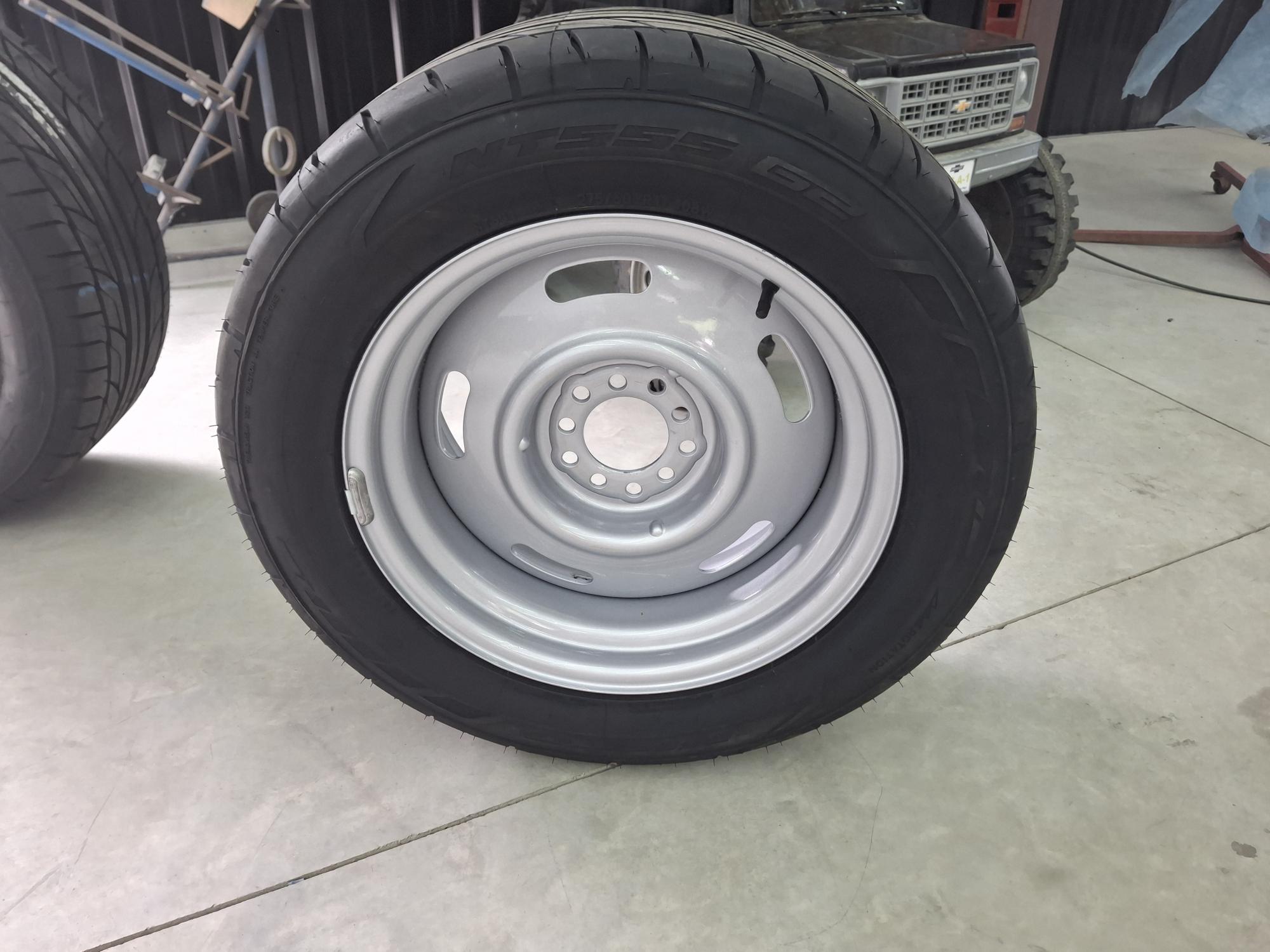

      Got my Rear Wheels and Tires in last week as well, 17x9 Steel Rallye's with a 7" BS running a Nitto 555 G2 275/50/17, it fits nicely. Ordered the fronts today after using another buddies 17X7 BS 4.5" - 235/45/17's as a baseline. I ordered 17x7's with 5.5" BS to run a 225/50/17.

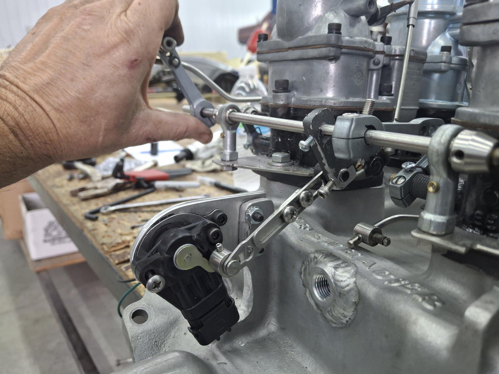

      Got the TPS for the Quick 4/4L80e mounted and synced with the Carbs...that was a PITA, also got my Vintage Offy Valve Covers acid etched and primed with some Aircraft Zinc Chromate Primer and then Painted them Burnt Copper.
