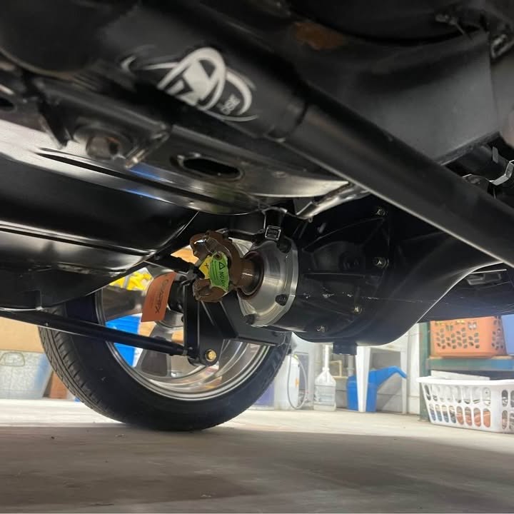

      All new sheet metal body with DSE mini tubs and partially shaved firewall.
      DSE Hydroformed Subframe with Single adjustable coilovers
      DSE Subframe Connectors
      DSE Quadralink Rear
      9" Ford True Trac 3.70
      Wilwood 6/4 piston brakes

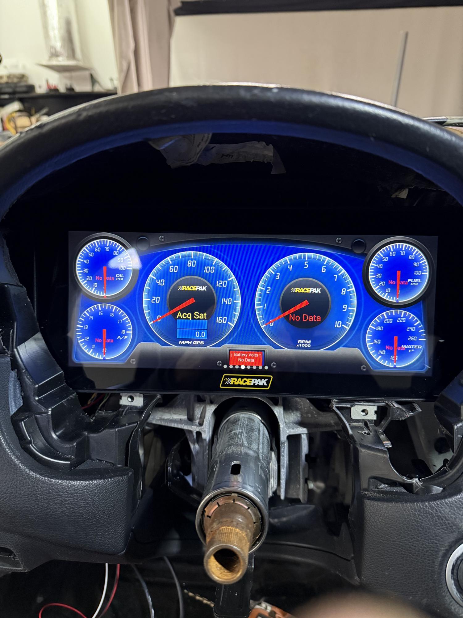

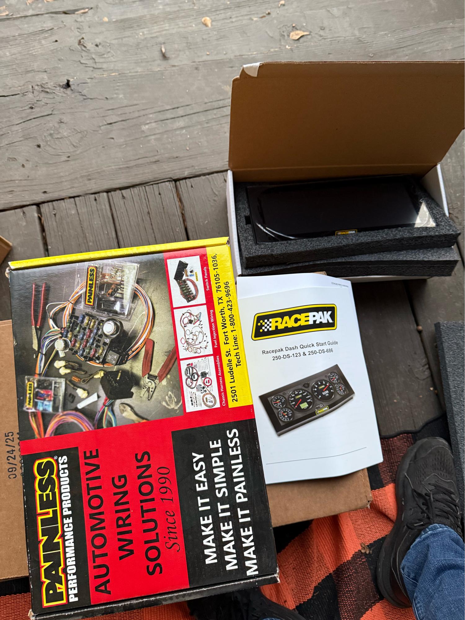

      4 packages arrived today!
      In the crates are the TSP shortblocks. I stayed up until midnight on Black Friday to score these. While I had an immediate need for the -2cc piston unit for Emma Kate, I couldn't pass the opportunity to get the -18cc dished version for the Whipple 427 going in Kennedy. A $9k shortblock for $6500.
      The Painless engine harness arrived as well as the Racepak 12.3" dash. The harness is setup for a GM ECU, but to save 2 grand, I don't mind repinning it for the MaxxECU.
      I've had these heads laying around for 8 years. They were on my C6 Corvette Road race car, sequential shifting at 7500 RPM. Glad I hung onto them.

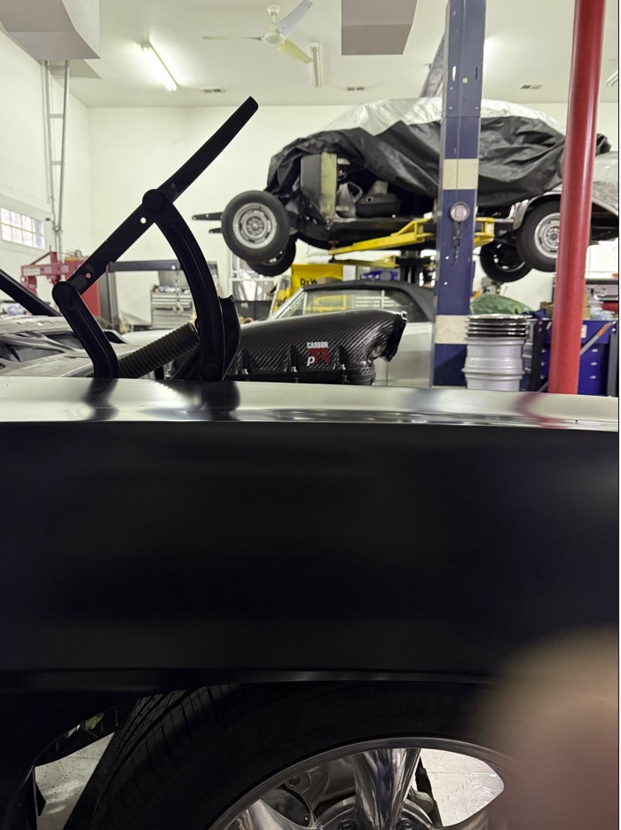

      Do they make a 6" cowl hood?
      Well, the Carbon pTR intake is certainly a no-go.
      With all the conflicting info out there, I just had to see for myself.

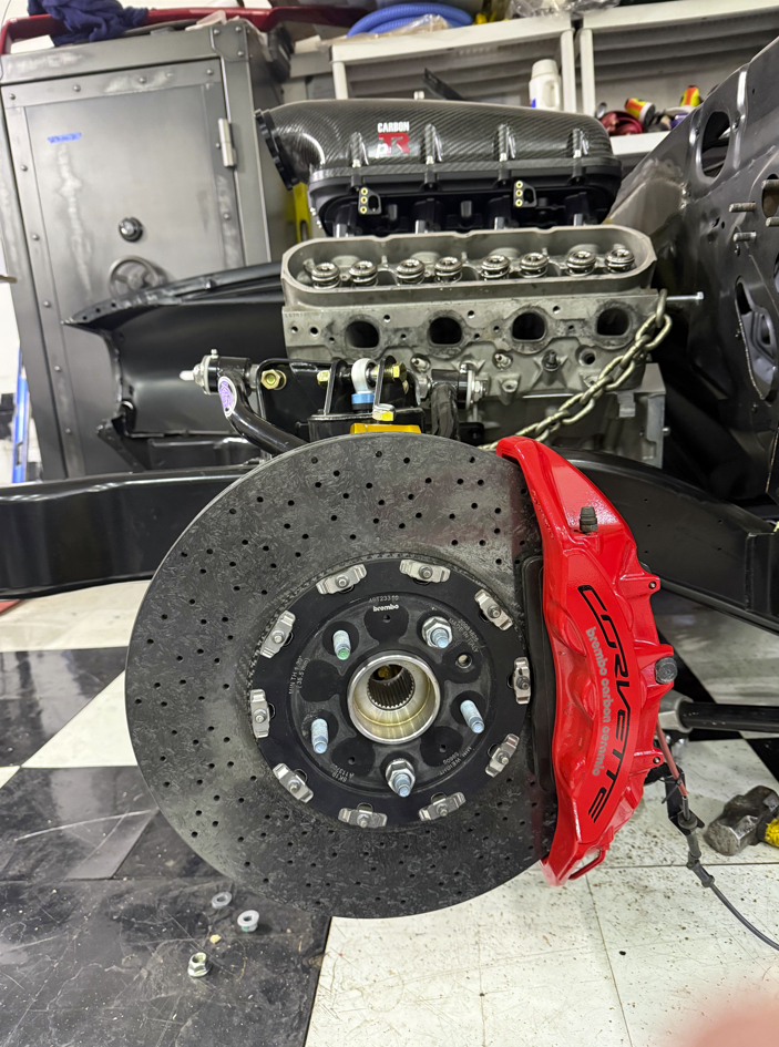

      Gotta stop sometime.
      Had to utilize a different spindle than the DSE, since they do not offer a C7 brake option.
      Some work to do to get the steering adapter mounted, but not a huge task.
      Yes, the brake sensor will be wired to the ECU to present an alarm on the dash.
      WARNING: Will require the use of 18" wheels.

      That is a massive rotor! I forget how big those are.
      Mountain Springs, Texas
      4,872
      Impressive build. What spindle did you use to get those C7 calipers to fit?

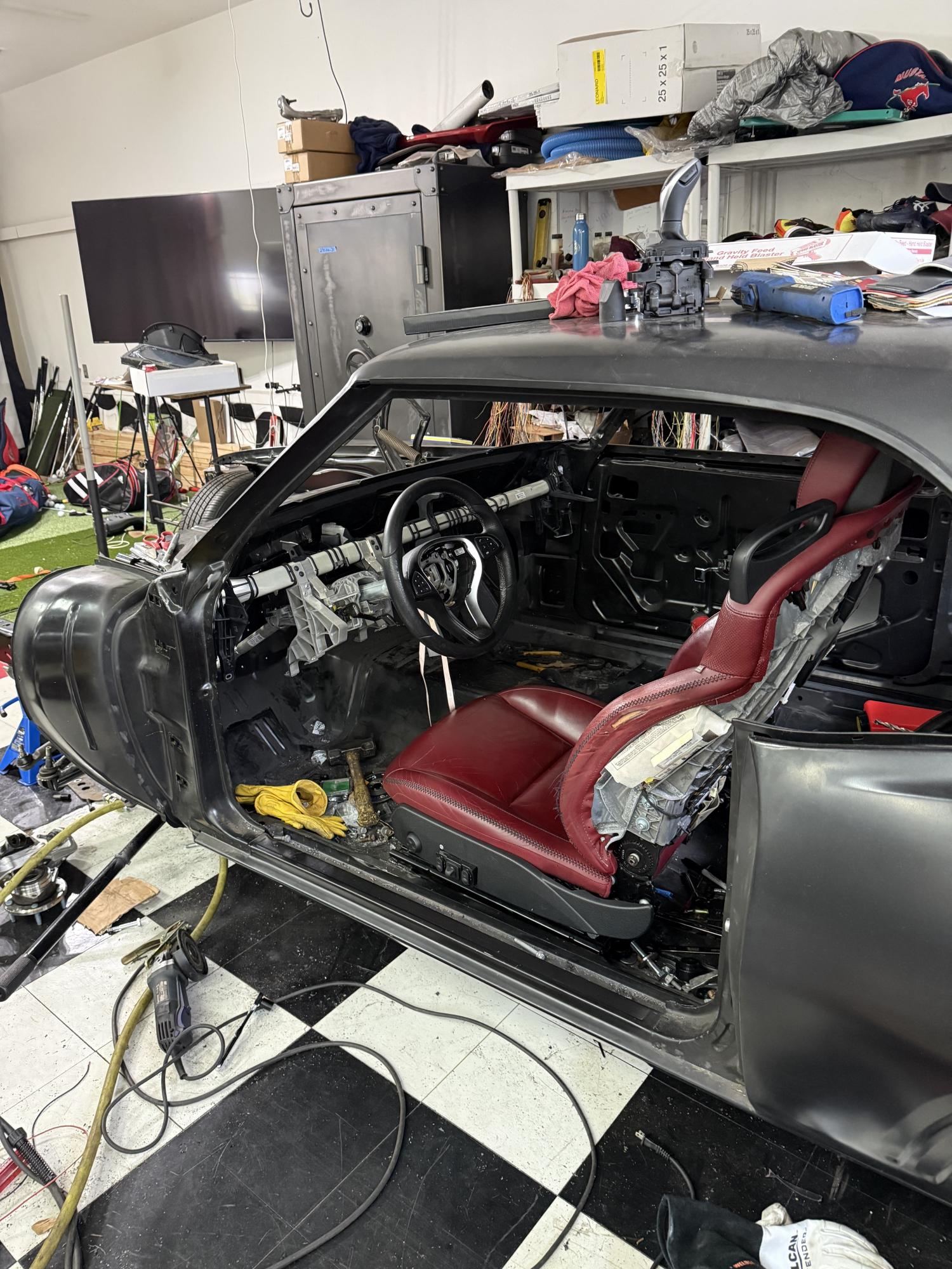

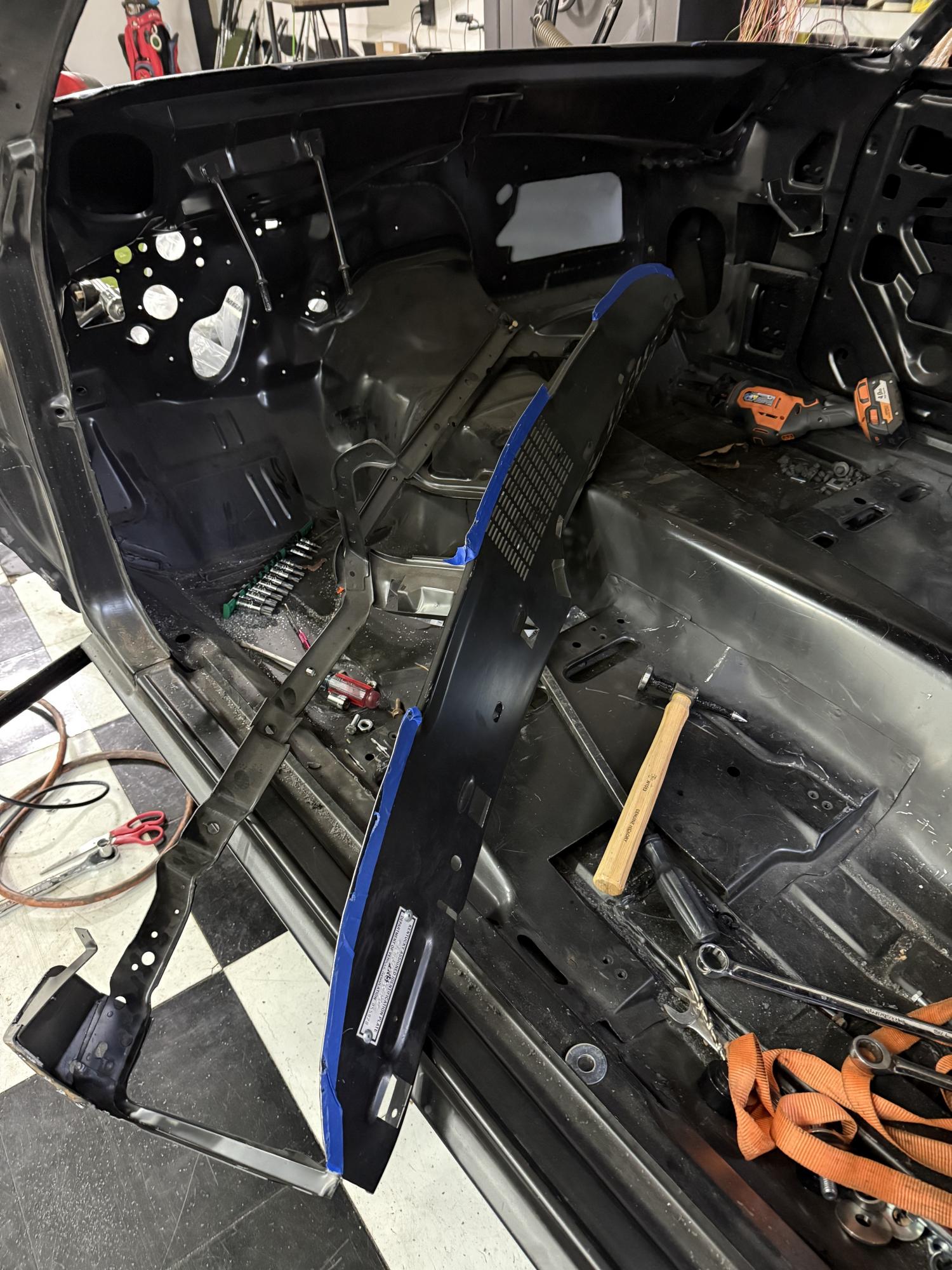

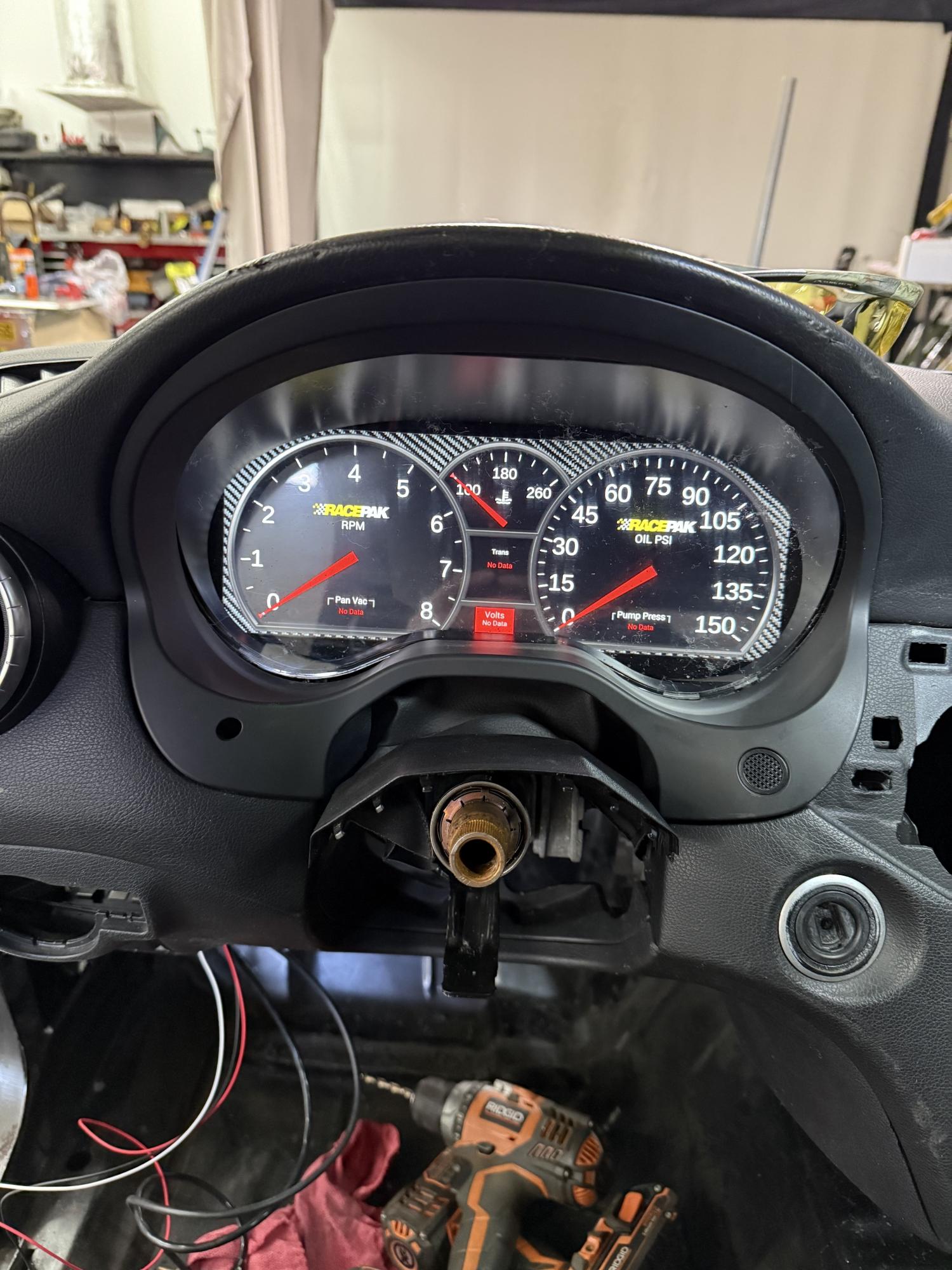

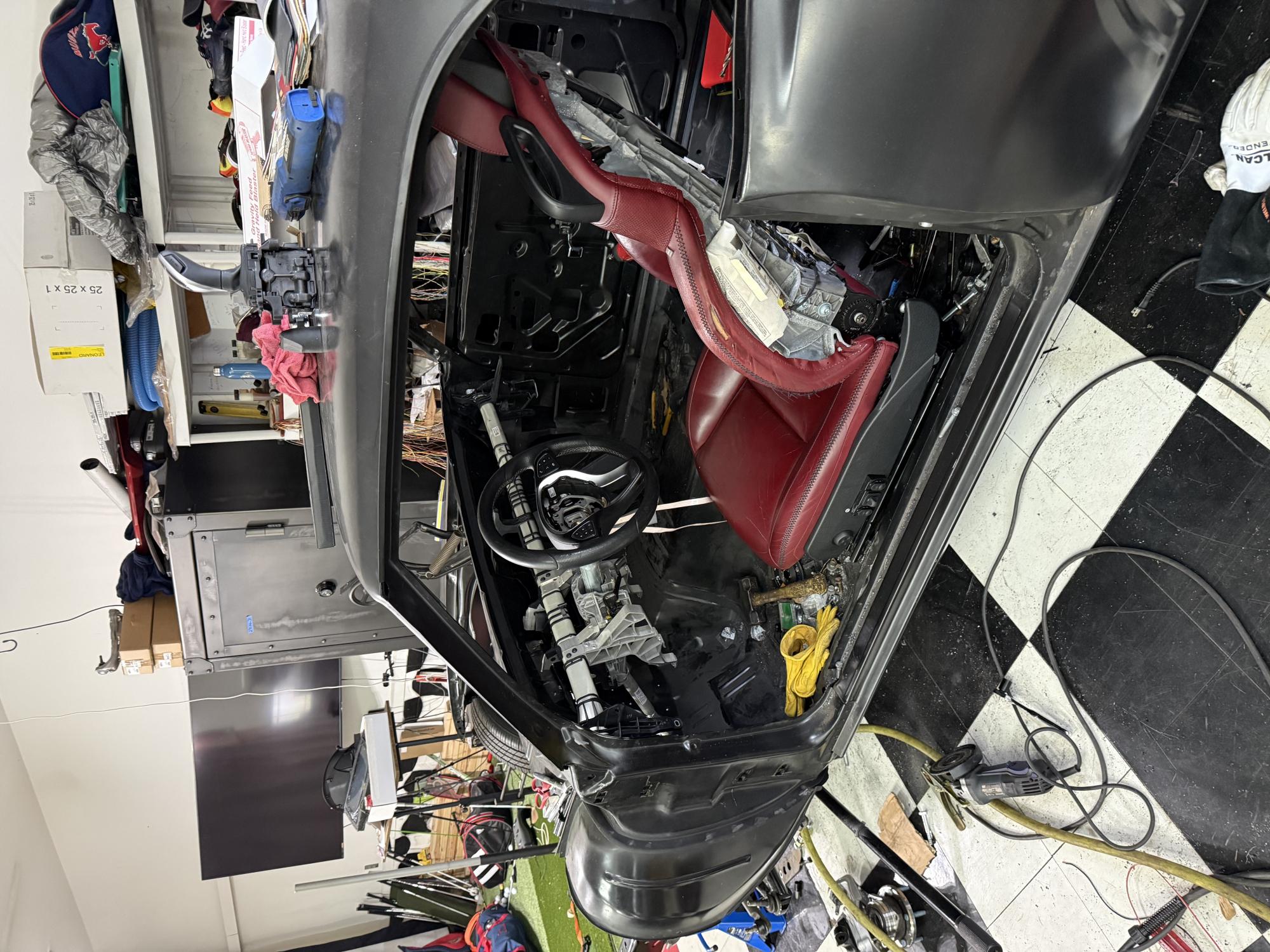

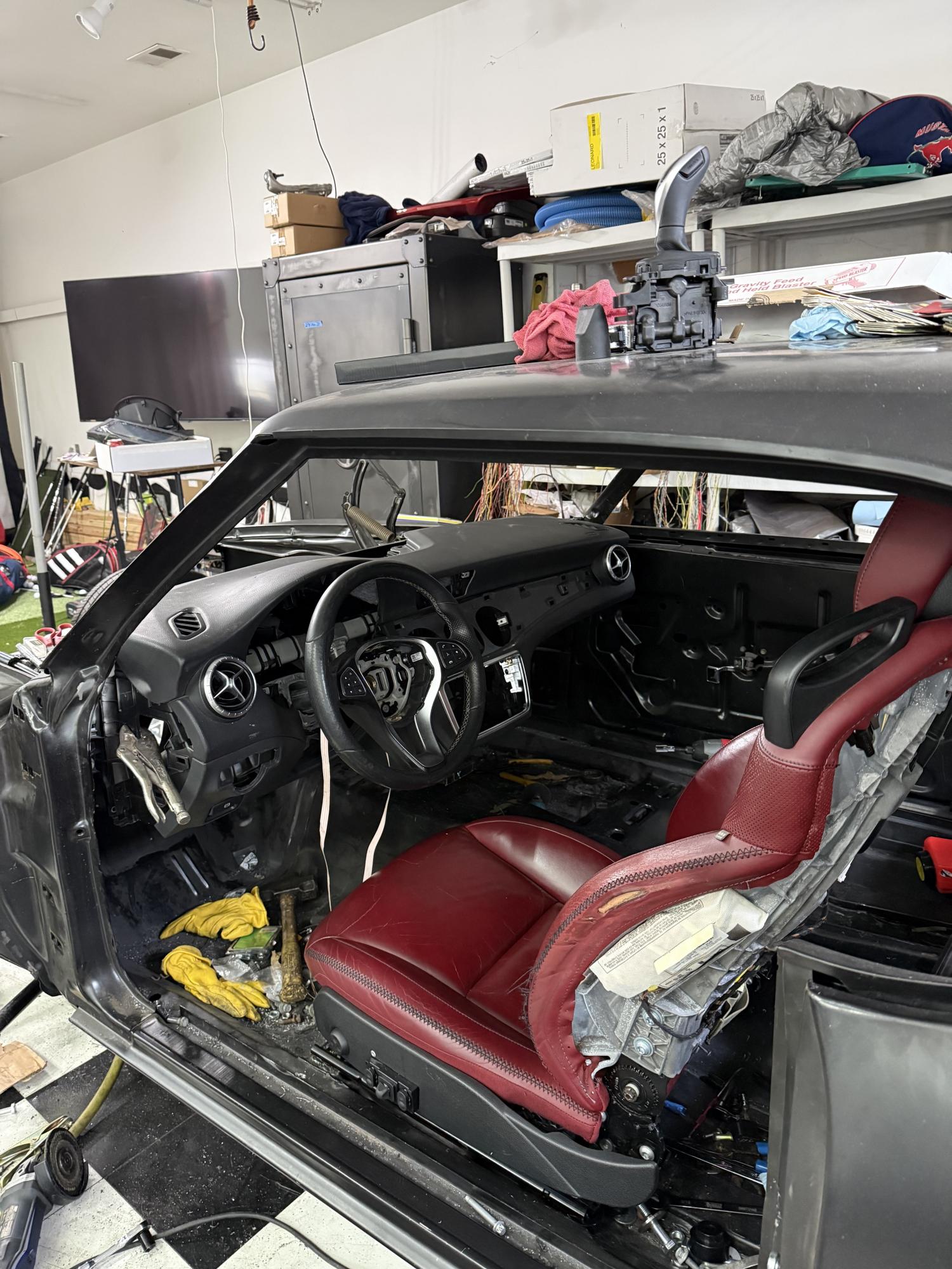

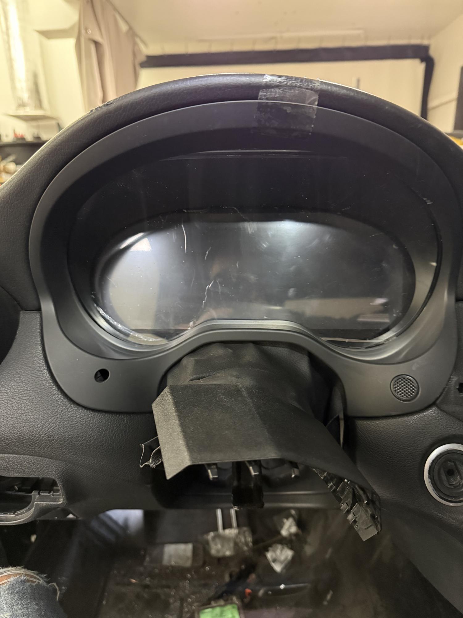

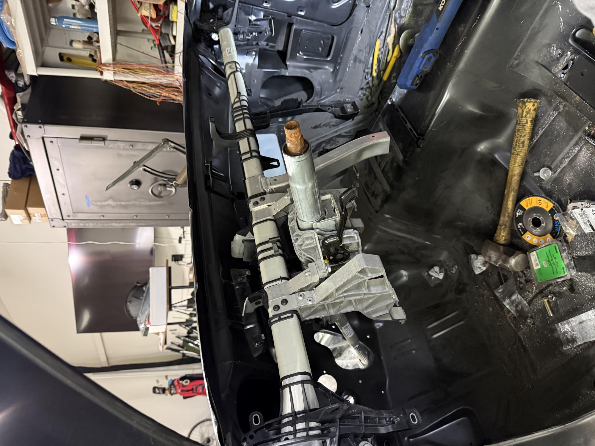

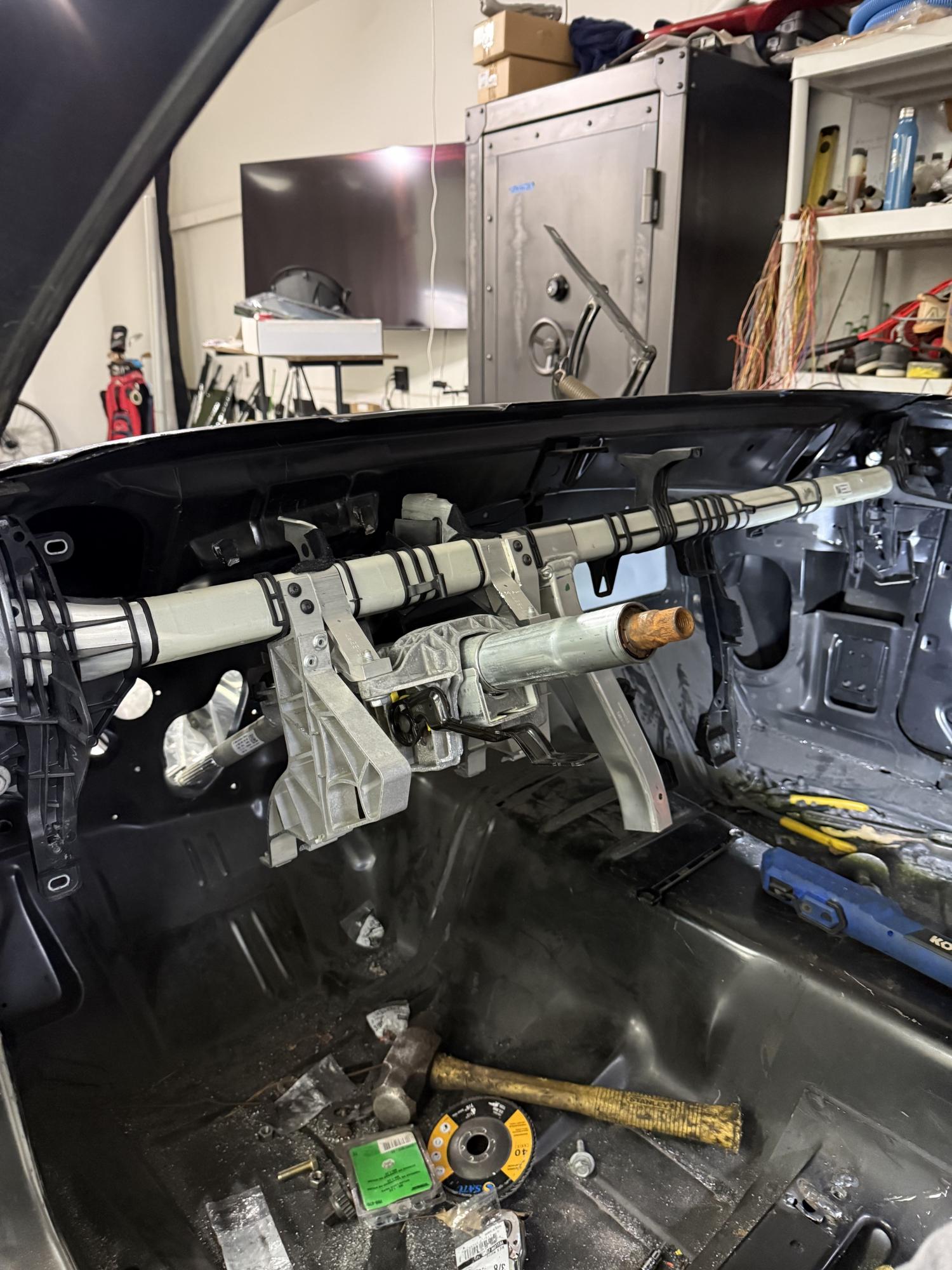

      Update 2/22
      Still waiting to get into the sheet metal shop, but busy on several fronts.
      Installing the dash and steering column, from 2014 Mercedes CLA

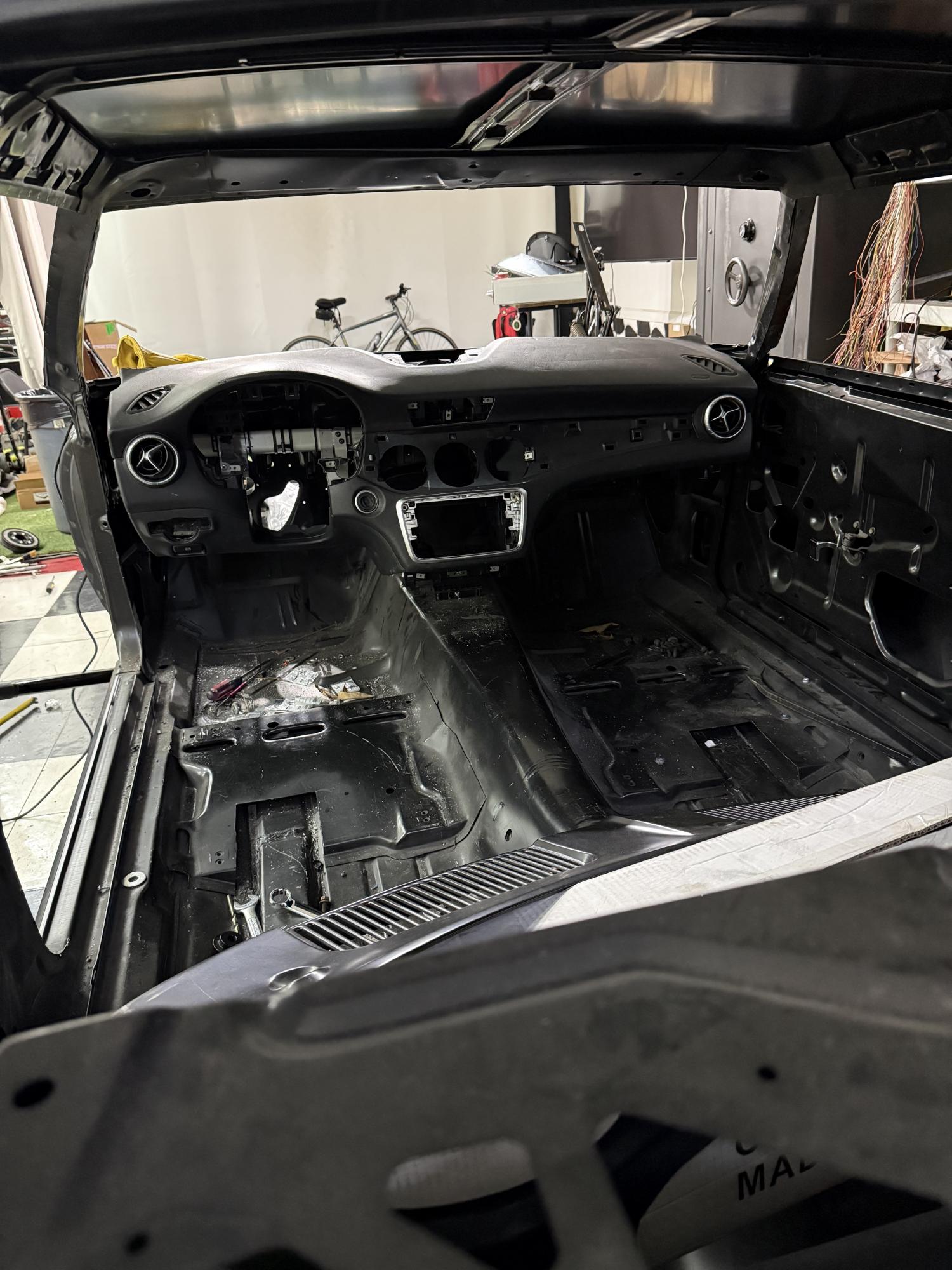

      Out with the old and in with the new...
Size:  318.8 KBName:  Dash 5.jpg
Size:  320.4 KBName:  Dash 4.jpg
Size:  219.2 KBName:  Dash 6.jpg

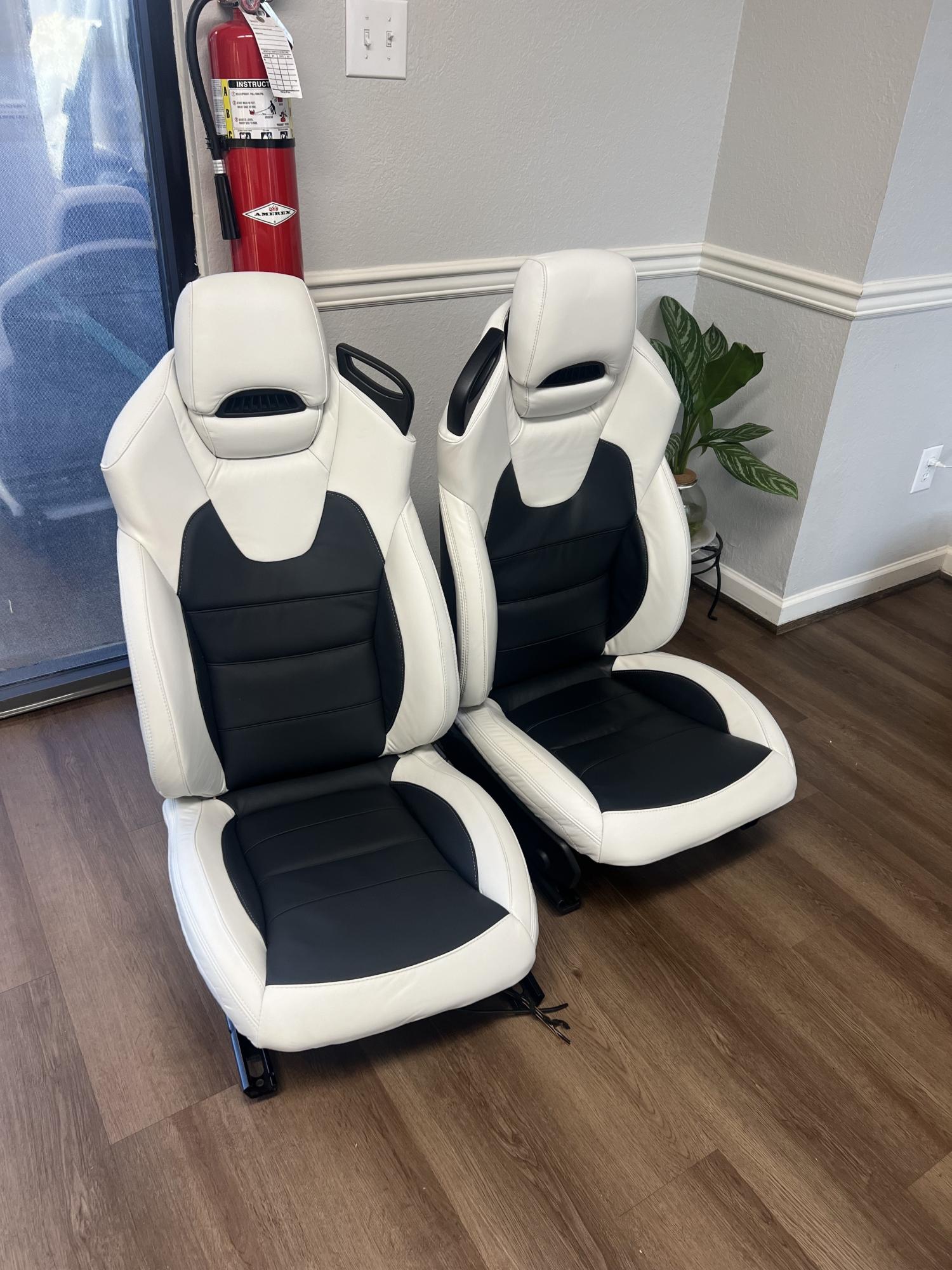

      Seats (from 2012 SLK), recovered in the interior scheme.
      Name:  Seats Recovered.jpg
