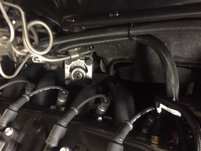

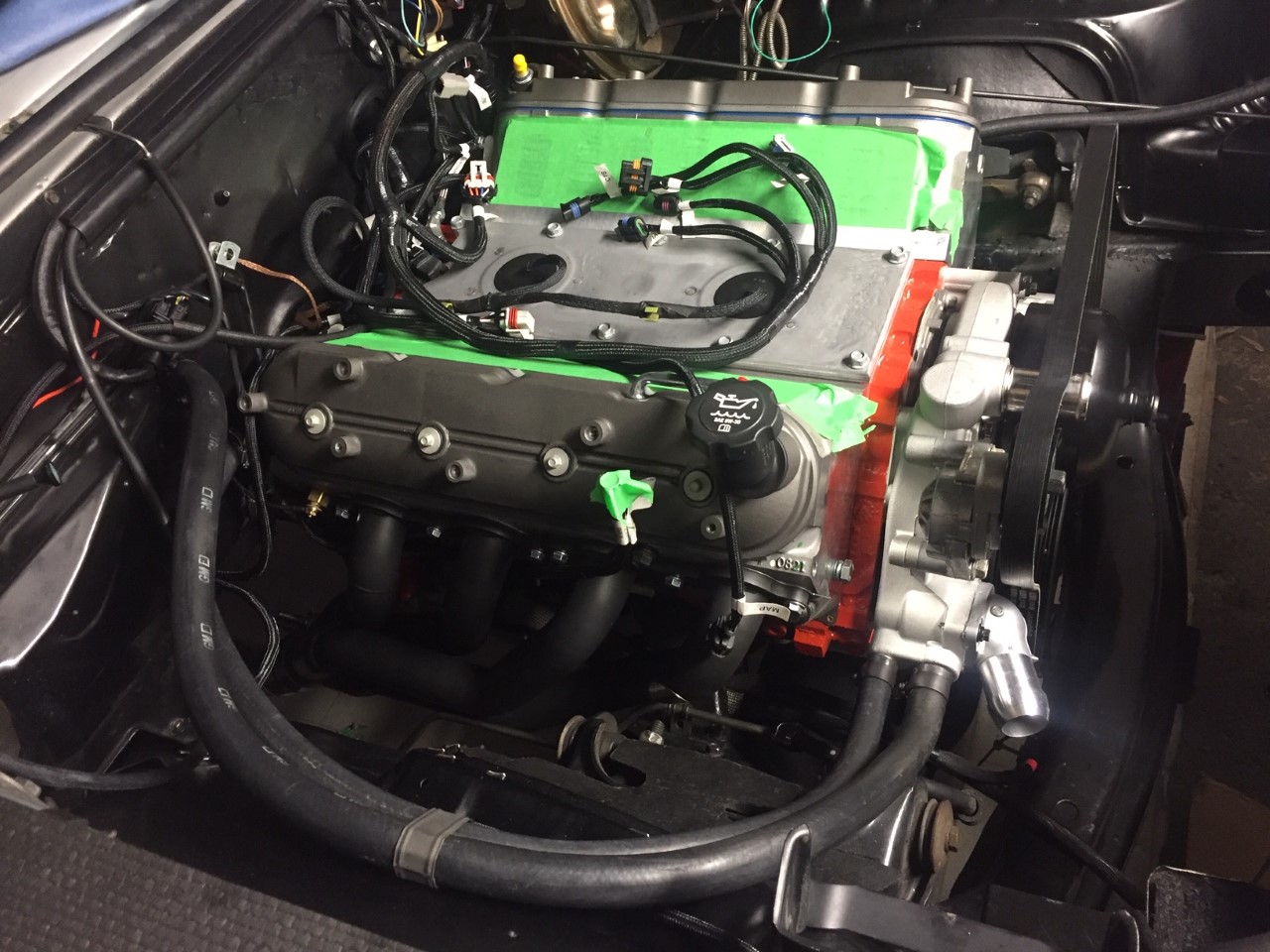

      I used the adjustable ICT Billet LS mounts, had them in the stock position and were too close to the firewall and heater core tubes, were scrapping on my 600 steering box. Moved them up one position I think about an 1" and everything worked out. Keep in mind that the trans mount had to be reworked when moving engine forward. Summit makes an adjustable trans mount that could work?https://www.summitracing.com/parts/sum-773200
      Also remember that moving more forward could effect from accessory spacing with rad. LS1 drive spacing with no issues.

      I used these 1.75" primaries mid mounts from Hooker, black ceramic coated, didn't want to have any low clearance issues with long tubes. Good deal on them now from Summit.
