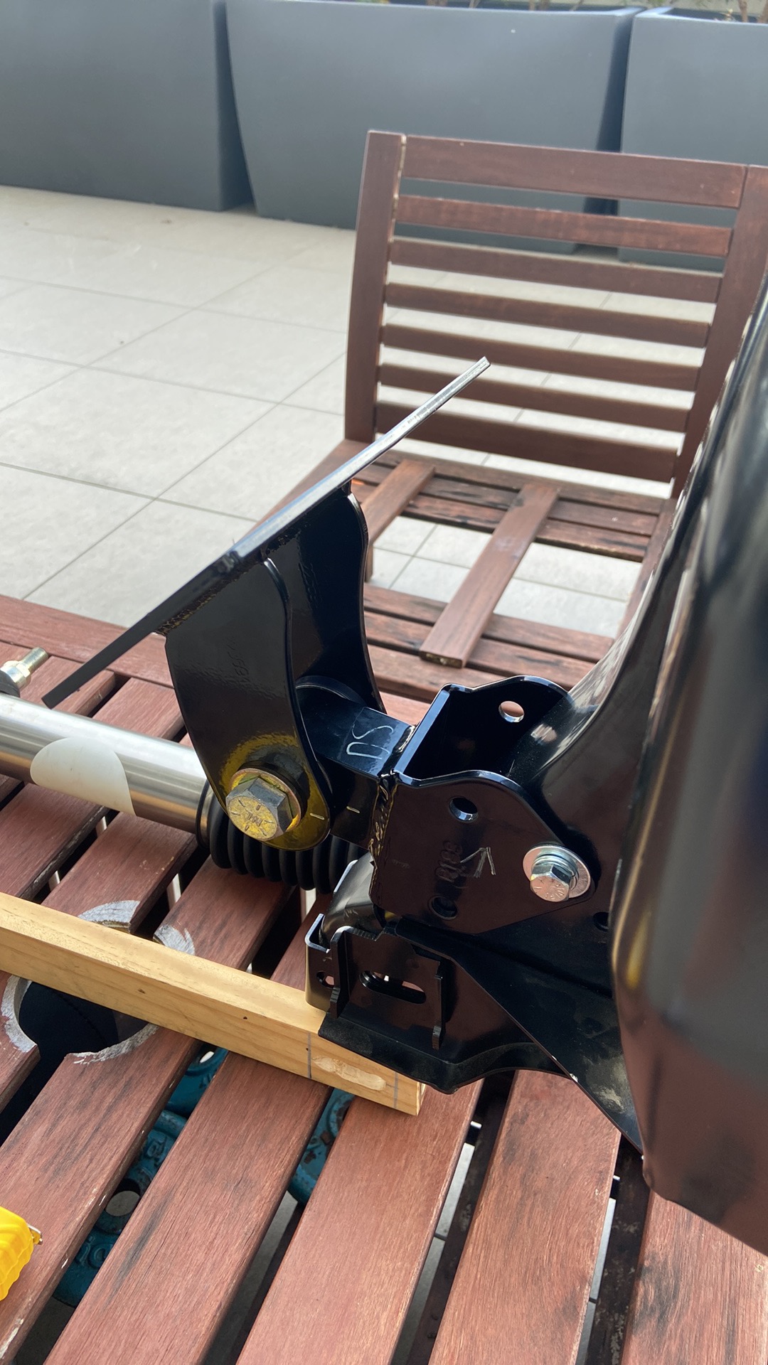

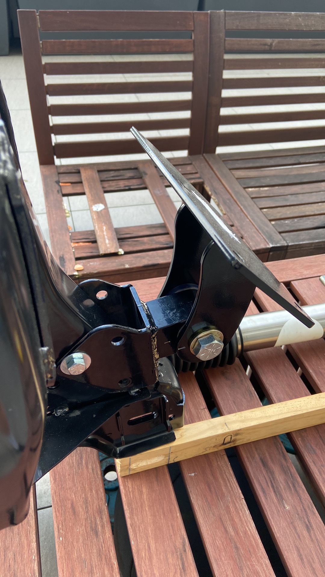

      Also I wanted to figure out a way to get an LS into a mustang without welding up mounts. I knew, like many of you that there are a multitude of options for this swap in to nearly every conceivable make, model and style of vehicle from Cessna light aircraft to shopping trolleys, but never a bolt-in kit for a early mustang.
      I found these bad boys from an Australian HotRod fabrication shop (www.rodshop.com) Castlemaine Rod Shop.
      Name:  lhs mount.jpg
Size:  450.7 KBName:  rhs mount.jpg

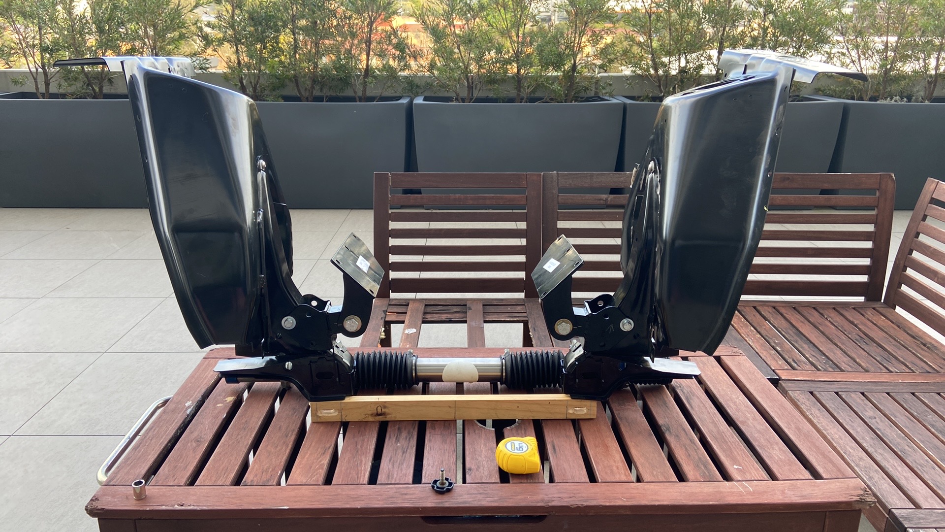

      I went to a local Mustang shop and picked up some inner shock towers to play with measurements and very rudimentary trial fitment.
      By looking at Andrews Cougar build, I'd want a rack and pinion steering system for ease of installation, so I've got a manual and power TCP rack (not sure which one I'll use for the final setup).

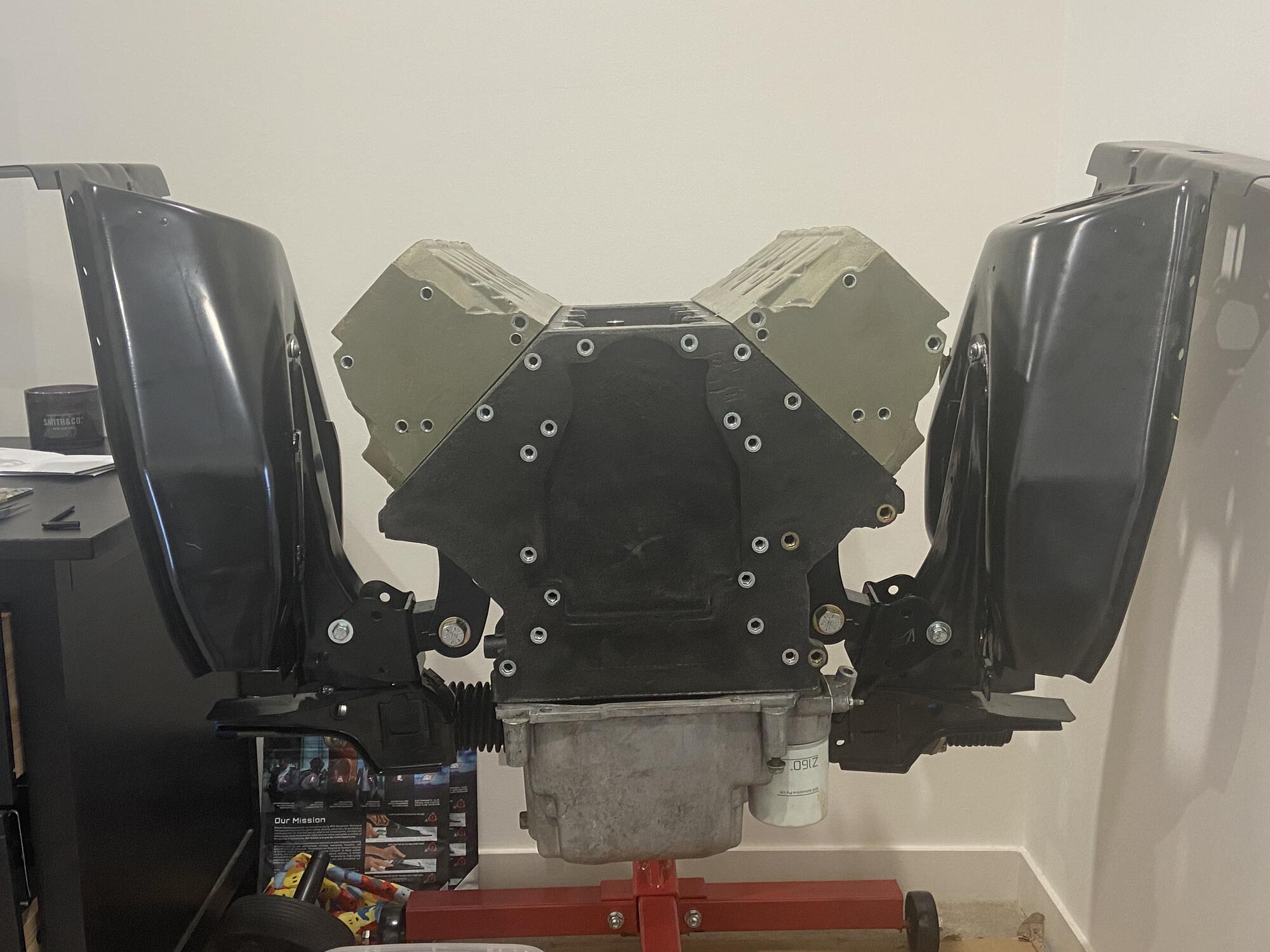

      I then picked up a plastic LS block to further test the plan.
      So far I was pretty close to what the measurements and dimensions I was seeing in the bay of my 67 mustang. Things were getting very interesting....
      Found a front sump out of a Monaro (your Pontiac GTO's I believe), and still, things are looking good.
      I should note at this point we were in an apartment looking for our next home so could only really "bench race" the plan.
      Until...
Size:  471.8 KBName:  LS RHS.jpg

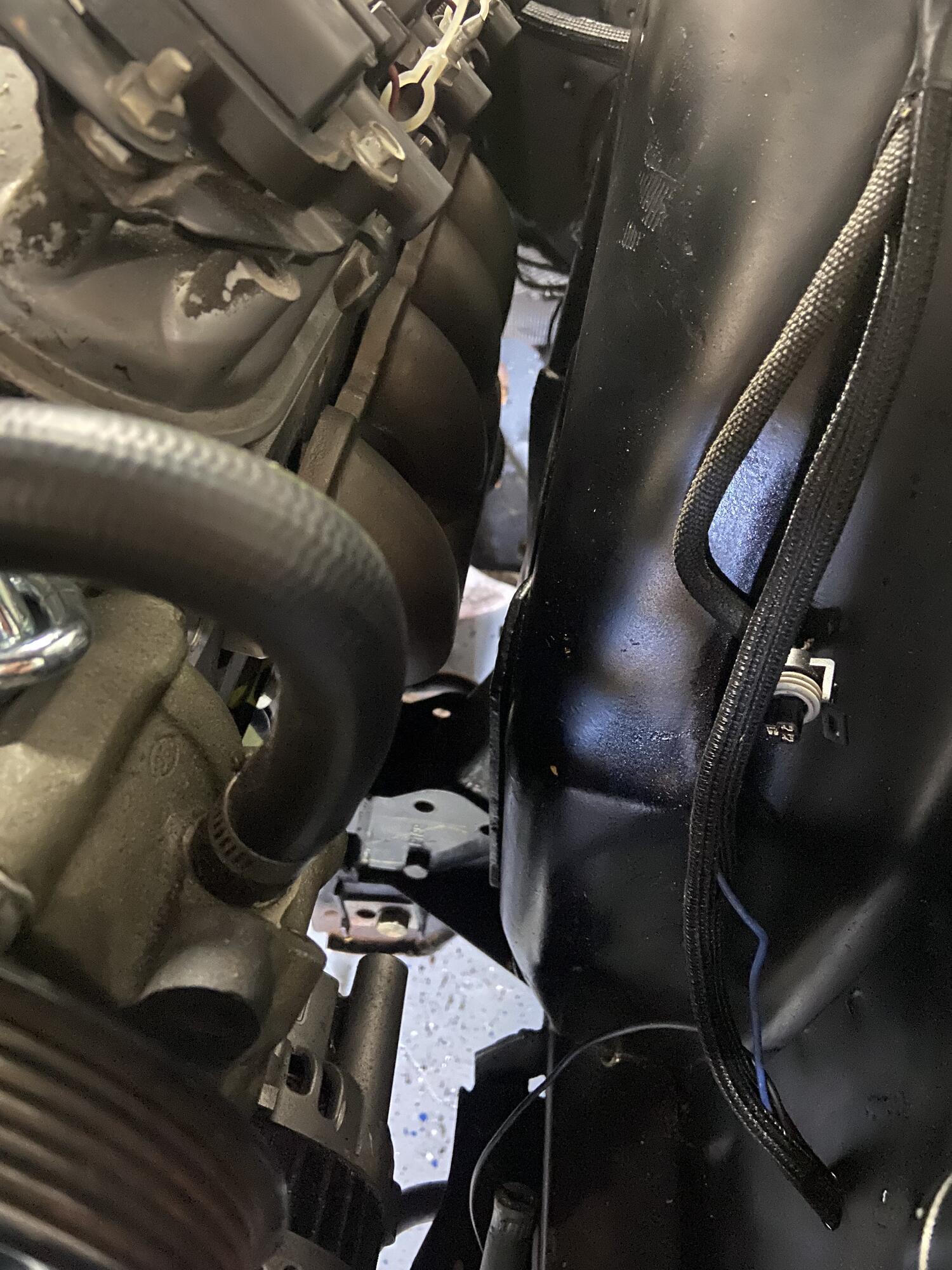

      as per Andrews build I'm using Hooker LS Swap manifolds. This has proven to be the correct route for this application, but also again note that I've removed the stock steering box and associated parts, so I have a huge amount of room on both sides of the engine bay where the exhaust will finally exit to the pipes.

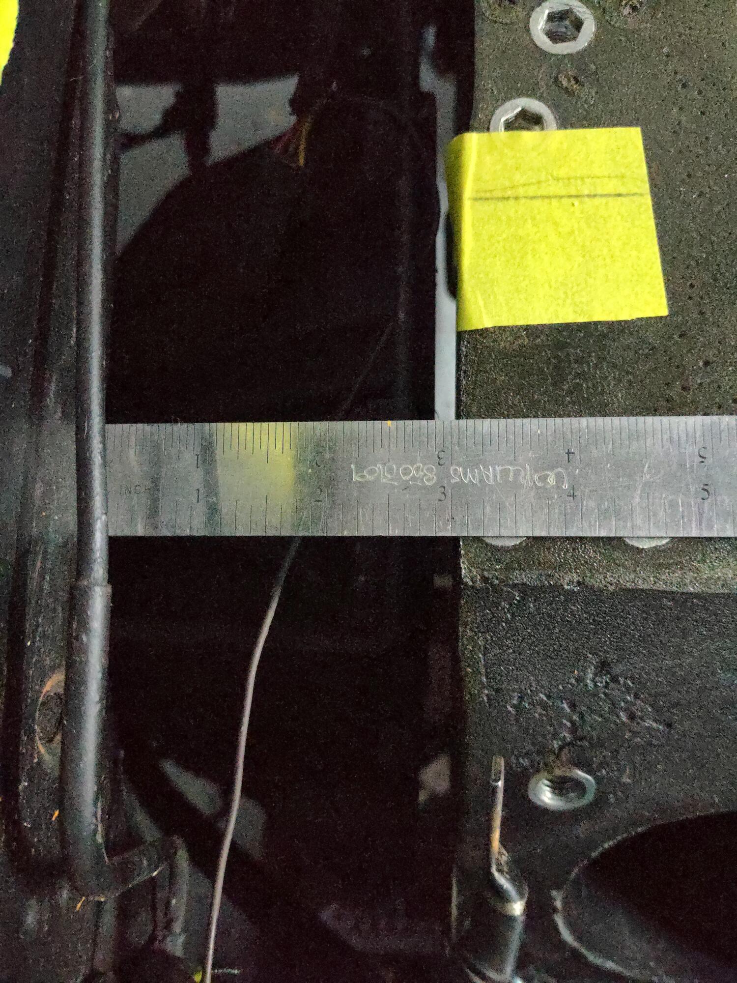

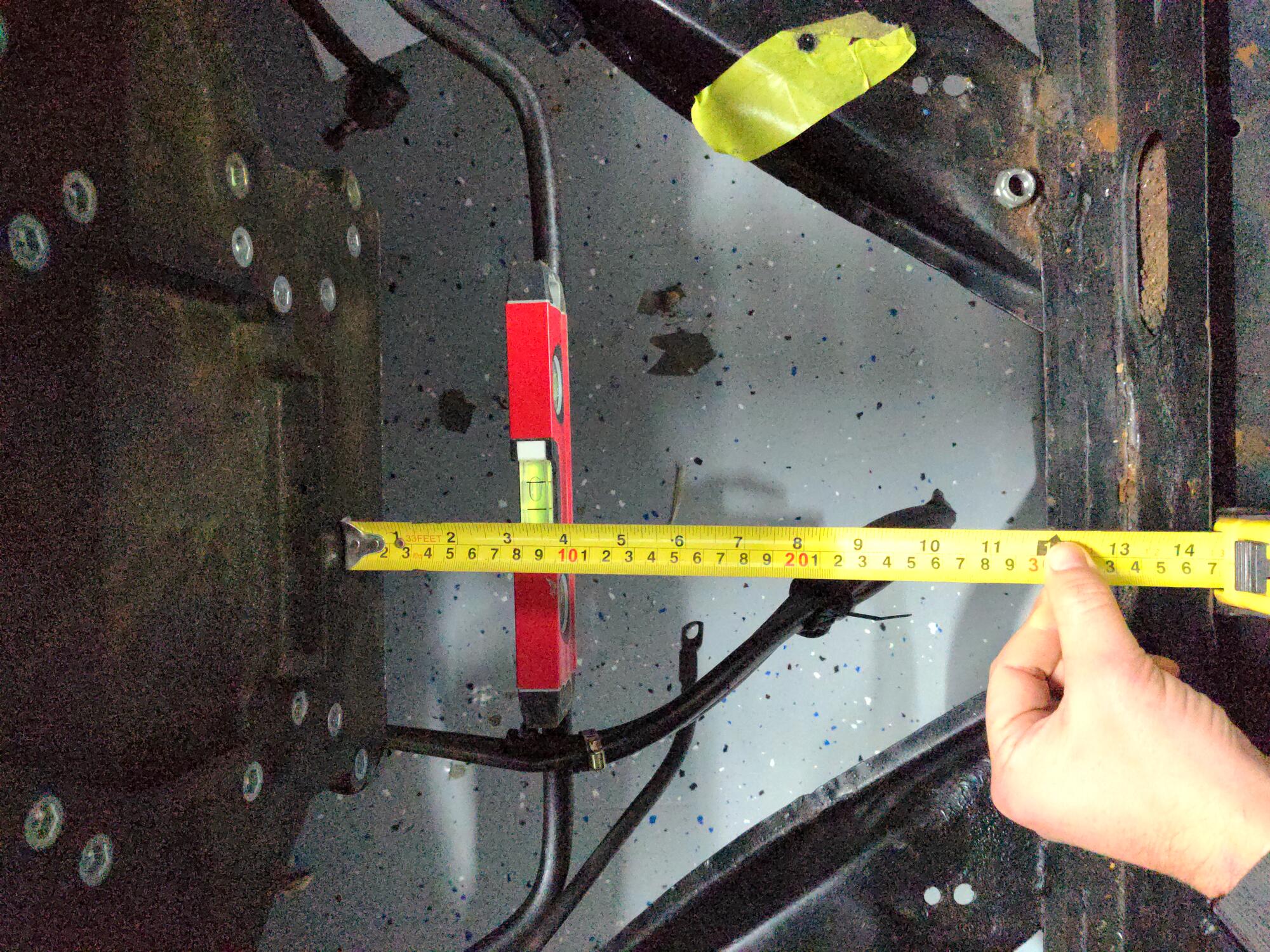

      That being said this is what room I have with the engine in its mounted position
      Radiator mount to engine block
      Name:  Rad to engine.jpg
      Block to firewall
      Name:  block to firewall.jpg

      As the owner of a 68 mustang sporting a stroked 351W with friends that pushed me hard to LS swap it....i can tell you one thing for certain. Plug changes will suuuuuck ;)
      I'm not a purist by any means but I just chose to stick with the SBF because that's the platform I'm more familiar with. But any time you start filling up space and inching closer to the shock towers, the worse it gets.

      https://www.rodshop.com.au/engine-mo...a-lsx-e~487499
      These are the ones I'm using.

      Yeah your not wrong mate. The passenger side is no sweat, the drivers side is tight, but 100% do-able. In fact I'd wager I may still have more more than you would have with the 351.
