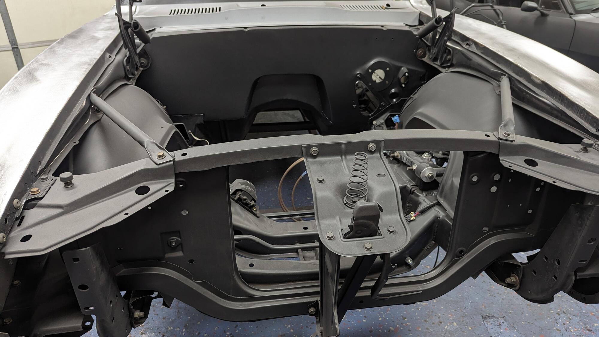

      On my bird I stich and full welds around the perimeter and used panel adhesive in the center. I painted the underside before applying the adhesive. I grinded some of the welds and applied body filler to smooth some of the edges.

      Thank you. Your install looks really clean. I like it.
