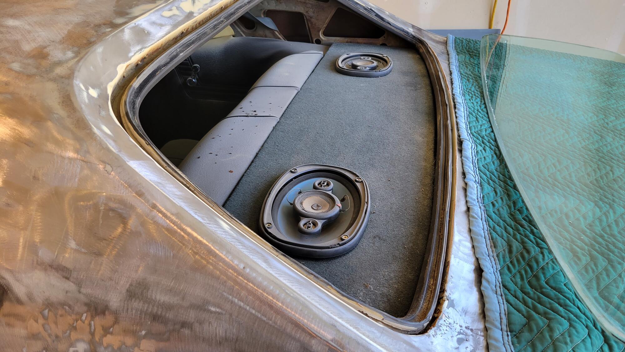

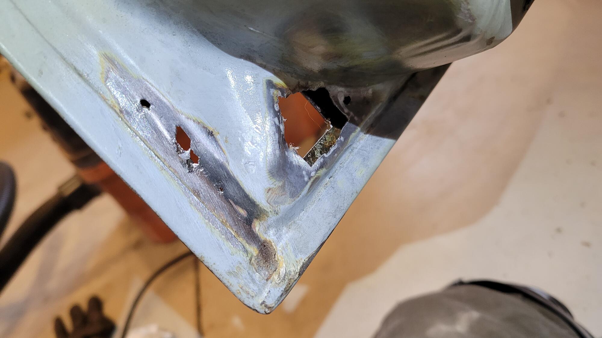

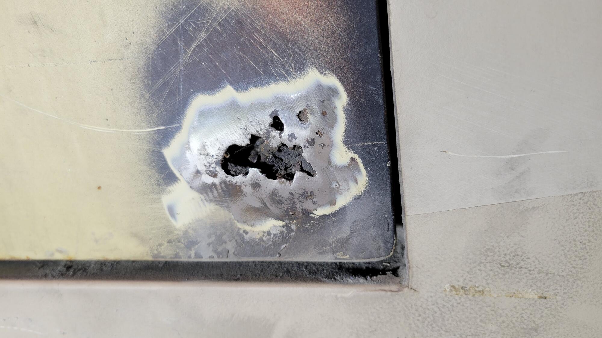

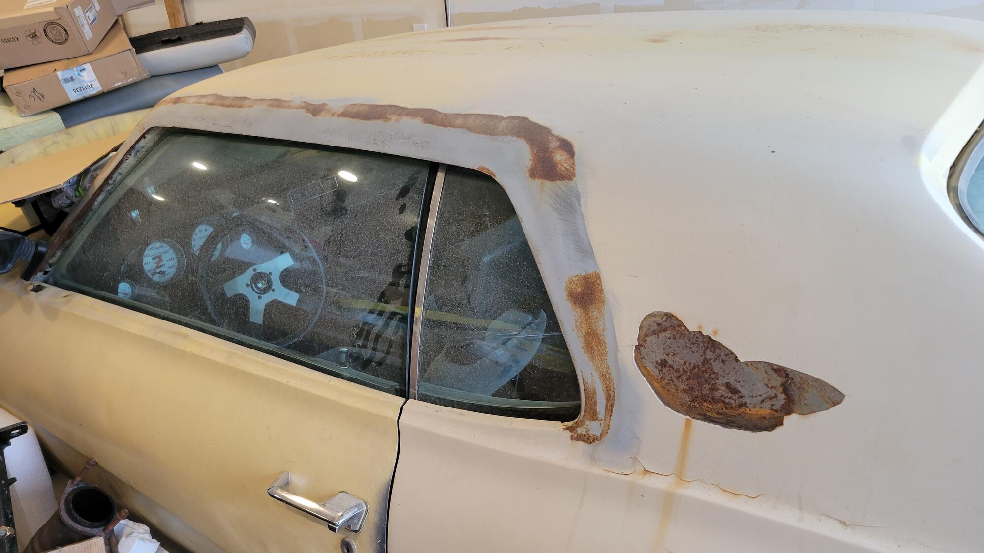

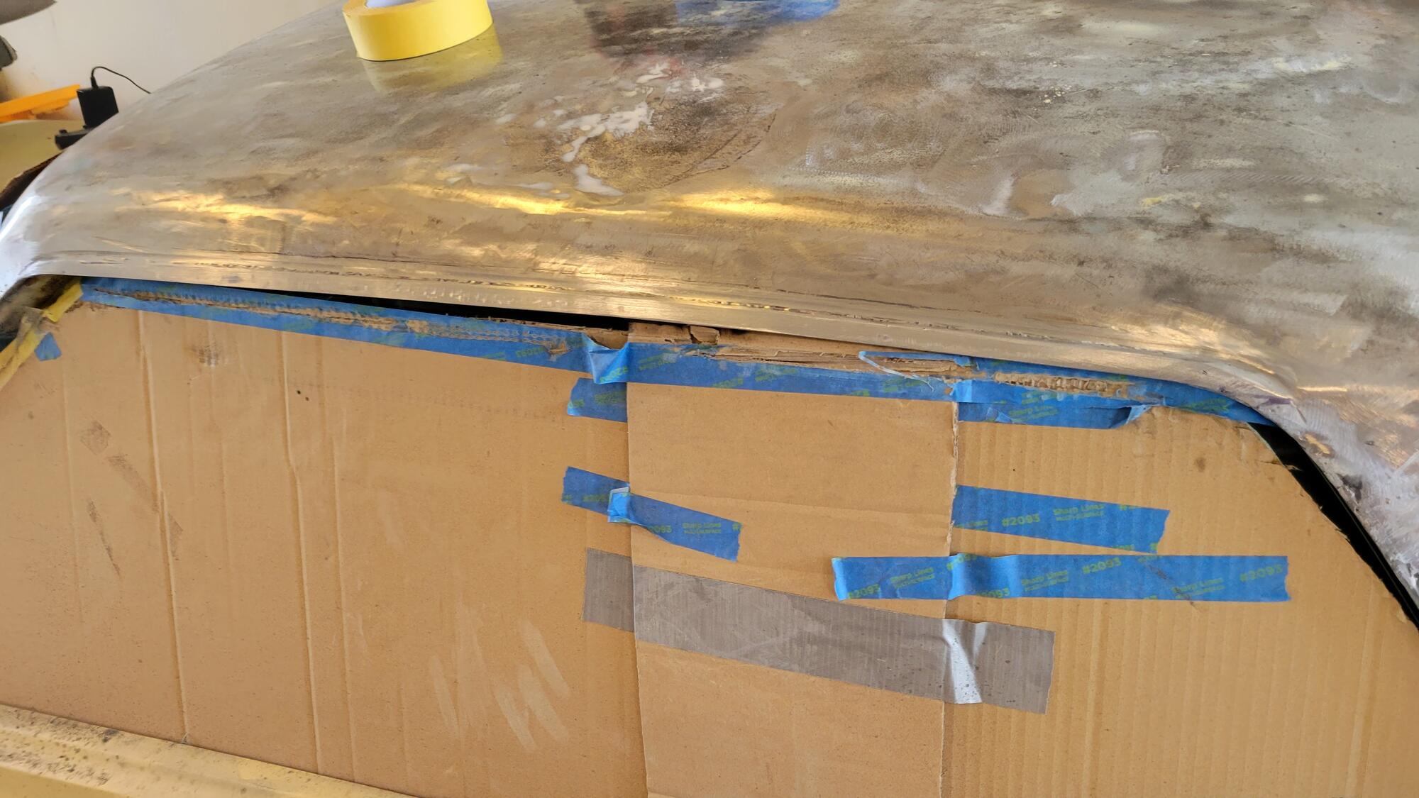

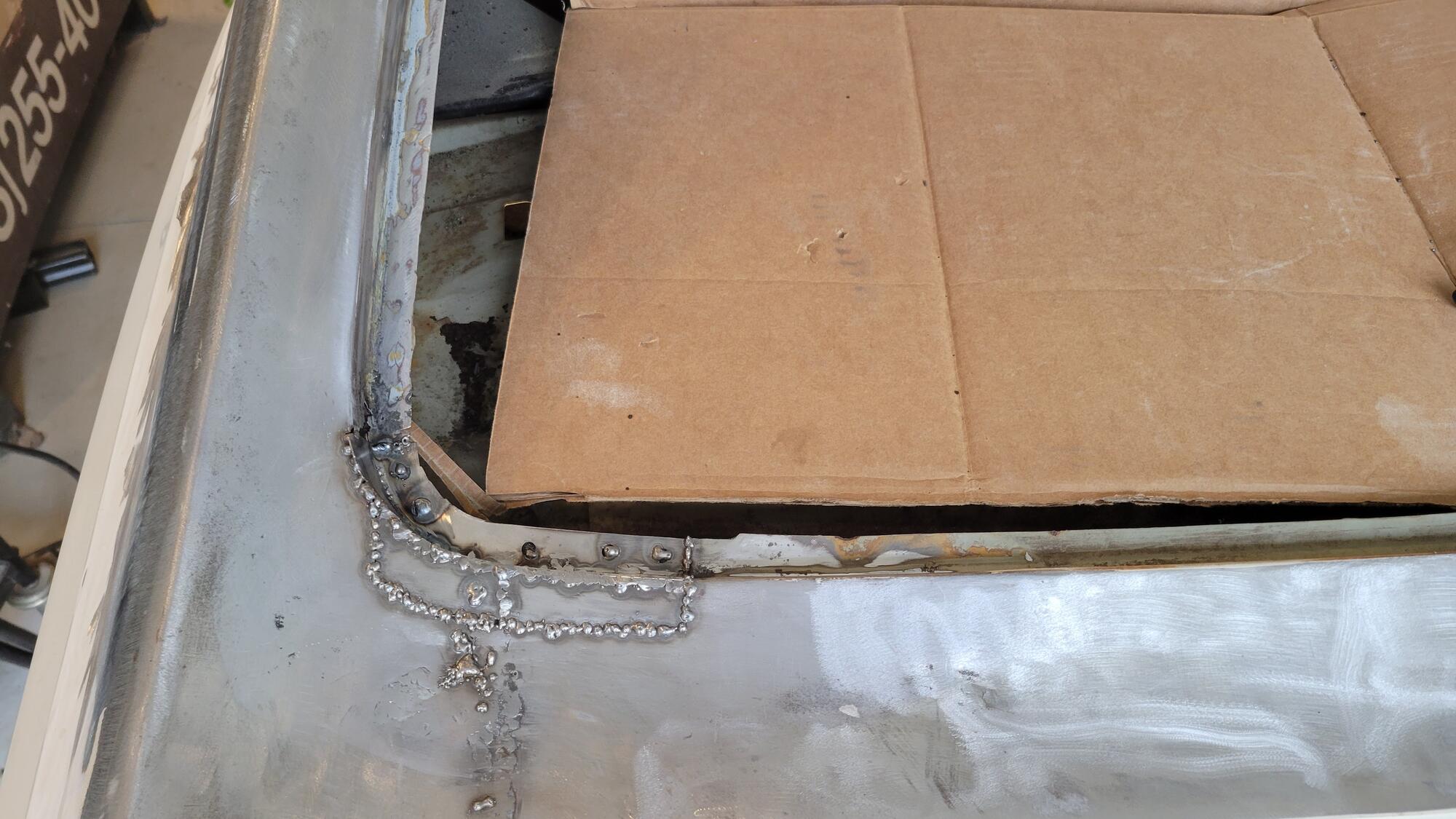

      Ha thanks. Here is some rust repair. Pulled the back window and began cutting and welding.Name:  20230903_102922.jpg

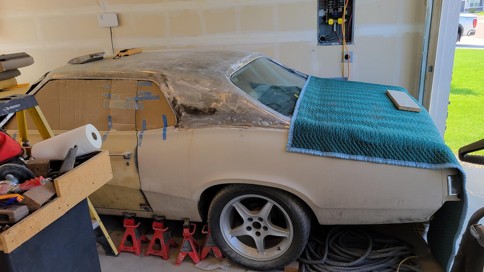

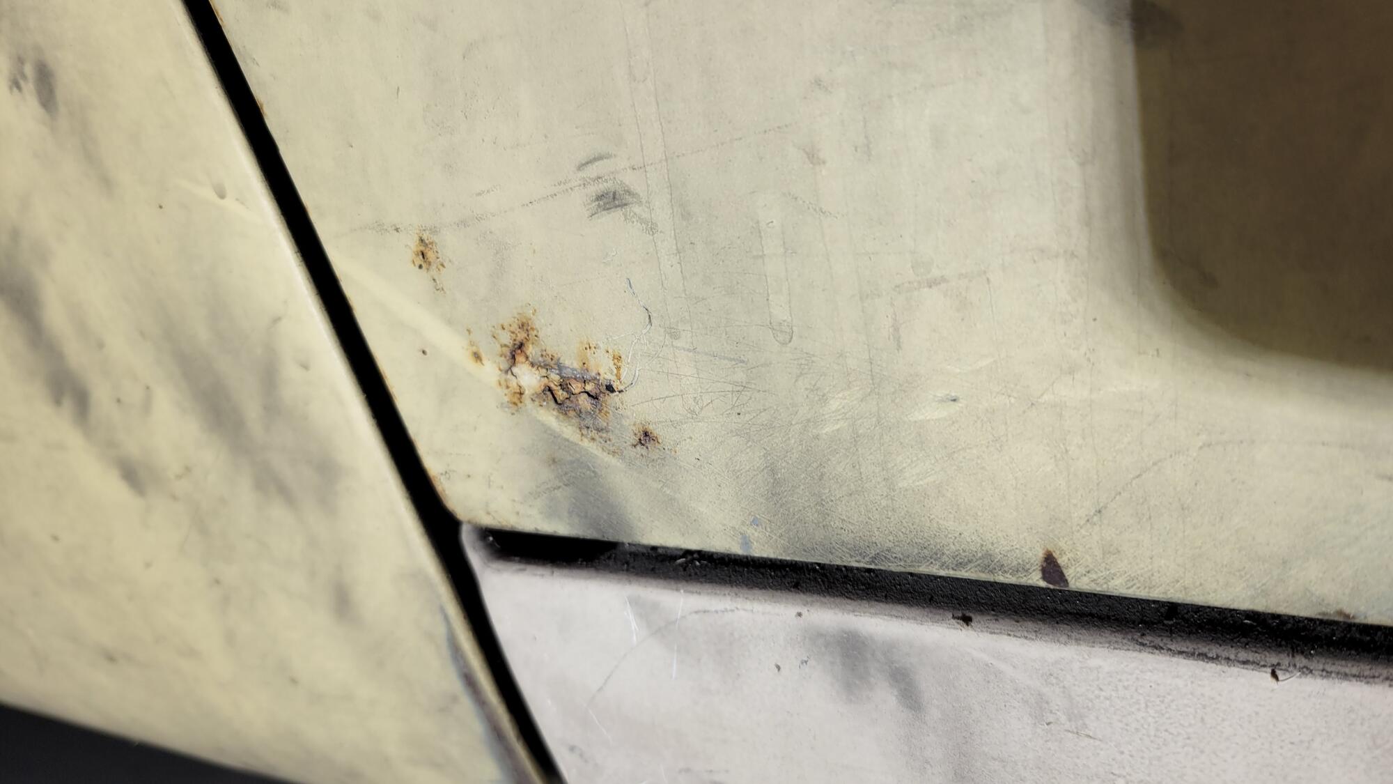

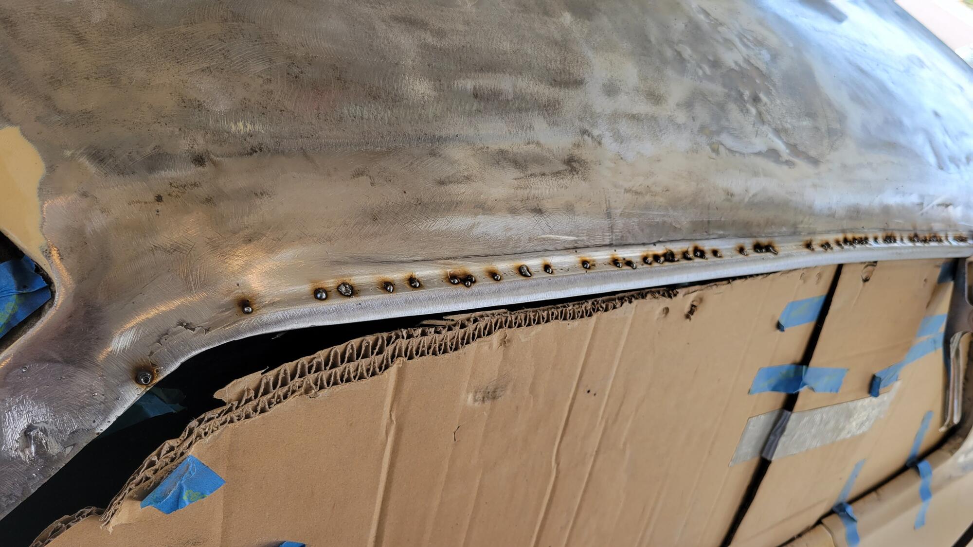

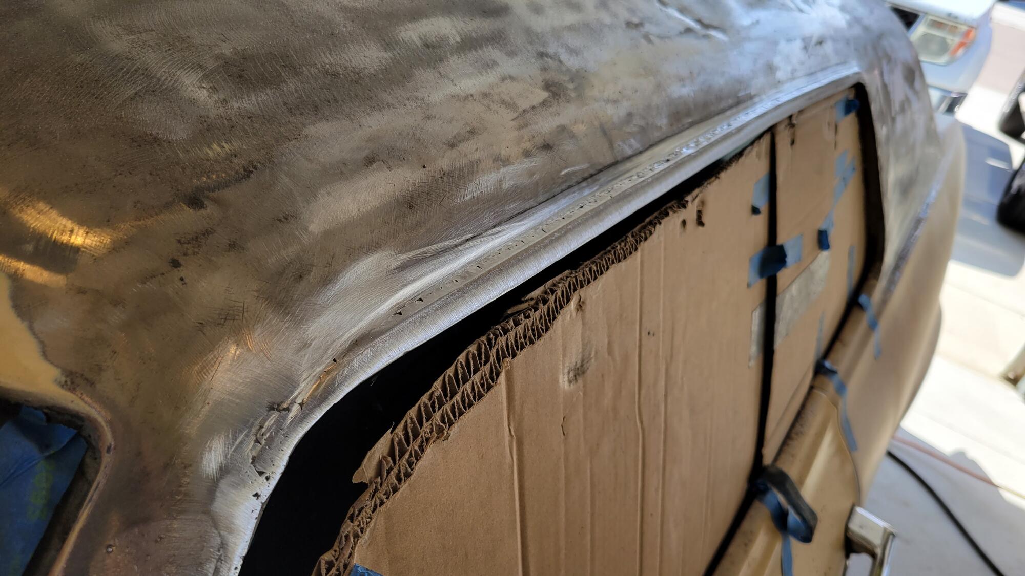

      I removed the drip rails years ago. Cut off a little too much. Had some repairs. I can't figure out how to post pics in order.....Name:  20230901_151808.jpg

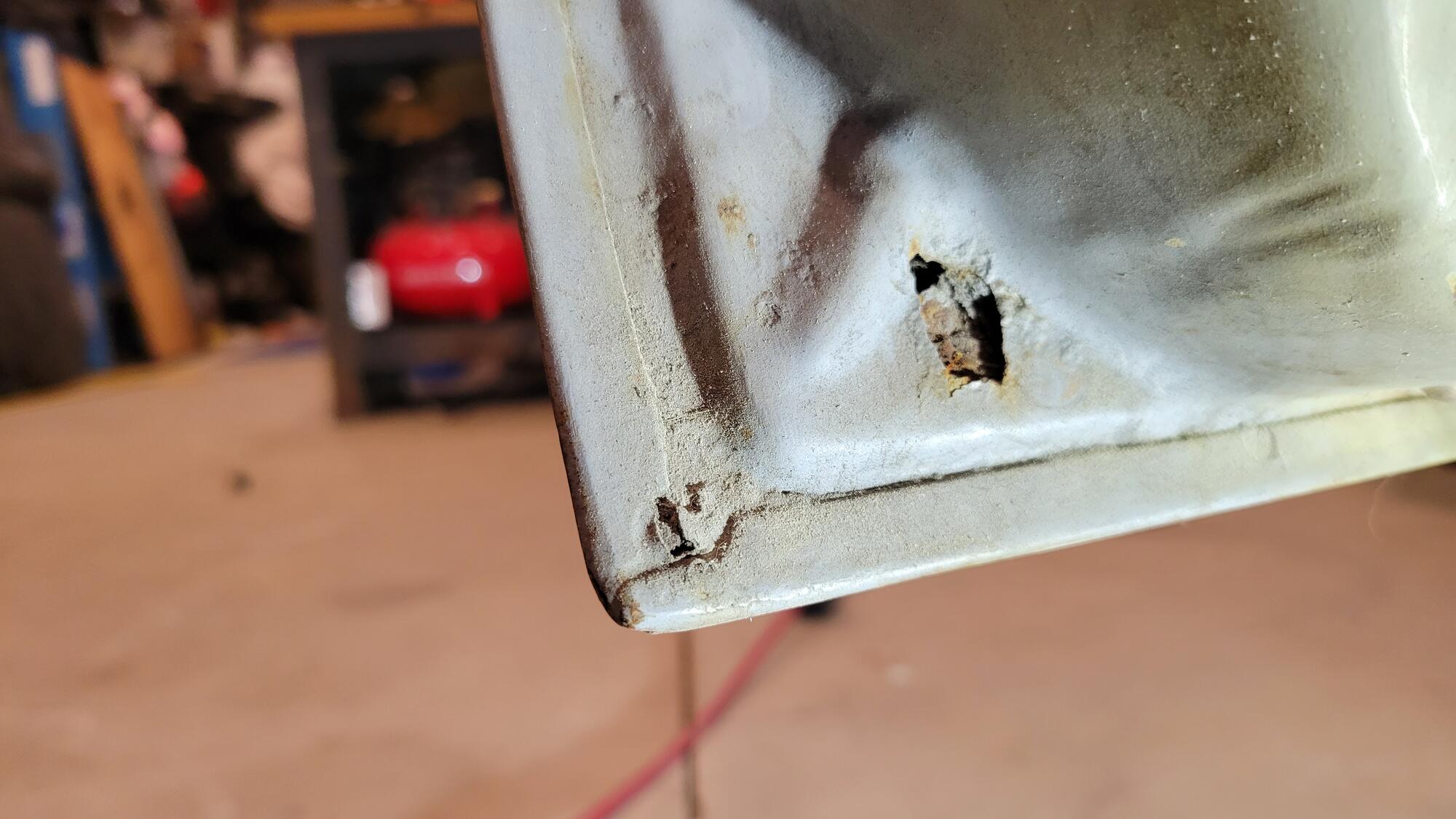

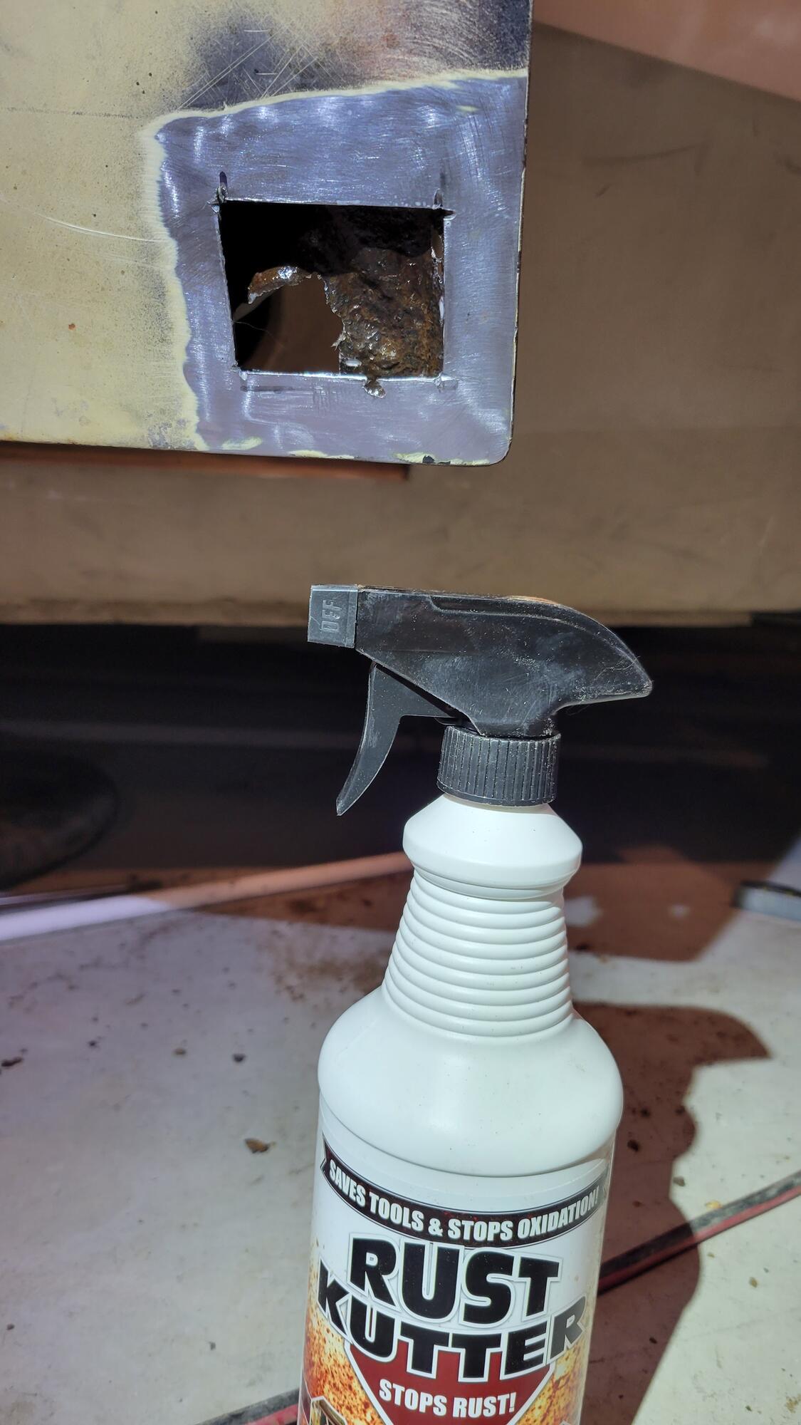

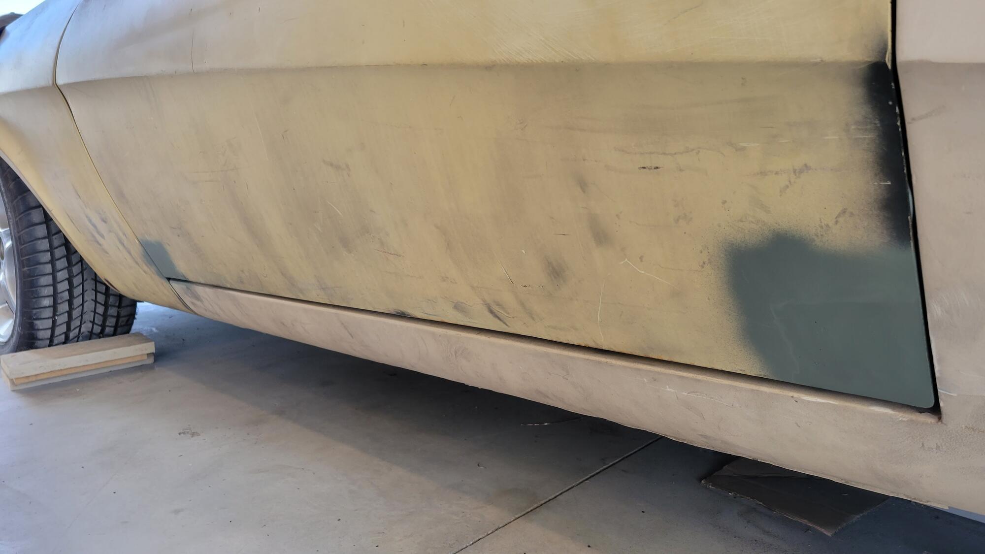

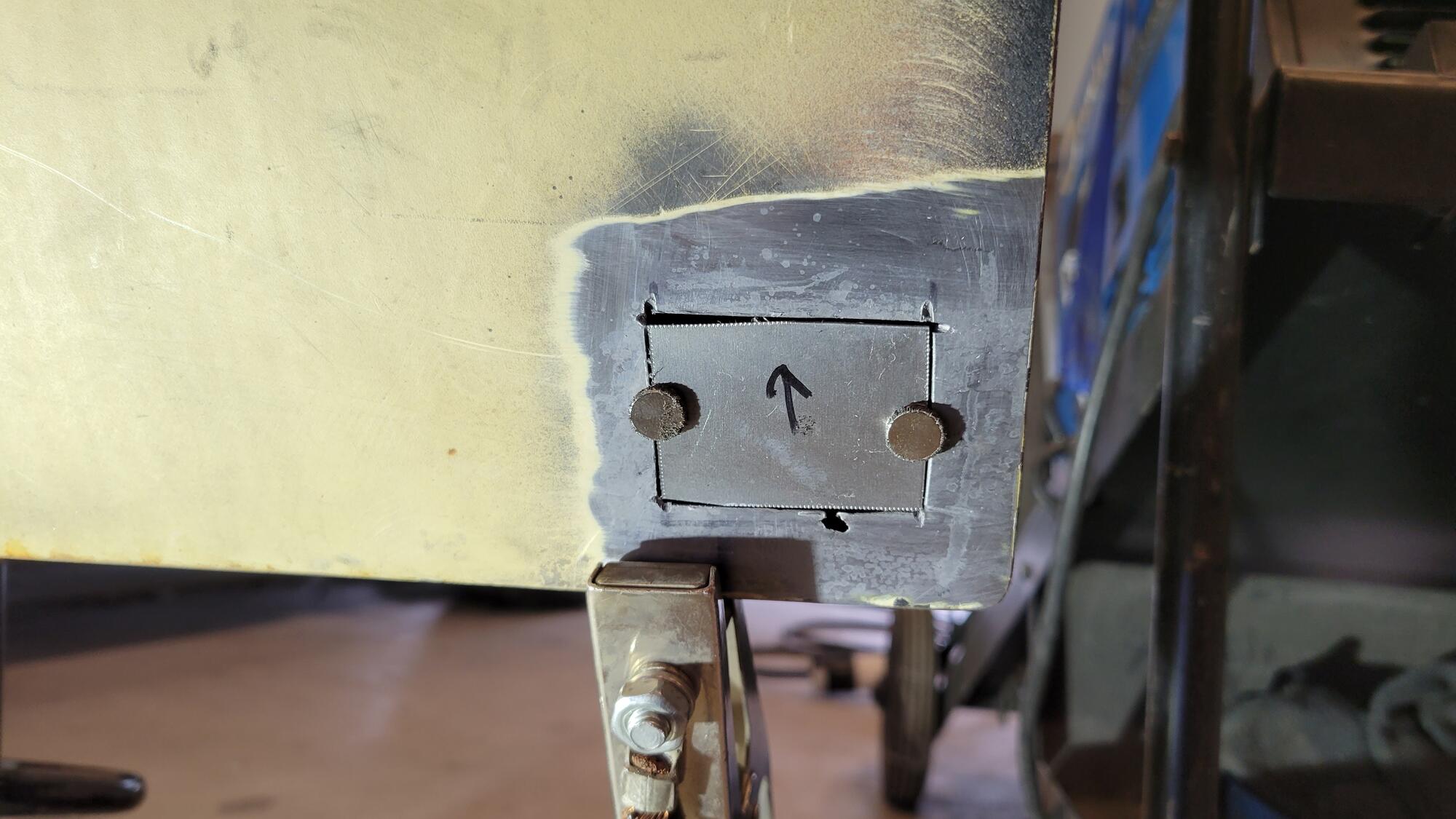

      Just did the driver side door rust repair. Name:  20231102_090257.jpg

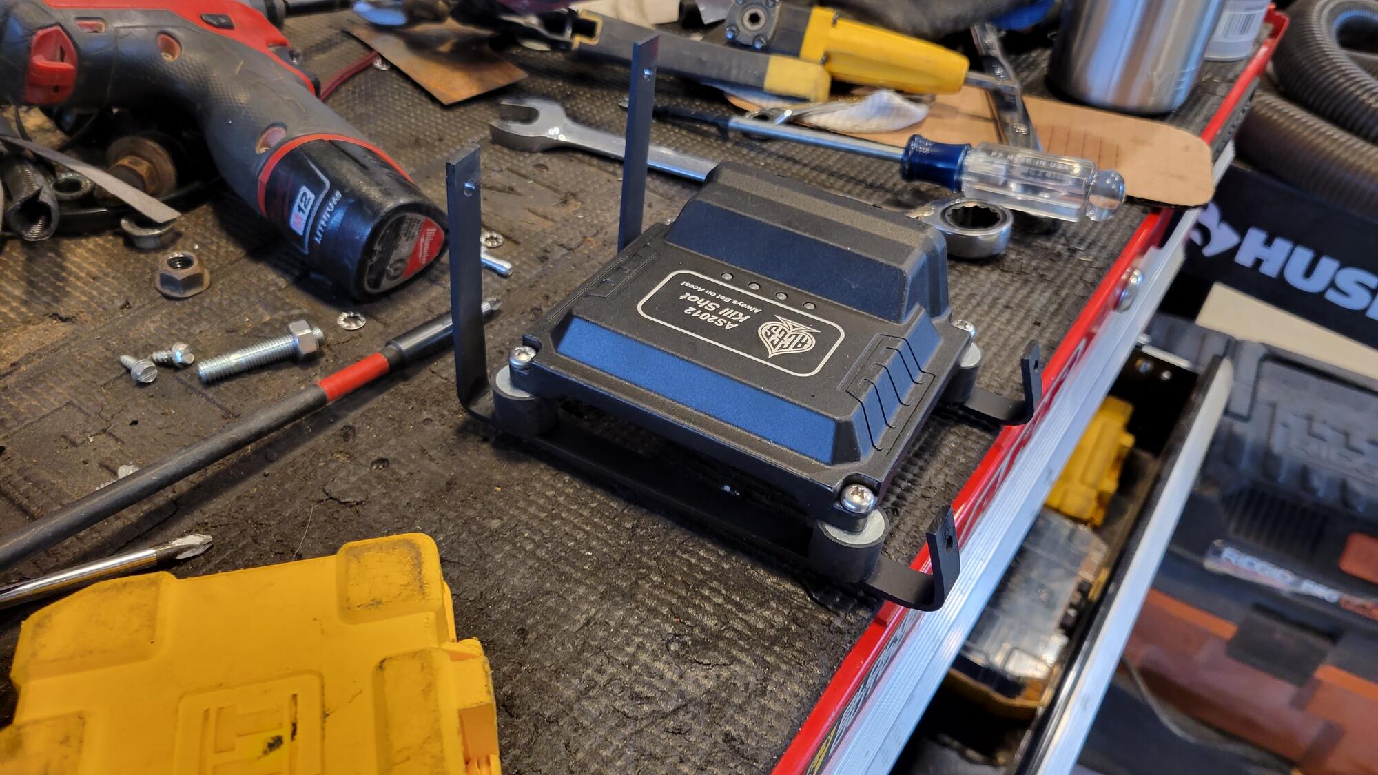

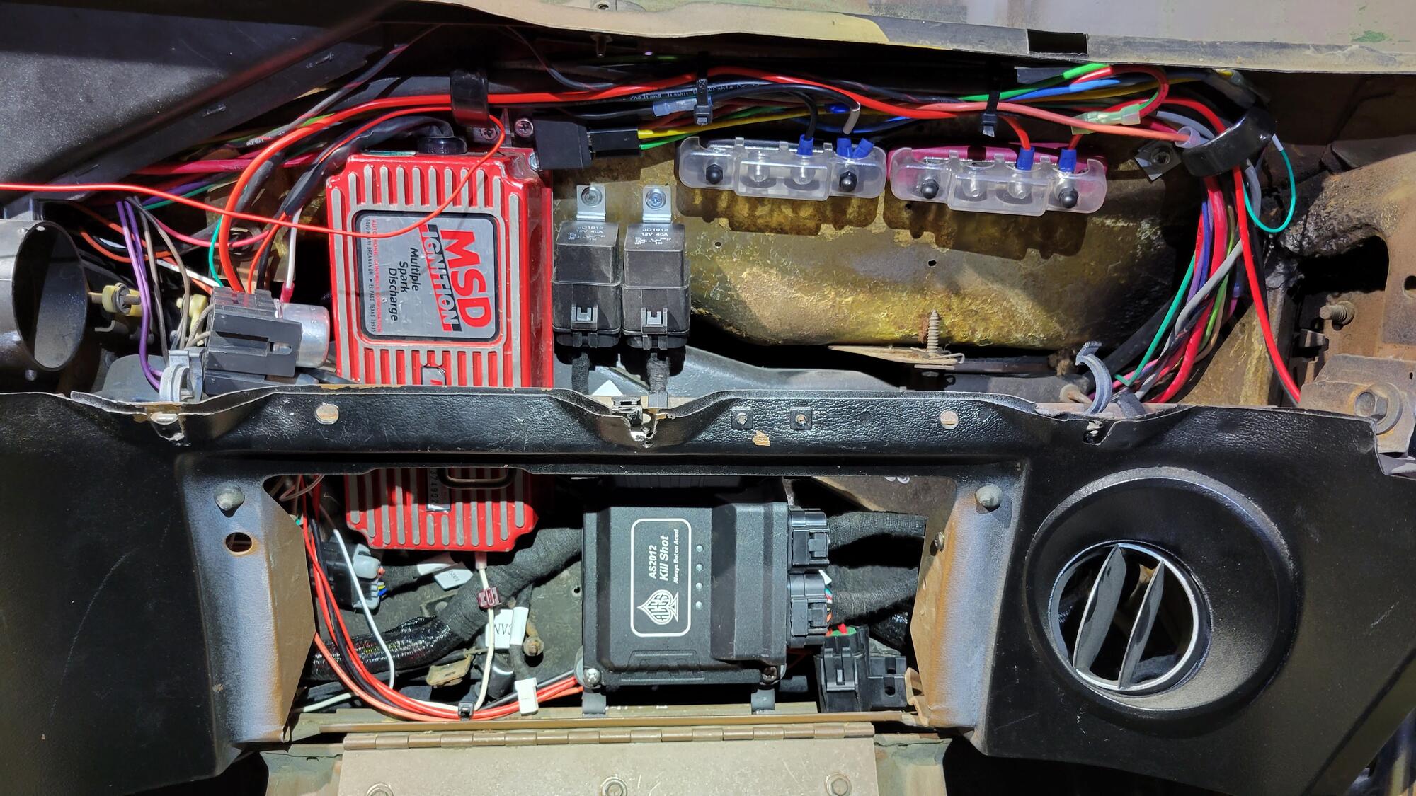

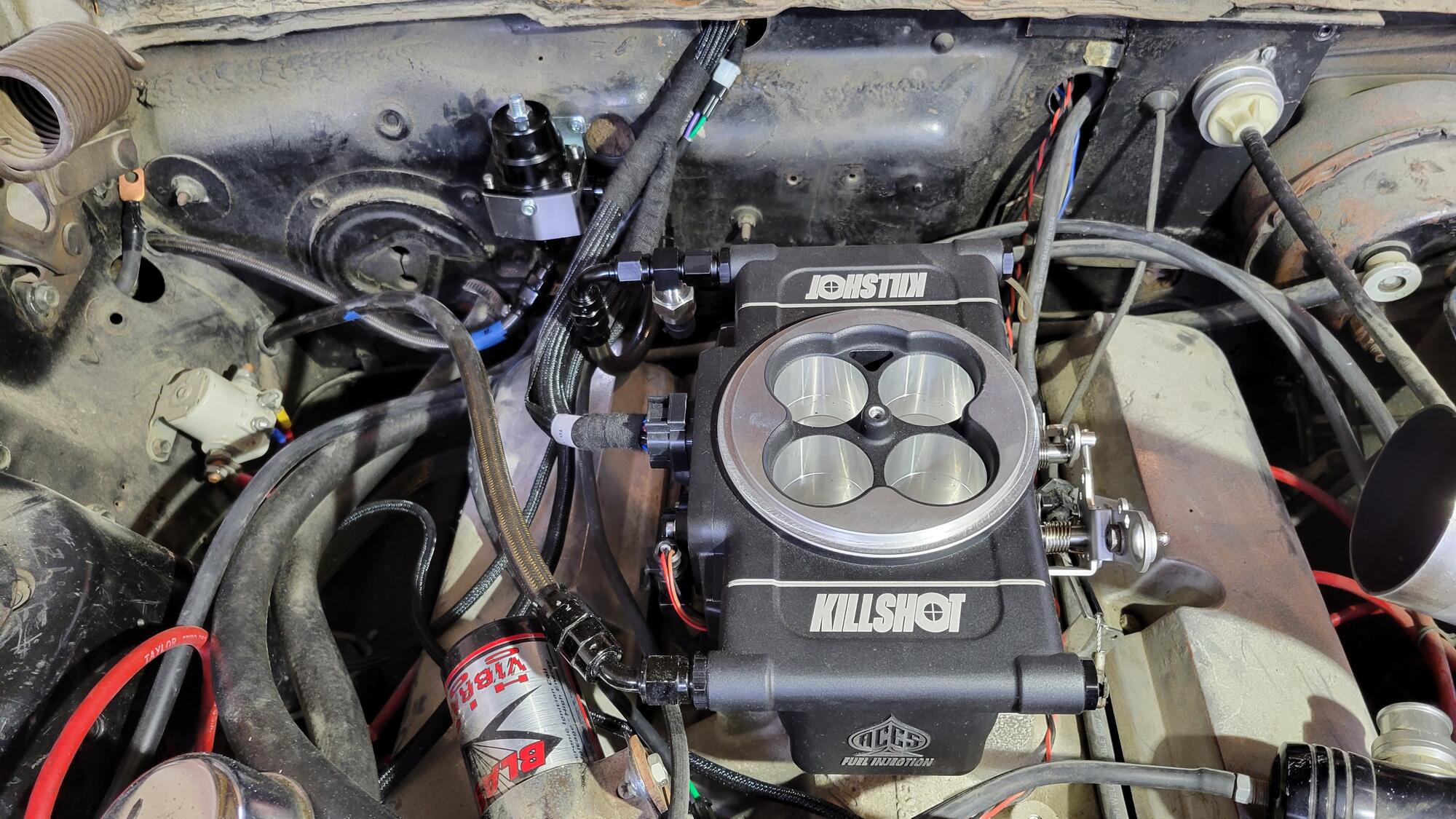

      I installed the Aces Killshot. Need to get vacume lines and a battery. I installed a no name fuel pressure regulator with the ptfe fuel lines for the needed 43 psi. This has -06 feed and return lines. A little more work before I can start it. I mounted the computer behind the dash.Name:  20231104_154708.jpg

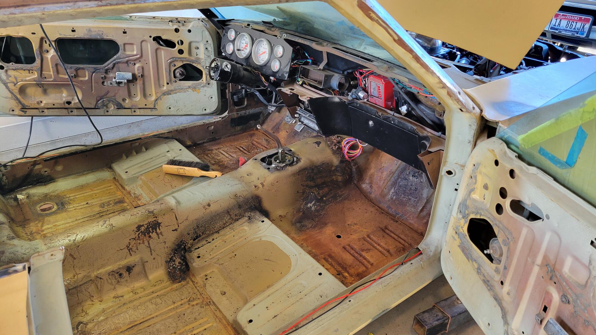

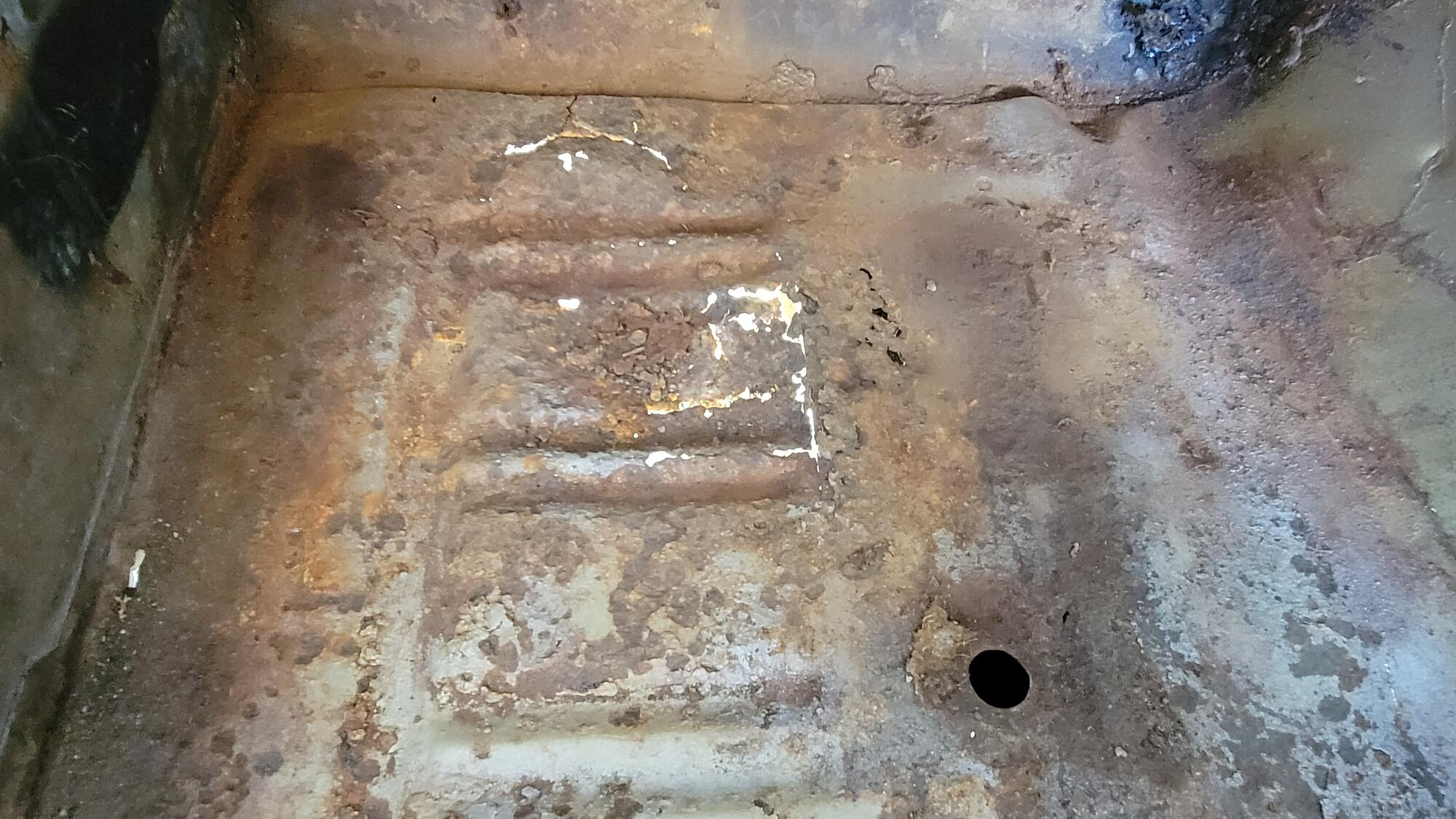

      Found some bad front floor pans. Plan to replace the fronts next winter. I would rather drive it while the weather is good.Name:  20240331_105640.jpg

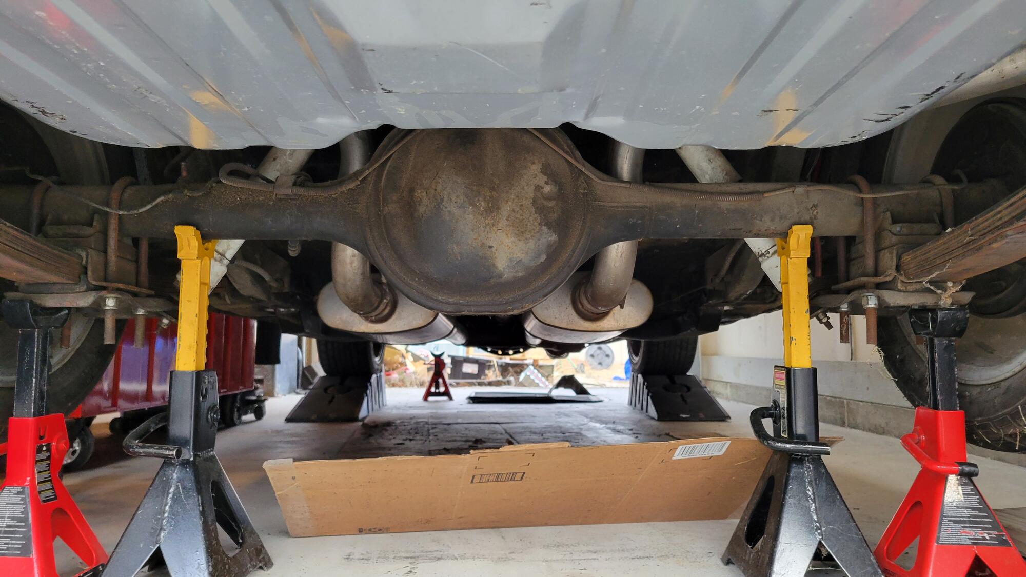

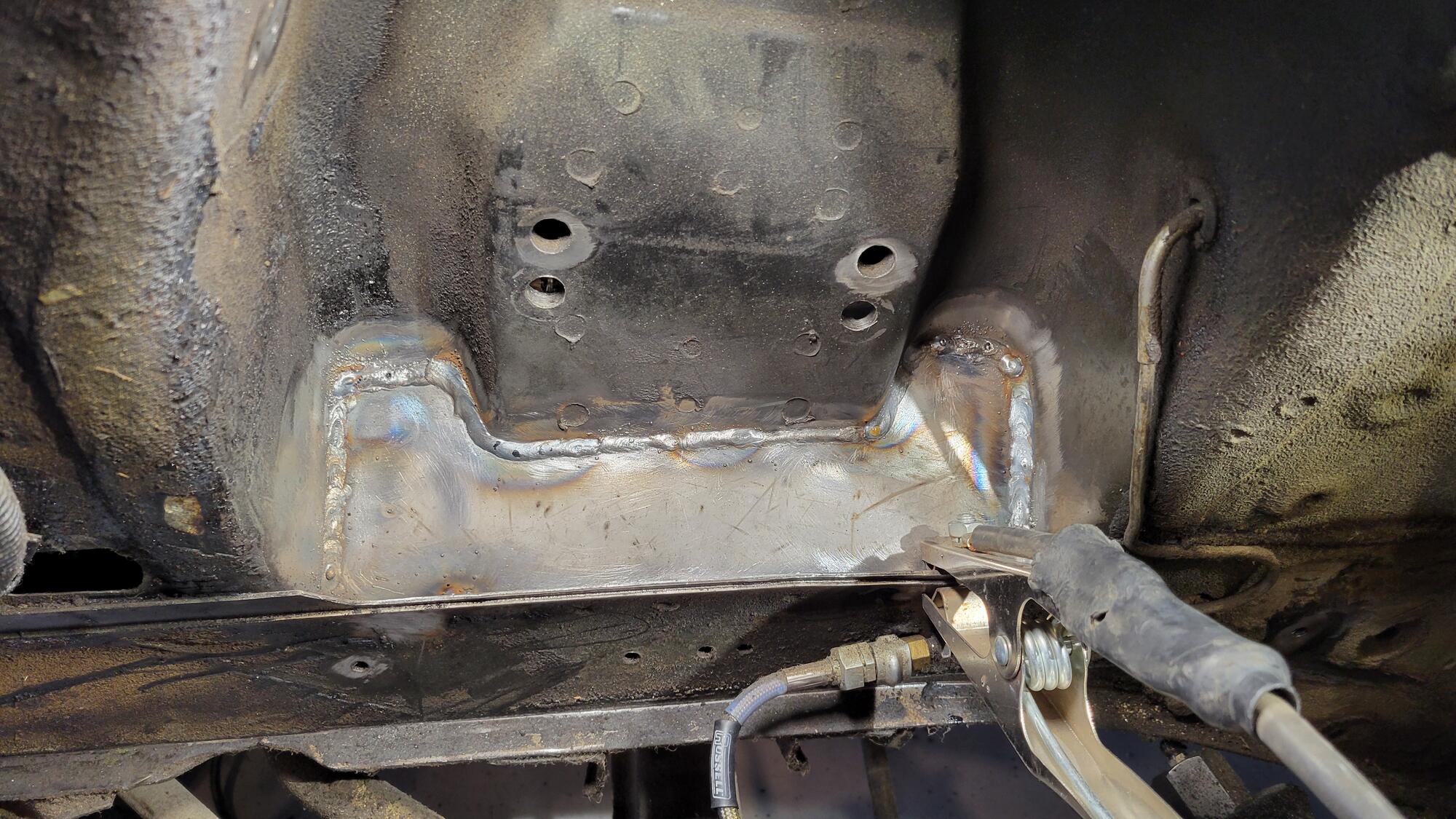

      I installed Tinman subframe connectors. Really nice, I highly recommend.Name:  20241109_144131.jpg
