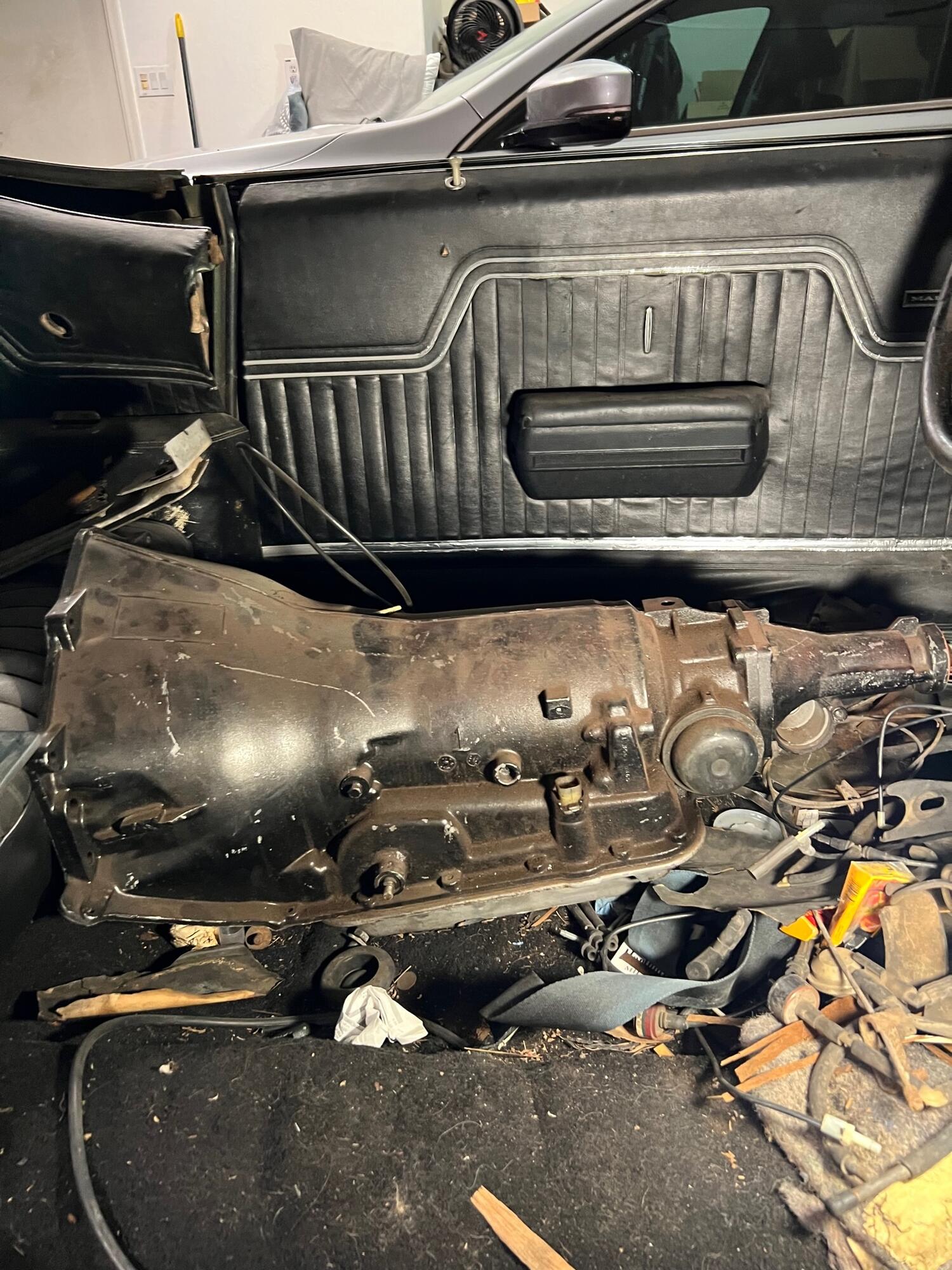

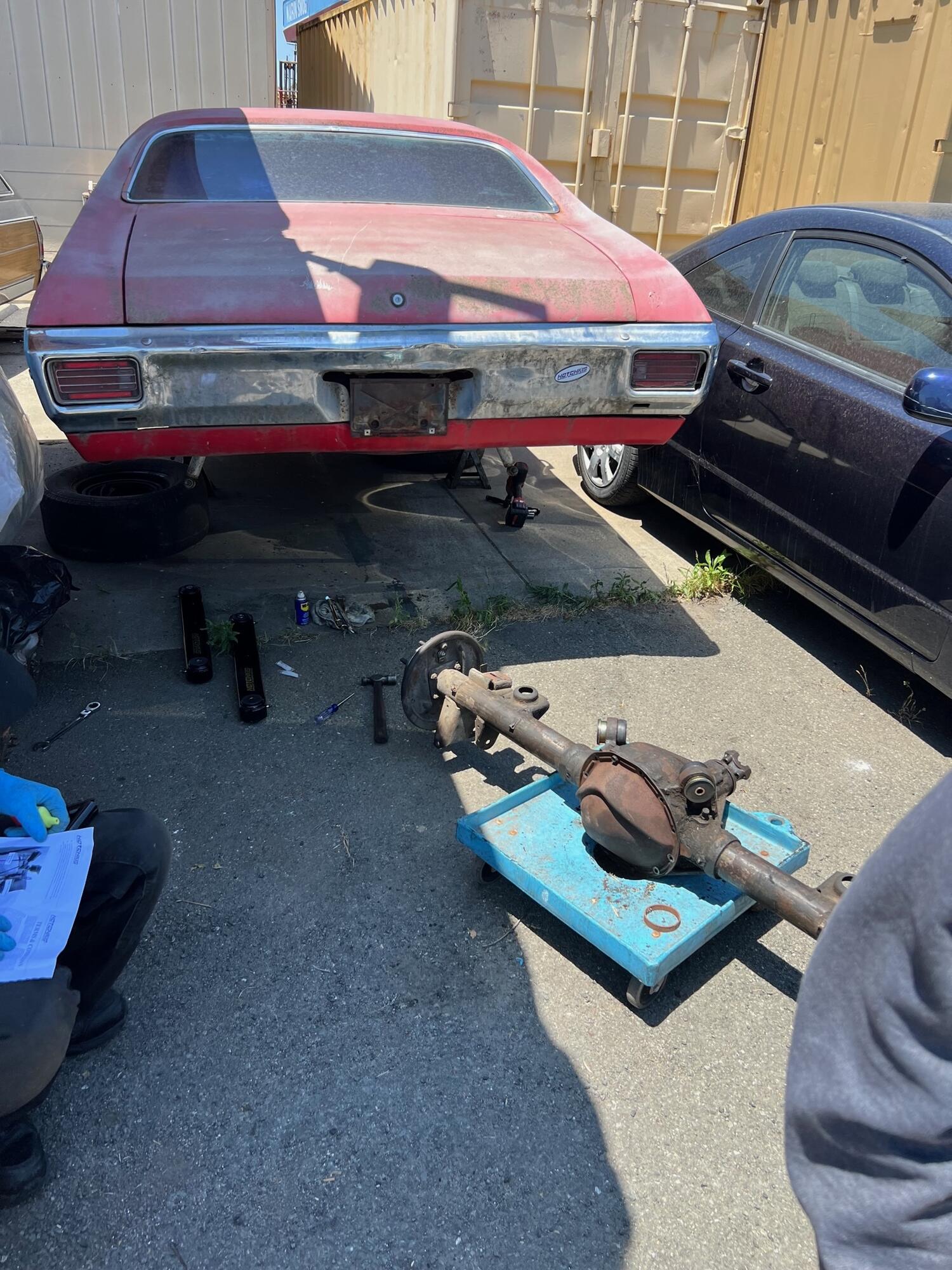

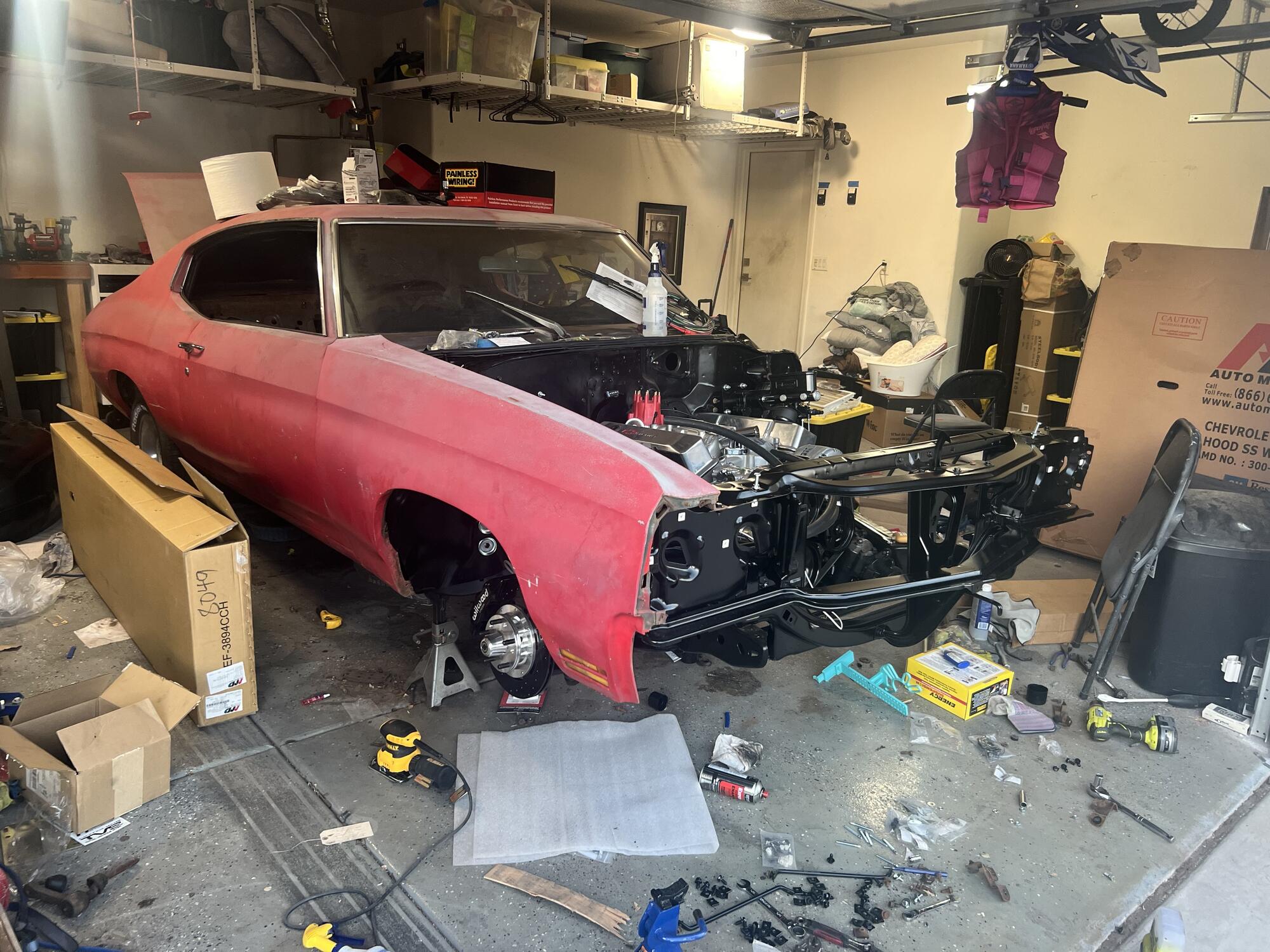

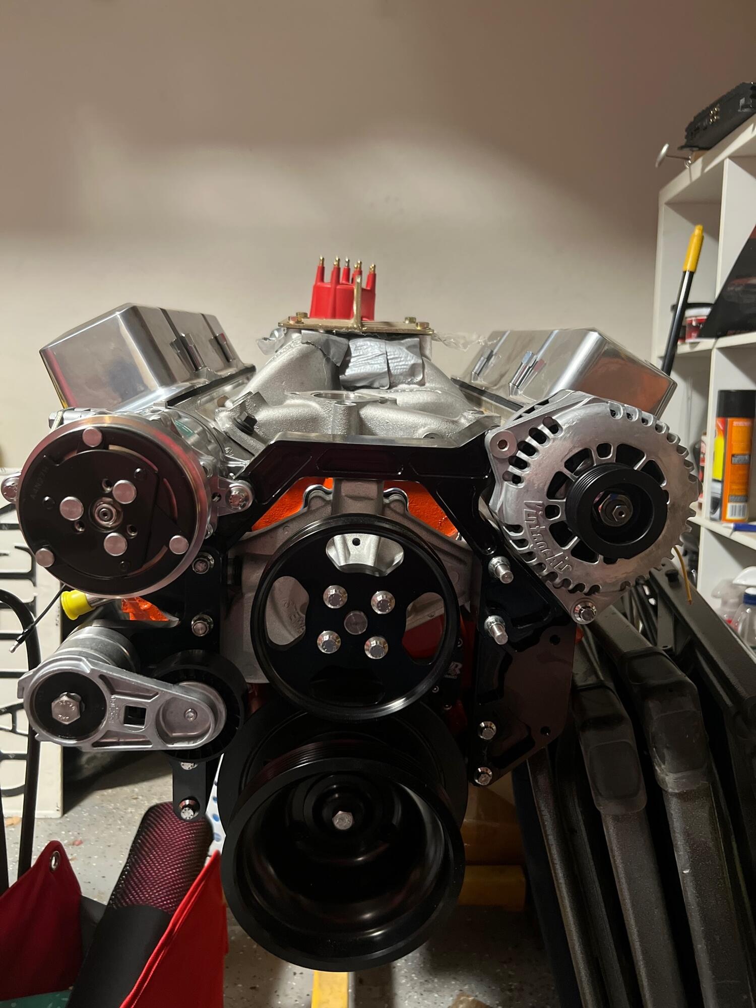

      First thing was digging this car out of my buddies shop and installing a 12 bolt with 4.11's with a hotchkis boxed control arms so we could get this ride on my trailer. The drive back to AZ from Northern California took 14 hours with my 5 year old and 2 year old boys. Finally got the car off the trailer with some help from my buddies. Rolled the 383ci full roller making 515hp in the garage that will eventually be mounted to a 700r4 that was built to withstand the power (fingers crossed). Installed my Vintage Air front runner. I then proceeded to tear down the front end to see how bad it was beyond the rough exterior. looks way worse than it is, nothing some wire brushes can't handle. Started a nice junk pile, coming soon to my local goodguys. Eventually i want to take the frame off and paint it, but for the time being i am only focusing on the front end which is the only place with surface rust on the frame due to a degreasing that stripped everything in the engine compartment back in 2007. Forgot to mention the last time this ride drove was in 2005. I thought the interior would have been worse than it was, but it is all surface rust too, even in the floor pans. Going to POR15 under the dash area after knocking most of the rust off. As i continue with more progress, i will keep adding pictures.

      Vintage air evap installed
      Since it’s been a waiting game for a lot of things to come in, I went a head and installed my vintage air evap after cleaning up the interior firewall.

      Engine and Transmission installed.
      Just dropped my 500hp 383ci stroker in, paired up to a built 700R4.

      Been waiting forever on springs and a new steering rack for the chevelle, finally came in and I was able to assemble the front suspension and brakes on this old beater.
