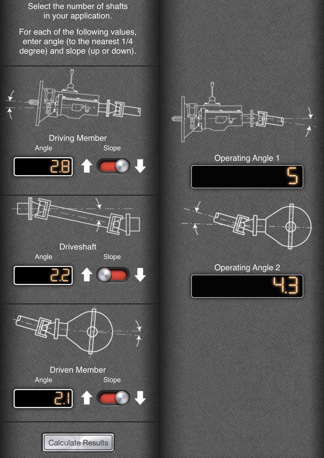

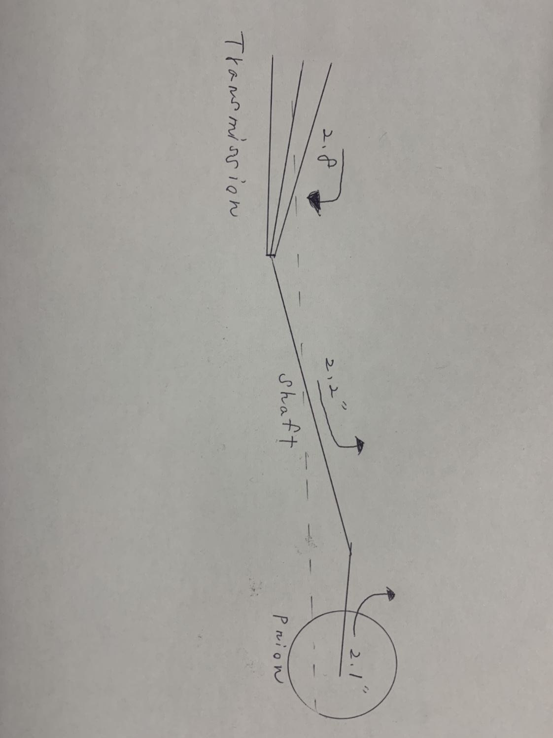

      1970 Camaro Is the pinion angle correct?
      Name:  スクリーンショット 2022-09-27 17.25.43.JPG

      Your pinion is higher than your transmission. It will likely vibrate. Raise your transmission as high as you can get it and reduce pinion angle. Ai least that is what I would do.

      Quote Originally Posted by dhutton View Post
      Don
      Do I need to raise the engine mounts as well?
      Lowering the ride height with coilovers raises the pinion.
      16,129
      Quote Originally Posted by Shotaro View Post
      No, just raise the back of the transmission as high as possible, leaving the engine mounts alone. Lowering the ride height in the rear changes the rear operating angle.
      Don
      I raised the transmission and the numbers changed a little. Correct?
      Correct. It will not be a big change, but it will be better.
      2.4 1.7 2.2 pinion angle
      Apr 2014
      JAPAN
      173
      Country Flag: Japan
      I haven't run it, but I changed it.
      2.4. 0.0. 1.7 nose down.
