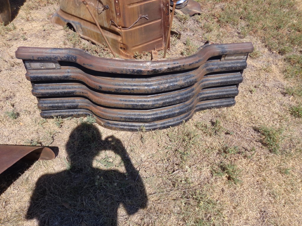

      I spent the morning doing hammer and dollie work on the front sheet metal. A little plastic will be all it needs. The upper grille bar was ugly when I started. It's a usable part now. Name:  DSC02749.JPG

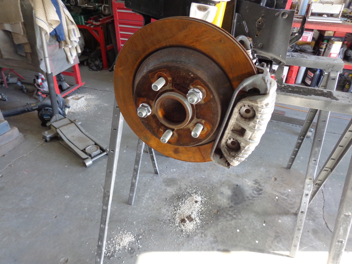

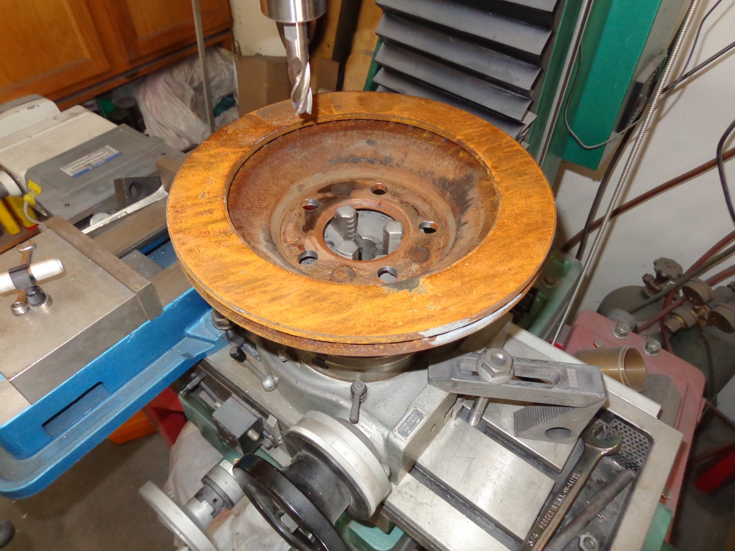

      O&S was in low gear but my 1st obstacle is almost completed. I put the vette suspension on 2 stands and removed the hubs. I found a bolt pattern template on the internet and printed it off. I could see there wasn't enough space to offset drill new stud holes. This is going from 4.75 to 4.5 bolt circle. I started looking for studs with the largest knurl I could find. I found a 16.5mm that was .100" less than I wanted. Turned out to be as large as I would find. Then it got interesting. That was a 14mm stud. The 2015 Mustang irs is 14mm. I picked up all the store had and ordered enough to do both front hubs. I have a 4.5 hub that I chucked in the rotary index table and set centers in the mill. I removed it and put the vette hub in. The center that goes in the wheel is the same size on both wheels. That made my offset correct. I milled a hole small enough to allow a press fit on the knurls. I removed the hub and used the press to install the studs. Then I used a spacer and nut to tighten them and make sure they were square. I test fit into a wheel and they fit as they should. I did a tack weld on the back side of the flange to insure the studs didn't come loose. Then I changed jaws on the rotary index table and put the rotors in and machined them with the same offset as the hubs. Having one setup from center allowed me to have a simple setup. Tomorrow when the rest of the studs arrive, I should be able to bolt some wheels on and start laying out some stuff.Name:  DSC02758.JPG

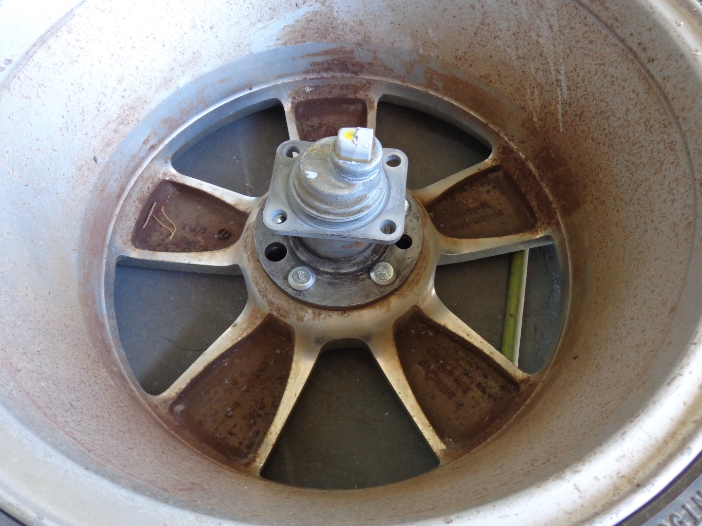

      Do you know how to make a vette look better? Put Ford wheels on it. LOL. One pic shows the clearance from the spindle to the rim with deep back space wheel. The hub conversion is completed. The pics are of the front end upside down to reveal the fiberglass spring. The real black part is the spring. The other pics are a rough location to show the 96" wheelbase. The c4 has 96". The AC Cobra was 90". That should make this interesting to drive.

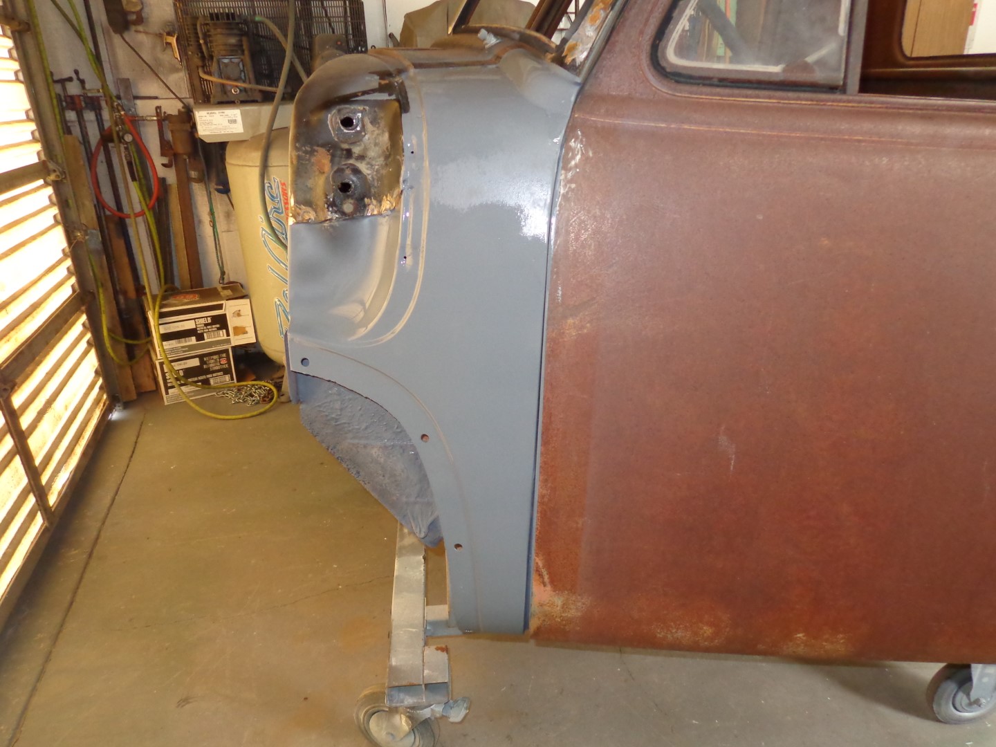

      O&S did a little today. I removed the left cowl panel and installed the replacement. I had trouble finding some of the spot welds to drill out. The rest of it was normal. I have a tiny bit of welding to do but for the largest part, it's done. One less item on the to do list. Name:  DSC02782.JPG
