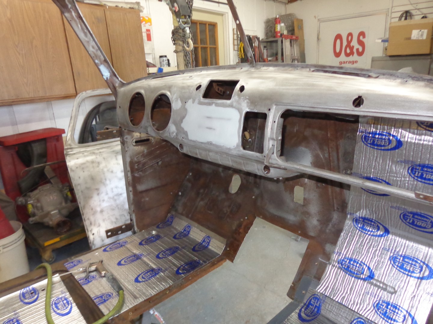

      O&S put in about a half a day. This consisted of using an angle grinder and a wire brush cup to aide in removing rust. It sure does get heavy above the head when using. More sanding and then laying down some sound mat on some easy areas. I had 2 boxes and wanted to see how much more I will need. Sure seems like I need a lot more than I used to on a project. That was 30 sq. feet.

      O&S has had enough fun for the day. Whether it turns out to be right or wrong, I welded a panel in where the factory speaker grill was. I filled the 2 holes on the right side of the gauge cluster. I put seam sealer in all of the places that I was aware were in need at this point. Most areas have been sanded with 220 and I started masking to paint the inside and firewall. That took almost a whole day!!!!! O&S at it still. LOL.Name:  DSC03621.JPG

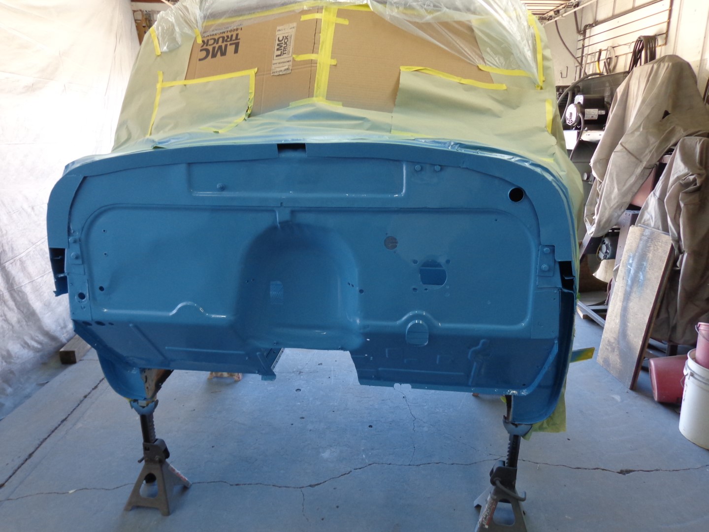

      O&S took advantage of mild weather and painted the firewall and inside of the cab. I use that term loosely. Doing the inside of the cab is a challenge for me. There's times I almost dig my siphon gun out of the cabinet and see if it will still spray. The cup on top limits where you can be. I painted the floor to help with the adhesion of insulation. On one of the other projects I had some dry overspray. I couldn't get enough glue on that to hold the mat on. Lesson learned, one of many. There will be interior panels in many areas on the inside. I painted the console even though my plan is to glue fabric on it.Name:  DSC03626.JPG

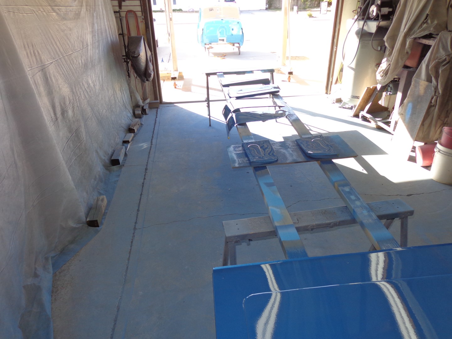

      O&S has got them blues. Slowly making progress. Weatherman says I have 6 decent days ahead. I hope he's right. Name:  DSC03631.JPG

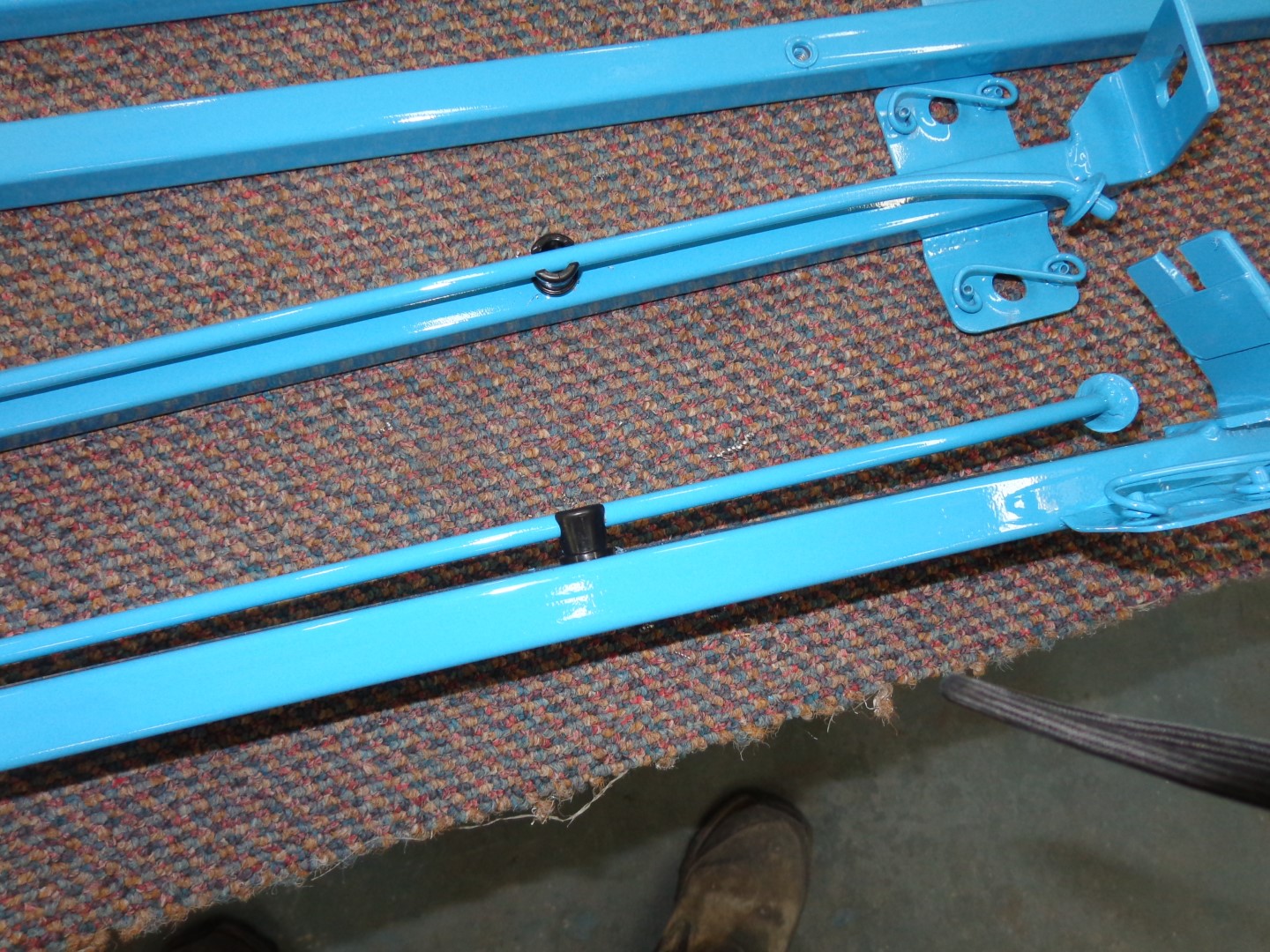

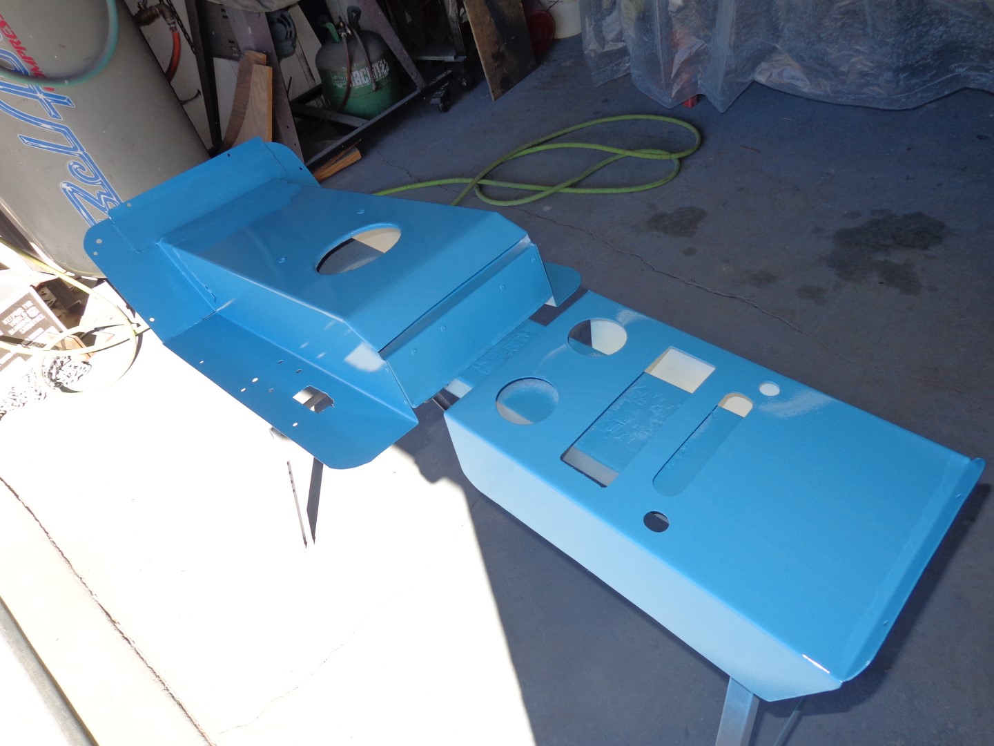

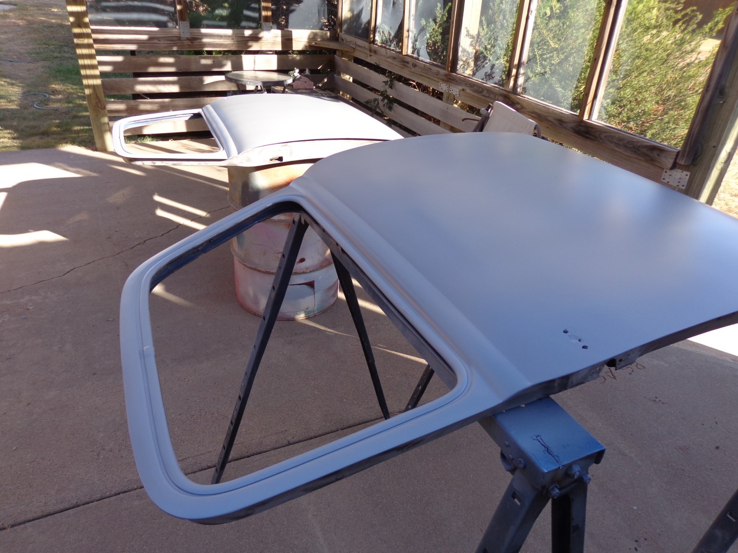

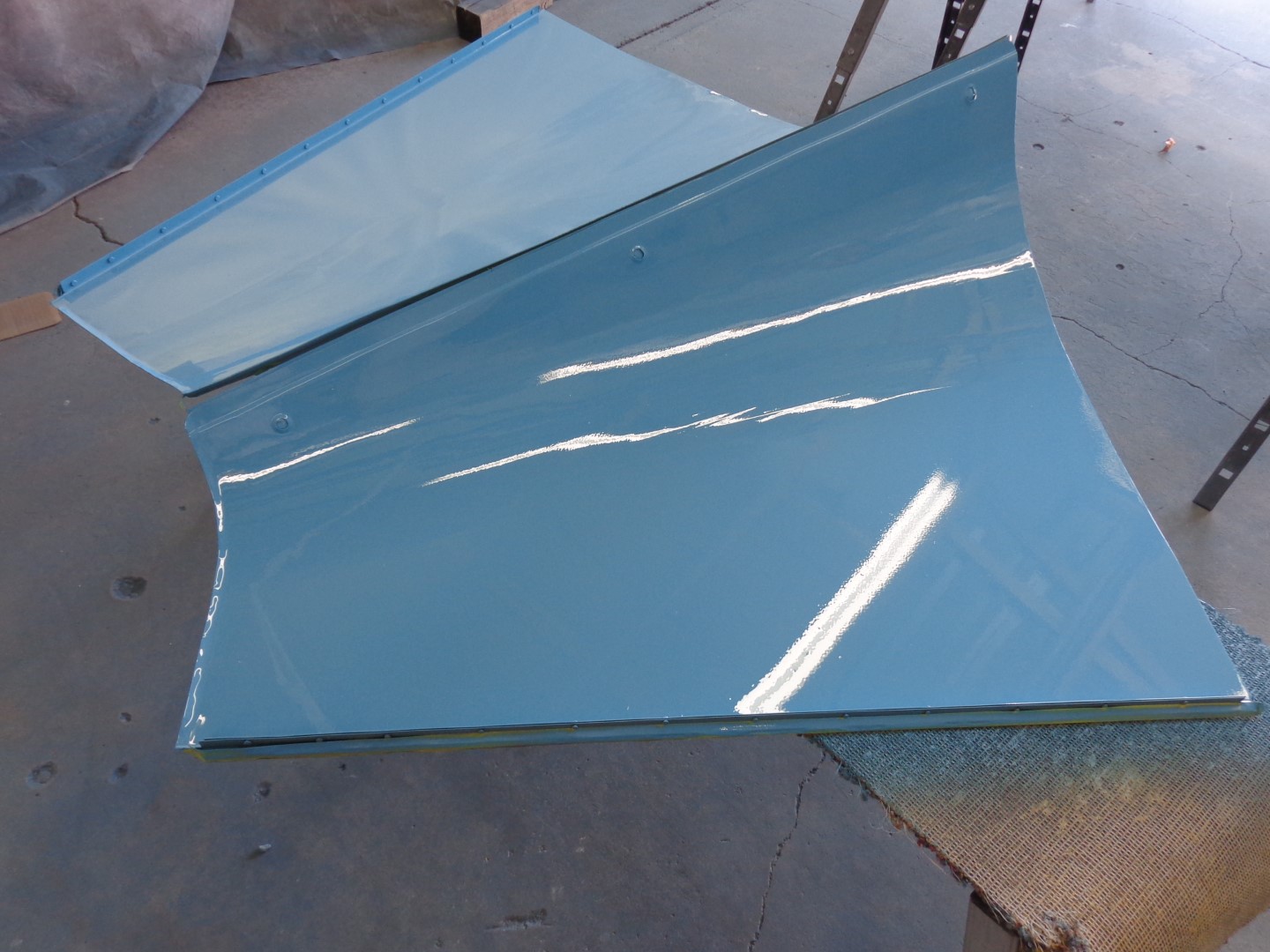

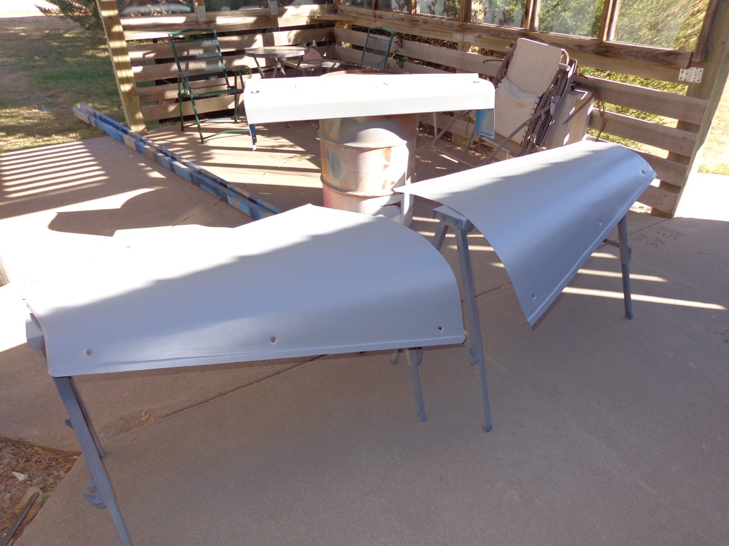

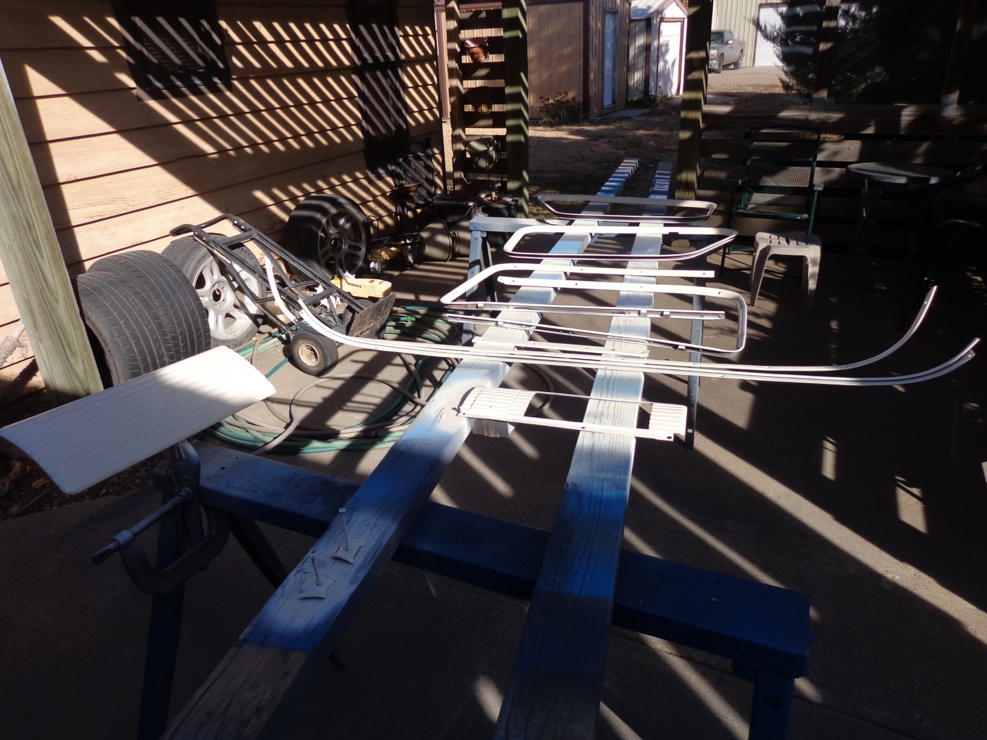

      The weather god is still being kind to O&S. However, today was not fun. The pics show the hood and roll pan in the 2nd app of primer. The doors had some bad spots that weren't going to clean up so I blocked them and shot the spots for no. 3. Next was the not fun part. Hanging the parts wasn't too bad. Trying to make sure everything is blue was tedious for a blind old guy. The cab sat outside this afternoon in the sun. That's my high temp baking booth. I know that the paint is supposed to be done catalyzing after 8 hours. Exp. has shown that the primer still shrinks. If I had the privilege of time, it would sit for a week.Name:  DSC03641.JPG

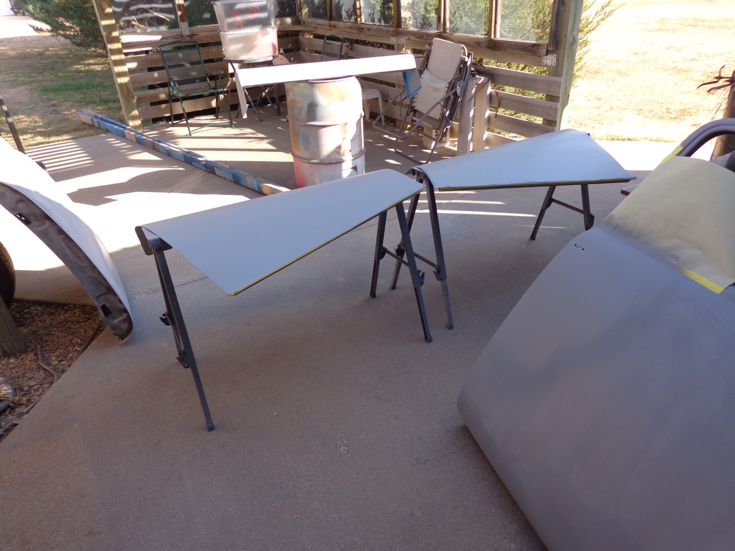

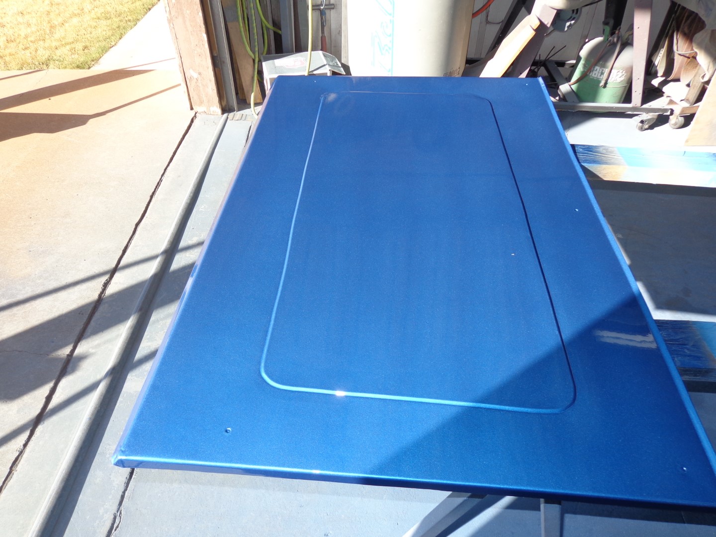

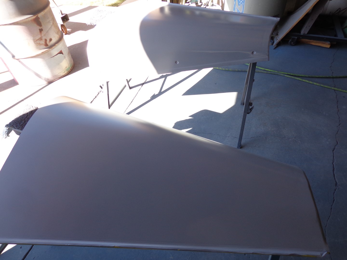

      O&S started out the day by installing Notchhead parts to hold the hood and bed cover support rods in place. Not cheap but look pretty good. It will be interesting to see how long they last with repeated removal of the rods. I blocked the outside of the doors and hood panels. The hood will need one more app of primer. I shot what I believe is the last of the plain blue parts. In case anyone is curious, that was 5 qts. of mixed material on all of the blue parts.Name:  DSC03643.JPG

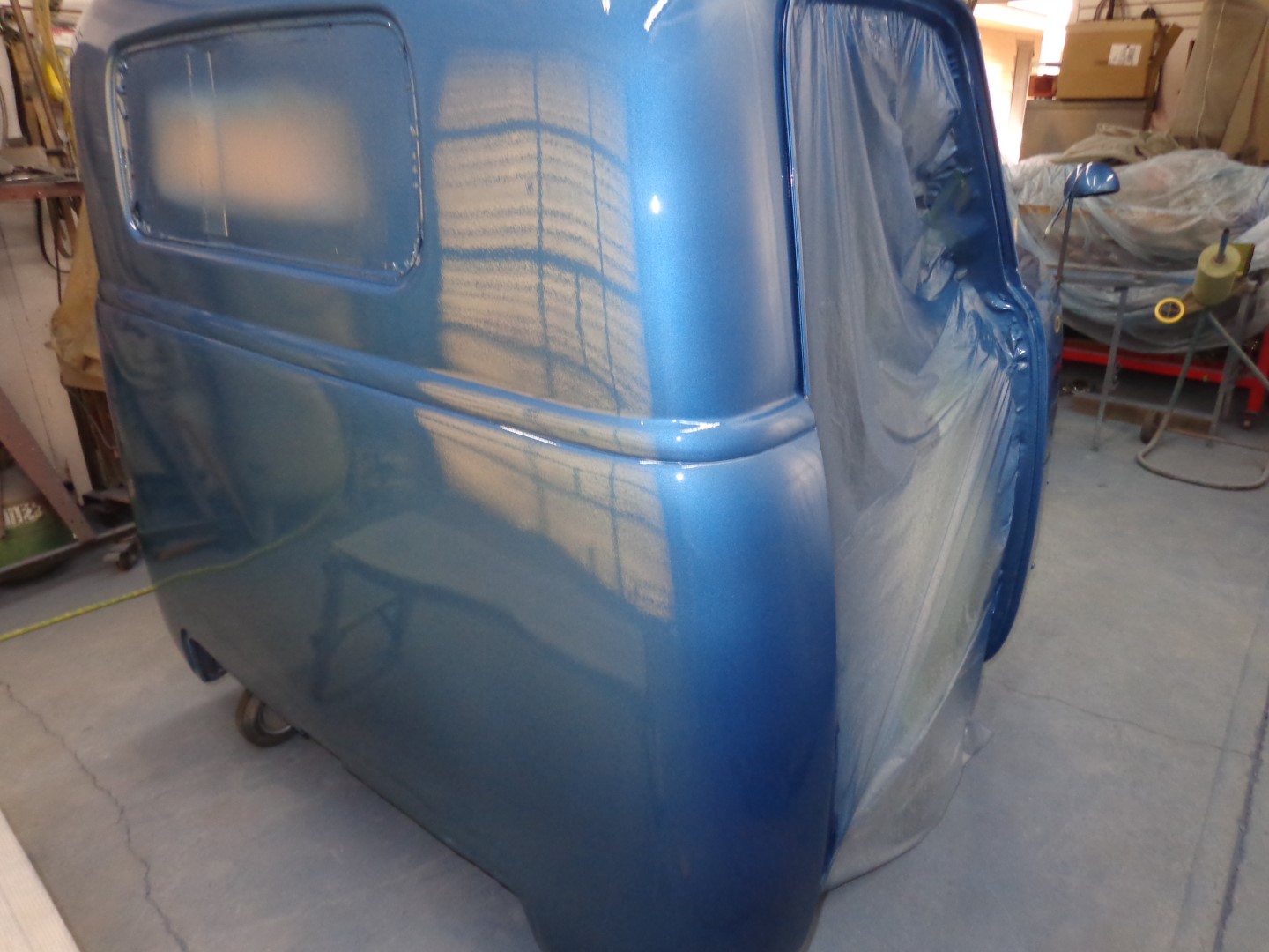

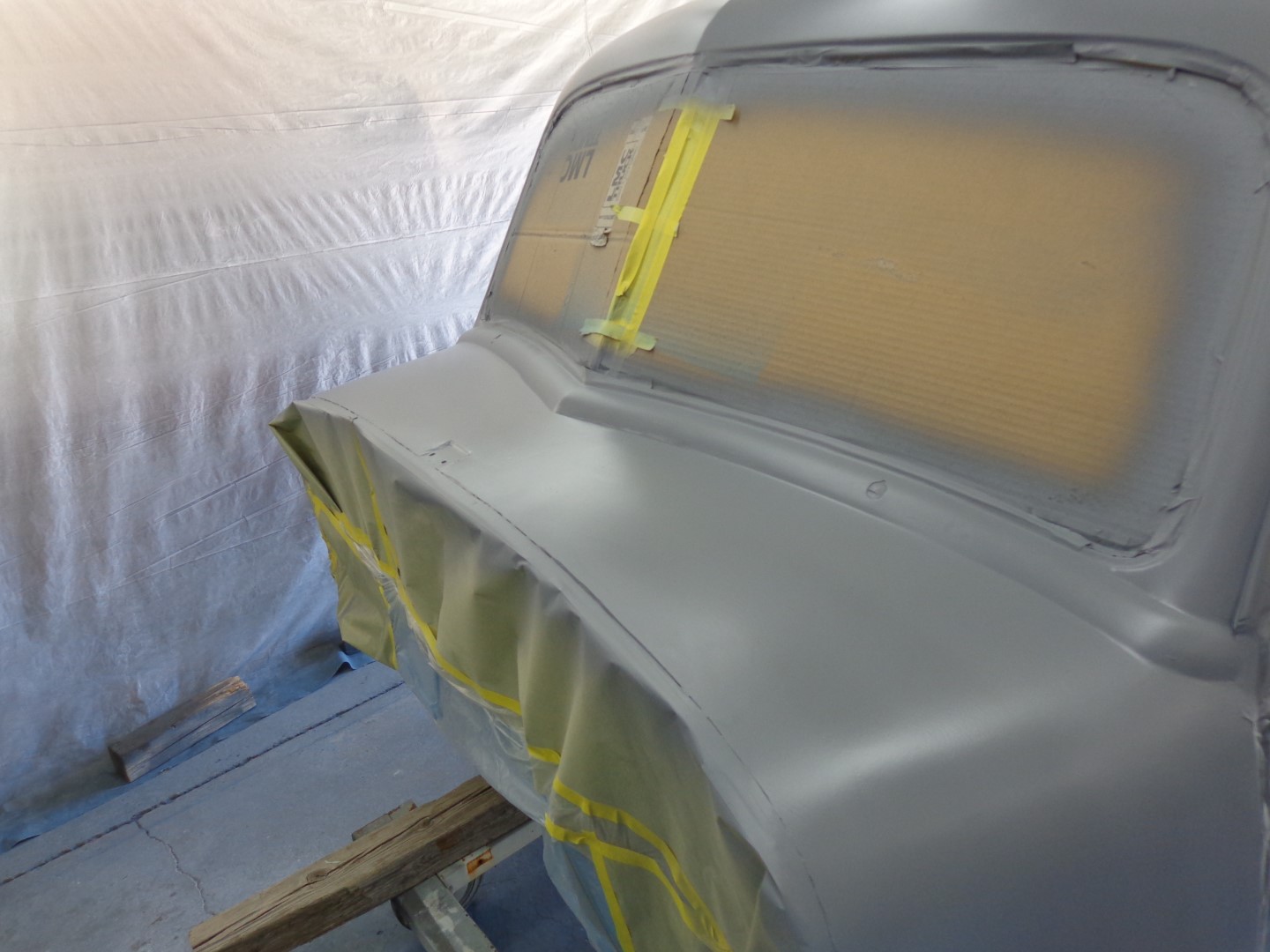

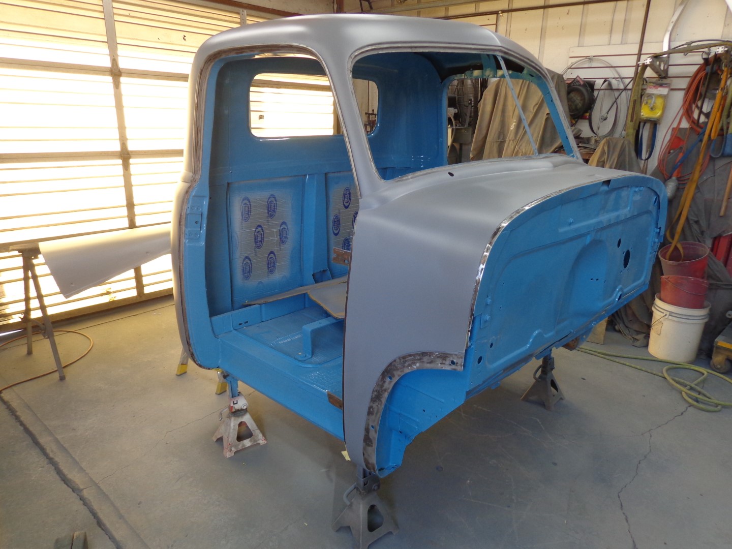

      O&S block sanded the cab today for the 1st app of primer. I think I can say that I sanded off around 80% of 5 coats of high build primer. The pics are before and after of 2nd app of primer. TB has taken over. Name:  DSC03646.JPG

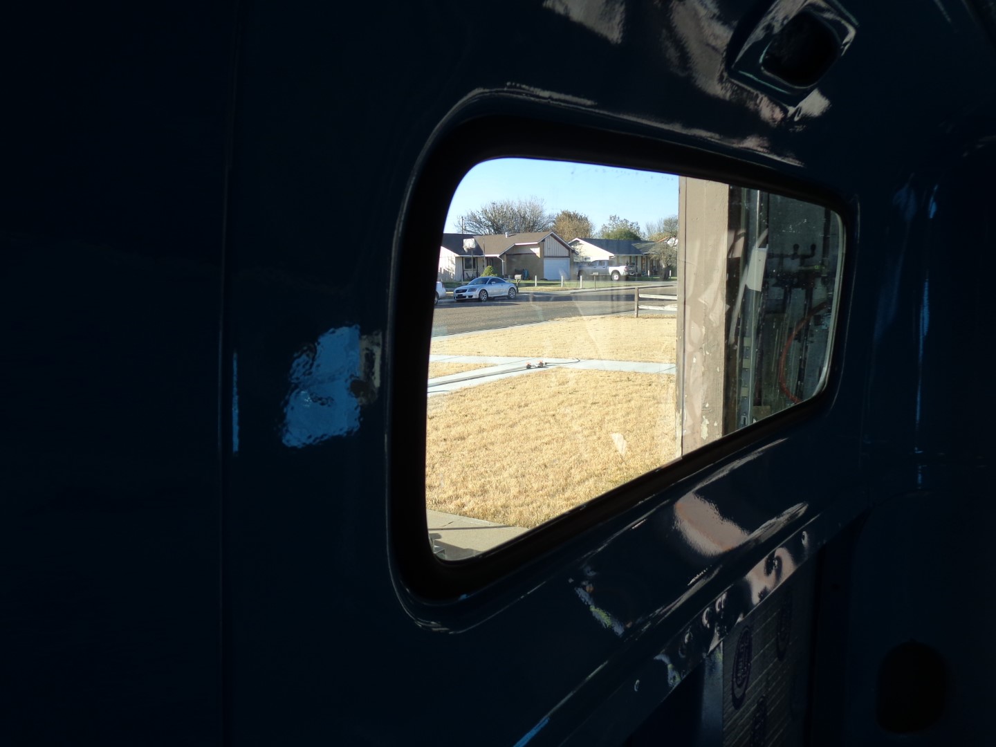

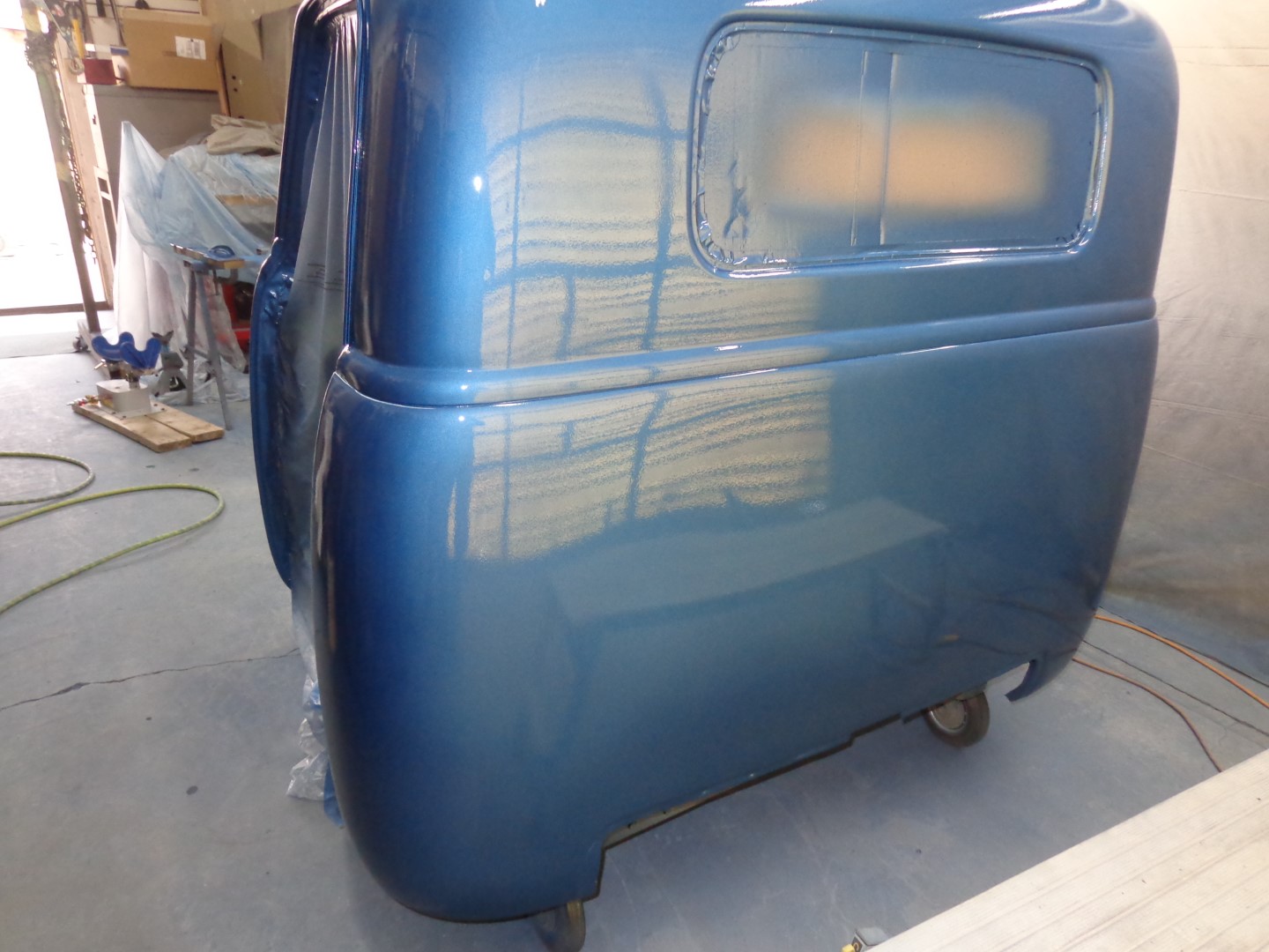

      O&S blocked and painted today. The roll pan and the doors are blue now. The weather wasn't as warm as expected but it was pretty calm. A nat got into the paint right next to the driver's door handle. It's nice that I will get reminded everytime I open the door. LOL.Name:  DSC03648.JPG

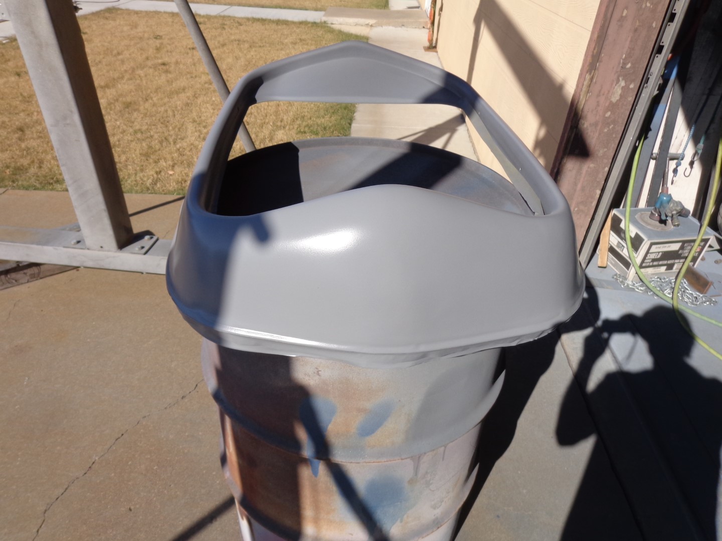

      O&S had a light day. 3rd app and 1st app of primer on the hood and grille shell. I believe the vendor of the grille shell was wrinkle city. Name:  DSC03650.JPG

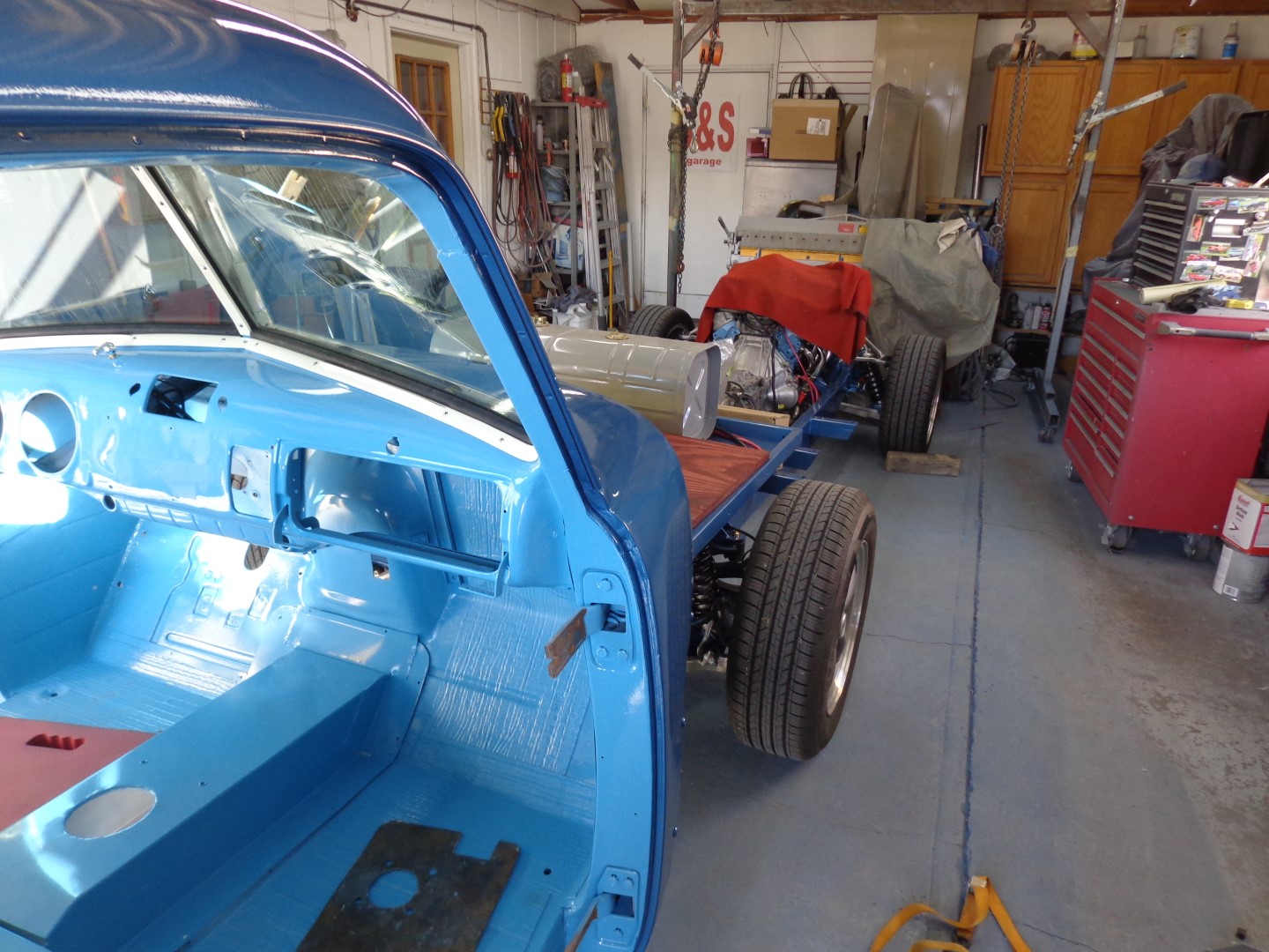

      O&S had some goals today. They were met, just a few hours longer than planned. It would be fair to say that everything fought me. LOL. My wonderful wife provided assistance in installing the rear window. If anybody knows how to put one in by their selves, I'd like to hear about it. The wipers are installed and tested. The windshield and garnish molding is in. The rear window is in. The chassis has been moved back in to the shop.Name:  DSC03666.JPG

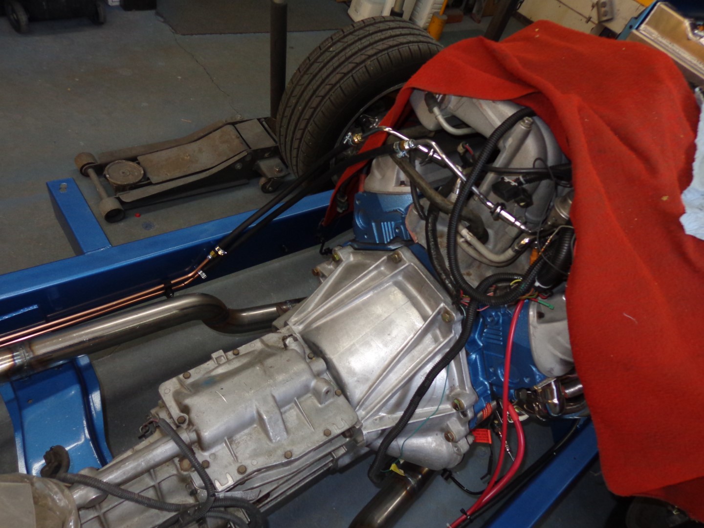

      O&S is back in low gear. The radiator, condenser and cooling fan are bolted back on, mostly to have less parts laying around. My plan was to get fuel and brake lines done today. The fuel lines are run. That is 5/16" nicop line and efi hose for flex purposes. Under the bed is a flare union on the pressure side and efi hose to make assembly easier when the cab is on and it's time to install the bed. The pressure line needs a clamp at the end of the fuel tank down stream from the filter. Lot of hours, not much accomplished.Name:  DSC03670.JPG
