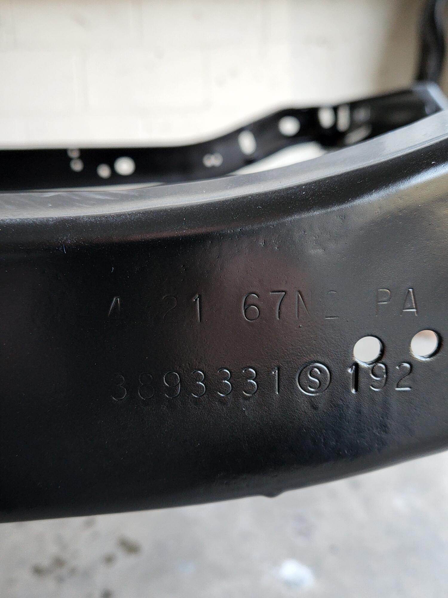

      Will try to not post up too many "plans," but only what I've done so far. Summary is boxed the frame with a Helwig FX kit, cleaned up the factory welds, smoothed out all of them, etc. Global West front suspension. Used their coil over setup, but didn't do the extended travel. Went with ridetech coil overs, as I'm not a fan of twin tube shocks. That caused problems I'll get to. Rear coil over aalso GW. Went with a custom width Currie 9" rear, UMI arms in the back. Wilwood disks all around (yes, I know there are better options, but get it going, first). Wheels are what I've wanted since I bought the car, American Racing Torque Thrusts. 17X9's, trying to run 275's at all four corners. Fronts are going to require entirely reworked wheel wells.

      This is example of how ugly the factory frame welds were. So I ground down those, welded up areas that didn't look so great, then smoothed over the welds with the glass reinforced filler.

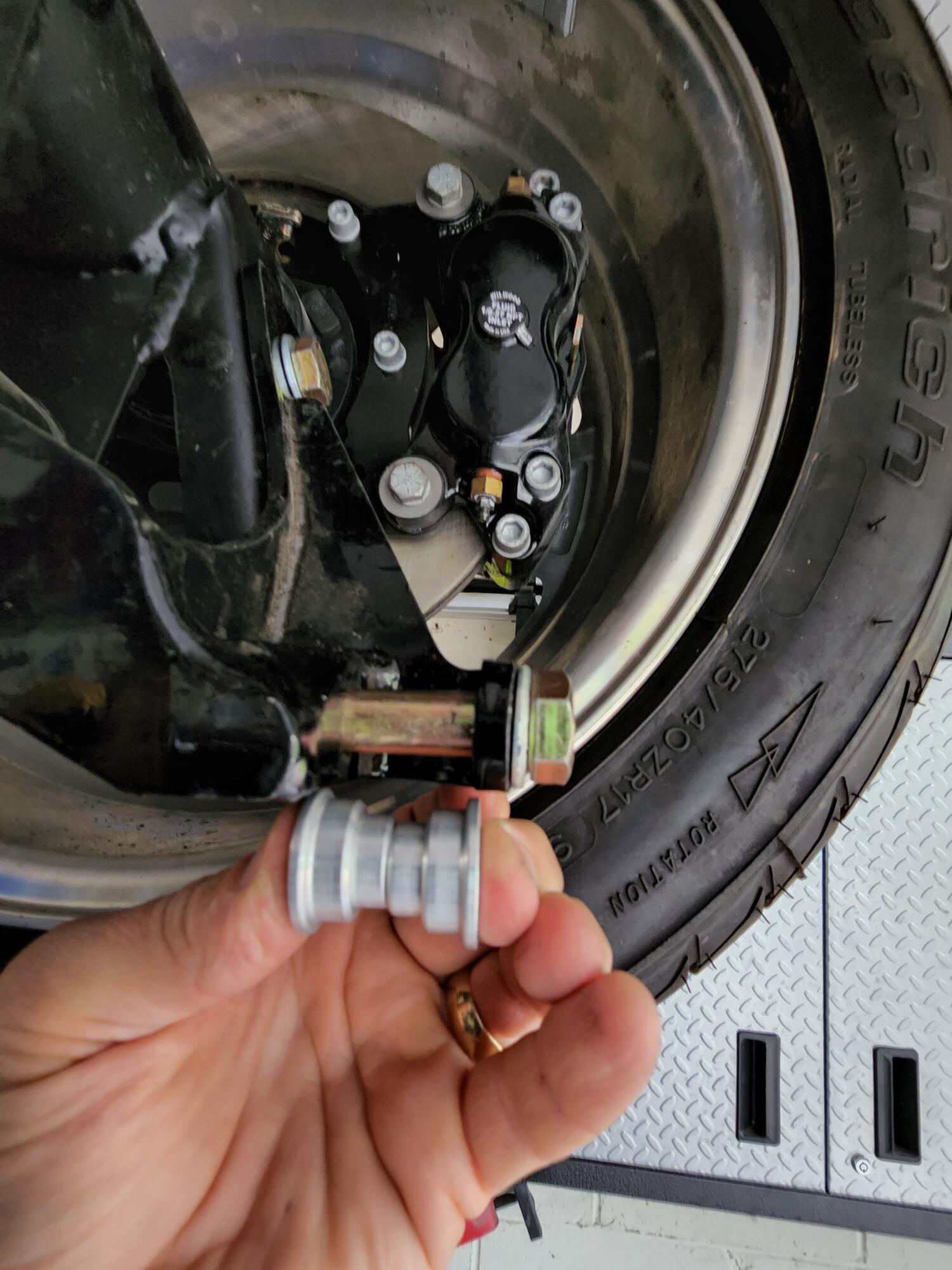

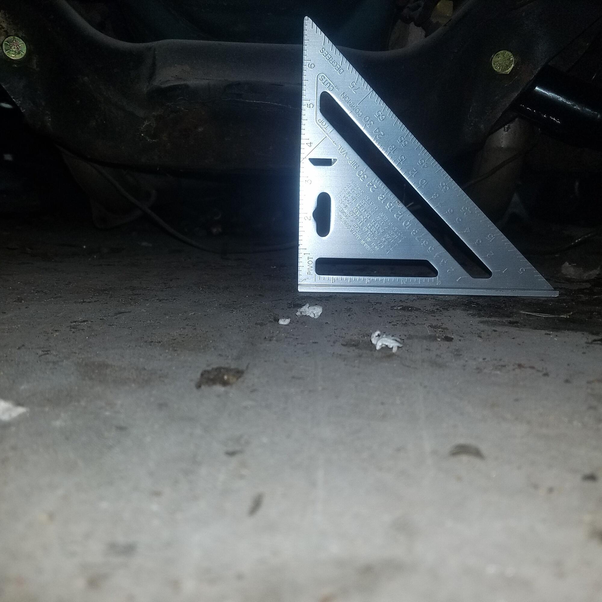

      So here I was playing around with ride height before I bought the coil overs. Fabbed up a threaded rod so I could play around with things. This was all the Global West stuff. Have to say, Doug was great, he is a GTO guy, has both a 65 and a 66. However, sometimes I'd get a tech guy there who was not so great. Advise me on setting up the suspension, and teh tire was resting on the bump for teh HVAC in the wheel well, and his response was "yeah, what do you expect?" I was thinking "um, to be able to drive the car?" Anyway, just played around with it, and it appears to be all good. And I can actually get my low profile jack under the frame if I ignore that.

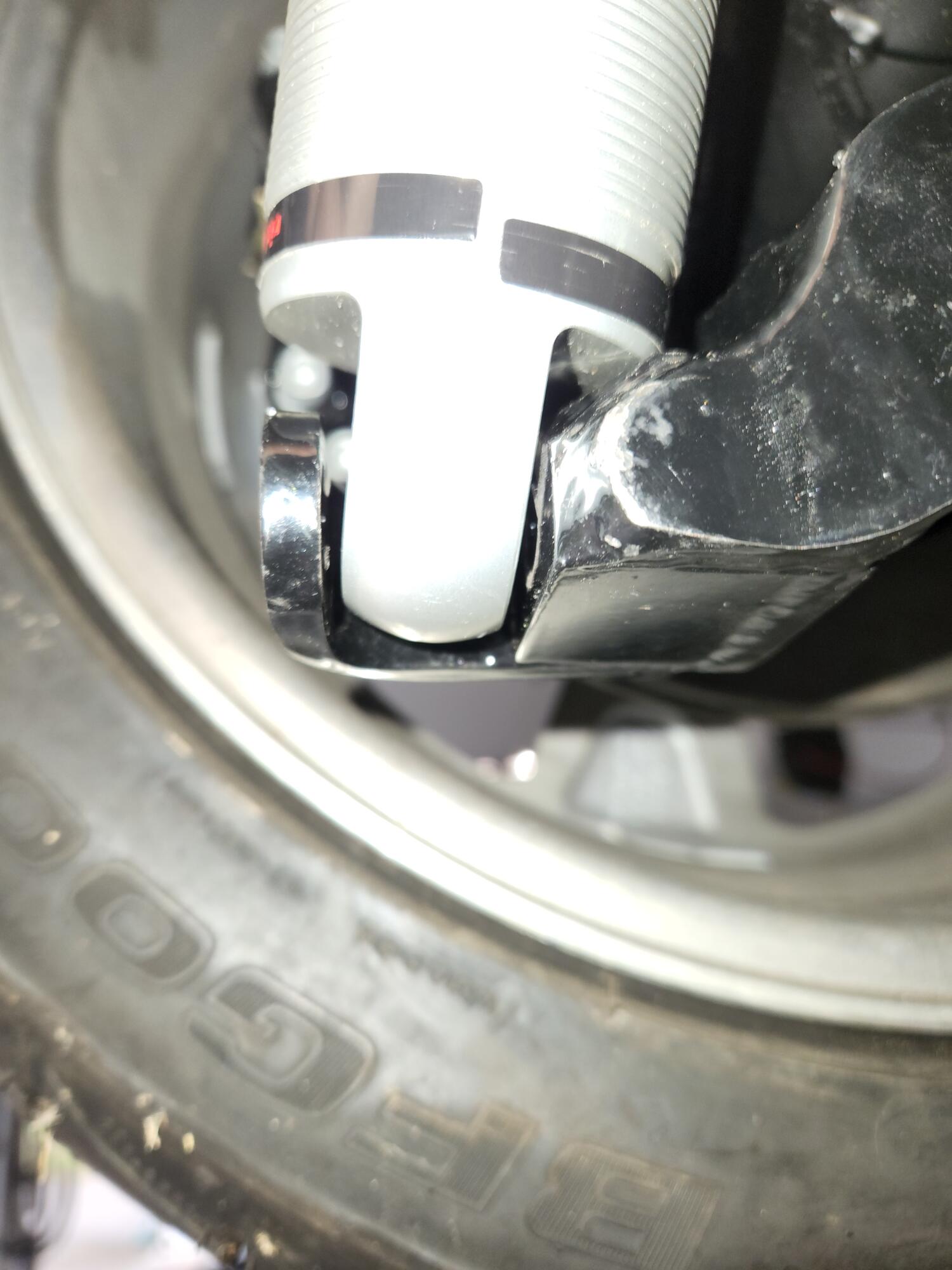

      To the back. Had some issues with the Global West coil over brackets and ridetech shocks. The Ridetechs have more meat for a larger bearing, and need about 1/4" more gap than the Vikings for which the GW was designed. So, I had to mill out a bit to make it fit, but once I did, it was okay. Fortunately, there is a very large chunk of meat in that bracket so it is still fine, structurally. Looks like I need to take an "after" picture of it installed after I modified the bracket. Sorry, I'm not the best at documenting.

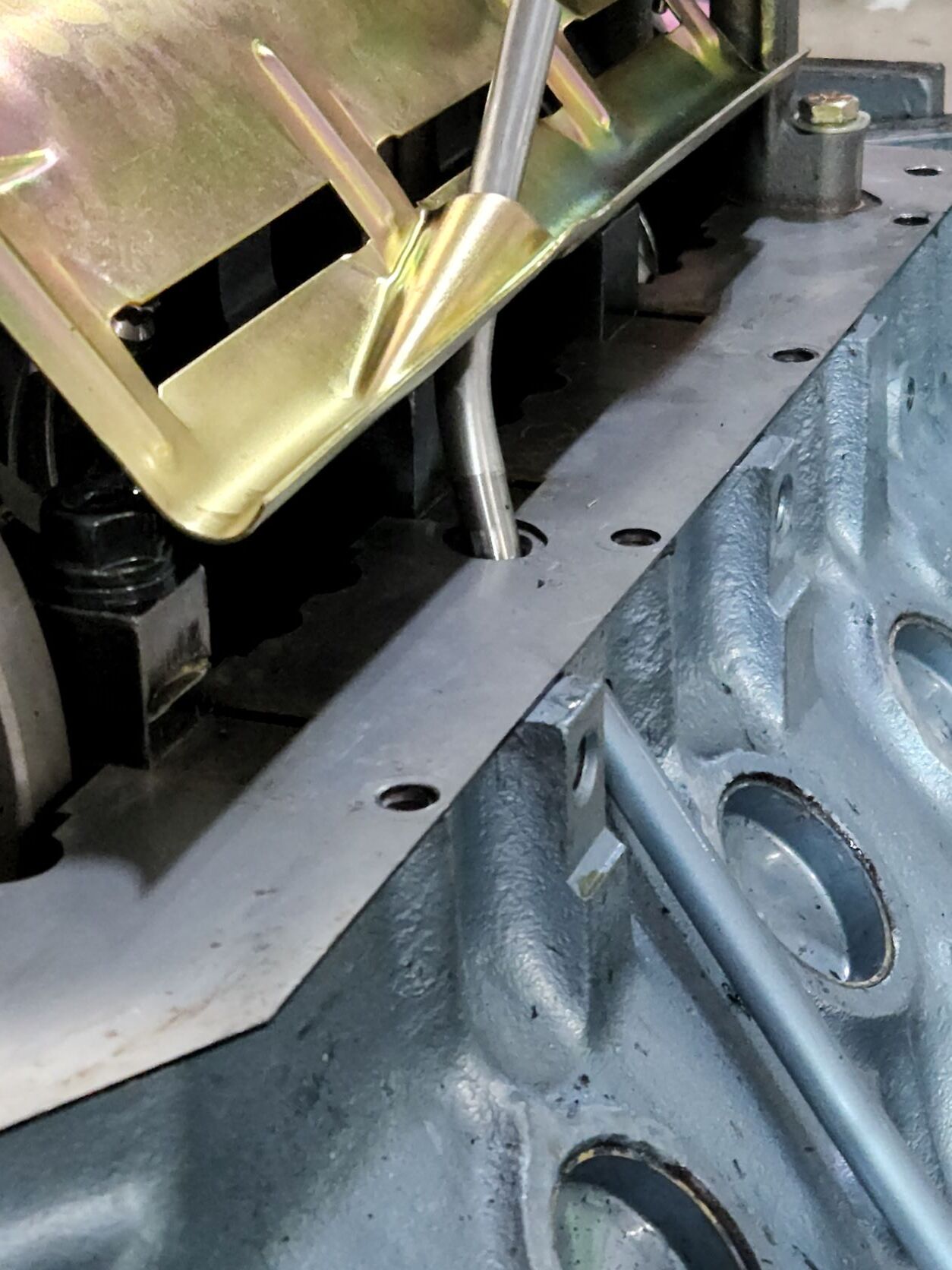

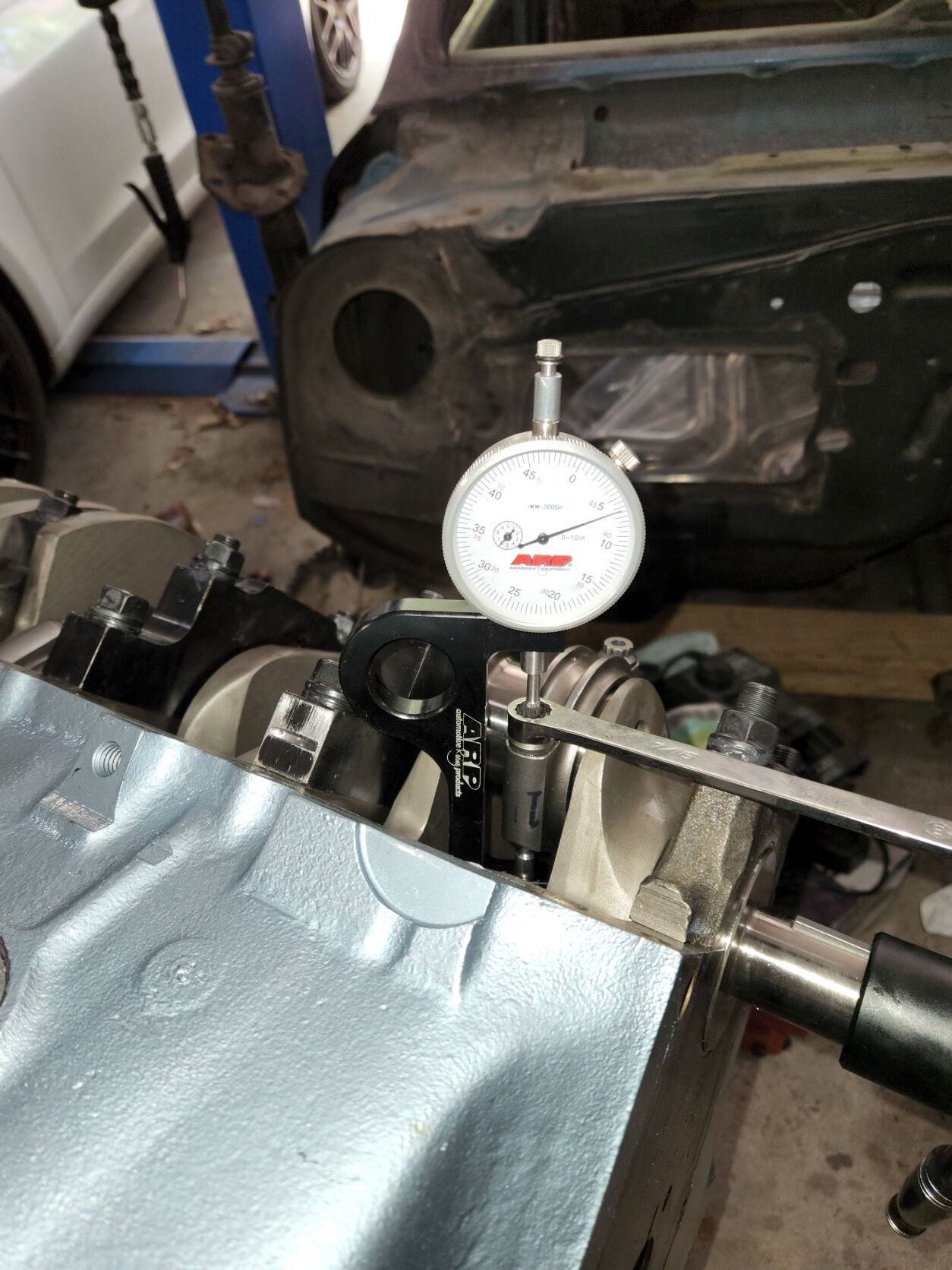

      Okay, some more pictures of the engine build, now that I figured out why I couldn't upload them. So for those who don't know Pontiacs, the lifter bores are "open," and therefore, a bit weak. I guess that roller cams aren't as bad, as the setups that are out there to retain some of the lifters don't work with the lifter bore girdle. Yes, that is JB Weld in there, that's how it was designed, to fill the voids between the cast lifter bore surface and the machined girdle surface. And yes, that is a Tesla in the background.
      Name:  lifter bore brace.jpg

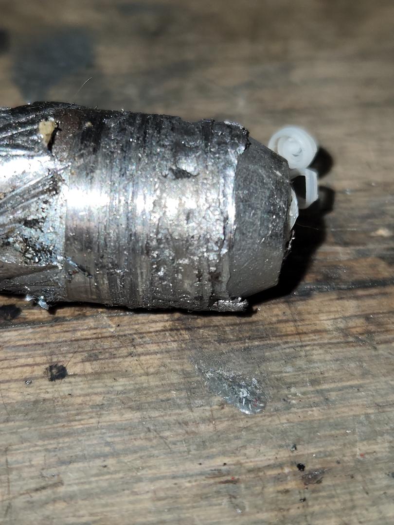

      As my car is all numbers matching, I'm doing the belt and suspenders thing on the block, so I had to make it work. Though I suck at documenting, I tried two different systems. One was a plate that bolts down using the provisions for bolting down the valley pan, and keeps the lifters from rotating by having a parallel flat on the outside. Nice, simple, clean system. Didn't fit. Tried drilling holes for bolts, which seemed to work, but the valley pan wouldn't fit over it.
      Name:  lift guide arrow inj.jpg
      So I moved on. The other option is a retrofit kit for a Ford Windsor style block. You have to cut and tweak the spiders on it. I ended up having to counterbore the lifter bore braces to get that to clear, but that is how I finally got it to work.

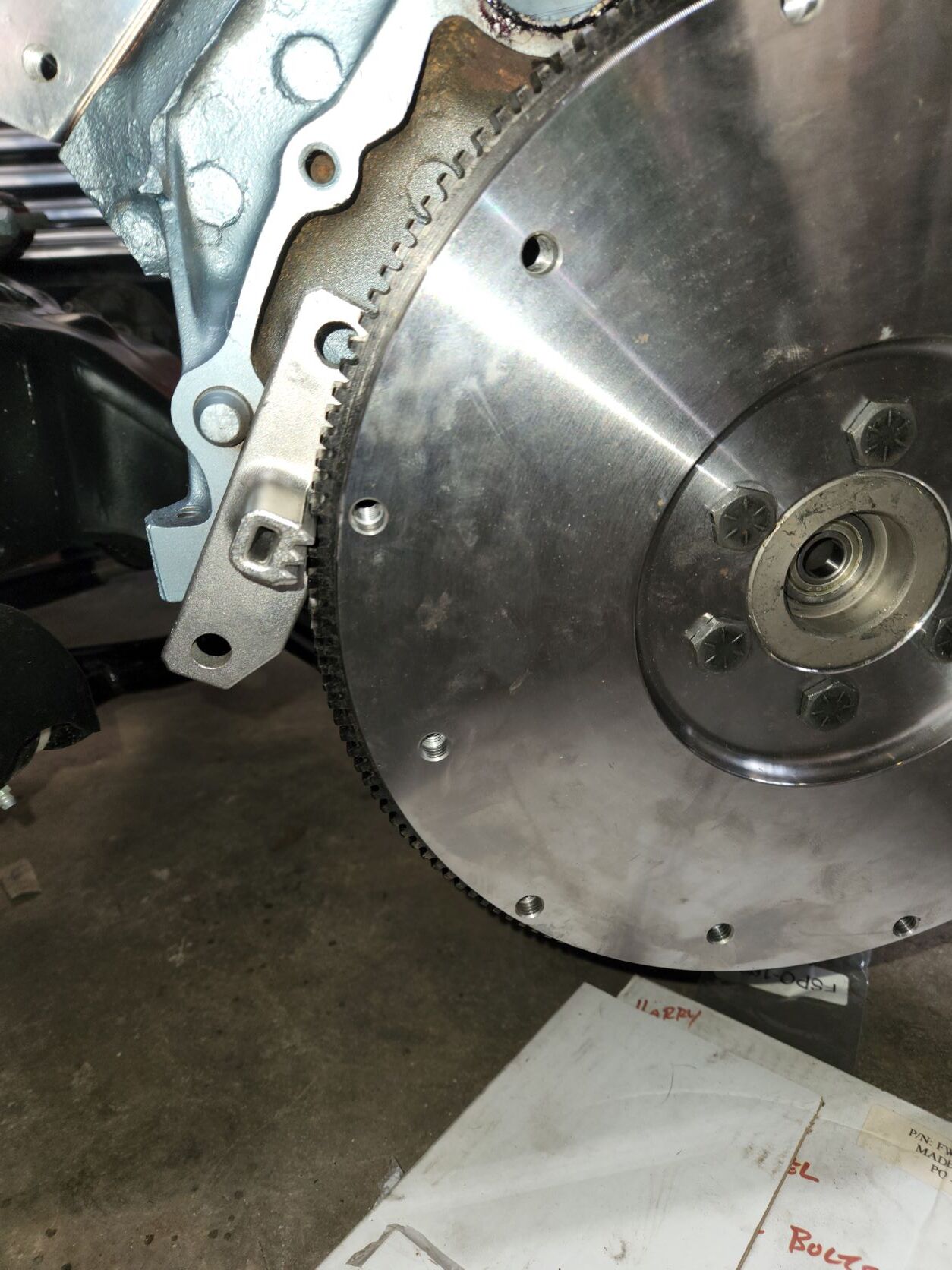

      Ran into a couple of problems. First was a flywheel lock. As in there isn't one for a Pontiac. ENded up repurposing the one from my Porsche escapades. This one is for a 944 or 968. But hey, it worked here. Same part of the block, when I was putting on the bellhousing, I had to deal with offset dowels, as the tolerance for the old Muncies wasn't great by today's standards, and I needed to tighten up that. This got ugly. The old dowels wouldn't come out. When I got them out, I had scored the dowel holes pretty badly, as you can see from the pictures. The standard offset dowels didn't work. Ended up junking them, and going with a more expensive option. Anyone reading this who needs to use offset dowels, don't waste your time with the junk you can find anywhere, buy these, the cost difference is very modest, and these things are incredible. https://www.robbmcperformance.com/products/dowels.html. Sorry I don't have good shots of the fix, like I said, I suck at the documentation.

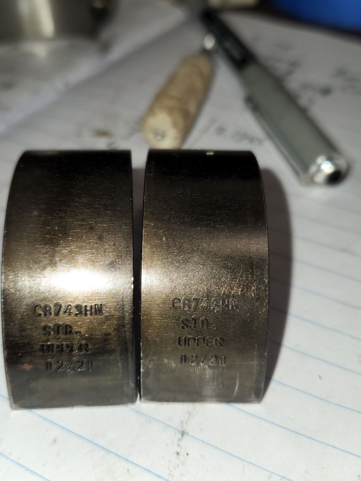

      Ran into another problem. Putting the engine together, one of my rod bearing pairs wouldn't line up. Turned out I got two uppers. Now having been a while since I messed with V8's, I was used to inline 4's, and they didn't have uppers and lowers, nor were they directional (yeah, I screwed up that, too, finding out when my crank wouldn't turn), I learned something. Or re-learned it. Check before you install. Because I had to go back (yet again) and check all my bearing shells to be sure they were all right. So again I had to re-do some stuff. Anyway, good thing abiout Butler, well there are a lot of good things, but they sent me a new pair right away, didn't need the old ones returned or anyuthing, juust got it to me as quickly as they could, so I wasn't slowed down too much. Highly recommend Butler, too, as I'm sure the other 2-3 Pontiac folks here will agree.

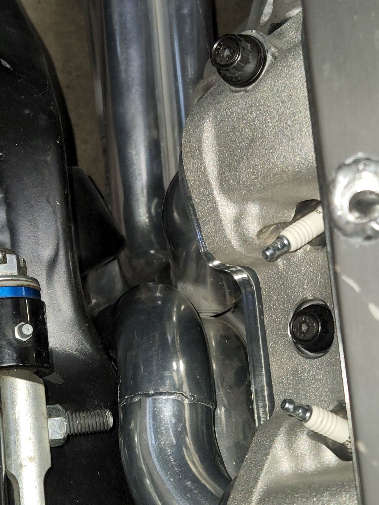

      Headers are Doug's round port, which are larger in diameter than the more common D-port. These suckers are TIGHT. Fortunately, they didn't need a whole lot of major dimpling, just a little massaging. Unfortunately, that required heat, which damaged the ceramic coating. But, that's life with headers, I guess.
