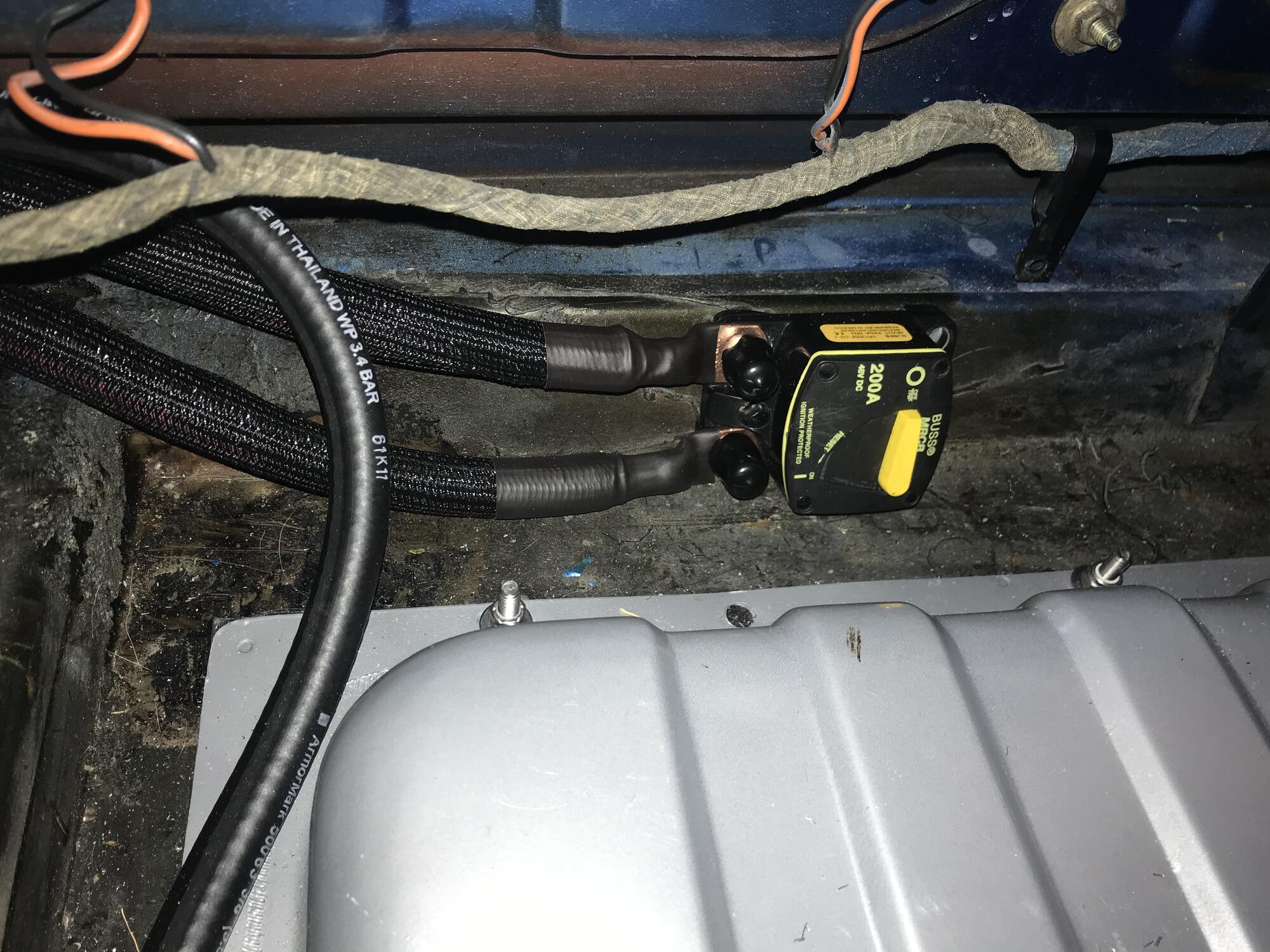

      That's what I'm running, bit larger cable though.
