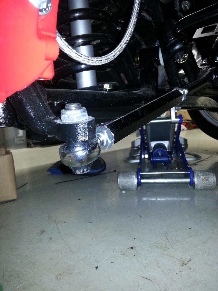

      I run a 245 40 18 , with a 9 inch rim, 6 inch back space and the ATS drop spindle, the only catch is you have use a hiem rod end instaed of a stock outer tie rod end. SO the inner part of the rim does not rub. Yes you have to drill out the taper on the steering arms and use the shorter sterring arms.
      I have used this setup for over 10 years with no probs. I also have founName:  2015-03-18 21.41.56.jpg
Size:  96.5 KBName:  2015-03-18 21.41.38.jpg
Size:  129.8 KBName:  2015-03-18 21.41.27.jpg
Size:  112.8 KBd off the shelf rims that fit the bill. It seems 3dr gen rims are the ticket.
