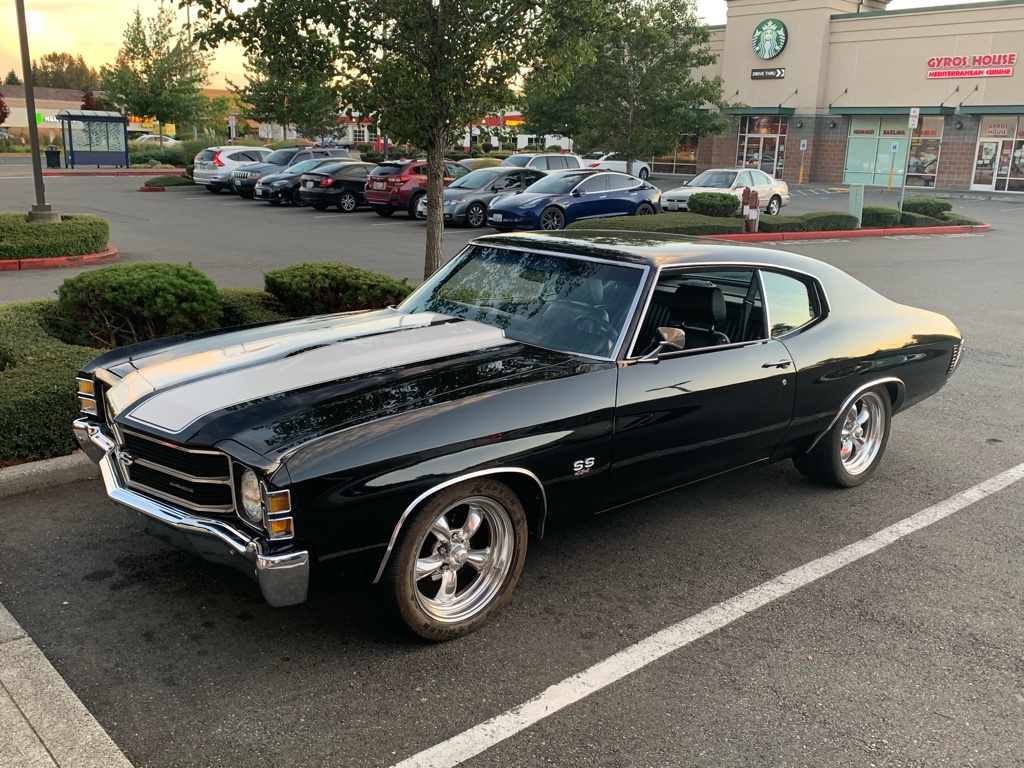

      So been posting on here a little but thought i’d introduce myself or more so Veronica. Don’t usually name cars but a friends wife said she looked like a Veronica and I kinda agreed.
      This is her.

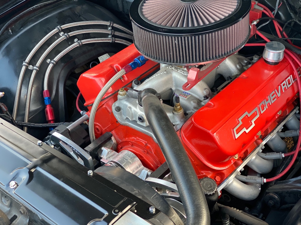

      She came bored out to a 489 with Scat crank and rods. Roller cam and rockers (crane rollers comp cam) 850 Demon carb and other niceties like aluminum radiator and electric water pump.
      She has a built turbo 400with a gear vendor OD and a 12 bolt Moser out back with Tru-Trac and 33 spline axle.

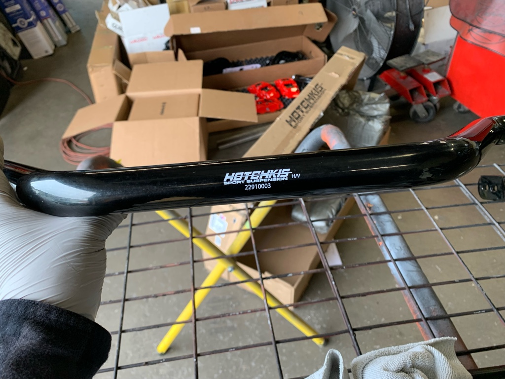

      Hotchkis adjustable upper rear and lower trailing arms (keeping) and Hotchkis 1” lowering springs (not keeping)

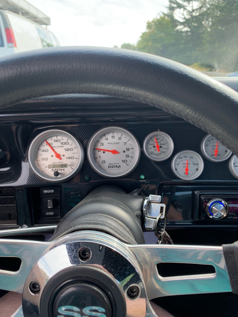

      Full auto meter cluster.

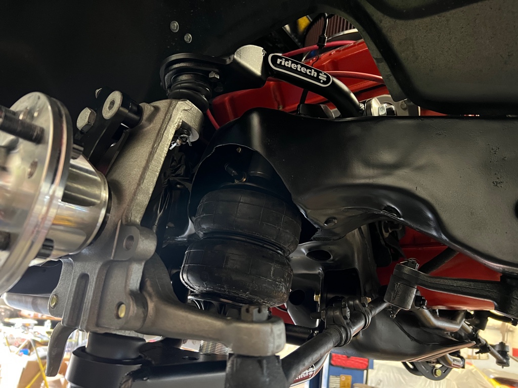

      Down the rabbit whole I went and as I’ve always liked cars with airride I talked myself into ridetech. Decided to go the best so I looked into Shockwaves. This another reason for my post as I couldn’t find much info so hopefully future googlers can find this.

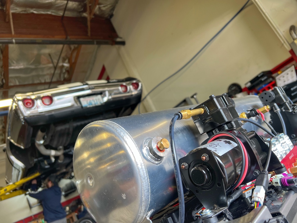

      ridetech E5 pro, 5 gallon ,double compressor’s and Bluetooth. 1/4” valves

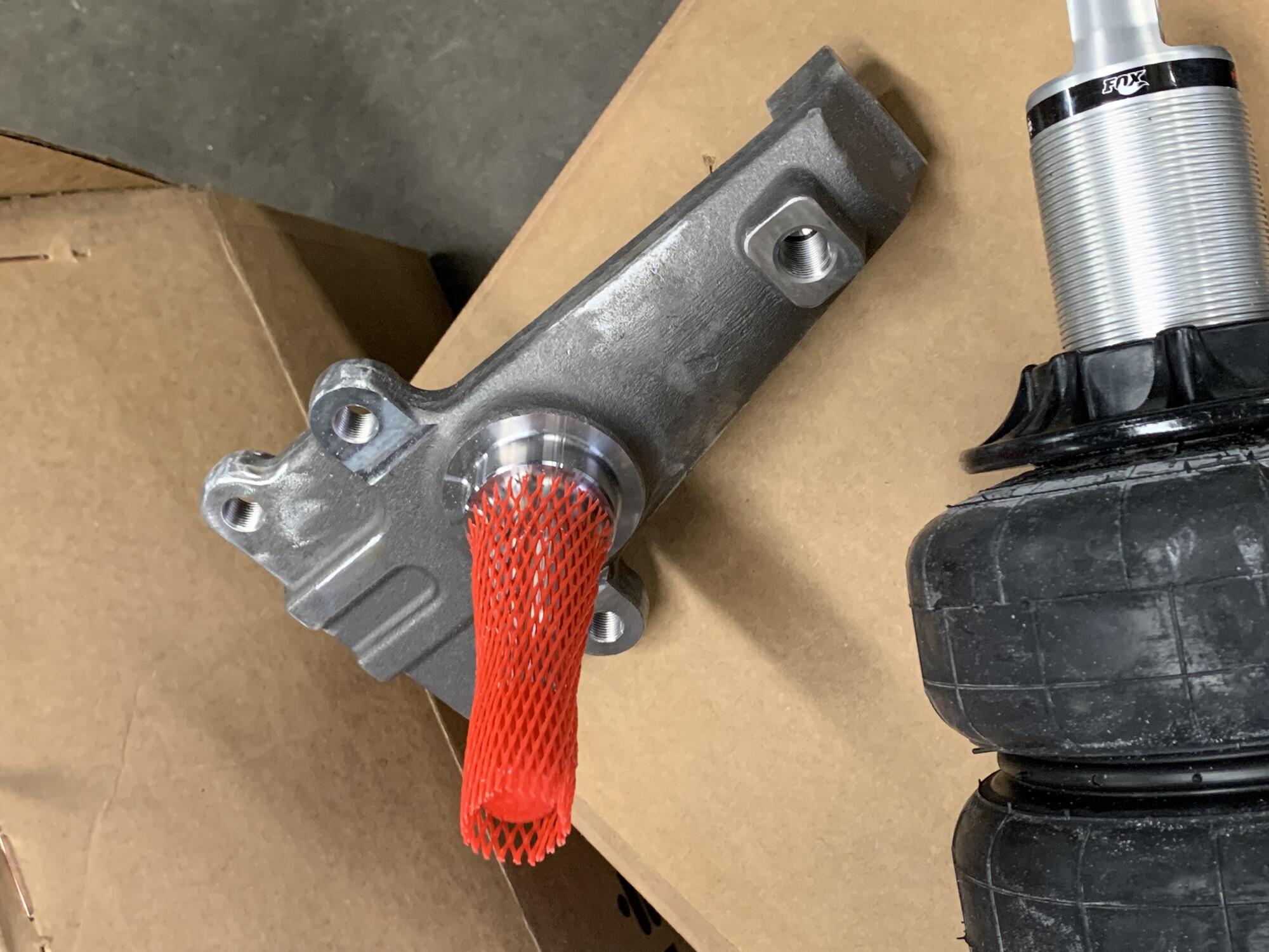

      Ridetech 2” drop spindles

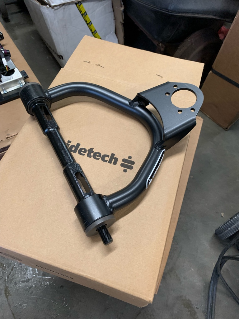

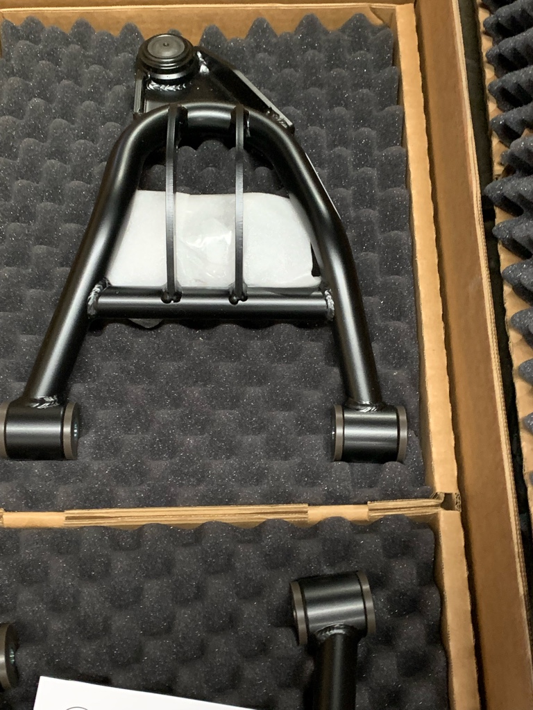

      Upper and lower Strong Arms

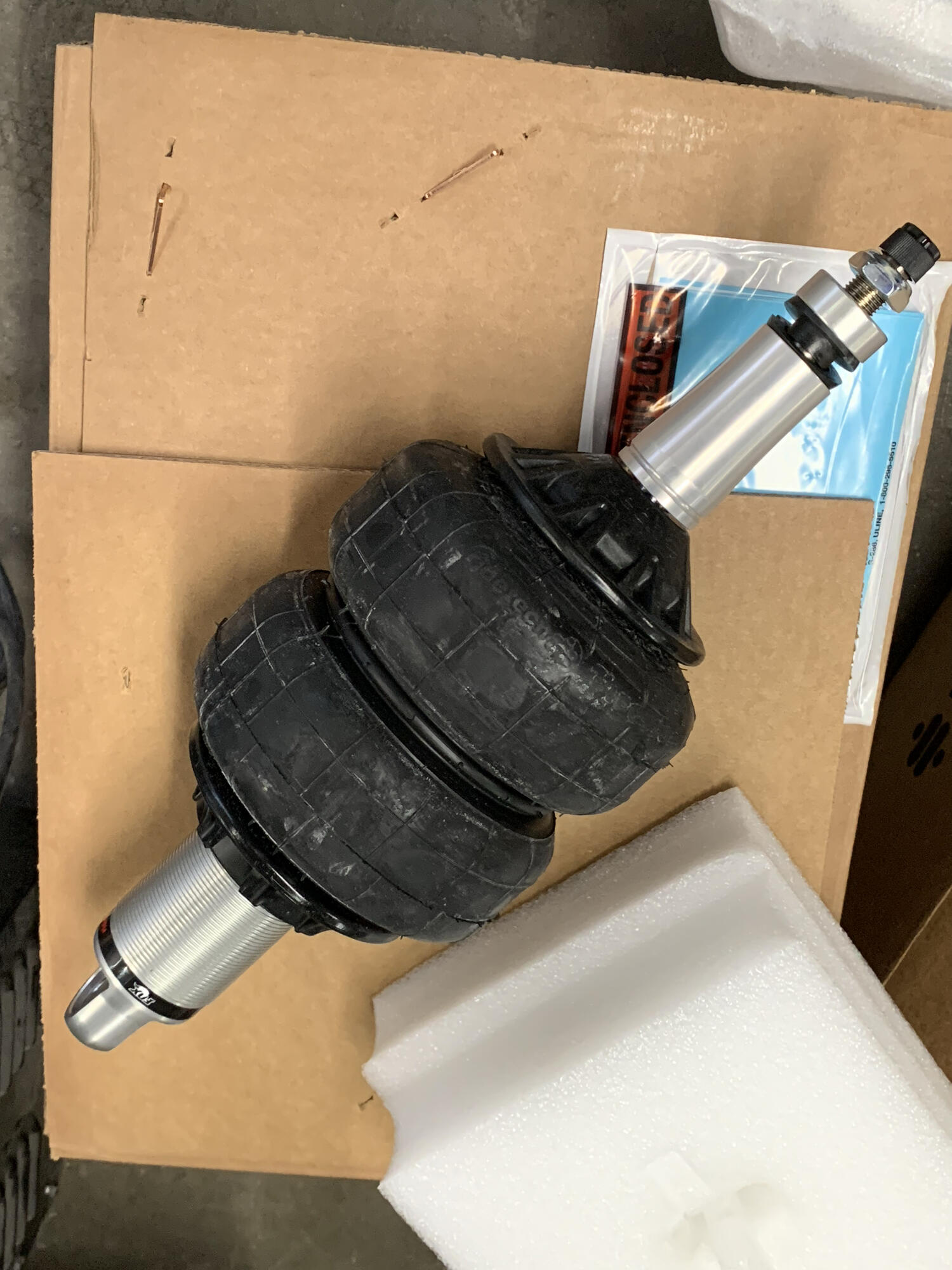

      Front Shockwaves

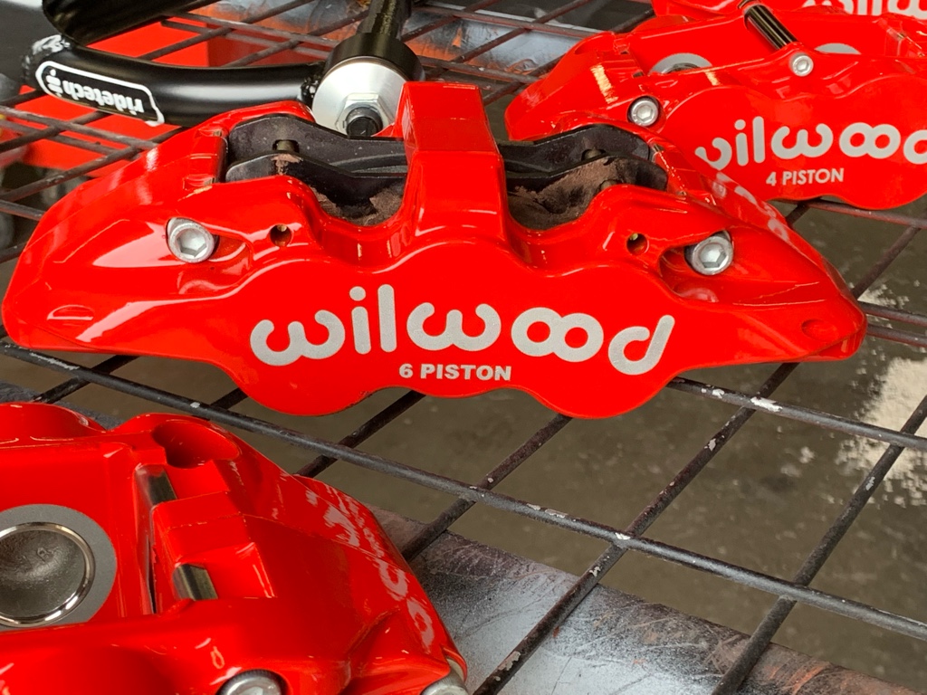

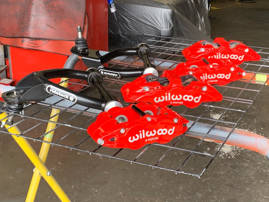

      Went and Ceramic coated the Calipers and other powder coated parts with C5 wheel armor from Gtechniq.

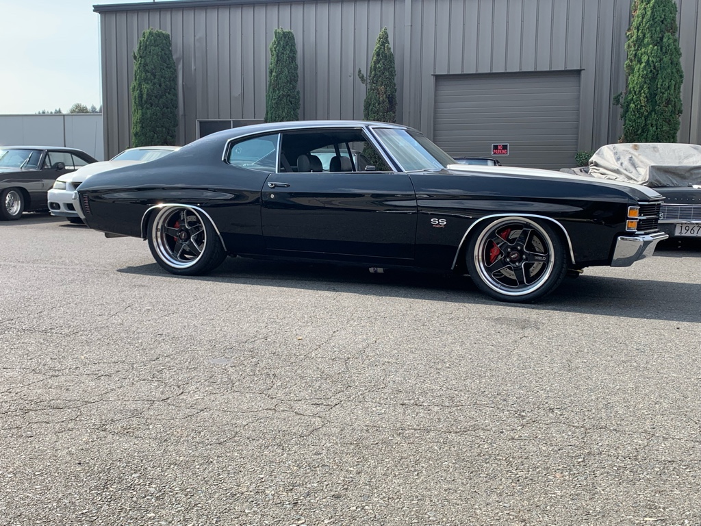

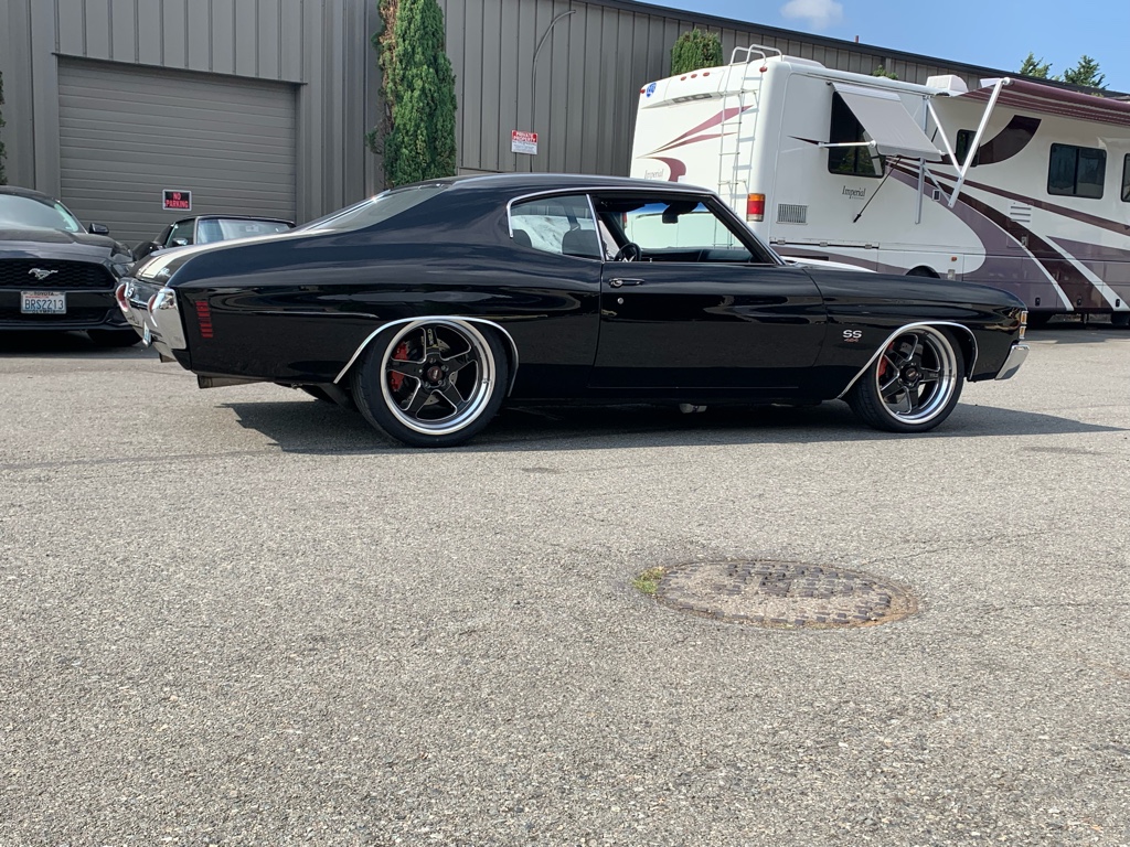

      Well 4 months later shoes arrived
      Dec 2020
      153

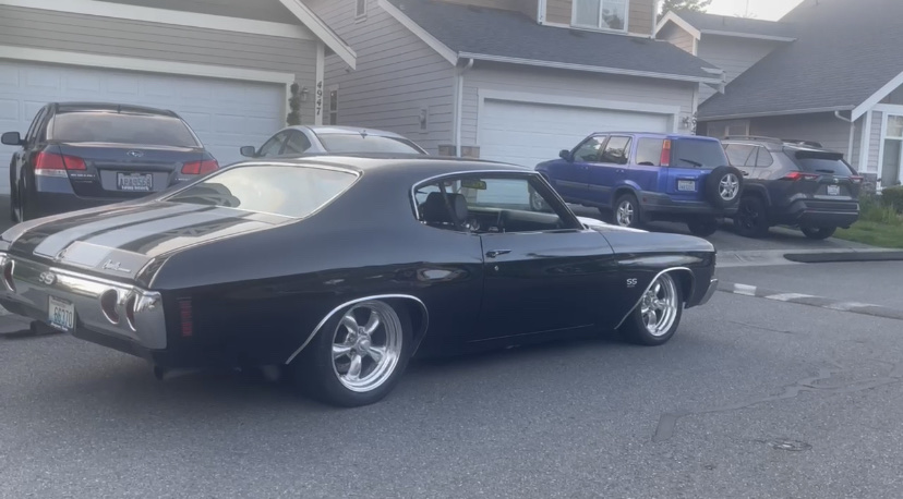

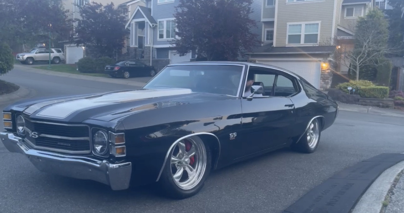

      Went from 3/4” to 1/2” spacers. Needed to clear exhaust. Shaved fenders. Now I can drop her properly
