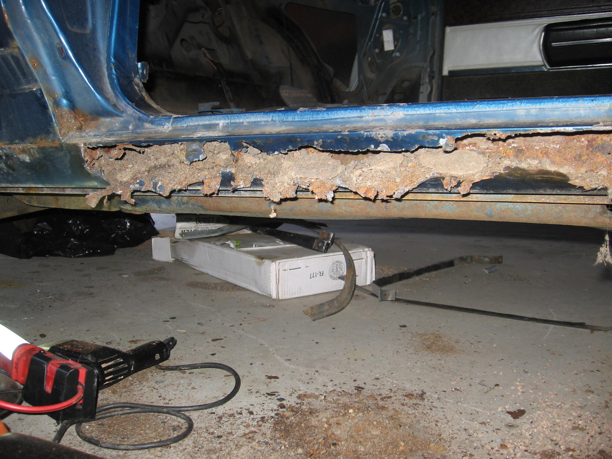

      So, my first car was a 70 Cutlass Supreme that I drove for 10 years. It was really rusty and we finally had a house w/ a garage to work in so I tore into it. Unfortunately, what I found was overwhelming for my first time doing body work.

      I made a difficult (but rational) decision to part it out and watch for a new project.
