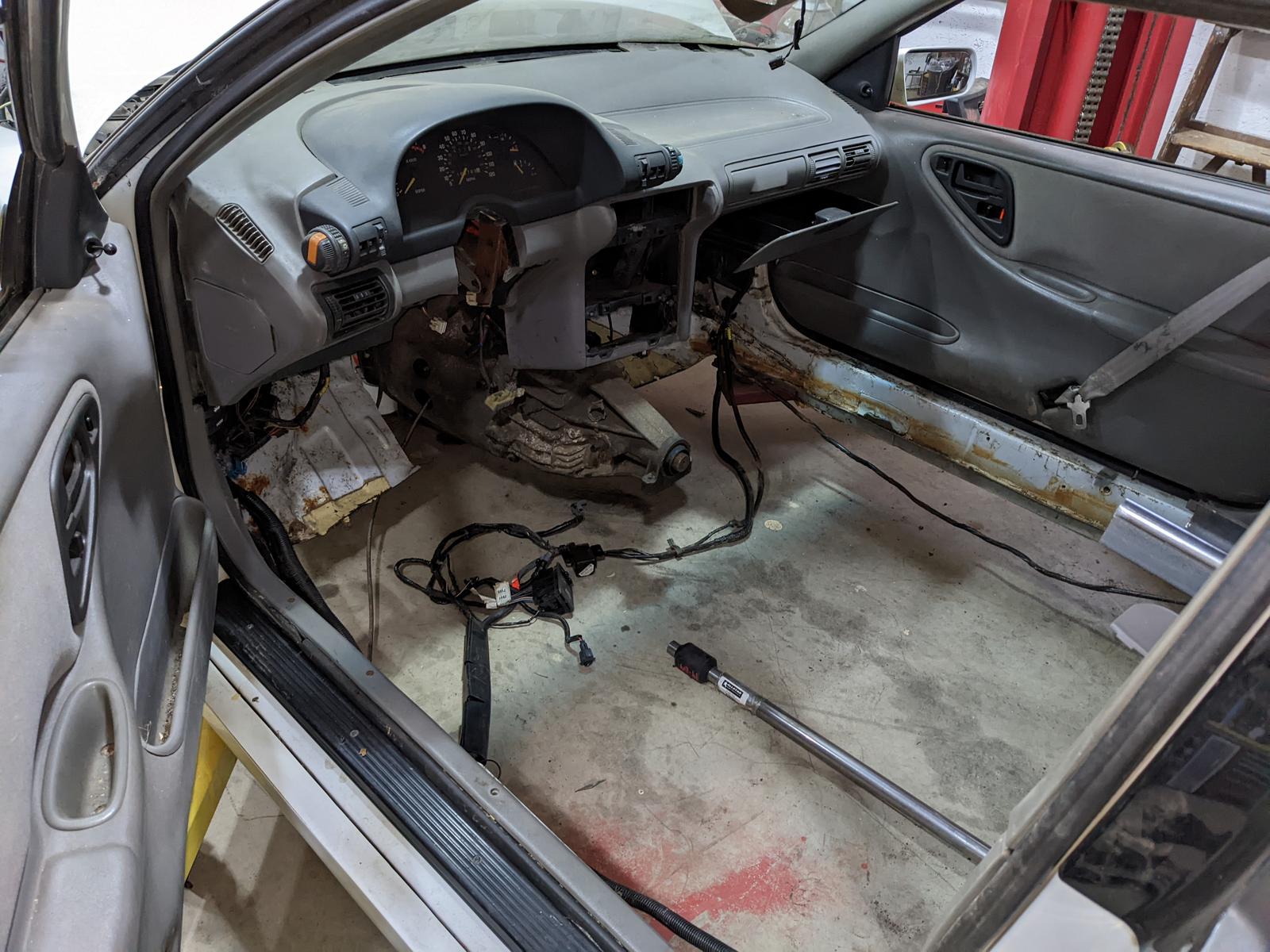

      Keep plugging away at it. Sawzalled the firewall and floor out to mock up the trans and the 5spd fitment could be better...that's for sure. Working on a solution to that right now.

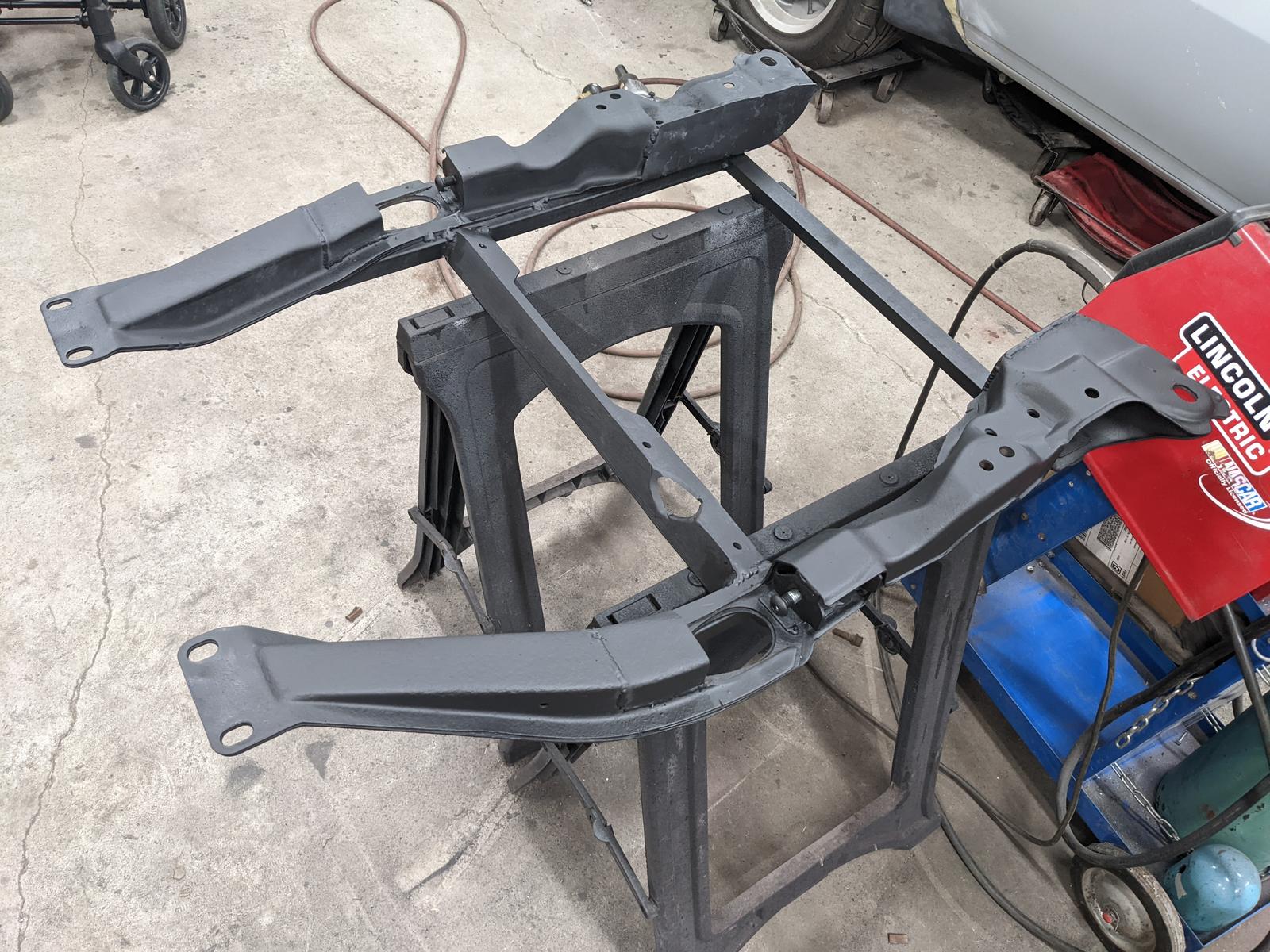

      Got the motor mounts all done. The subframes will become one piece with a C channel crossbar for the steering rack up front, and a skidplate/brace in the back under the oil pan/bellhousing.

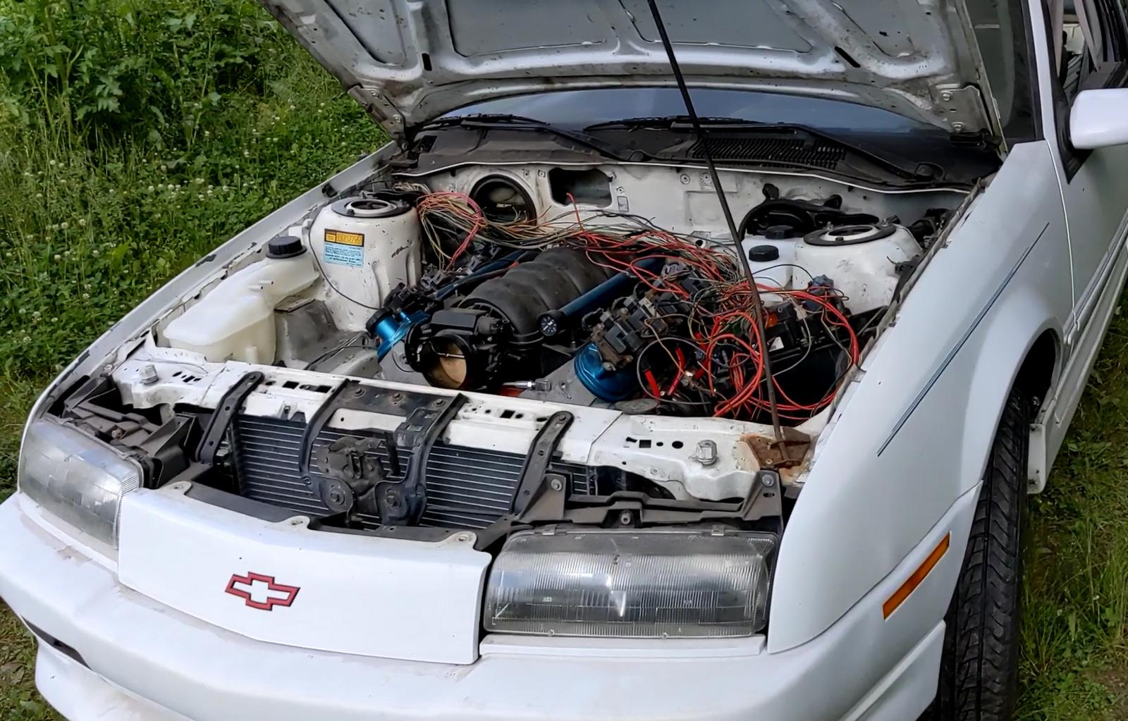

      Bought a rockauto full-aluminum radiator and pushed it forward for some more fan and water pump room. Looks like it will work pretty mint.

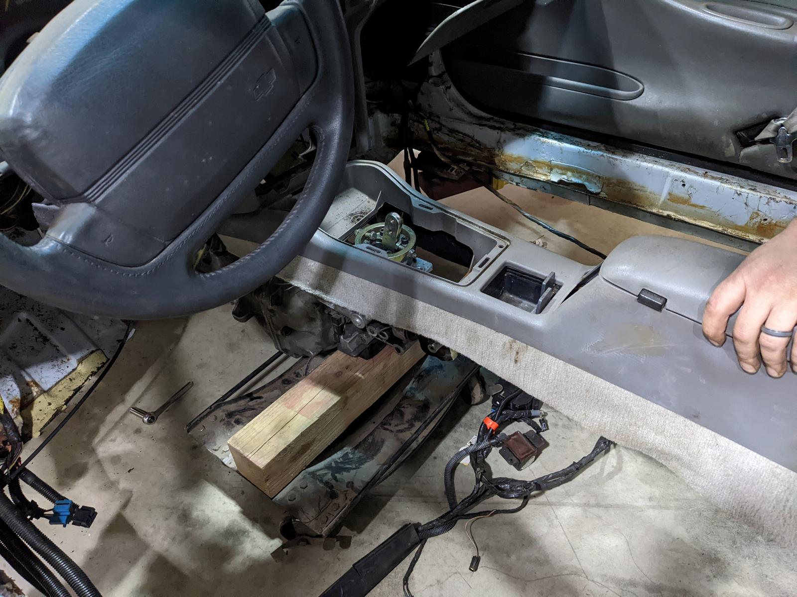

      Also got the crossmember in and the back half of the raised floor mocked up. Not too far away now! Just trans mount...torque arm mount...front floor...tunnel...pedals...steering...wiring...

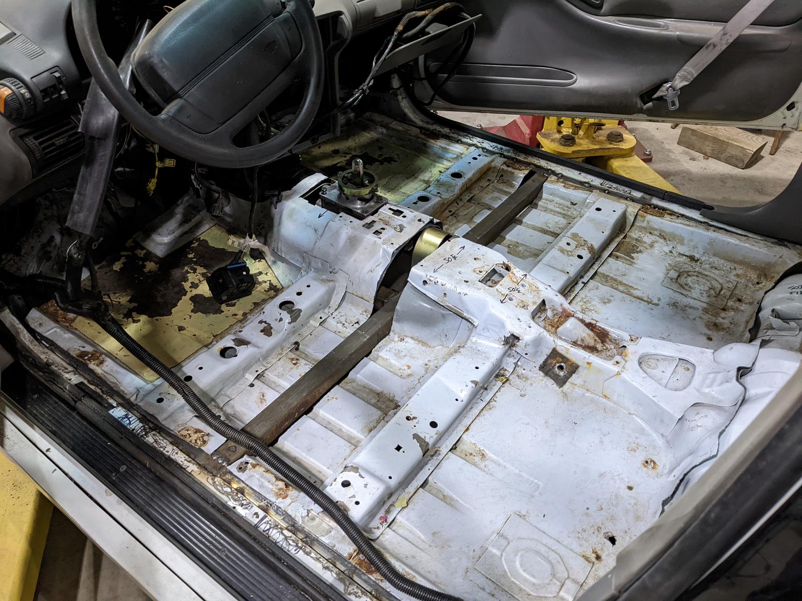

      So that 6spd that's mocked up in the Beretta is stolen from the Camaro. Still needed to find another one...and I was able to snag a used Tick Performance T56 built for nitrous! Test drove to make sure it was good and pulled it in the guy's garage. That one will go in the Camaro once I swap it from LS to LT style. I'll take the LS input shaft, front plate, bellhousing, clutch & flywheel and throw them in the Beretta with the stock 94 T56 that I used to run in the Camaro.
      Also got the crossmember built and welded in and the torque arm fabbed and installed. So now it's sitting on the suspension and it's a lot higher in the front than I expected. so I gotta figure out some coilover sleeves for the struts with a higher rate and less height. Keeps moving forward though, that's the key.

      Looks good man! So what are your plans for the floor? When you get the floor back in do you plan to add a brace for the front of the trans mount? Looks like as is, it would be putting a lot of leverage on that mount.
      Walton, NY
      758
      Yeah, I'll weld the trans mount "arms" right into the floor, as will the crossmember. I don't love the design, but it was the best I could come up with that allows the engine/trans to be installed from the bottom and also leave some room for exhaust. The exhaust will be really tight coming through the firewall and I also need room for my feet and pedals. The floor is already gonna be raised 3in...I didn't want another crossmember that would be even higher than that.
      I just mocked in the front floor and it looks pretty decent.

      Got the stock LT1 trans swapped over to LS style and ready to go in the Beretta. I'm doing a video of that process at some point. You need a shim kit to get the clearance and preload right. This is the second "Beretta" trans to get opened up on that bench...I rebuilt a FWD 5spd years ago. haha
      Also got a few things figured out and started final floor installation. Not a ton of progress in the last couple weeks, but it's still going forward. Couple more things came in while I was on vacation in Texas so I can jump back on it.

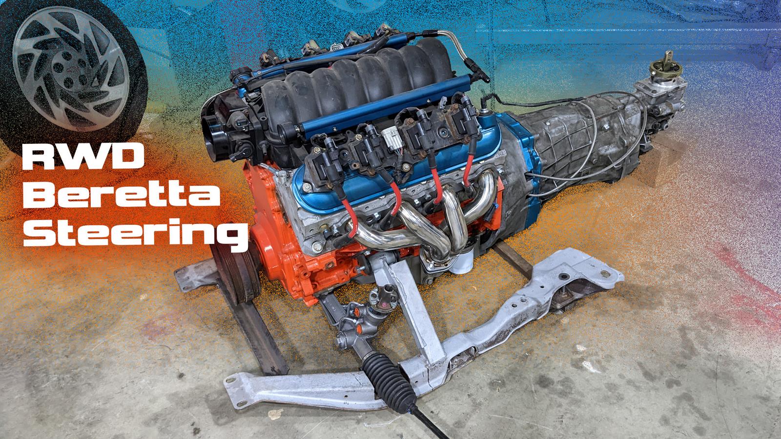

      Started mocking up steering and it's kind of a mother. Most of the RWD stuff has been going pretty well, but this is a pain in the ass! haha

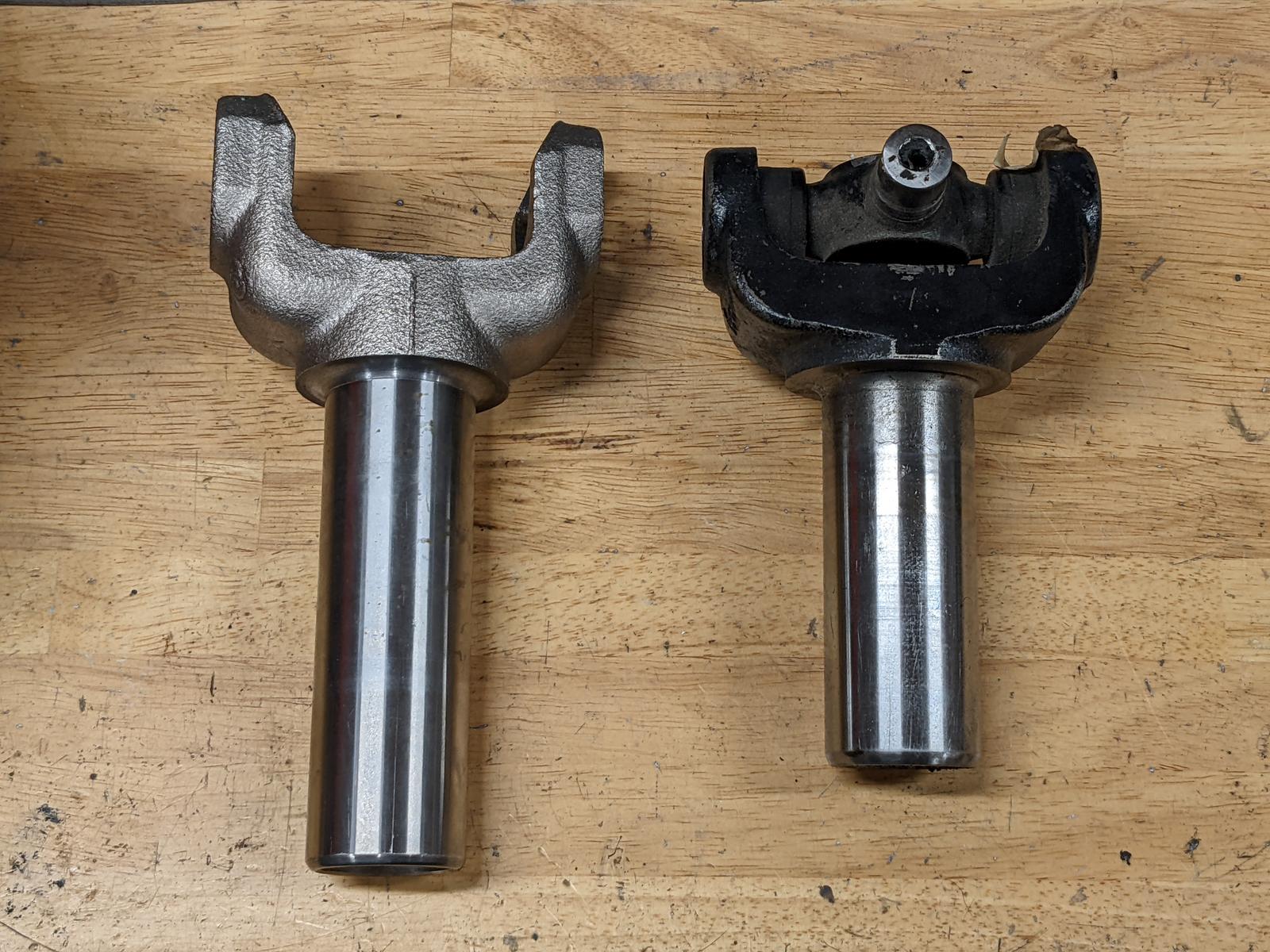

      Driveshaft came in and didn't fit...and I couldn't chuck it in the lathe to trim it down, so it went back to Texas to get fixed.

      Got it all connected from V8 crankshaft to rear tires. Put the Camaro clutch in it, fixed the trans yoke that Texas "fixed" and put it back on the ground.

      I had to cut the engine mounts out and change them to make the steering rack fit better. After butchering the stock subframe, I welded some structure back in and made my rack mounts.
      Once my rod ends and steering arms come in from Speedway, it should steer!

      The rack is basically as far back as it can be with those control arms. I would have liked another half inch or so, but that's where it's at. The tie rods will be at a slight angle back, when the wheels are straight, but it should be ok now. I would have tried to overtravel the inner tie rods if I left the v1 engine mounts in.
      I wouldn't mind a little bit more angle to the headers, but it couldn't be much, because the unibody where the subframe mounts would be in the way, and I'd lose floor space right at the firewall. I planned on staying super cheap and using the stock manifolds, but they would have put the downpipes into the firewall.
