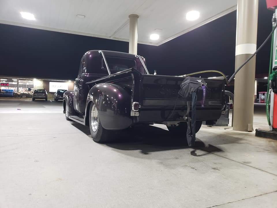

      I did however finally get to the dragstrip with the old pickup. I ran my first 5 in the 1/8th mile and drove it home round trip of 75 miles, so I'm pretty stoked about that. Especially with it being almost 4200lbs. Shes a hefty pig.

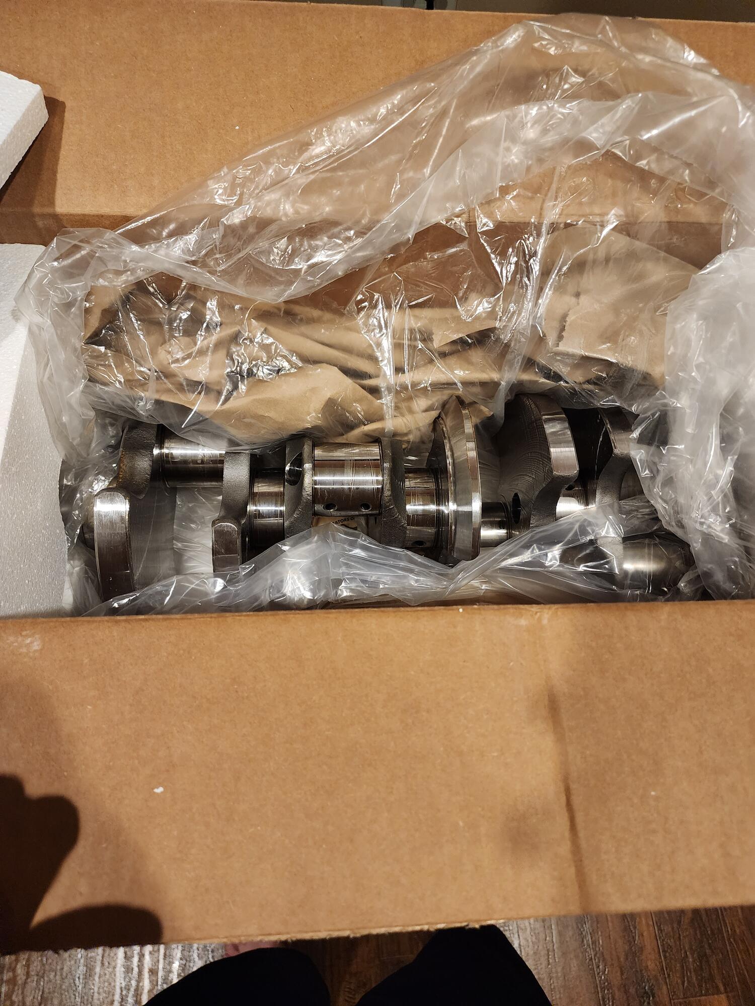

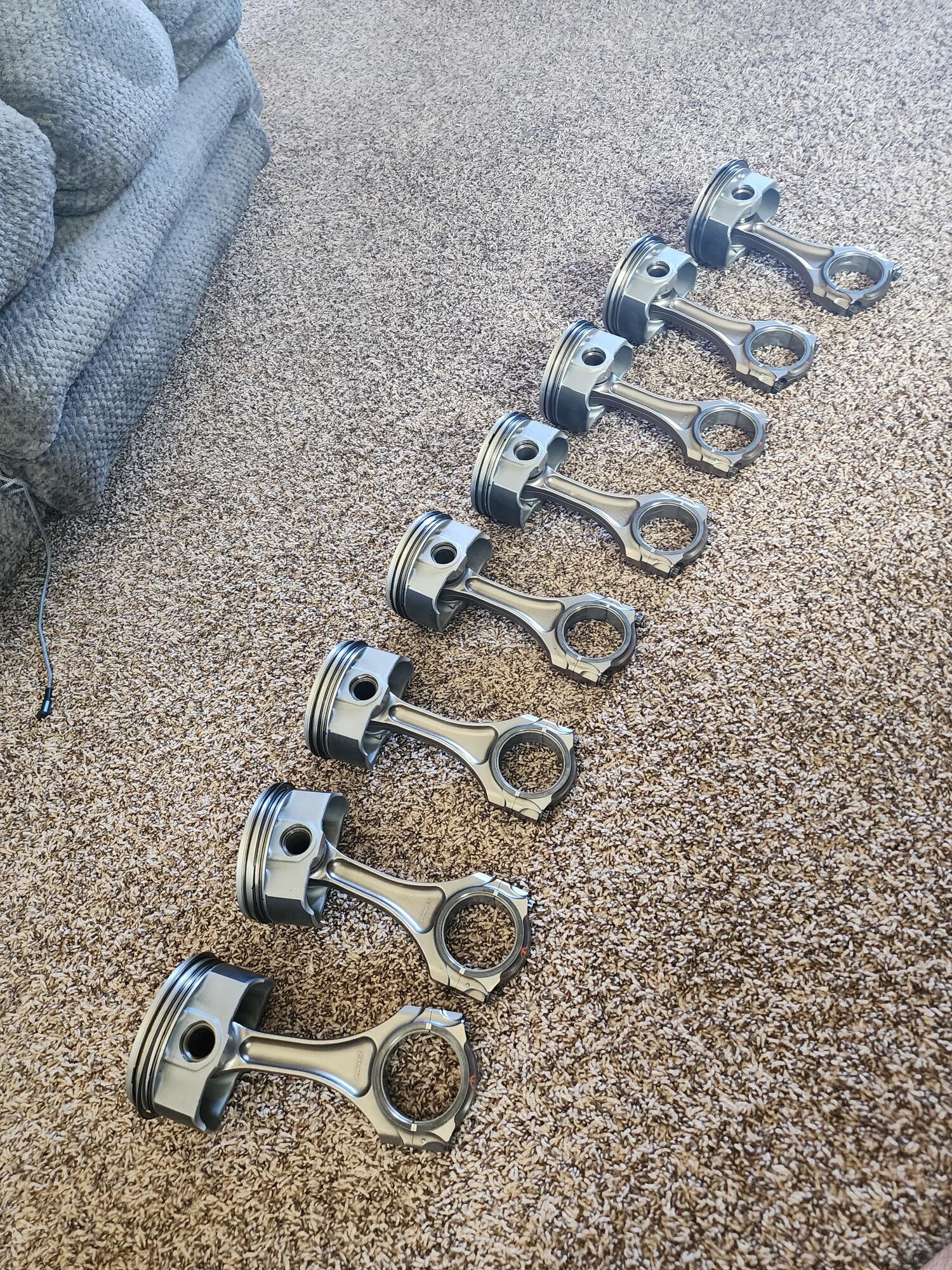

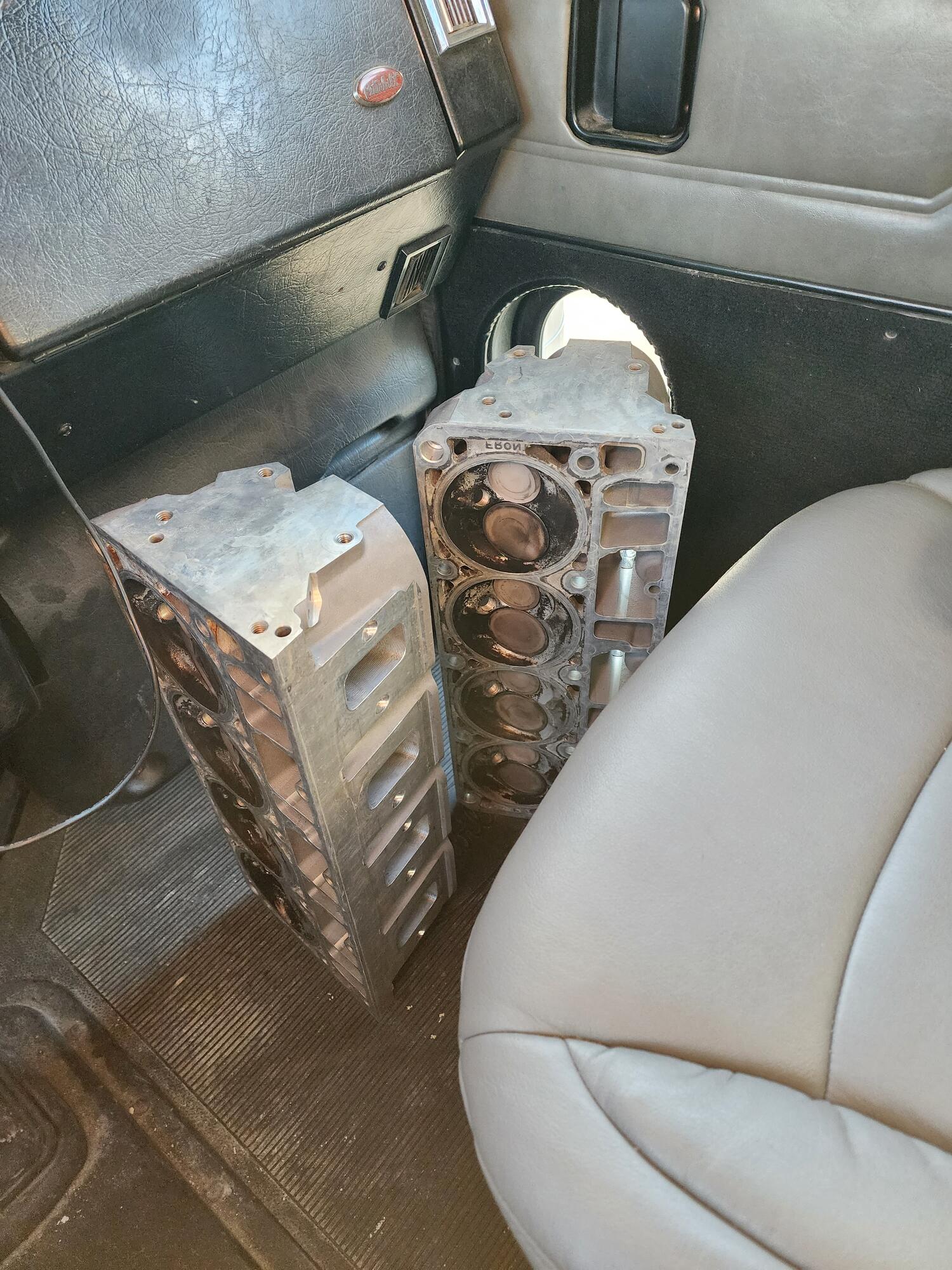

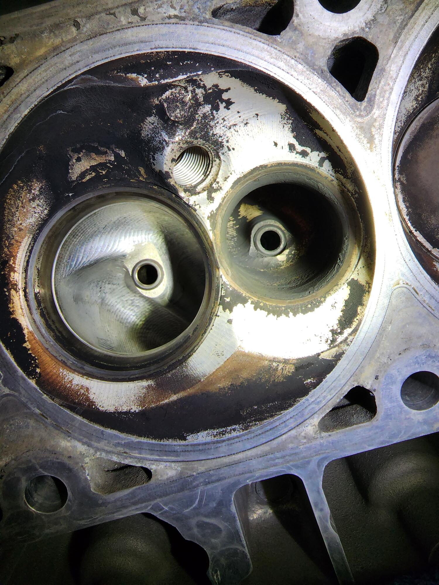

      So plans are changing a little. I'm selling the LSA setup. Picked up a set of stock ls7 heads, and the plan is to shoot for over 2hp per cube, on a pump fuel, stock casting block and heads, and still using a hydraulic roller setup. So, a L8t forged crank at 3.858", and a 4.125 bore, makes 413cid. It's gonna be pretty rowdy and I have a good few guys in my corner to help make it work. All in all, it should honestly end up being close to the same price as the whole LSA setup I had planned. Nothing too exotic is planned for the parts either. I also snagged up a Holley Dominator. Still not sure if I'm gonna toss it in my 50 chevy, and swap the terminator x into the camaro, or keep the dominator for the camaro. Some more sheet metal came in too. I just pulled the trigger on a bunch. Both full quarters, roof skin, outer wheelhouses, both full outer rockers, and most of the big trim pieces to make this have the RS front end.

      I could be wrong, but it looks like those heads have been CNC'd. Really nice parts update! That should be rowdy with 800+ HP!
      108
      Yeah, I guess news to me, ls7 stuff is factory cnc'd. I had no clue! Kinda cool, and crazy to think there's so much more to be had across the flow numbers on these heads.

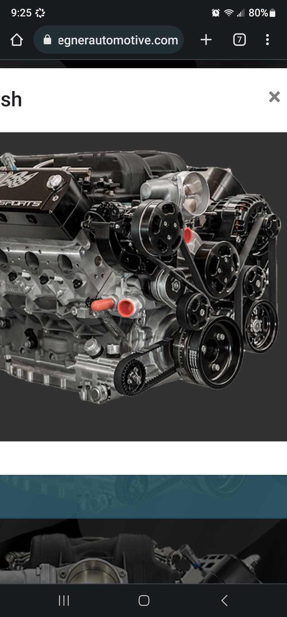

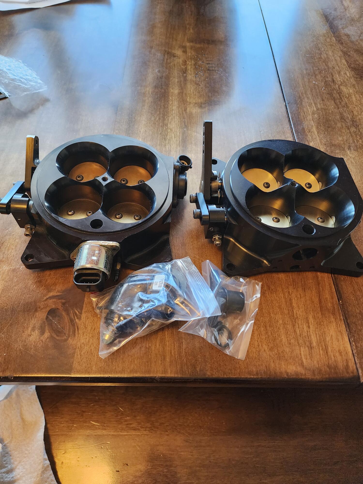

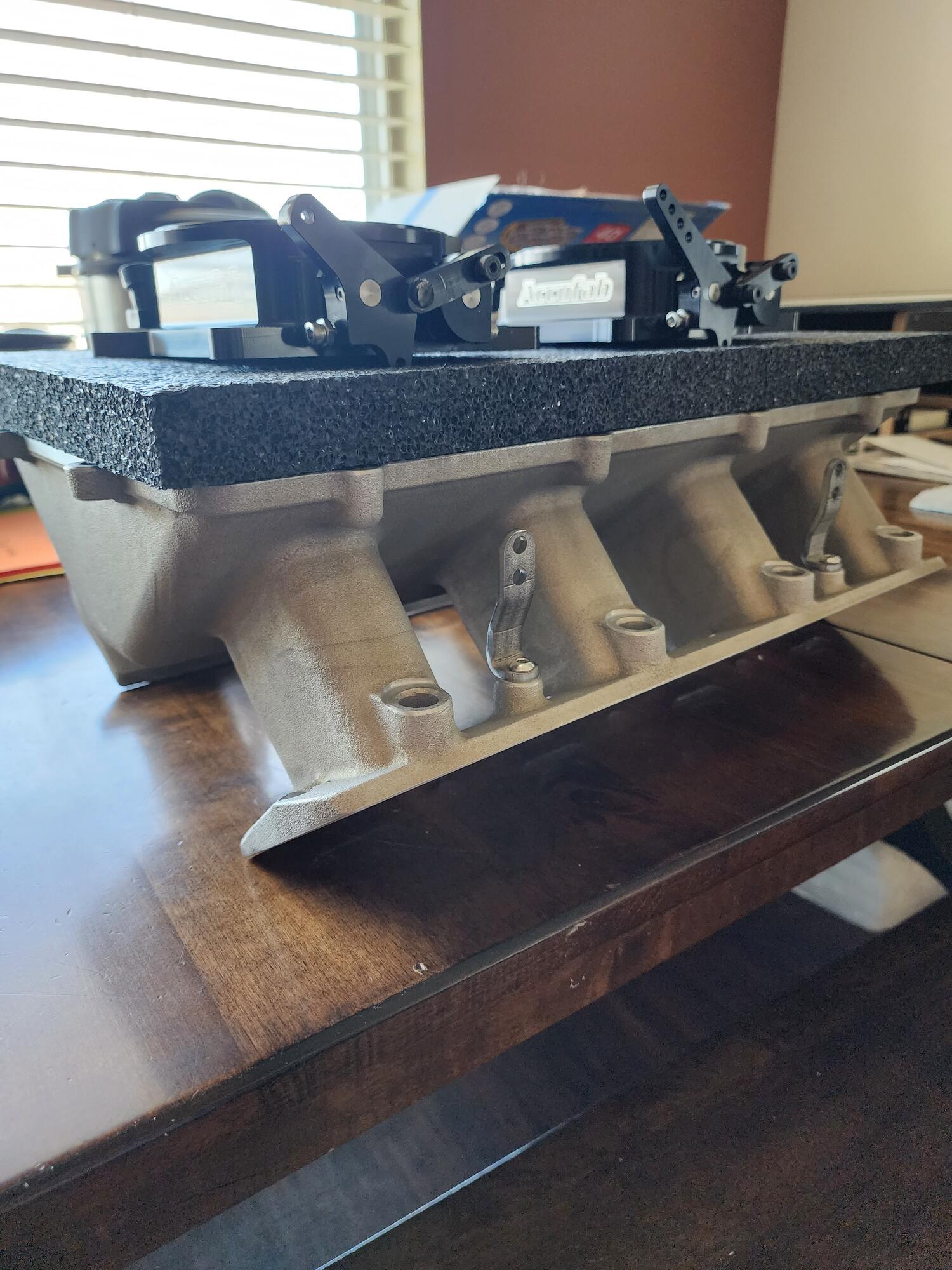

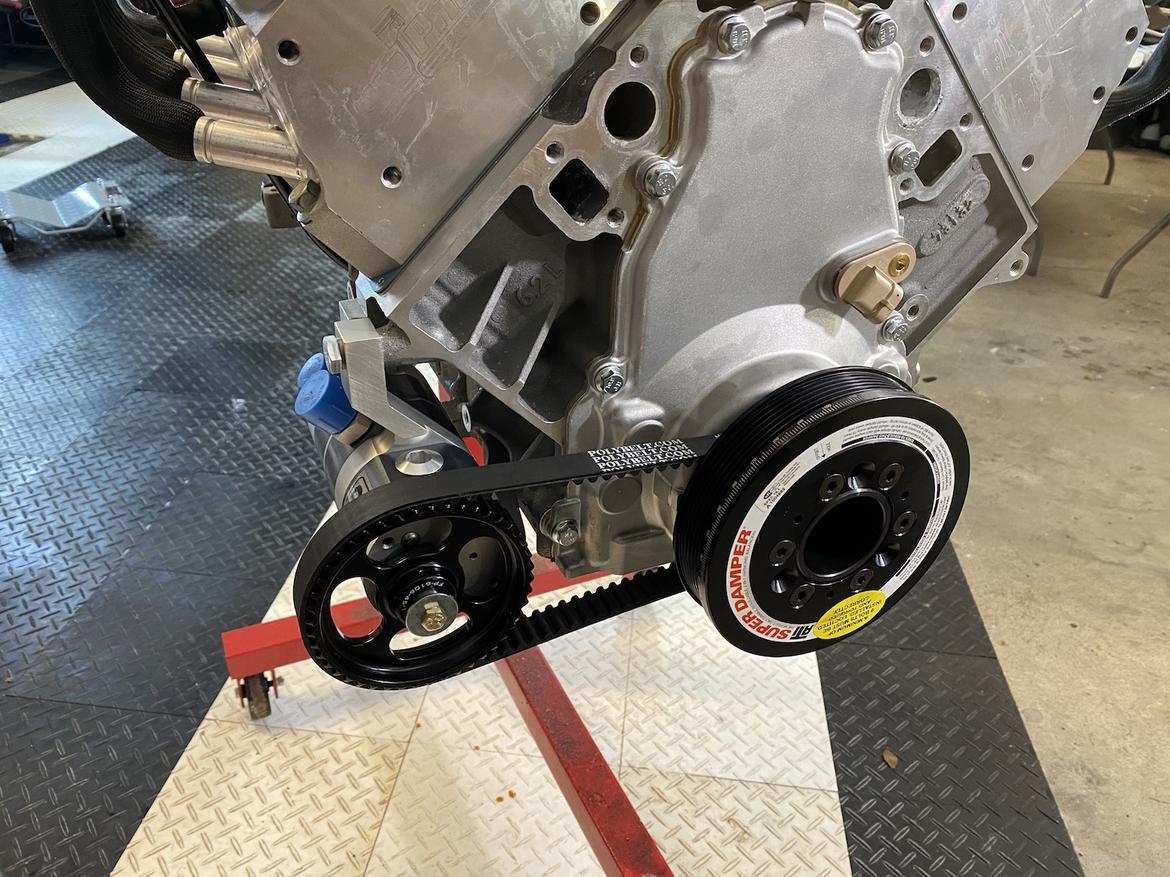

      Few more goodies ordered and on thr way. Twin accufab 4150 throttle bodies, aviaid external wet sump, wegner front drive with AC.

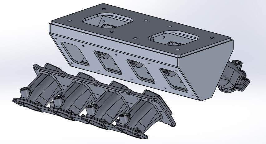

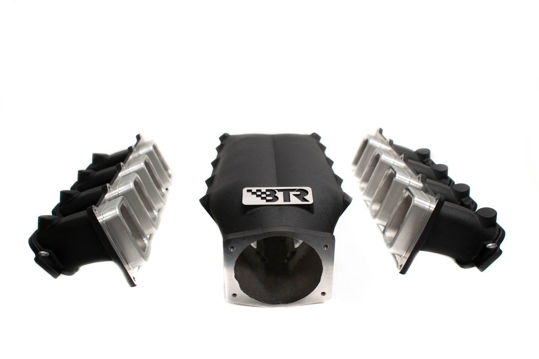

      Couple things were doing to make the power and rpm were asking out of this thing. We got the runner sections and furl rails off a BTR manifold, and are having a custom made plenum made to fit under a short cowl hood with air cleaners, and still have some runner length.

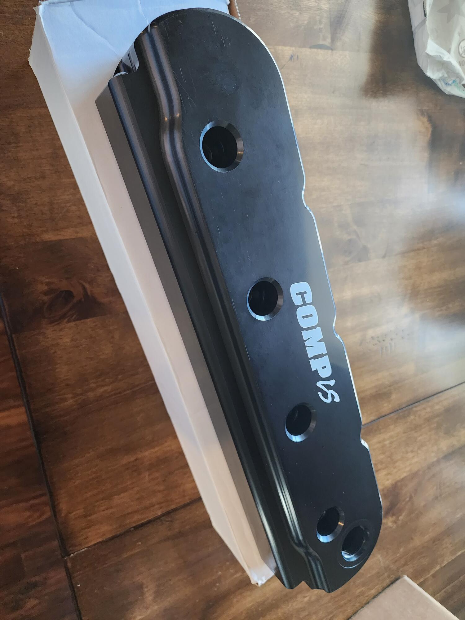

      Next is getting some tsp LS7 roller tip rocker bodies, and toss in some CHE bronze trunions, and put them on some comp full shafts that will be forced oiled.

      Well, almost all the engine parts have showed up, and the last of the engine parts are gonna be ordered Monday. .903 Johnson tie bar lifters, crower shaft mount rockers, a BIG boy cam, head studs, main studs, and upgraded rod bolts. I also got rid of the BTR intake idea and grabbed a texas speed 2 pc intake for cheap. So now the top plate to mount the 2 throttle bodies should be considerably cheaper. Found a set of ls9 rods and pistons for $450, so that helps with the bottom line of the motor.
      So, next month or two, the parts will all be going down to 2jmfab in Texas for machine work and assembly. 4.155 bore sleeves installed in the 5.3 block, lifter bores cut to fit the .903 lifters, true up the block, and a bunch of work to the heads. Cam designer says this engine may end up over 900hp. Lol so, we will see if it's gonna be too much for what I'm wanting to do with the car.
