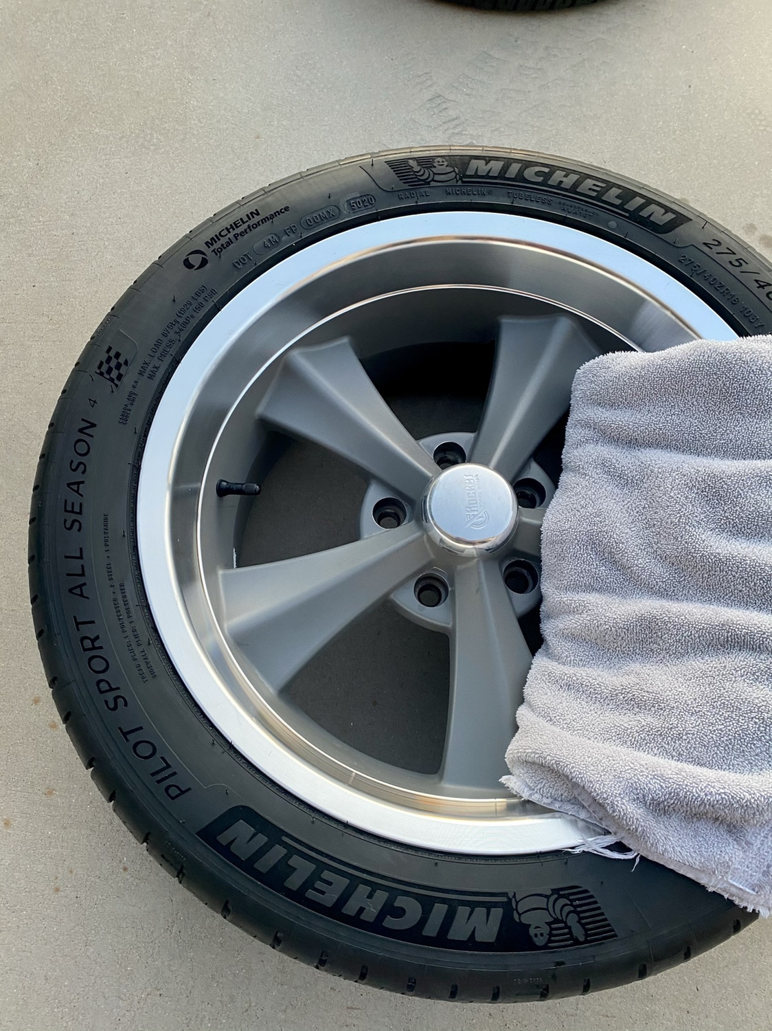

      Thanks! Love to see a picture of your tire/wheel selection. I live in Florida, so a "summer" tire will be the obvious choice for me. I will be taking this on Hot Rod power tour this year (taking my dad), so so sort of ride comfort would be nice.
      Jan 2016
      Arizona
      169
      Quote Originally Posted by FlyingRN View Post
      I run pilot a/s4’s up front and I run a sticky sumner tire out back.
      The original summer tires up front were tearing the paint off of everything under my truck so I switched them out to pilot all seasons. And they are a fantastic tire. I’m half tempted to try a set on the back to see how they hold up. my truck makes 640whp so I kind of have to run something sticky on the back though.

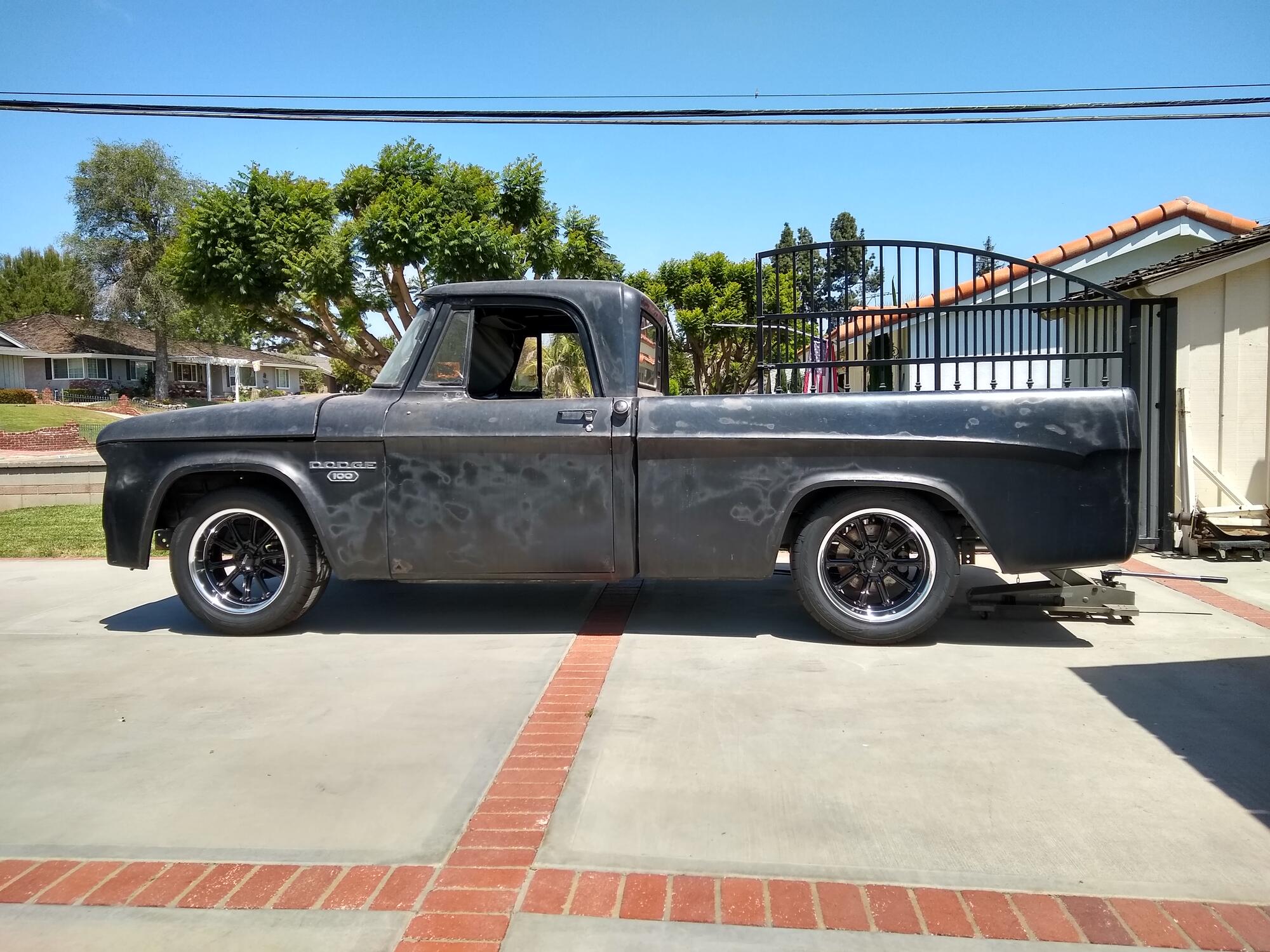

      I’m running the same wheel in back (but black) and a 295/45-18 Nitto NT555 G2. Don’t know how they are yet since my truck’s not running. Don’t pay attention to the front, that’s the other back wheel. The front wheel will be 18 x 8 w/ 255/45-18. Front will also be 1 - 1 1/2 inches lower w/ engine and trans. I didn’t want to go shorter than a 45 series so the options are more limited. Good luck with your truck. Oh, and it’s also a Dodge. ��
