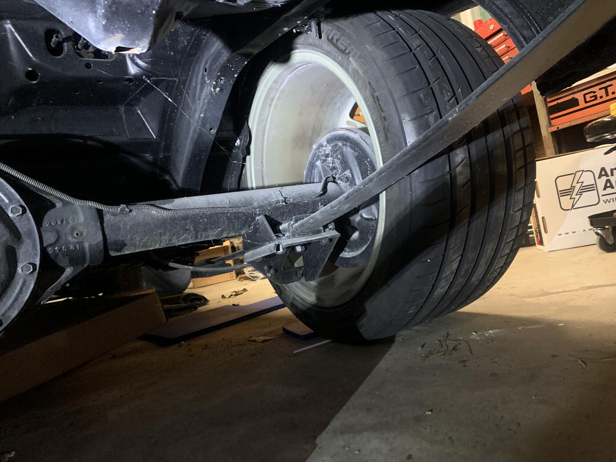

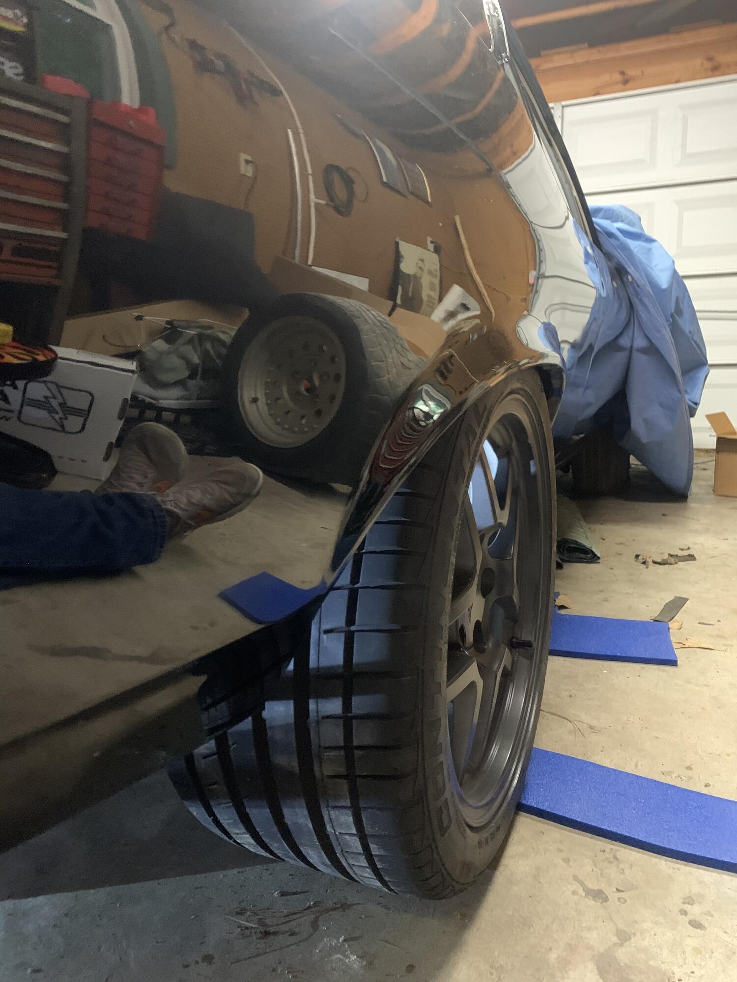

Size:  291.4 KBName:  E88DD102-F0D7-441A-B78C-D60DBE8BCF3F.jpg
      Pics of test fitting a 295 tire- cause everyone likes pics!

      I would go with 10s to give more lateral stability. Plus the depth will make it look more aggressive.
      Here's a C10 with 295s on a 10" for reference.
      http://67-72chevytrucks.com/vboard/a...1&d=1391745292

      10" wide rear wheels aren't so bad as long as the tire width stays reasonable. Don't be afraid to stretch the tires a little bit.
      IMO it's stupid when guys are sweating whether that last 10 mm of tire will clear all the sheetmetal. If you have to ask then it doesn't fit. Axles & tires move around on street cars.
