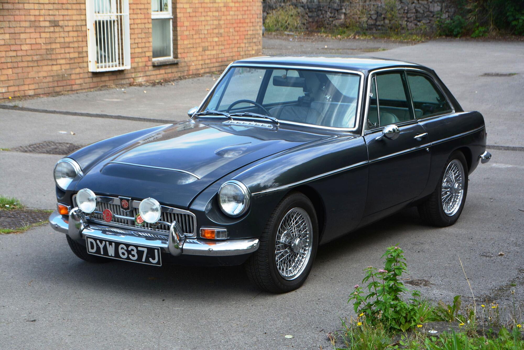

      I have owned an MGC-GT for a number of years. Not my picture, mine's buried in a barn
      Click image for larger version.

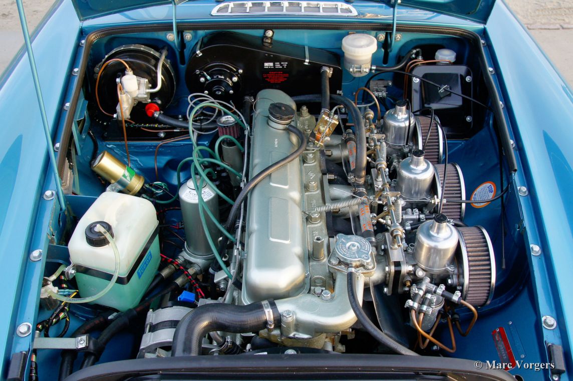

      It's been parked gathering dust since I blew the engine up a couple years ago. Many people are aware of the MGB- the MGC was the much less common six cylinder variant. Basically, everything under the hood and inside the front fenders from firewall forward was different.
ID:	189431Click image for larger version.
      The engines are externally huge and heavy, while being small displacement on undersquare based on then current UK tax laws. Displacement is 2.9L, 3.28 bore x 3.50 stroke. The engine will never be an RPM monster because you can't get enough valve in it. It was supposed to be a long distance tourer, so torque production was targeted.
      So I'm here 50 years on with a spare block thinking- this thing is supposed to have long legs, how about getting more displacement in it? A friend has a similar idea, but you can only bore the deal to a little over 3.2. So I'm thinking there are two other ways to add displacement - stroke and cylinder count. Adding cylinders is out, so I'm starting to investigate building a stroker. Unlike US engines where stroker cranks are readily available, there is a limited supply of cranks available for this engine (it went out of production circa 1970), and essentially no aftermarket support.
      In stock form, the motor is very lazy, the rods weigh about 1100 grams, and the piston iskit is 4" long w/ a 2" compression height They come in about 450 grams. And it has a 32lb flywheel. Did I mention the engine was lazy? The deck height is 10,25", so there is room for more stroke. there appears to be significant cam clearance, and the crancase is fairly wide. I've actually looked at aftermarket flathead Ford rods as a weight reduction to get this deal to spin up a little faster (they are .400" longer then stock, use the same bearing diameter, albiet a narrower bearing. And weigh almost 400 grams each less.)
