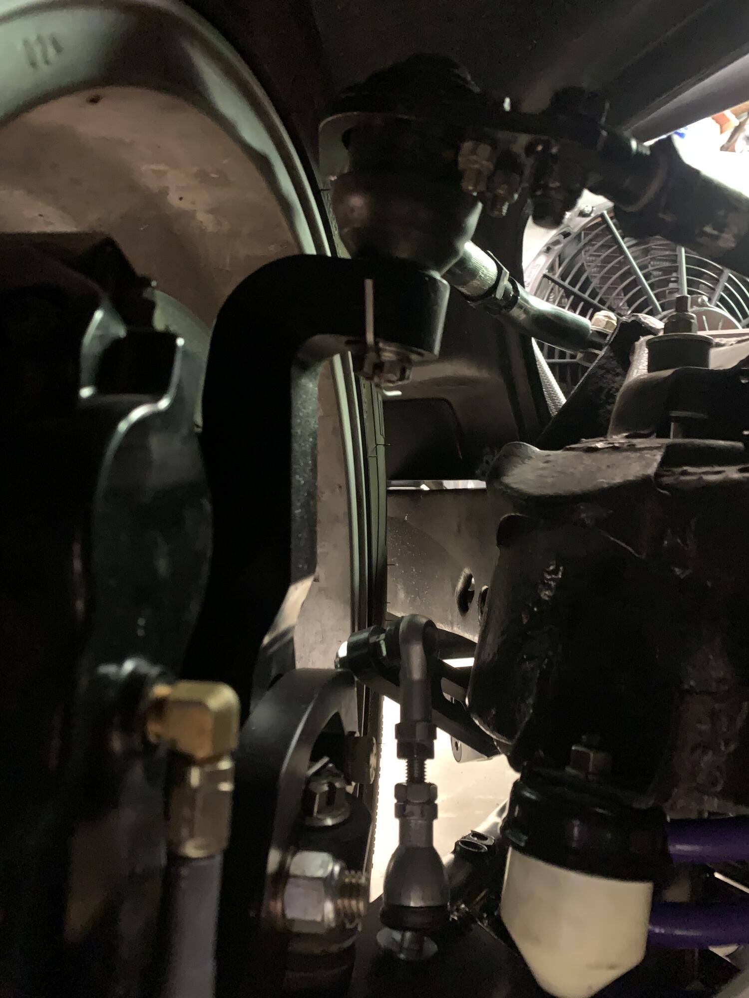

      This was about the best picture I could get...
      Thats the driver side, with the wheel turned to the right. You can see how close it gets to the front of the upper arm. I did see posts where you can flip the upper SPC and grind the frame where it attaches. I wanted to see if the ride tech would bolt up, without any cutting metal out of a stressed area.

      Here are a couple shots. The first one shows a comparison with the SPC arms. Right where the ridetech arms have more clearance is where I needed it... I have about 1/8th inch clearance at full lock on the arms!!!
      I see now why there is more clearance with the RT arms....cantilevered ball joint plate.
