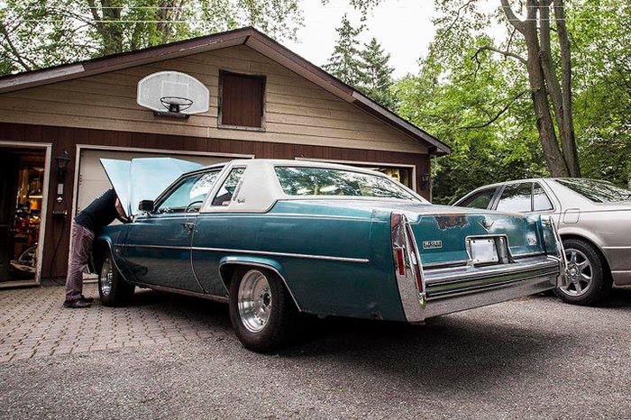

      Most likely the starter you have is as tough as they come from GM. I do know the starter on the '77-'79 425 is strong unit. Ours hated to start as well ('79 starter), so we put a retard box on it which takes 20 degrees of timing out, just to start the engine. Works perfect.
      As for the car, it's a '79 CDV and it's fun.
