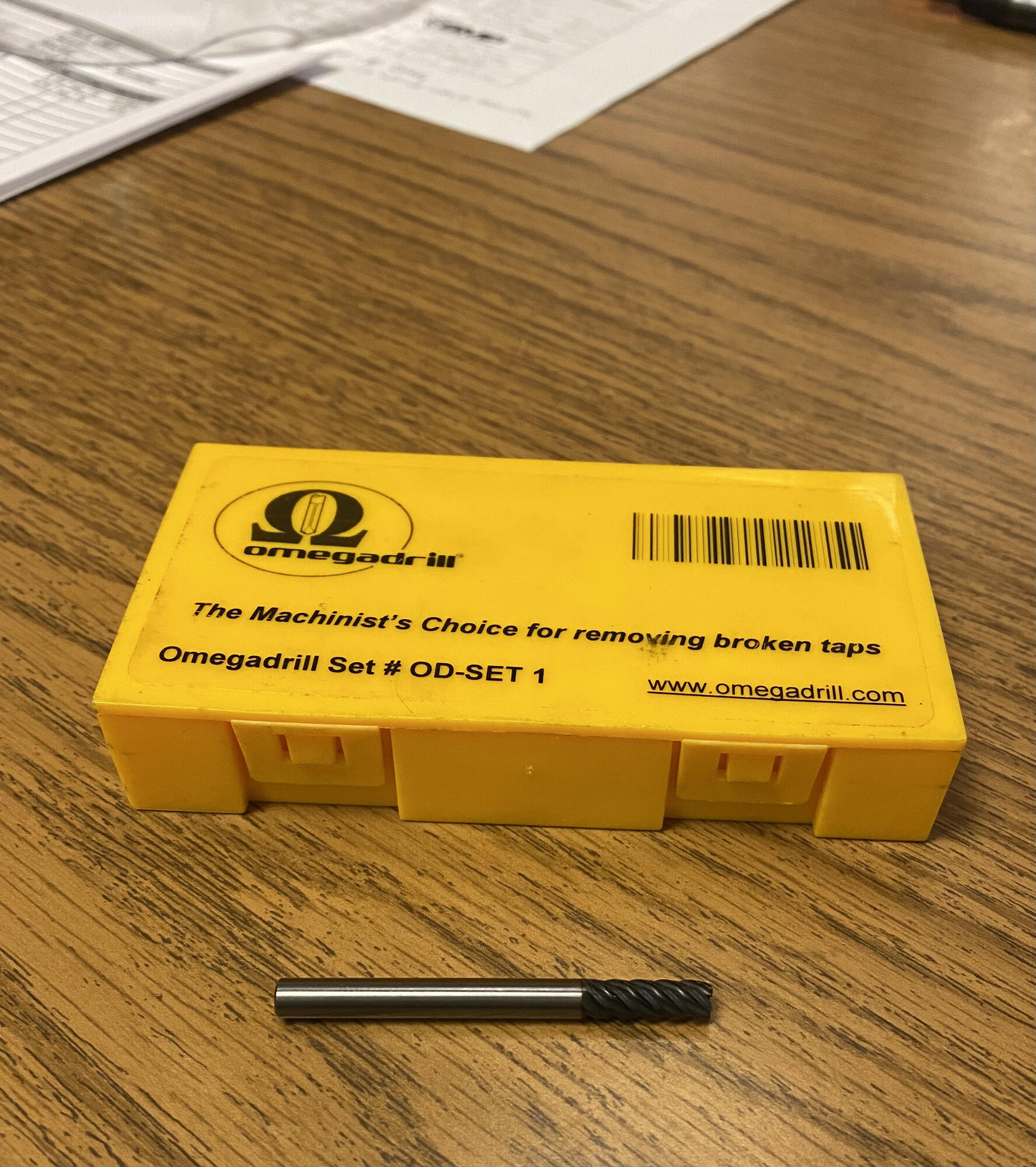

      Spoke to one of our machinists at work and he gave me another non-destructive approach. Have to take the cross member off anyway so trying a drill press option.
      Feb 2013
      South Carolina
      935
      And this is done. Ted (machinist) gave me the Omega drill kit and a couple of old carbide end mills in the right size. It would have been even cleaner on a mill but the drill press got me where I needed to be. Started the hole with the carbide mill and blew through the rest of the tap with the Omega bit. Probably put a spot of weld on it, re-drill and tap to finish it out.
