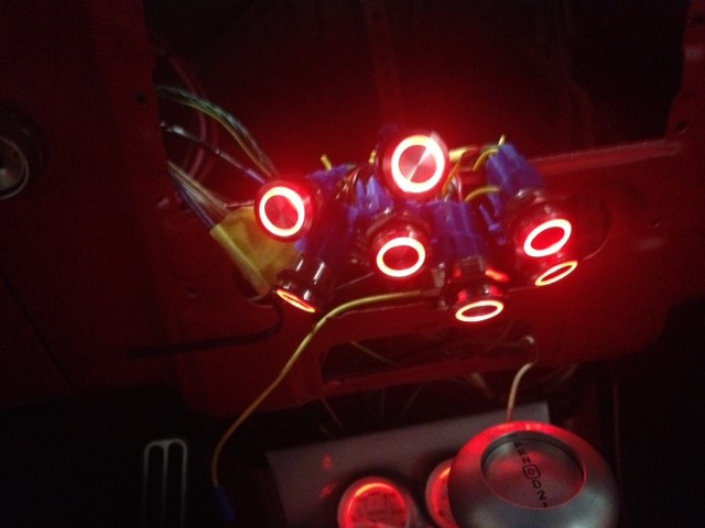

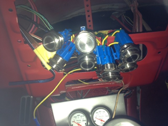

      I was thinking of getting 12 of these https://www.aliexpress.com/item/3301...archweb201603_
      I've seen the $50 billet ones but don't want to spend a ton until I'm sure I'm committed to this console.

      Also, for us lazy people that have no desire to build our own pretty relay box, is there anything out there that is prebuilt that can power all 4 windows and 2 door locks that I can just buy and run my switch wiring and window wiring to?
      Project thread - https://www.pro-touring.com/threads/...ouring-Project
      IG - @tc_chevelle
      Jul 2011
      Nashville/ Tampa
      730
      The was a place making something called a Black Box (Ron Francis maybe) that had 10 or so programmable relays for doing just that. I had one and some of those Watson Street Works switches shown above a few years ago. Not sure it's still available but it wasn't cheap even when it was. Might pop up on ebay. Or just spend $50 and an hour and make a relay box.
