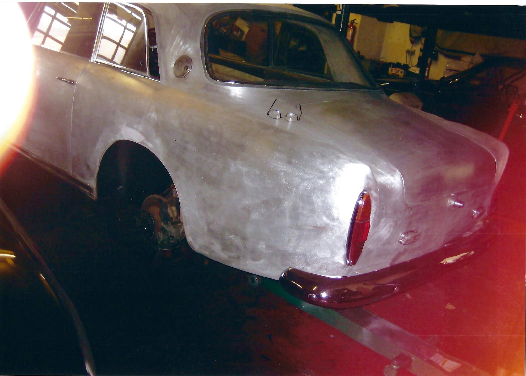

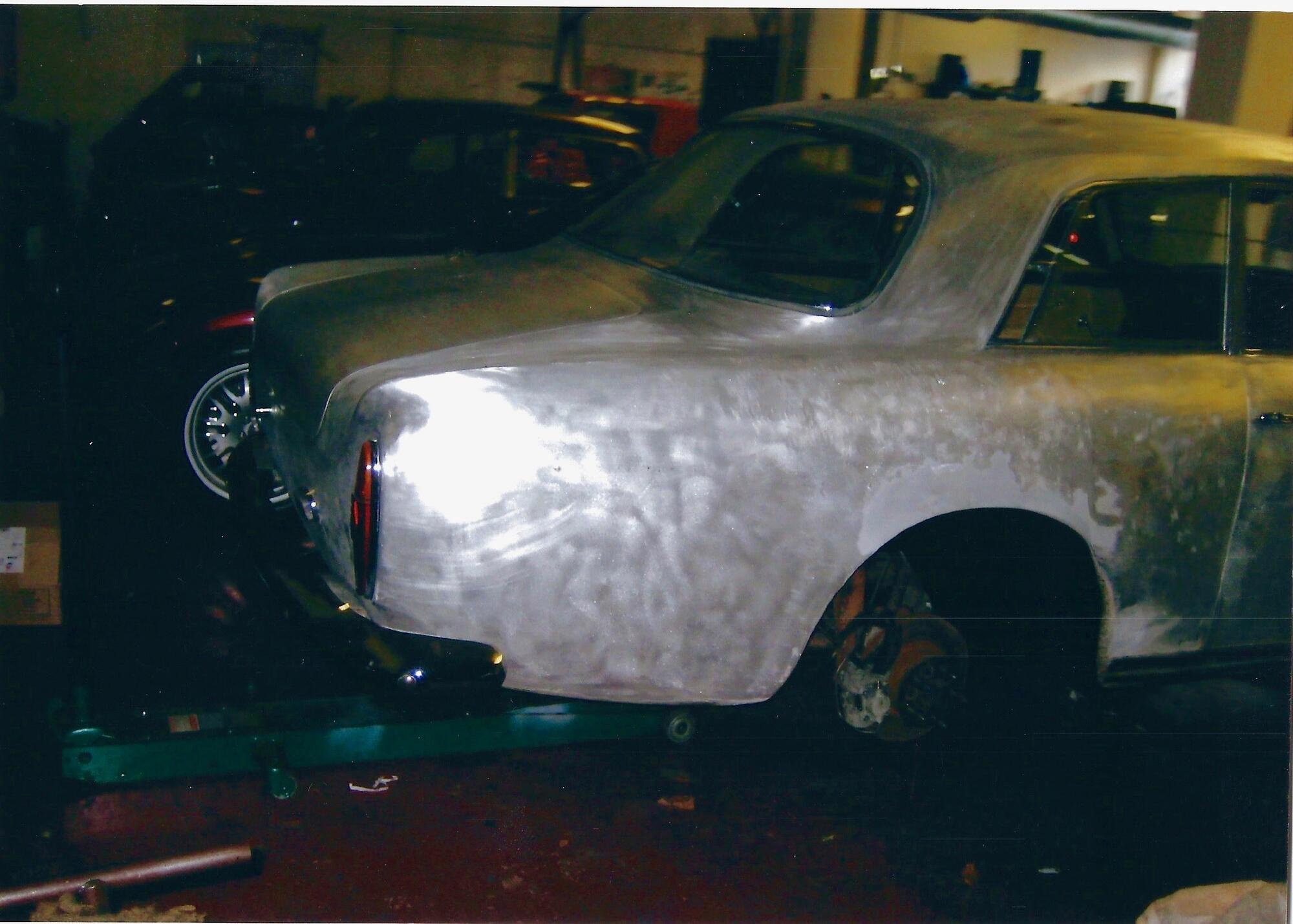

      So this was the original car:
Size:  274.8 KBName:  B0BB6851-1117-431A-AAB1-90A553821FED.jpg
Size:  291.2 KBName:  B8E3EA76-23AD-4A4B-8267-8B310399D832.jpg
Size:  228.2 KBName:  7C1FB0FF-570E-44BB-AE7B-2D473273A95B.jpg
Size:  471.4 KBName:  F3144F49-F450-462E-A311-3022431696D1.jpg

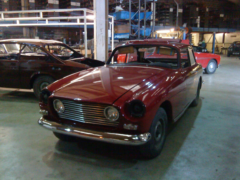

      Yes! 1965 Bristol 408
      Here’s the car prior to stripping

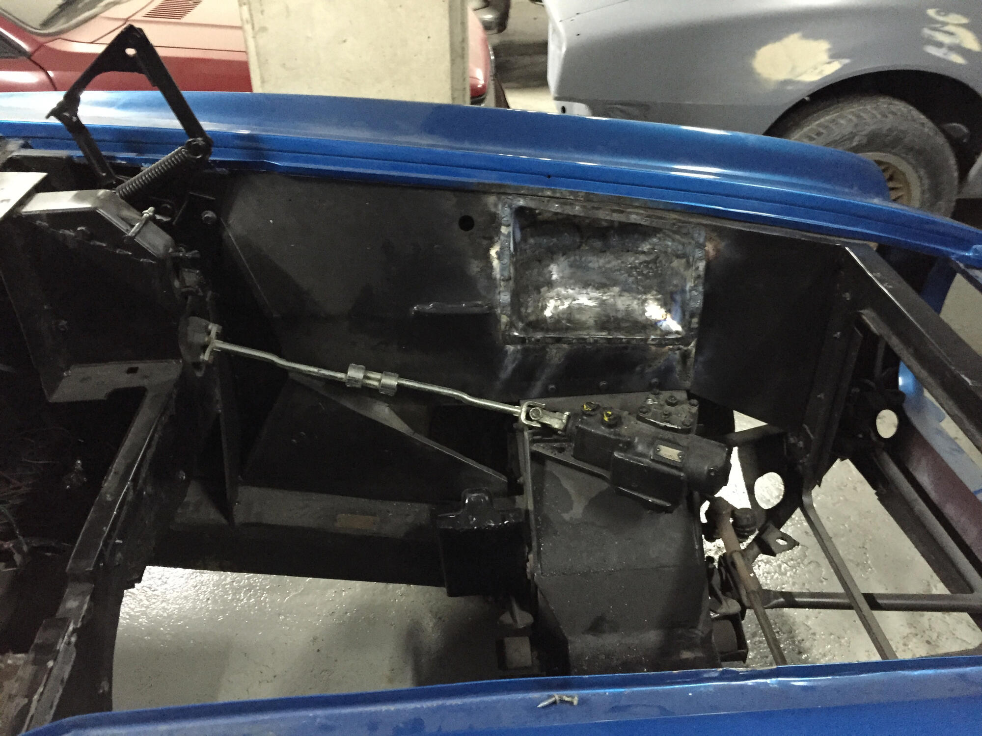

      Unfortunately I dont have a full photographic record of all the work, but will try to give you relevant highlights.
      First order of business was to make the car left hand drive. I managed to source an original Bristol LHD steering box. These were made by ZF and are excellent with a good feel. Here’s the new steering column

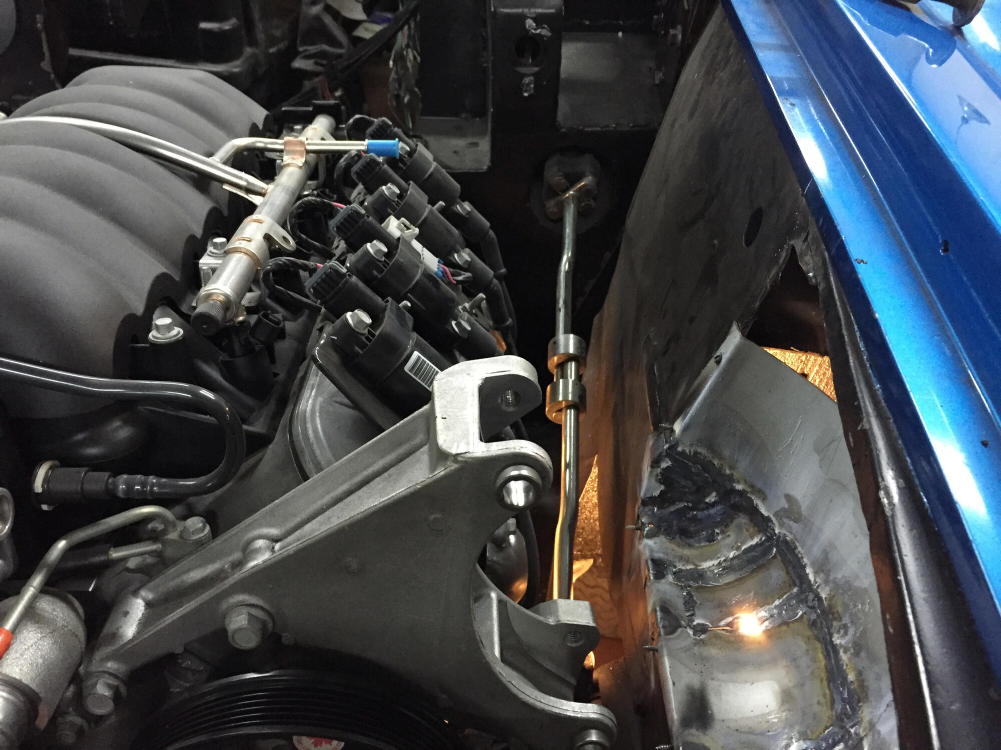

      Engine mounts were a challenge. In the end, I used Cadillac Escalade mounts welded to the chassis

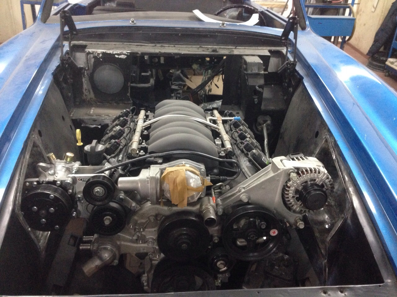

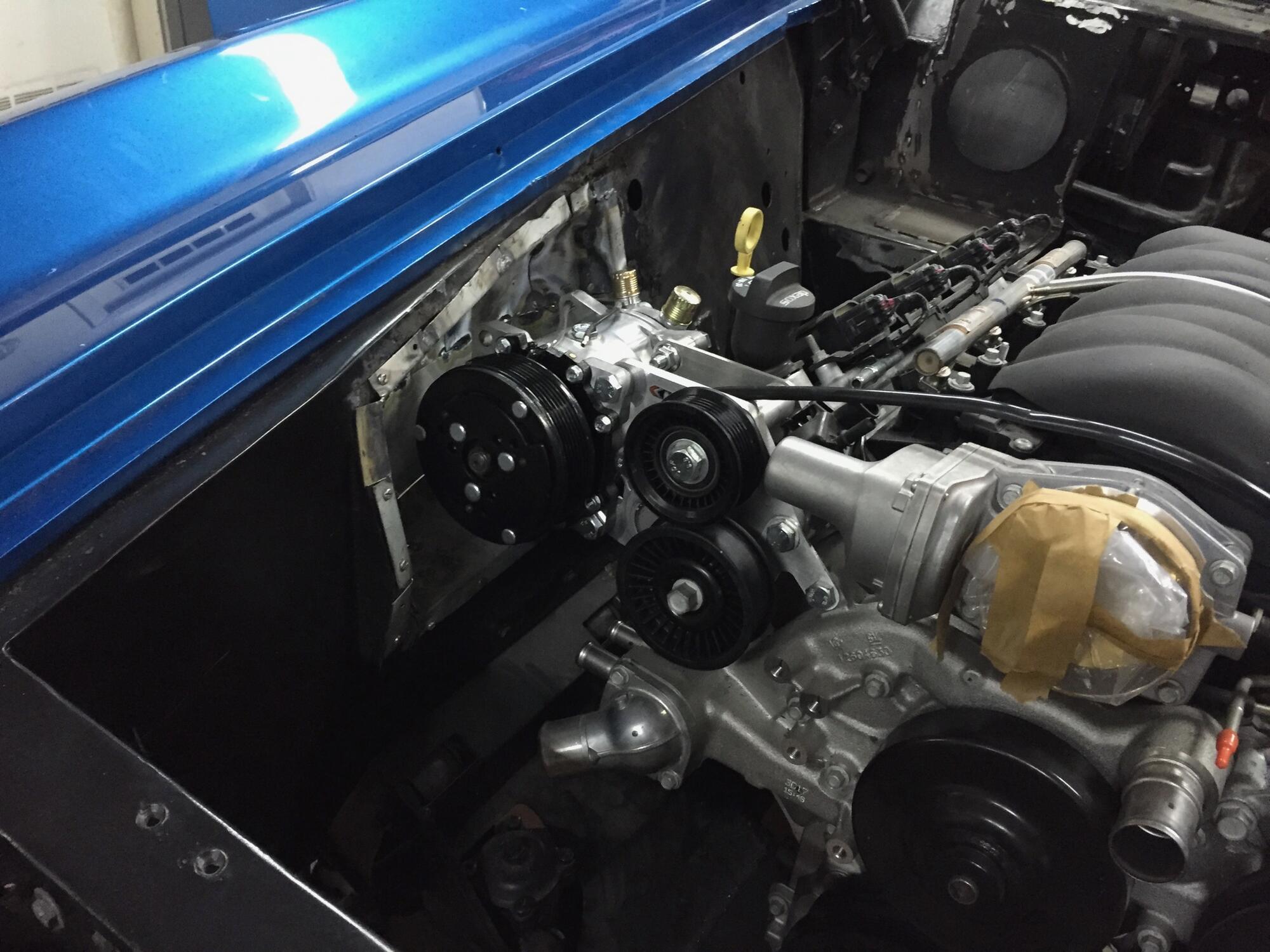

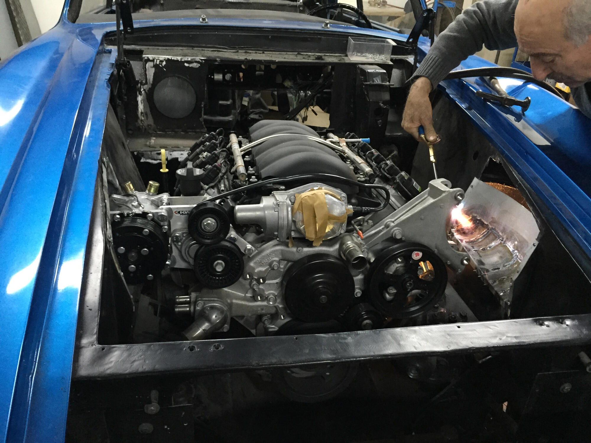

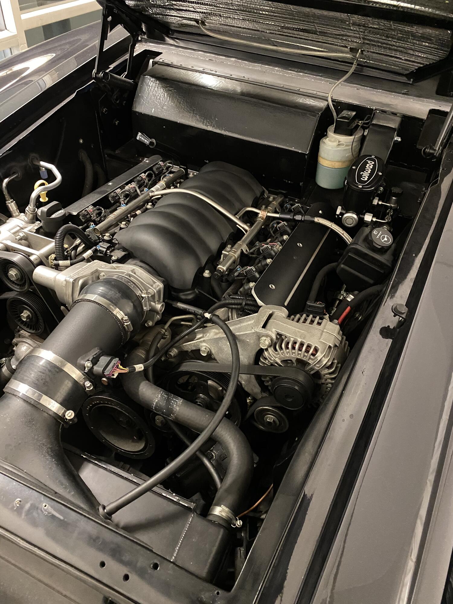

      The Bristol original engine was a Mopar 318 (Canadian version) with a few tweaks. I chose to go to a much more modern alternative, but could not find a Hemi engine that would work. The easy choice was an LS 376/480 with a 4L70E gearbox. It is great from a weight and location standpoint, effectively bringing the center of gravity much more towards the middle of the car and reducing weight on the front axle. The big issue was how to fit the alternator and AC compressor. I needed them to be as low as possible to clear the hood, but width became a problem. Solution for this was to craft “ears” in the engine compartment to fit everything.

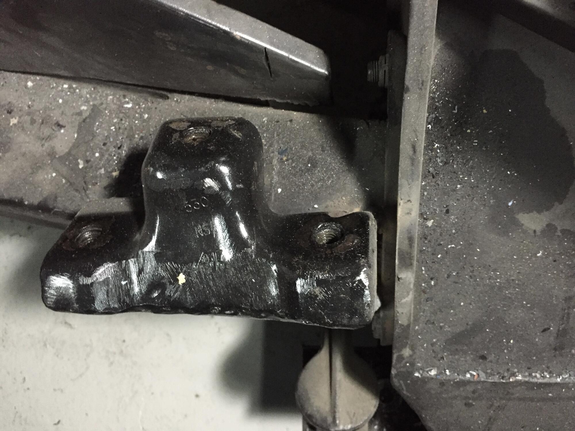

      Work on the braking system :

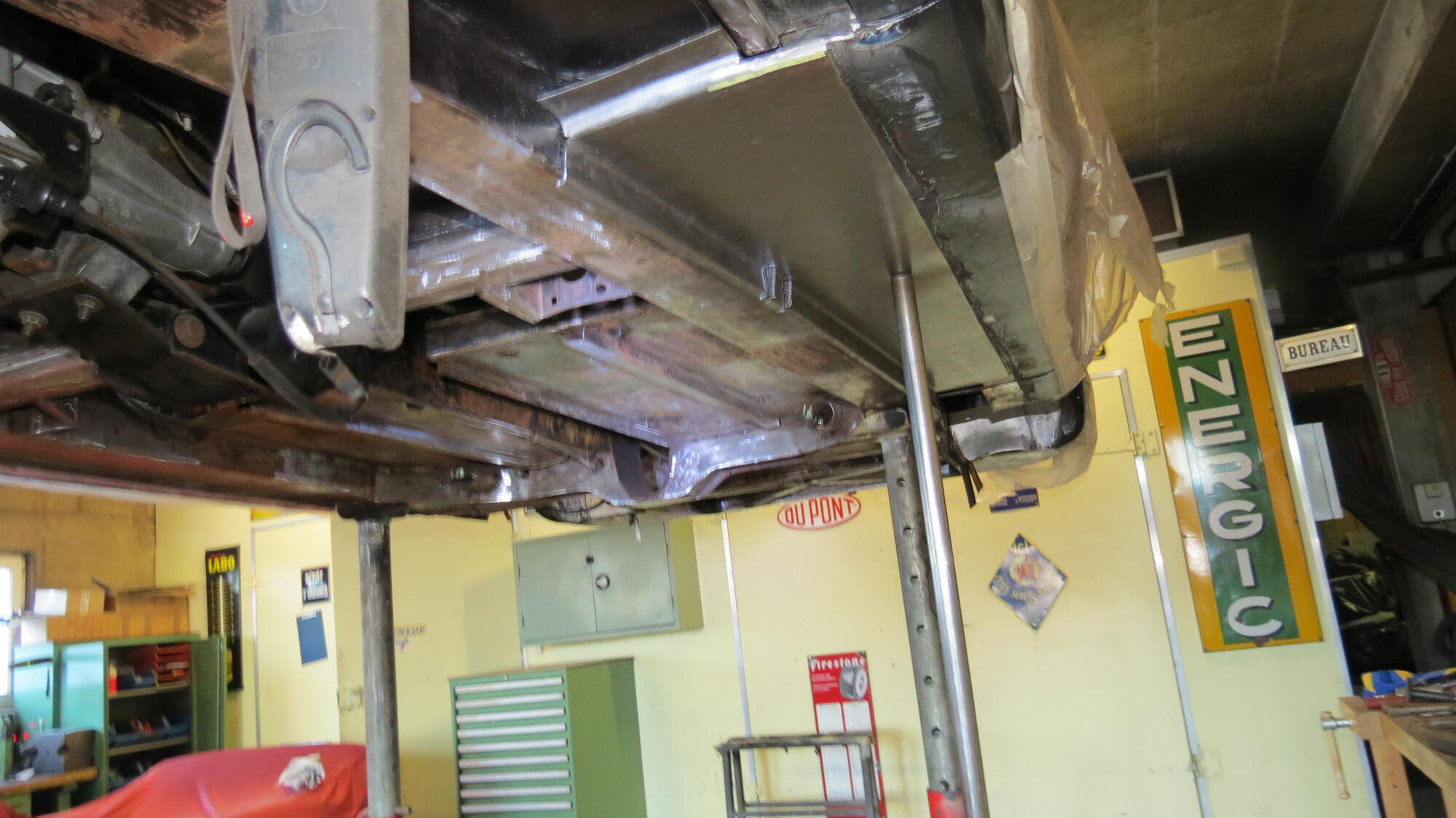

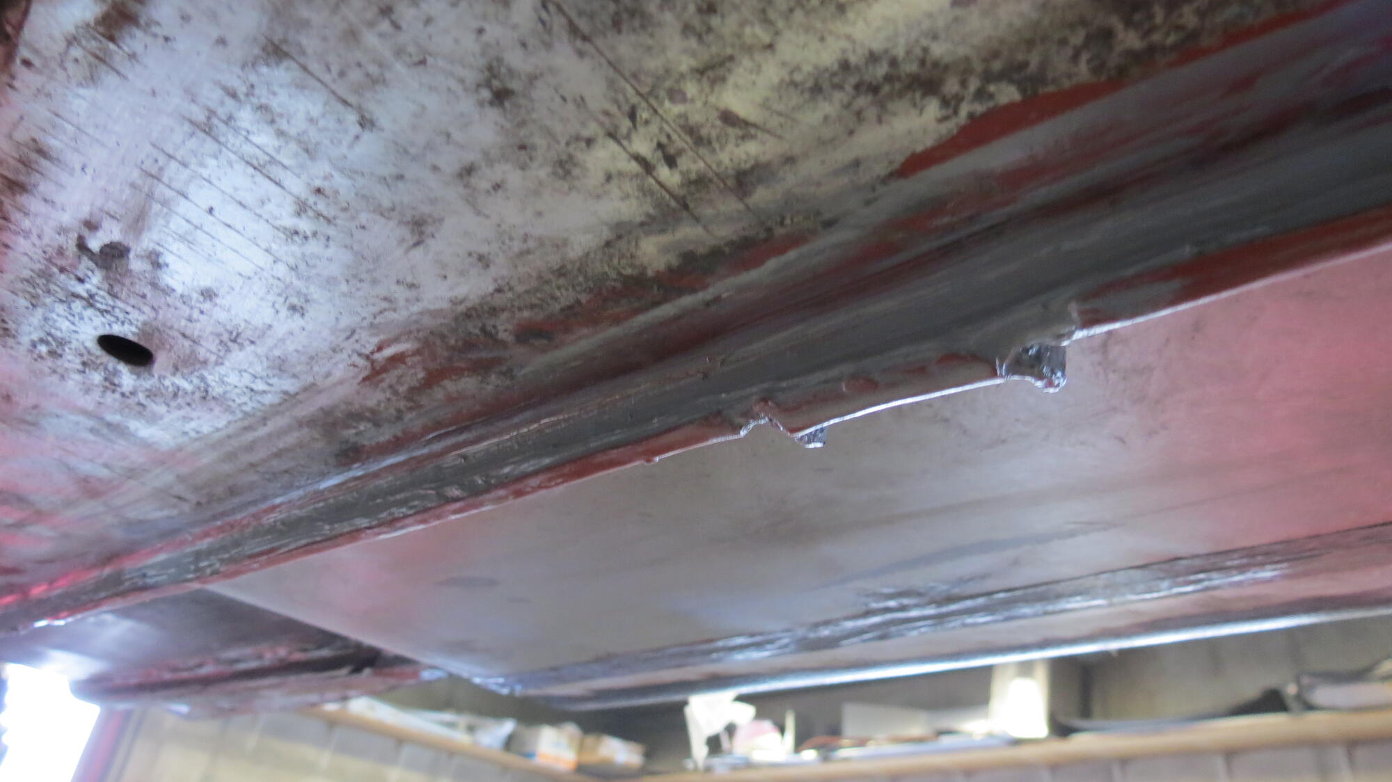

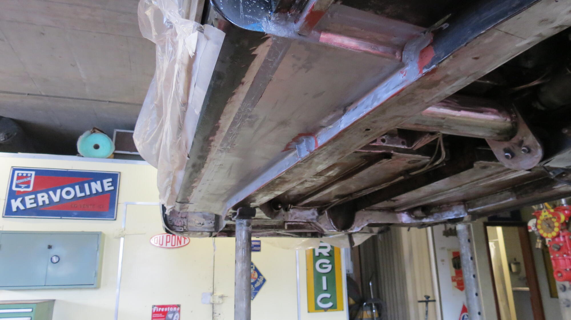

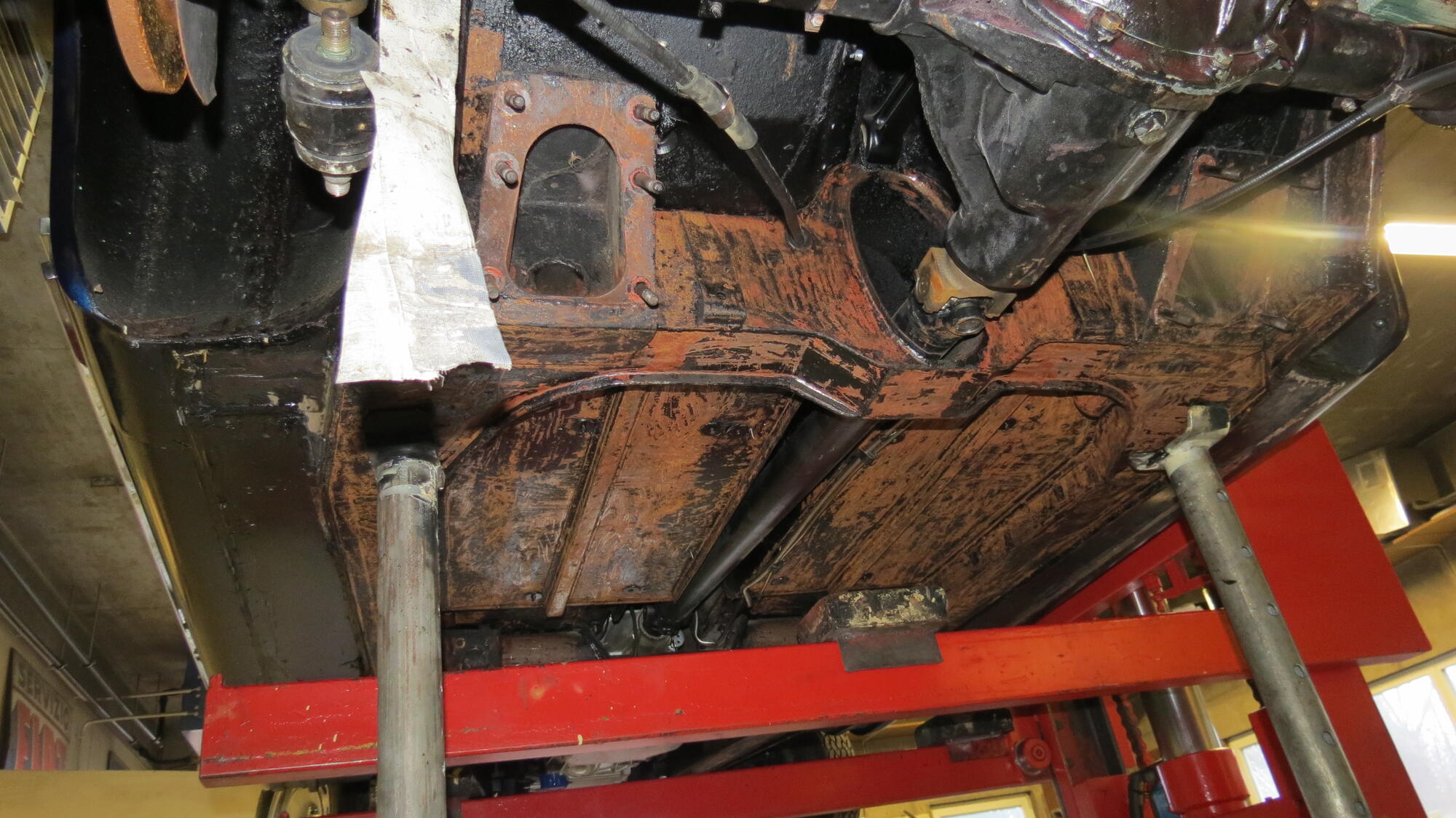

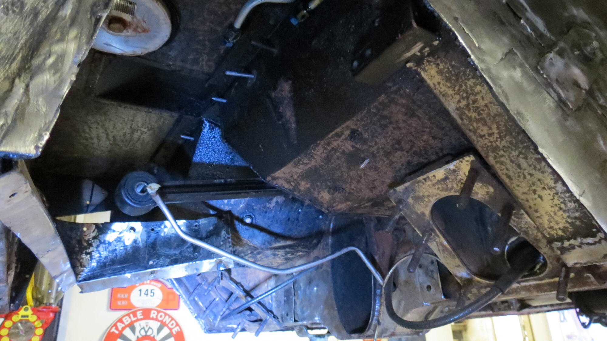

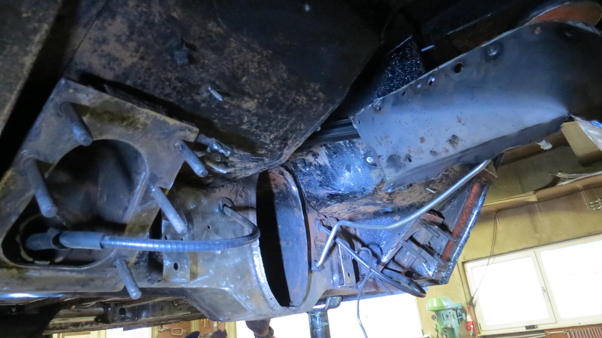

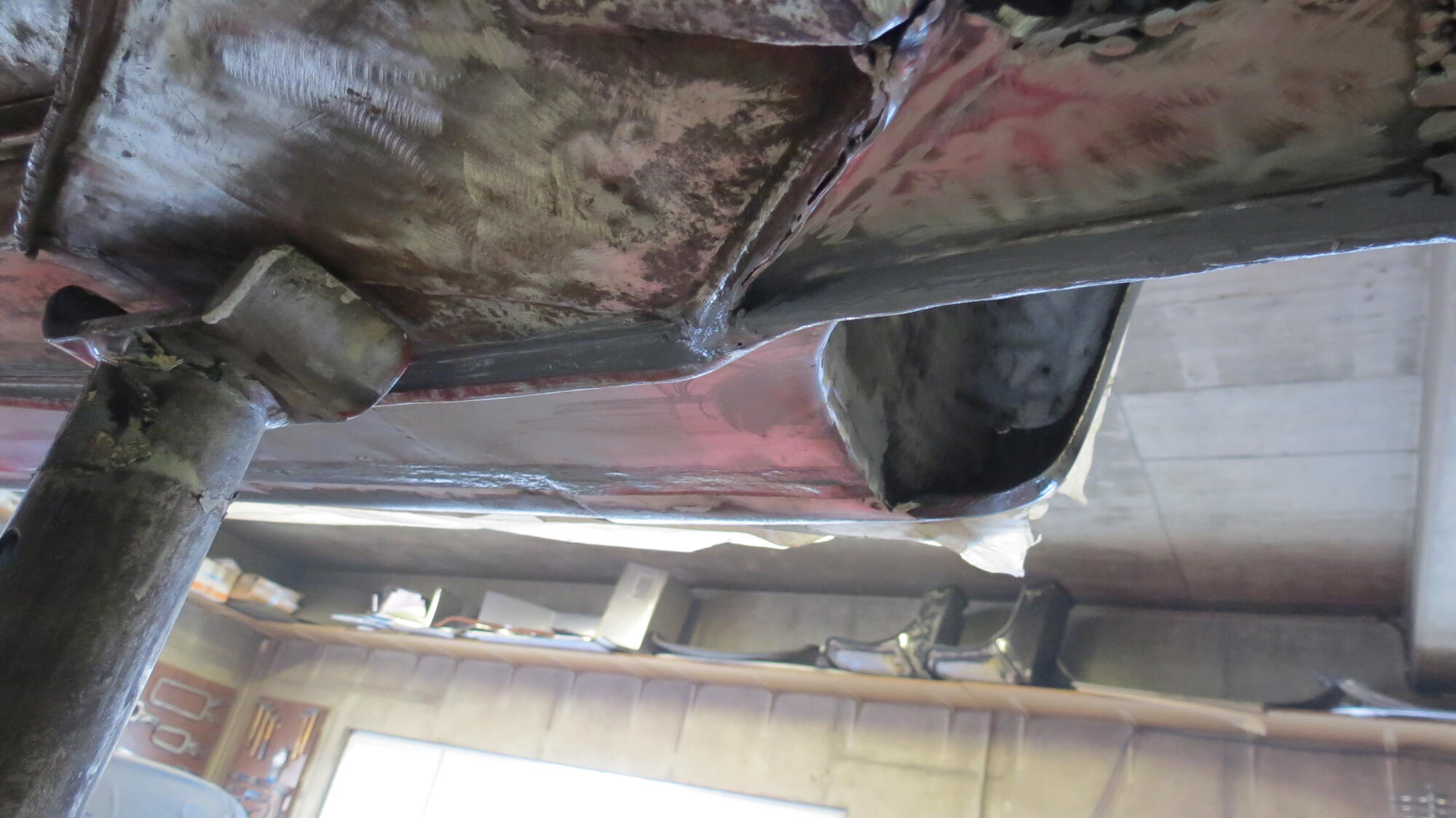

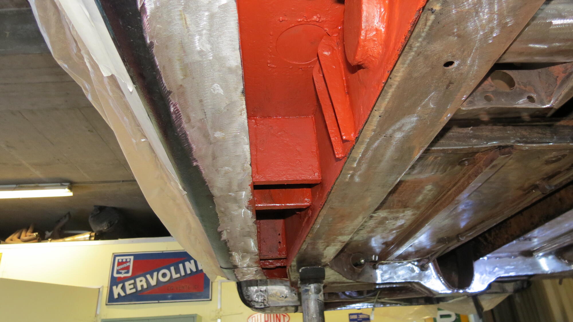

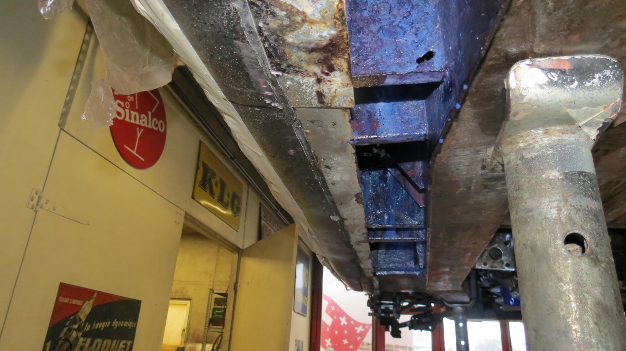

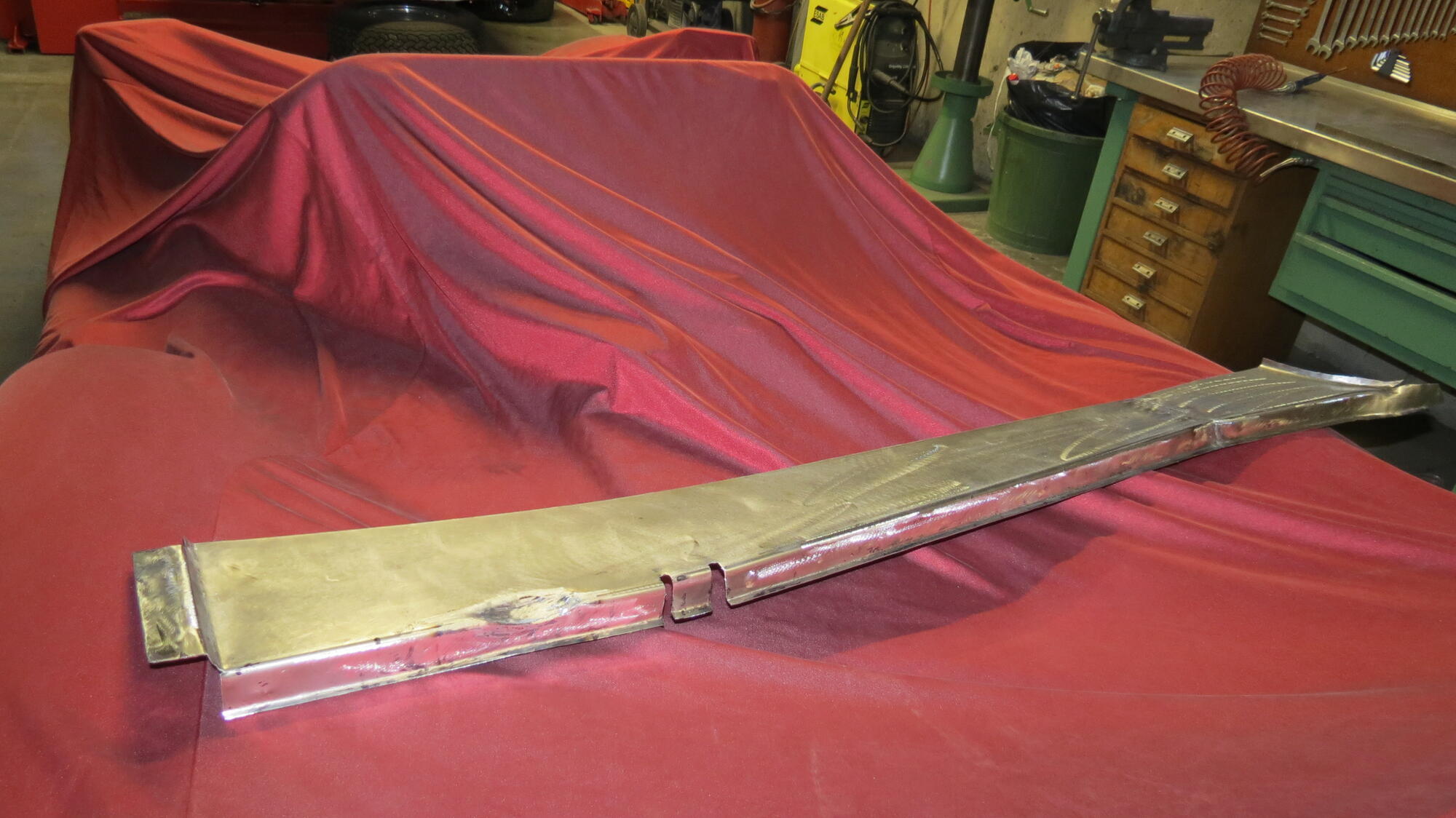

      The Bristol has an aluminum body on top of a steel chassis. When I got the car, everything was coated in heavy tar...but supposedly rust free.
      Well, not really !

      Aug 2020
      11
Size:  254.6 KBName:  421F387F-7271-4BB4-94AD-71B7C00D3691.jpg
Size:  174.8 KBName:  709521B2-CC9A-4F8B-B6E9-A97D9C28CB7F.jpg
Size:  193.2 KBName:  8DD14678-EDCF-4FA0-978F-B40DBC340499.jpg
Size:  230.6 KBName:  F942CC75-17E5-4A00-BD98-DA4CE0622608.jpg
Size:  225.9 KBName:  F1BDB9A5-CF81-4E74-95C8-6A02BD18B1CF.jpg
Size:  198.5 KBName:  EEE91975-1A56-4D9D-B834-28D81B2E1532.jpg
Size:  229.8 KBName:  72121242-9962-4ACA-9D59-9A6343CAA121.jpg
Size:  224.5 KBName:  A3662DBA-55D0-4A9E-A08A-9705270AED07.jpg
Size:  223.6 KBName:  83BA9C92-8514-45D6-8865-56F233556B8B.jpg
Size:  201.5 KBEverything was stripped, and where needed redone
