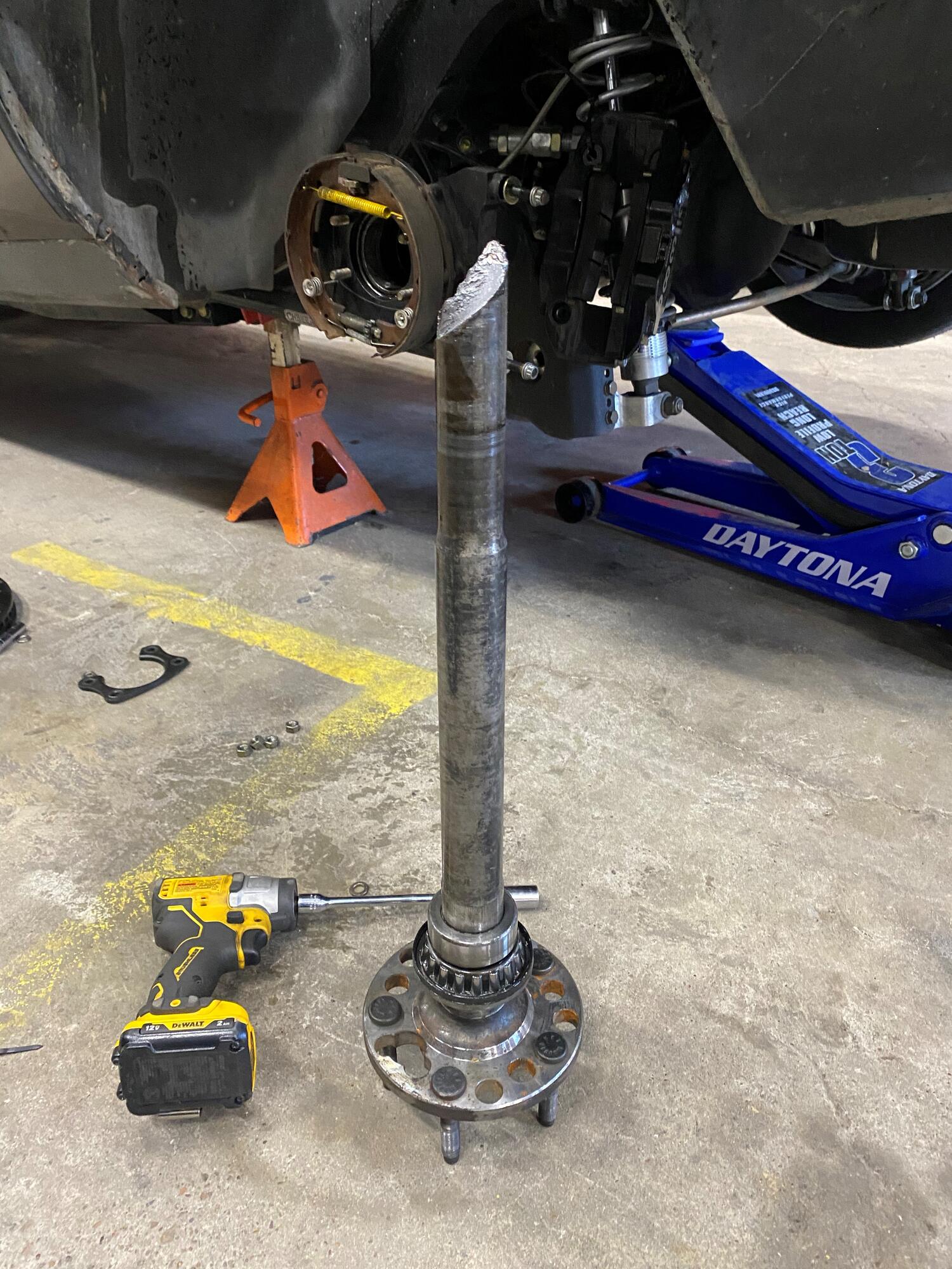

      I hate my tuner.. after tuning my HCIE LS3, I have broken my diff twice in the last week. Here is what I got:
      1. 1967 PT Camaro, 500RWHP NA LS3, Tremec Magnum 6 speed (2.97 1st gear)
      2. PEM 9" ford housing, 31 spline axles, detroit locker, 3.89 gears
      3. Nitto NT05 rear tire; ~12" wide, 26" tall.
      First time out, we broke the case and destroyed 1310 ujoint; Ford grey iron case and pinion support. No biggie, I always figured that would have been the weak link.

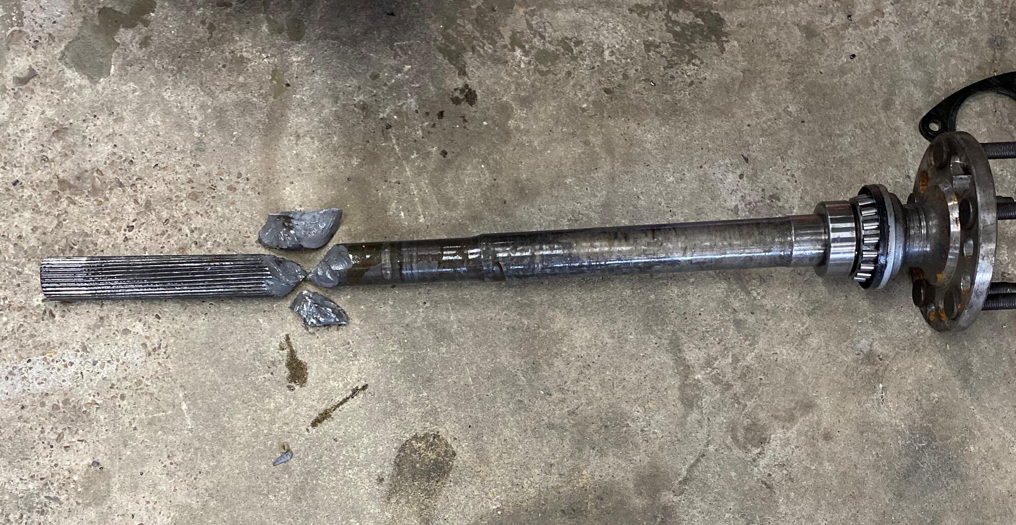

      We then rebuilt/upgraded the case to Strange Nodular 3.06 case, Daytona Pinion Support, new gears, bearings etc. and proceeded to snap/shatter the drivers side rear axle at the spline transition. This was at the drags, during launch, on street tires.
      I know that there are others on here with wayyy nastier combos than mine that are holding together. Let me know what you are using

      1310 u-joints & yokes are not performance oriented....
      I have broken these with 300hp.
      A 31 spline axle is only rated to 500hp.
      I just had this conversation with Strange last week.
      Upgrade to 35 spline axles & a matching center section with a good Driveshaft & 1350 u-joints.
      Then it will handle 1000hp.
      I ran a 33 spline 12 bolt with 33 spline axles launching at 5K on slicks with 650whp & went 9's.
      Yes, this will eventually twist the input shaft off of a T-56, but the rest of the drive line held just fine for years.

      thanks for everyone's input. Looks like we are looking at a 35 or 40 spline uprade.
      just need to choose a vendor and move forward. Matt

      40 is overkill unless you plan to be over 1000rwhp.
      Here are some axle Ratings:
      30 Spline: 6,200 ft./lbs. (per axle)
      31 Spline: 7,000 ft./lbs. (per axle)
      33 Spline: 8,200 ft./lbs. (per axle)
      35 Spline: 9,600 ft./lbs. (per axle)
      40 Spline: 12,000 ft./lbs. (per axle)
      Remember it is possible to put nearly all power to 1 axle with a good posi or locker.
      Wheel hop is even more destructive.
      In your case, say 500ft/lb x 2.97 trans x 3.89 rear = 5777ft/lb potential.
      Add a safety factor & take shock loads into account.
      Strange rates their 35 spline street axles to 800hp & their race axle to 1000hp, based on drag strip launches with slicks.
      40 spline are spool only.

      thanks again for everyone's input. Placing order today for 3.250 case, 35 spline differential, and alloy axles.

      31 spline axles and 31 spline diff and carrier; otherwise parts list between the 2 are surprisingly similar
Size:  444.9 KBName:  broken axle 2.jpg
